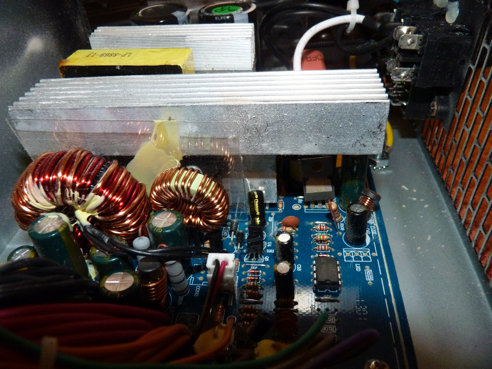

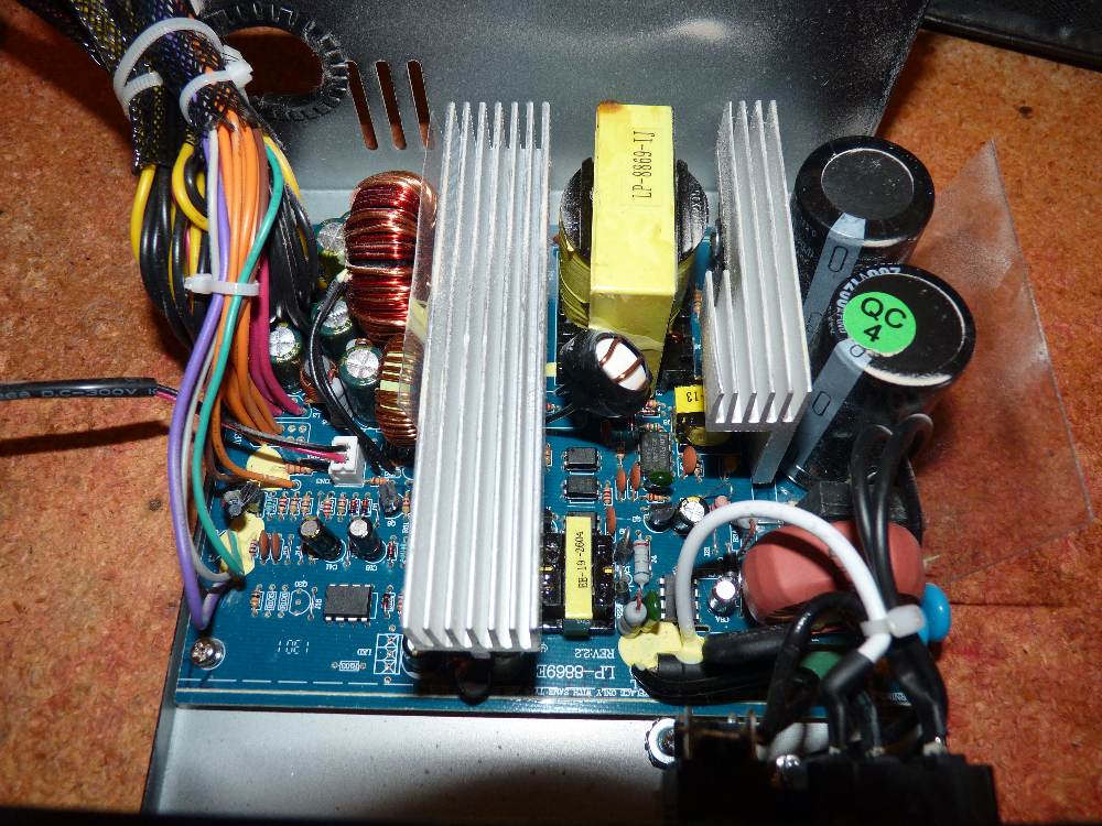

            Here's a Solid Gear SDGR-750E (Leadman LP-8869E) from a friend's computer. Secondary caps are Chengx, no idea about the others. Looks like maybe a 300W to me.
              Looks fairly good actually.
              PWM chip for the 5V_STBY, and a decent sized main transformer.
              Note that there is a to-247 device on the secondary heatsink! That is probably a fairly beefy rectifier.

                #947
                Re: the gutless, bloated, and fried power supply hall of shame
                It's the same thing as the Inland. Based on the model, this one is probably rated for 750W.

                  #948
                  A Leadman with a bridge rectifier? That's news to me!
