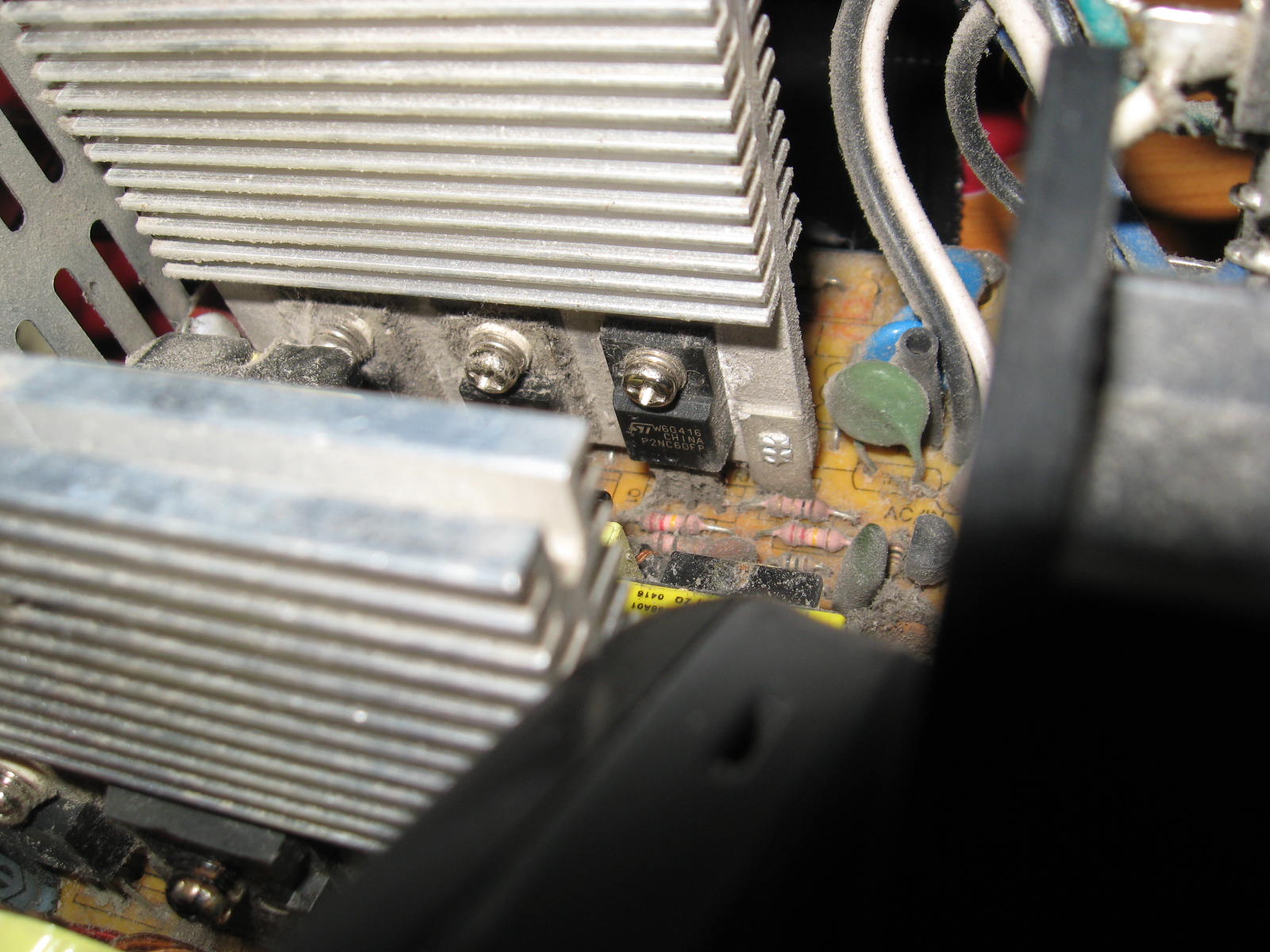

                    You'll have to forgive me for the quality of this post - I'm visiting my parents' place for a few days so I'm demoted from a eight core system with 2 1920x1200 screens to a Sempron pc with a 19" lcd screen.
                    In addition, I've snapped the following pictures with my sister's camera, with batteries nearly dead (literraly turned off and on the camera every 2 pictures due to flash getting the batteries below the threshold).
                    I'm also writing this through remote desktop connection to my pc so if i make grammatical mistakes it's the lag.
                    So please excuse the out of focus and poor quality of pictures, the post,everything, i'm not in my environment.
                    Anyways, on with the story. Father complained a few weeks ago that the system was erratic, not powering on , or powering on only once every few times. Then one day it died.
                    Knowing it was a crappy psu that came with a 30$ case 3-4 years ago when this system was made, i just told him to go with the computer at a local service and let them install a new cheapo psu in the system. He only uses the computer for eBay (collecting stamps and coins) and news.
                    So here's the 400w rated psu. Supposed to be 400w ... based on transformers it looks more like 250w max.
                    Full of CS capacitors, 560uf 200v 85c on primary, 13009 transistors, ie-33 transformer, i think it's the two transistor job for the 5v sb
                    3.3v, 5v, 12v is 22a , 40a, 18a but i doubt it, the beefiest diode that i can see on the heatsink is a SB3040PT which is a 30A shottky barrier rectifier.
                    If you check the pictures carefully, you'll see why it died.

                      Dead cap on 5VSB output, looks like. Easy fix. Yeah, it may not be a 400W PSU, but it's probably more than enough for that Sempron PC. Only concern is the 5VSB sections - it looks darkened. I don't see a critical cap on there, though. Perhaps it just needs new output caps on 5VSB (although if you replace the output caps on the rest of the PSU, that wouldn't be a bad thing eitehr).

                        Bingo. That schottky rectifier on the secondary also looks a bit cooked, may be dead.
                        Honestly, can't be bothered to carry it with me back to my place and fix it, all i have here are screwdrivers.
                        I would have loved to remove the big caps and measure them, for Uranium's thread, but it's just too much hassle.
