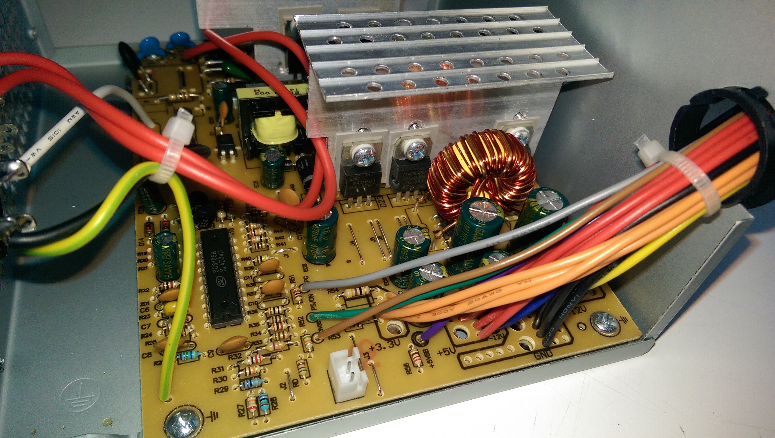

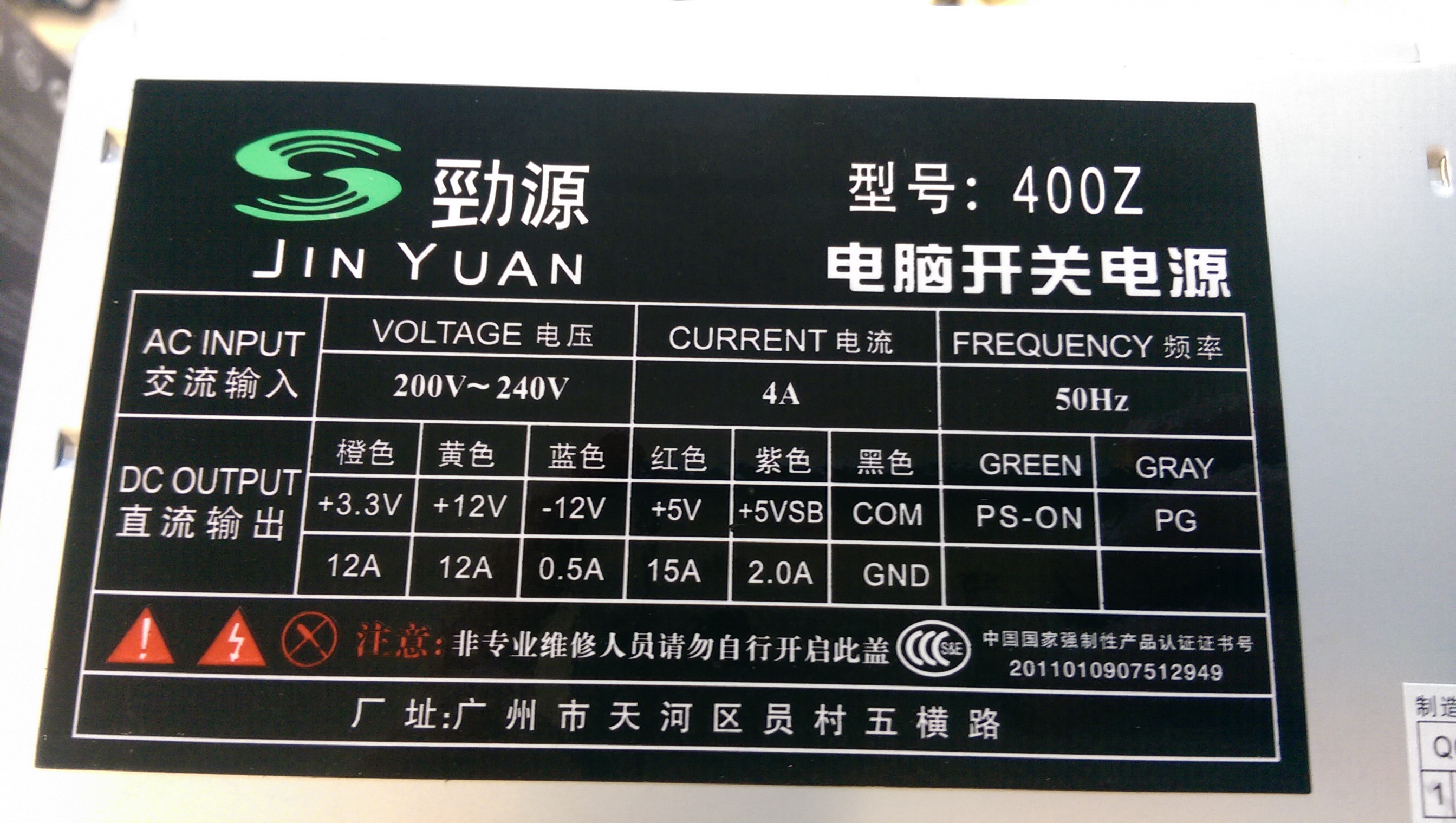

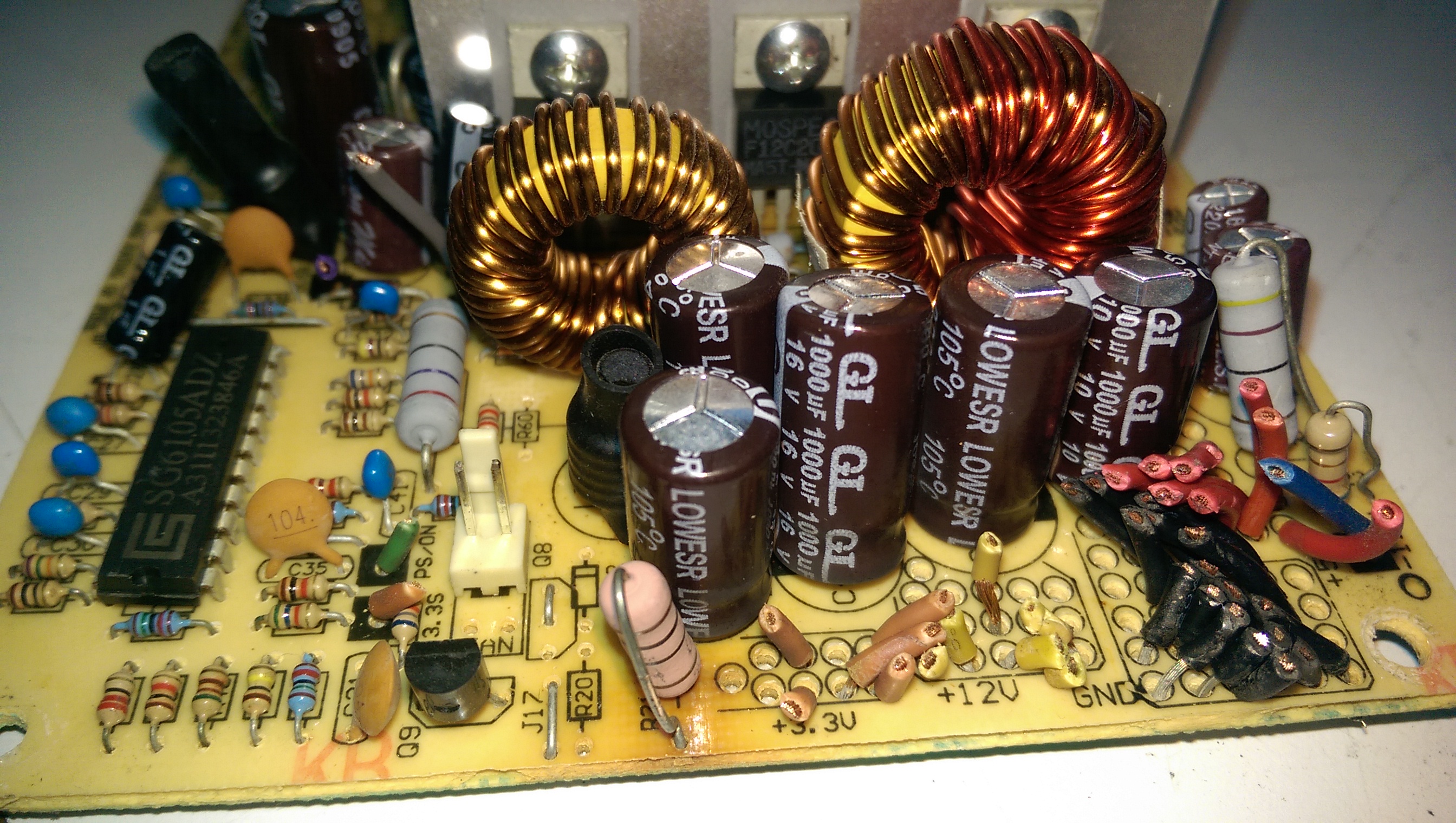

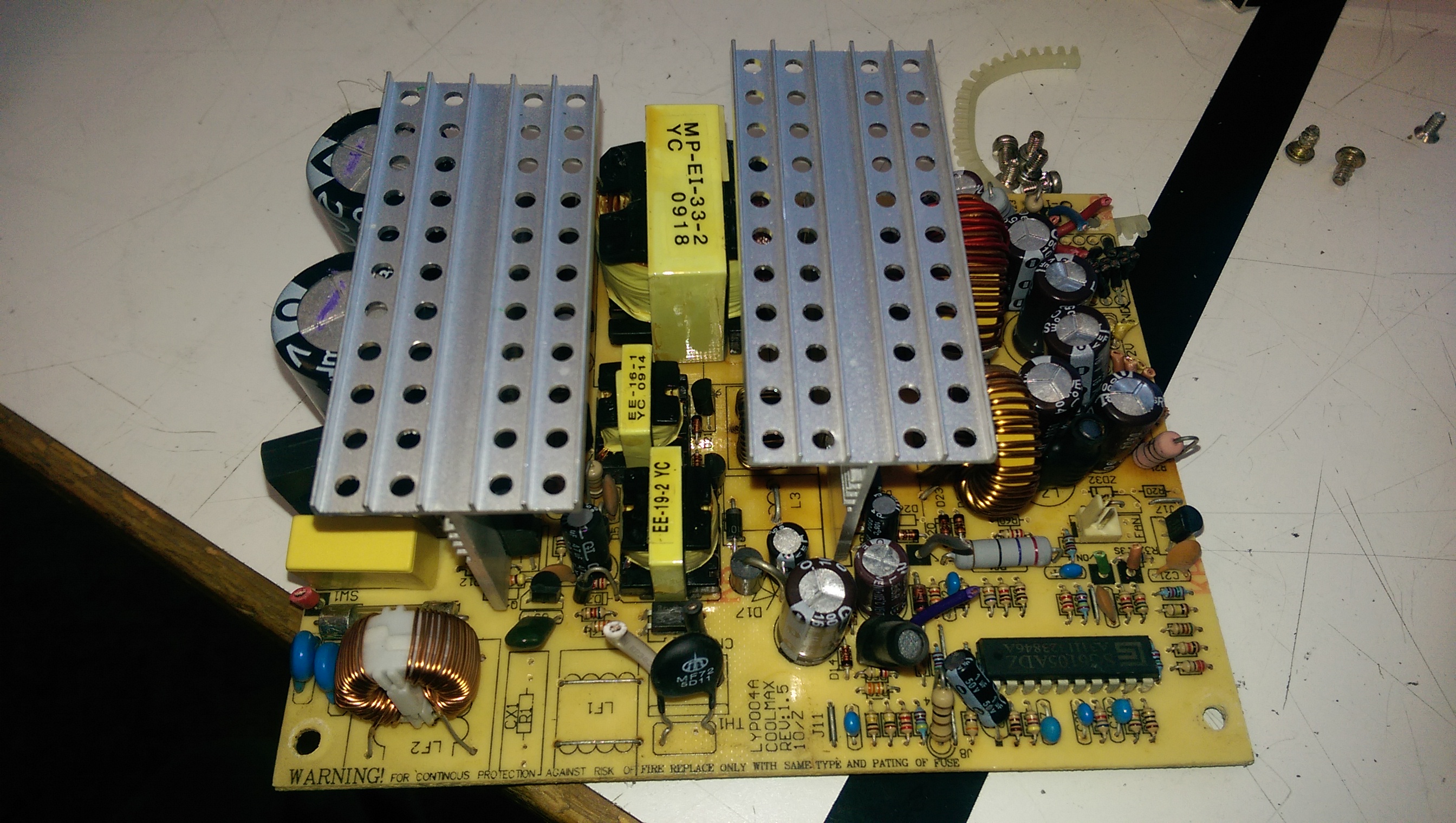

The BR is 4A, NTC rated at 5A, 330uF Micon primary caps (They actually read 330uF too!) 13007 transistors, 33 transformer, 20A for 5V, 12A for 12V, 20A for 3.3V. Pretty lousy, no PI coil on 12V or 5V, Mostly GoldLink caps, some Micon in there too. Looking at the soldering side, how embarrassing. Maybe this thing was RMA'd and hand fixed? All those sloppy joints (one with a lifted pad) are on the 5VSB transformer. Not going to bother fixing this one, just going to take some parts and throw it away.

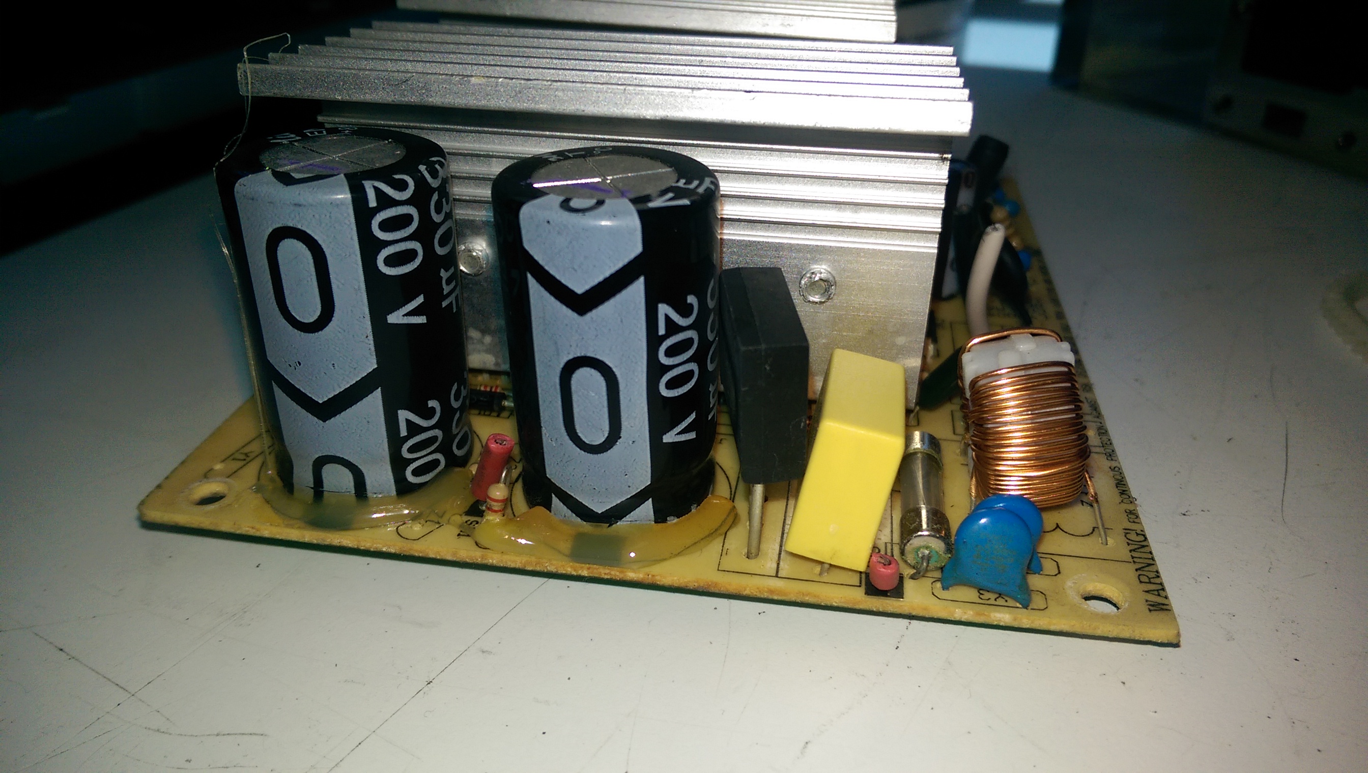

Of course there's almost no input filtering to speak of, with the usual missing components and unapproved Y caps. The caps are 330uF branded "HTC" transistors are 13007. Transformer looks like 33, it's pretty small but it's silkscreened for an even smaller transformer!!!

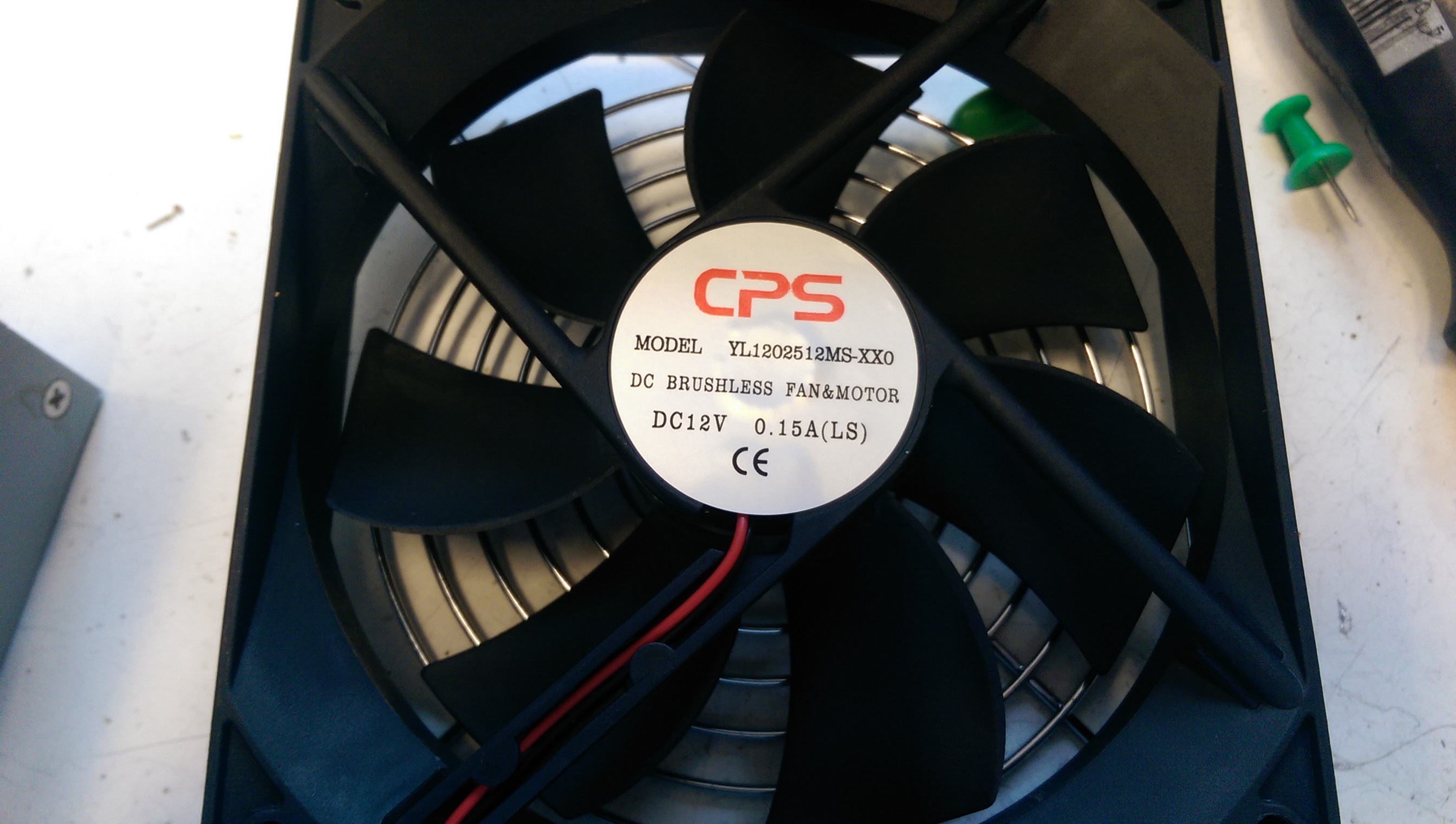

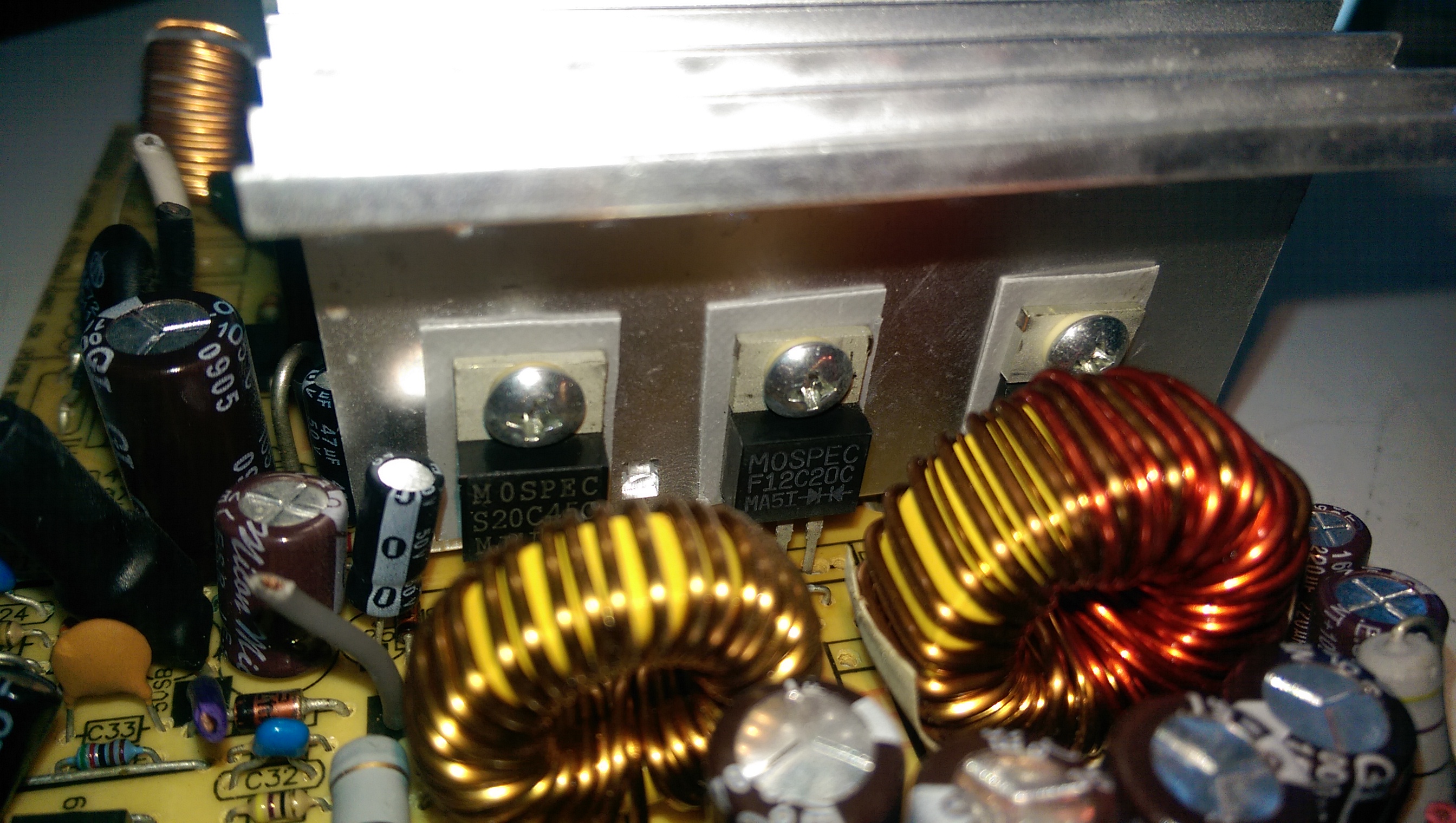

One of the few positives, it doesn't use a 2 transistor 5VSB. Looks like it uses that single toroid for all the rails, for mega group regulation. It seems that the 5V rail and 3.3V rail share the 30A shottky and the 40A FET just steps the 5V down for the 3.3V. 12V uses a 16A ultra fast. Soldering looks good, minus on some of the silicon. The only other pro for this thing is the fan. Can't find jack shit about it though. It's hooked straight to 12V, but it's actually very silent and moves a lot of air. Plenty oil in the bearing too, and it's actually oil, not grease.

At least with these cheap heatsinks, I will be able to break them down into a few bridge rectifier heatsinks
that's not a size "35" transformer! Heck, I'll say not even 33. Looks like a "28"-er. Probably good enough for 150W continuous. 200W would be kind of pushing it.
