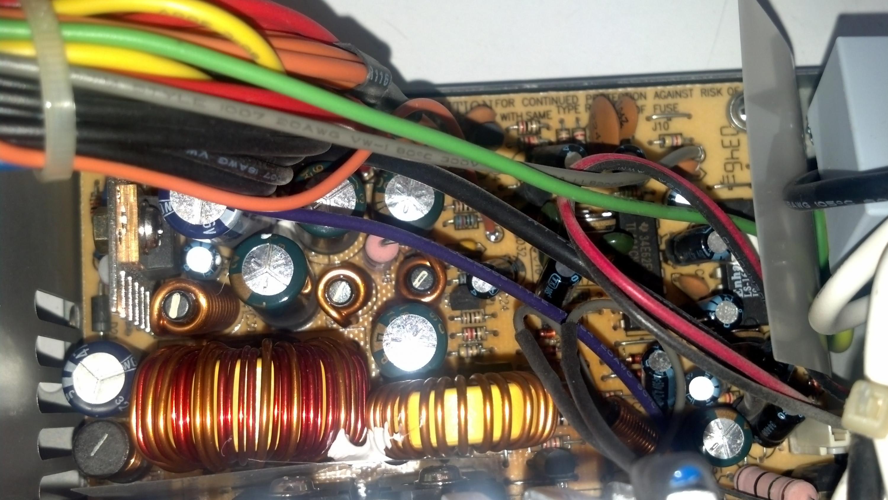

        Would you mind seeing what kind of chip U2 is? I could not make it out in the pictures.
        Thanks!

          Yeah no problem it says JD3310D with 12M02 date code
                    This chip looks like it is for the 5vsb, but I could not find much information on it.
                    http://www.jdsemi.cn/en/search.asp?k...imageField.y=0
                    Thanks for replying with the information.

                      Good find, I couldn't find practically anything on it! It must be a fairly new part
