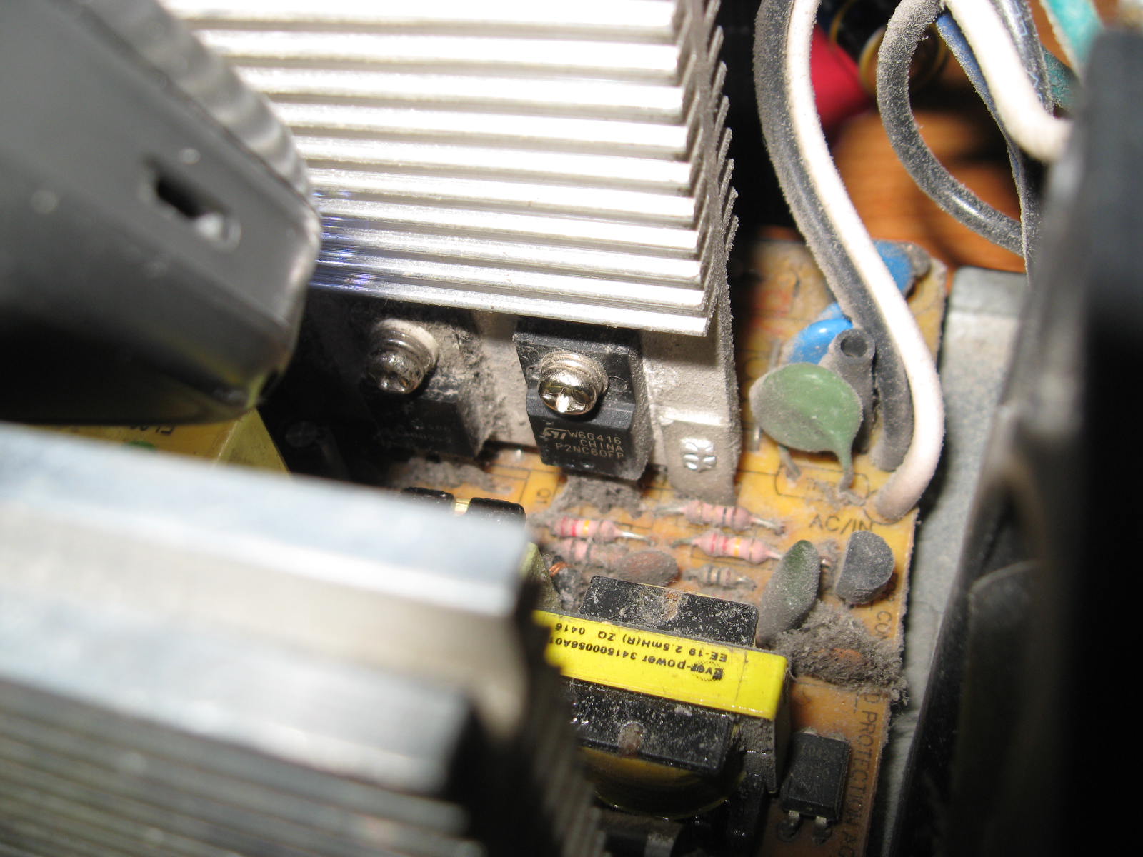

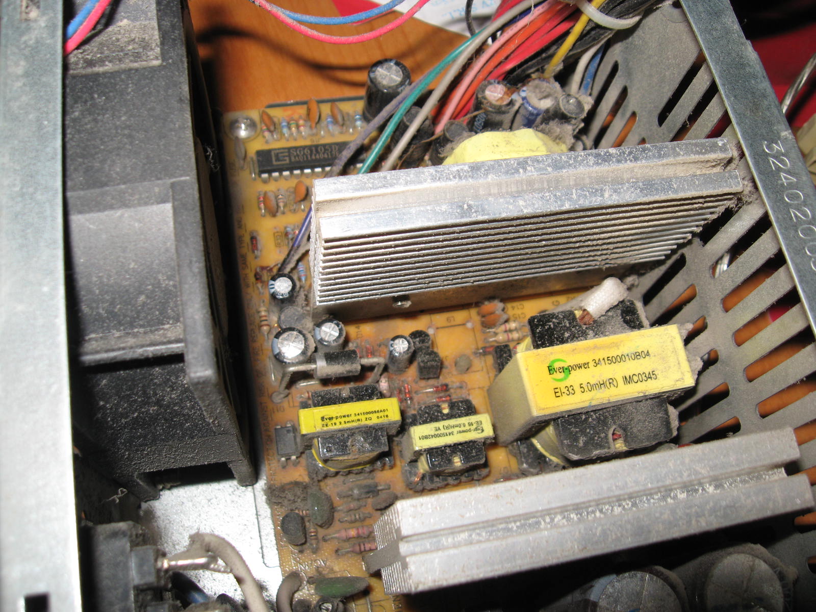

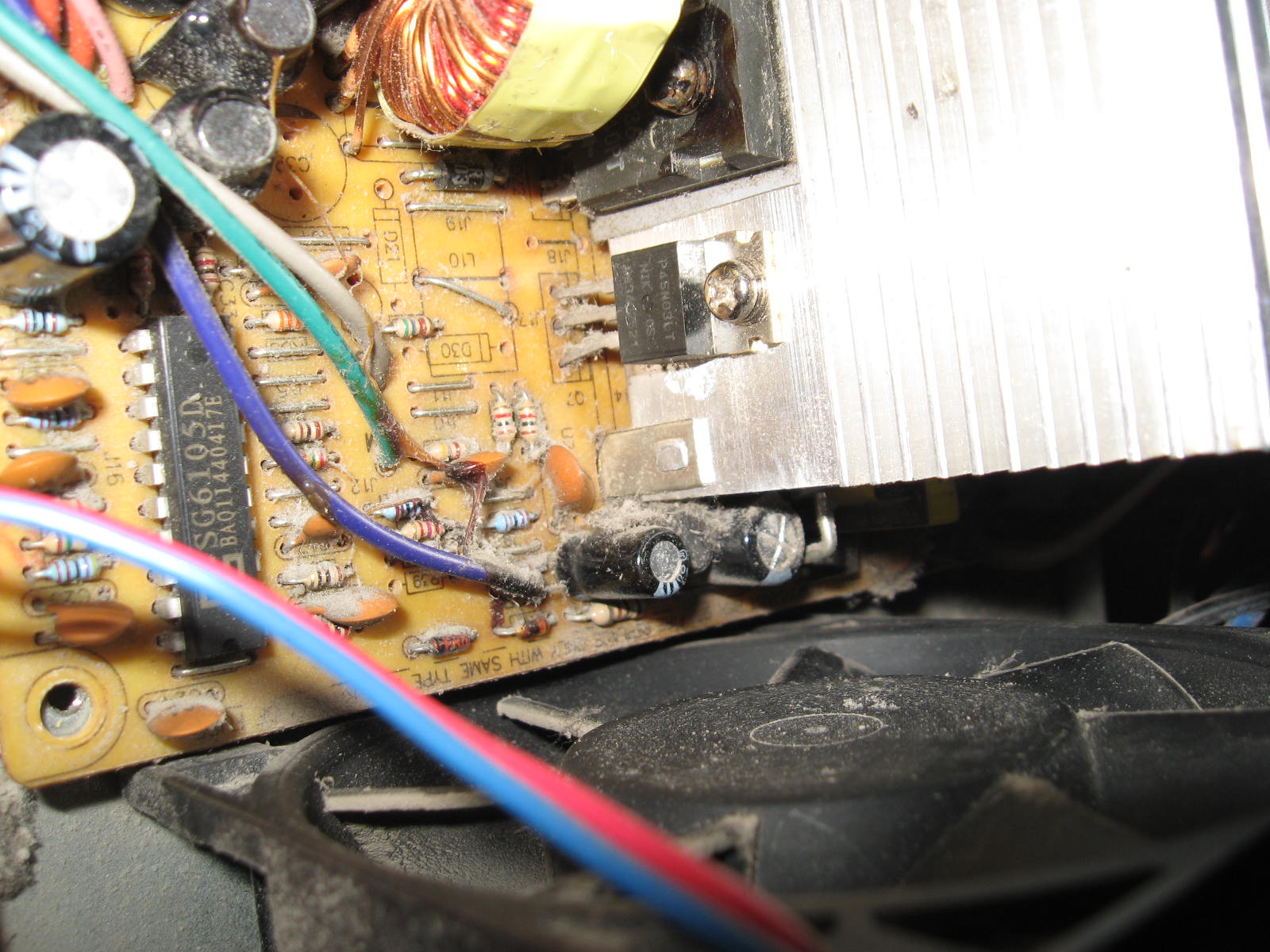

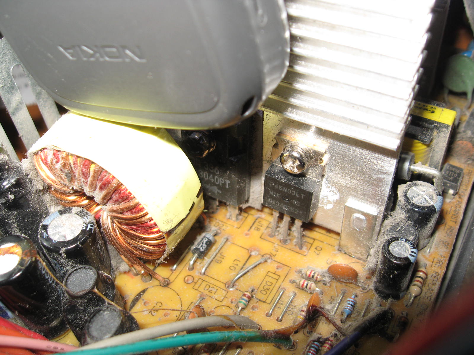

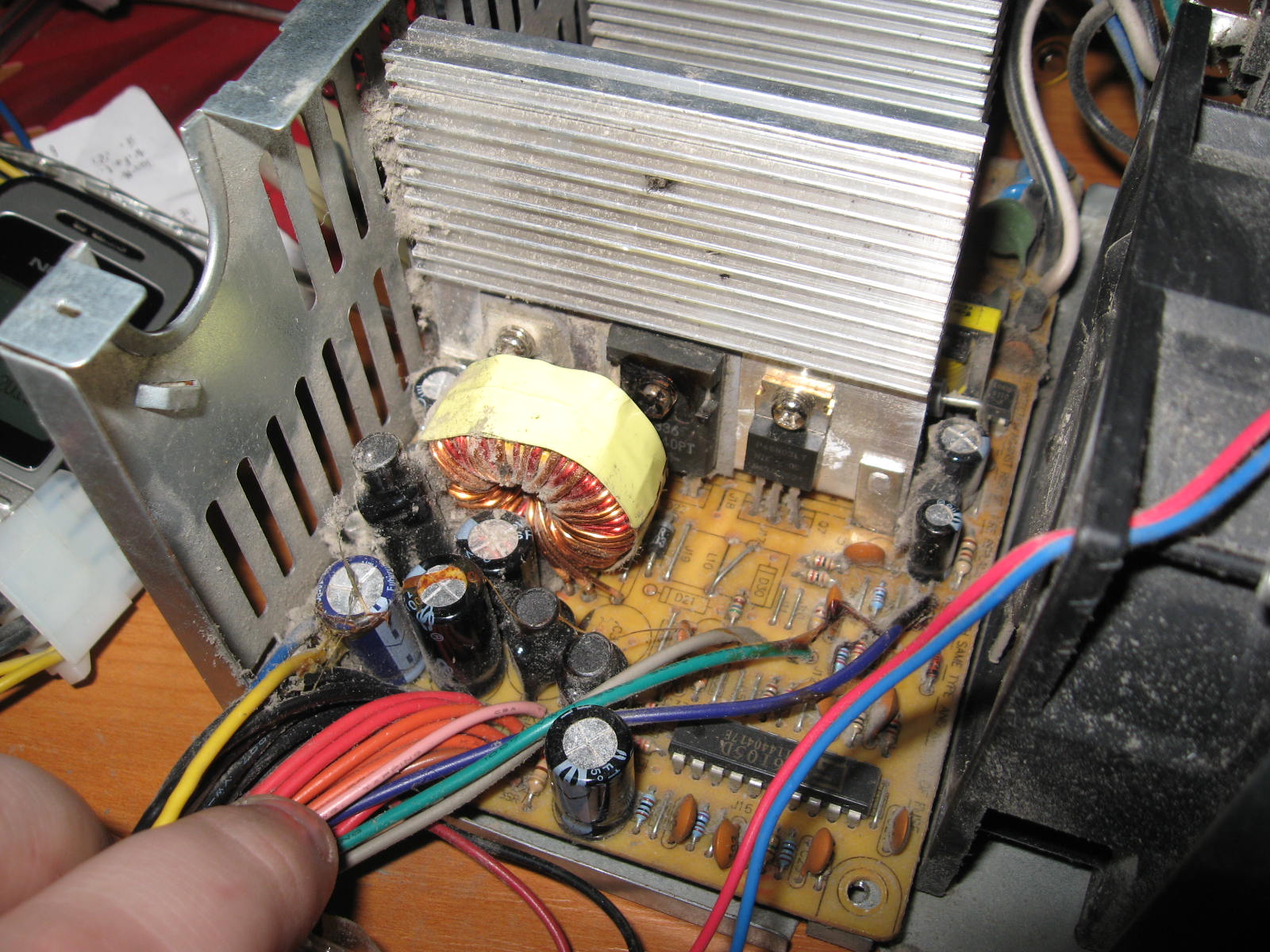

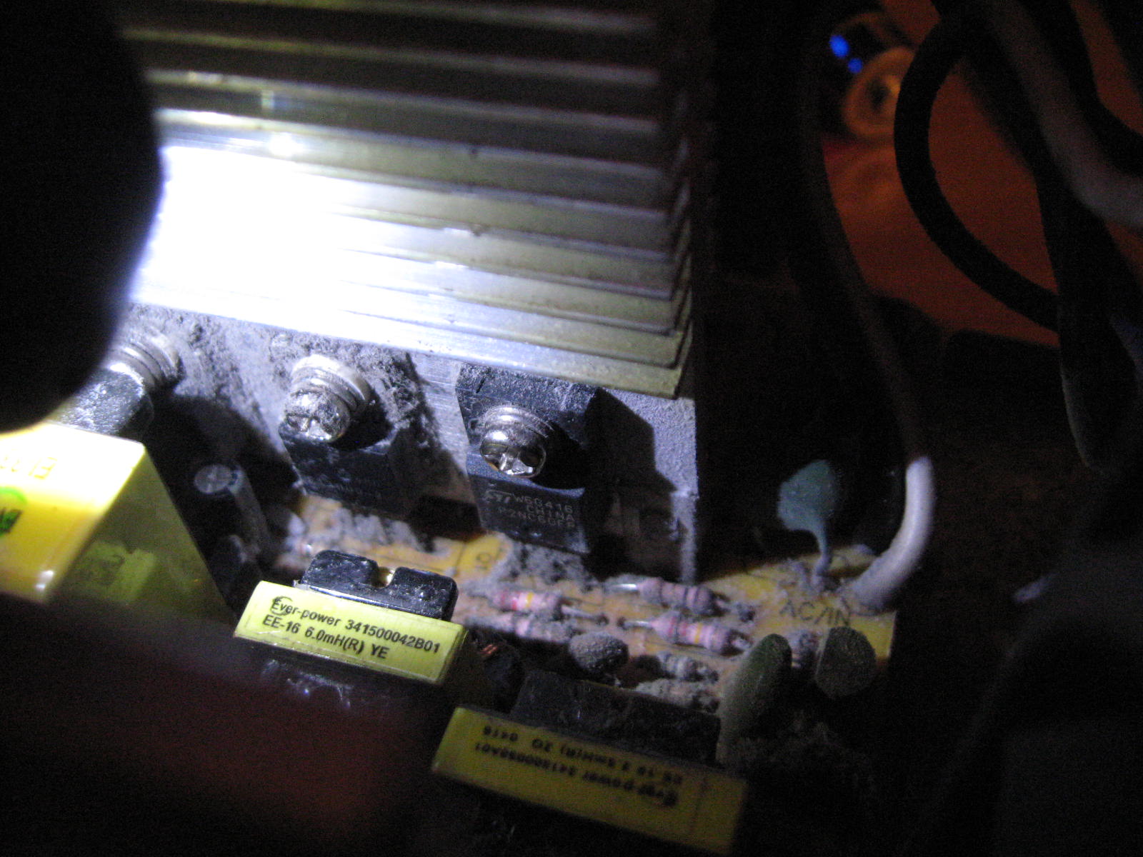

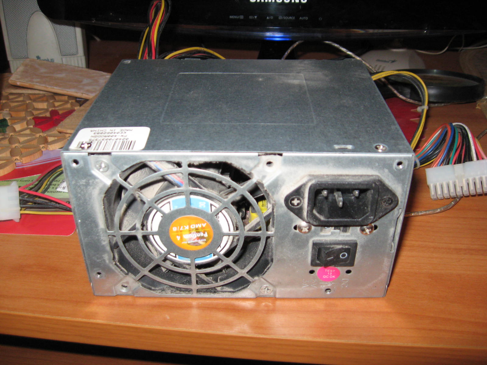

Yeah, no input common mode inductor, no X cap, no MOVs to prevent the input lytics from venting (a safety standards violation, IIRC). Those heatsinks, the MJE13007-copy BJTs, the 470uF input lytics, the TL494, the -26 material output inductors all yell, "I'm a mediocre 250W power supply!"
[elitist rant] Dammit, the UC384x family PWMs and power MOSFETs have been around for 3 decades, everyone knows who the good cap vendors are, powdered iron cores have been around longer than I have, and heatsinks have been around and understood as long or longer! There is no excuse for manufacturing and selling a TL494-and-BJT-switch-device-and-26-material-based, unfiltered input, wimpy-heatsunk, crappy-fanned, crappy-&-wimpy-capacitor-populated POS like this. Not without a multilingual warning label such as, "Warning: this POS is a waste of money and is hazardous to your checking account, computer system, and home!" [/elitist rant]
 Actually, the heatsinks are better than they look. That metal is actually pretty hard to bend with your fingers, I was surprised. I'm not saying they're good, just that they aren't the Leadman style ones that look like they were forged from melted beer cans
