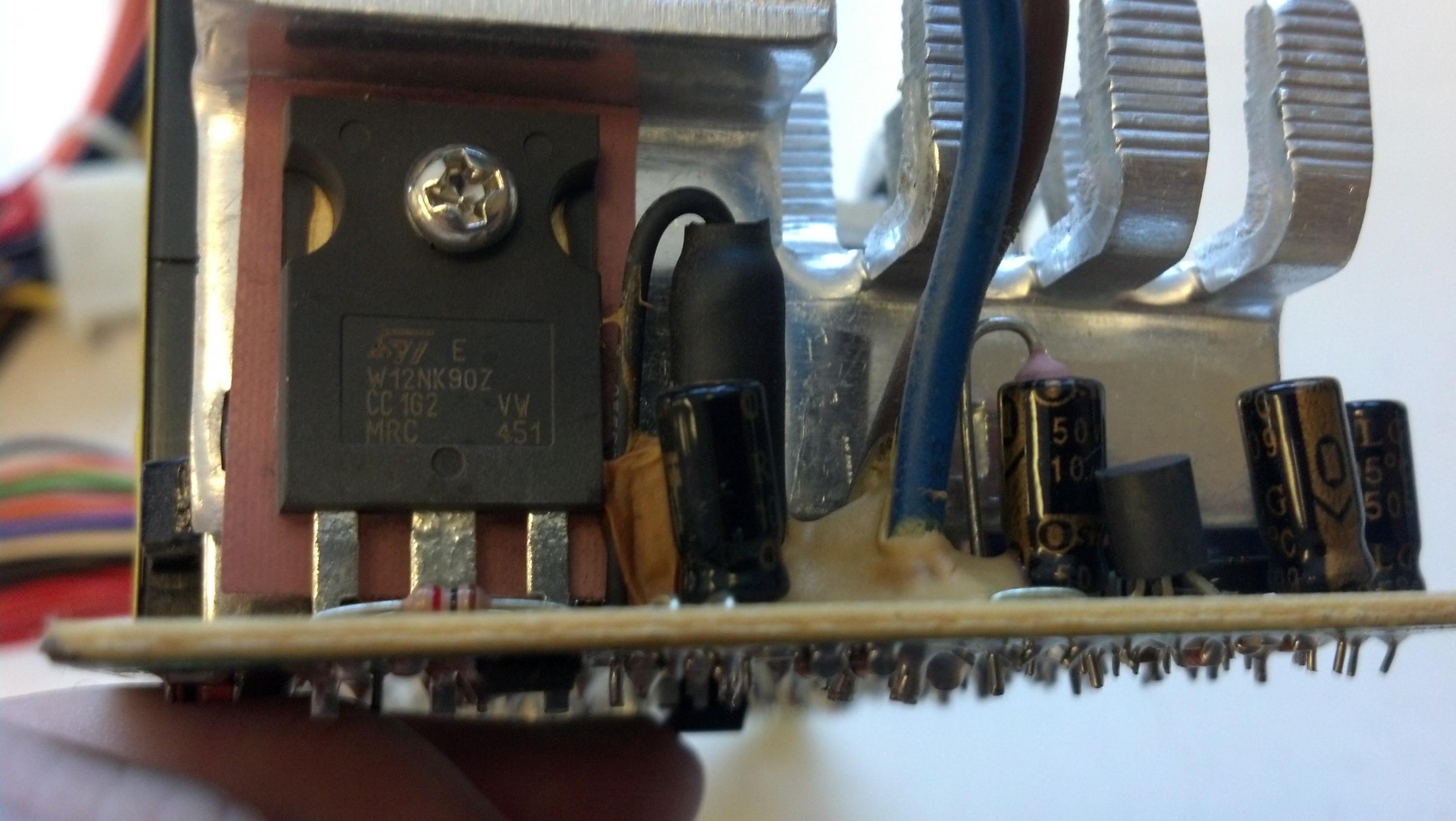

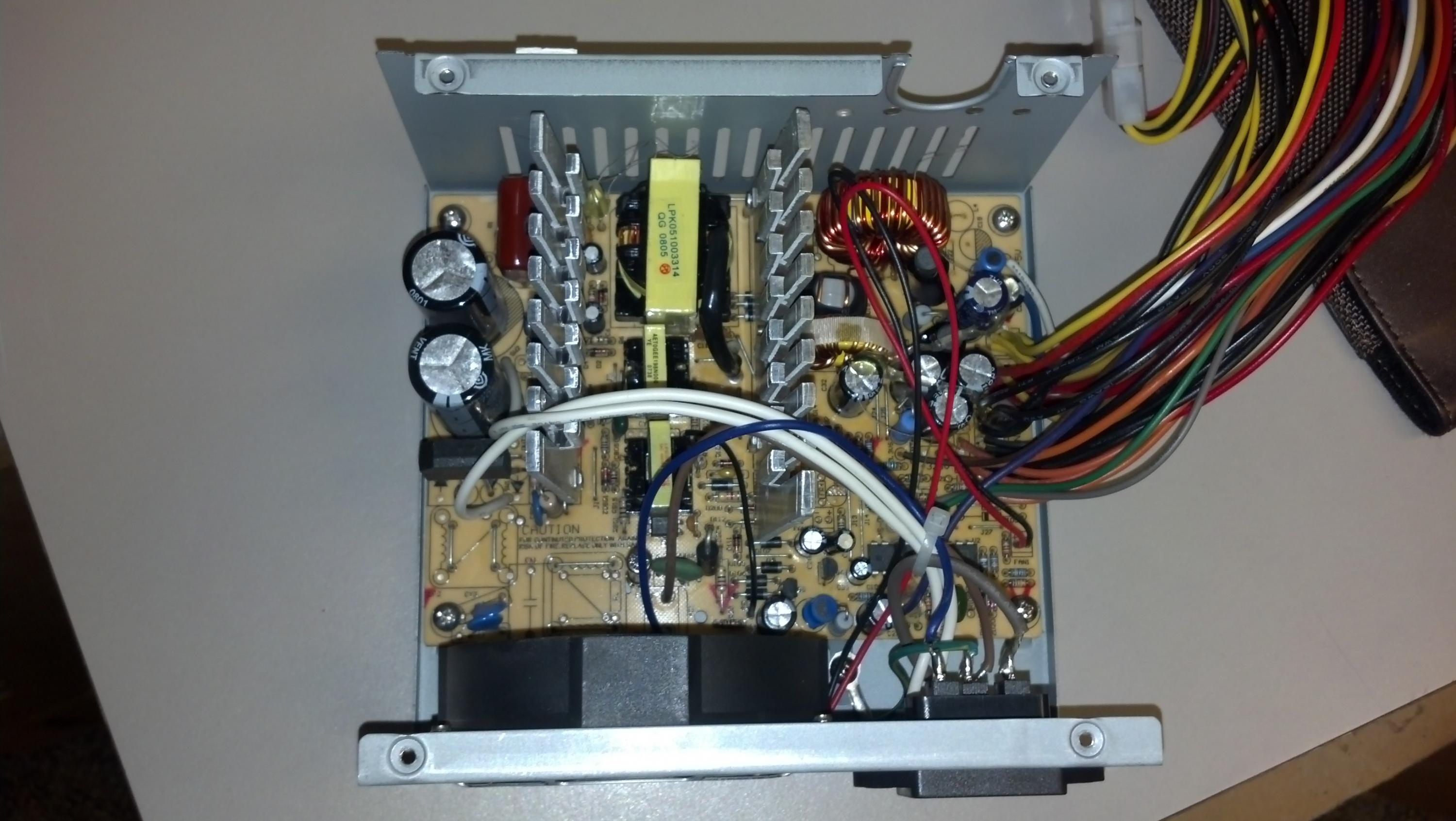

          Had this PSU in a surveillance system powering a Pentium D setup. The fan completely seized up and who knows how long it was running like that! I think the only thing that saved it was the fact that it was in a very cold server room. The heat did kill most of the OST caps without them bulging. Check out the ESR on the one in the picture!
          Replaced all the caps and the fan, it is much happier now and it looks much better

            Re: the gutless, bloated, and fried power supply hall of shame
            Interesting. Only the 5VSB caps actually bulged. In Win Power Men usually are quite well built, but I do wish that they would use better fans. Most of the newer ones use ADDA fans.

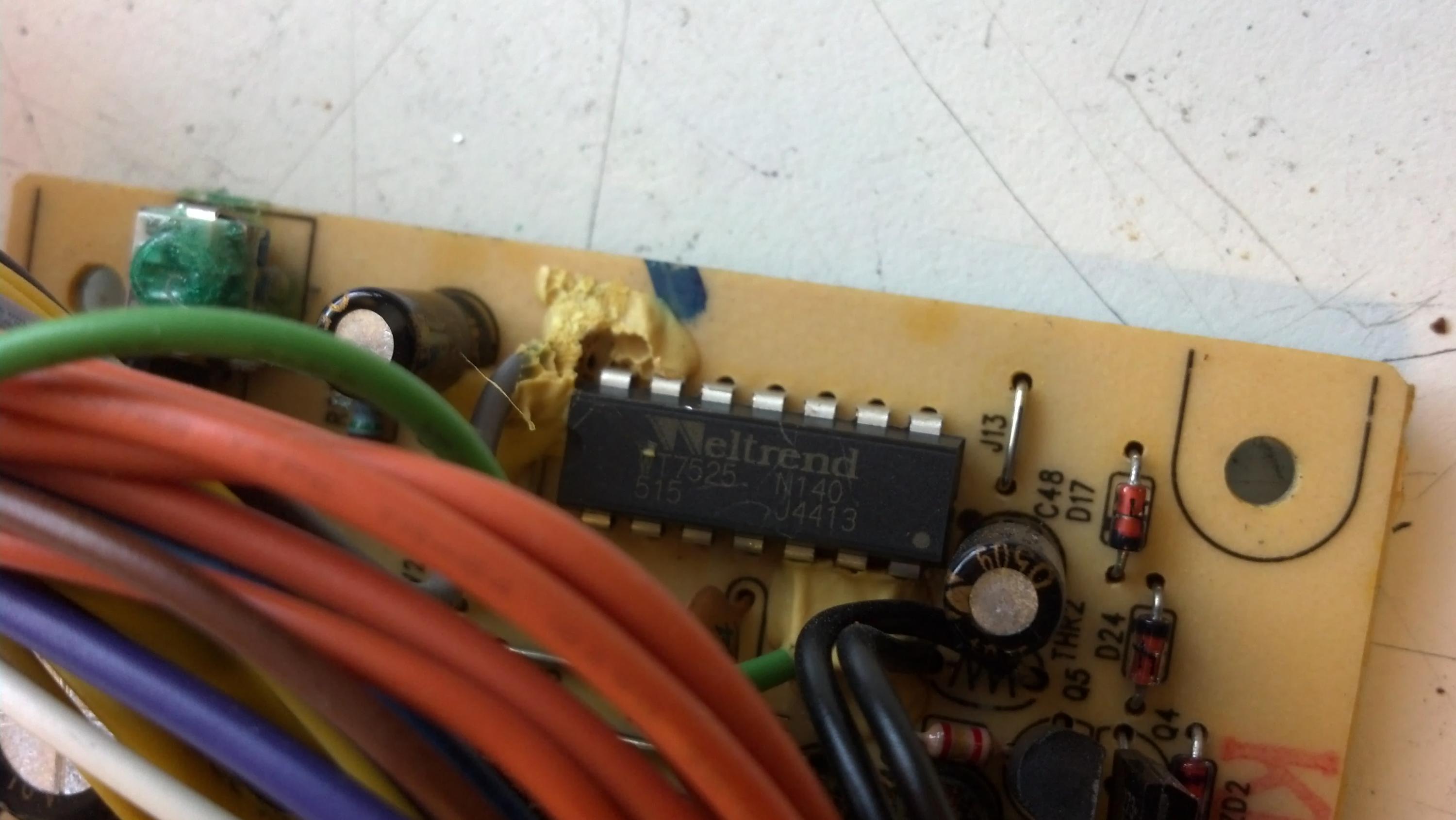

              #666
              I found that strange too since while the fan WAS working, they were the closest. The fan had hardly no oil in the bearing at all, but that could have dried out from the PSU getting so hot. Poweman does have a lot of good power supplies. A shame they use a lot of ADDA...the one I used in this one is a Protechnic Electric.
              I like how in that pic showing the 5VSB caps bulging, next to the orange wires they forgot the period so it looks like "+33V"

                #667
                Bestec should do that on the 5.0VSB rails on the 250-12E

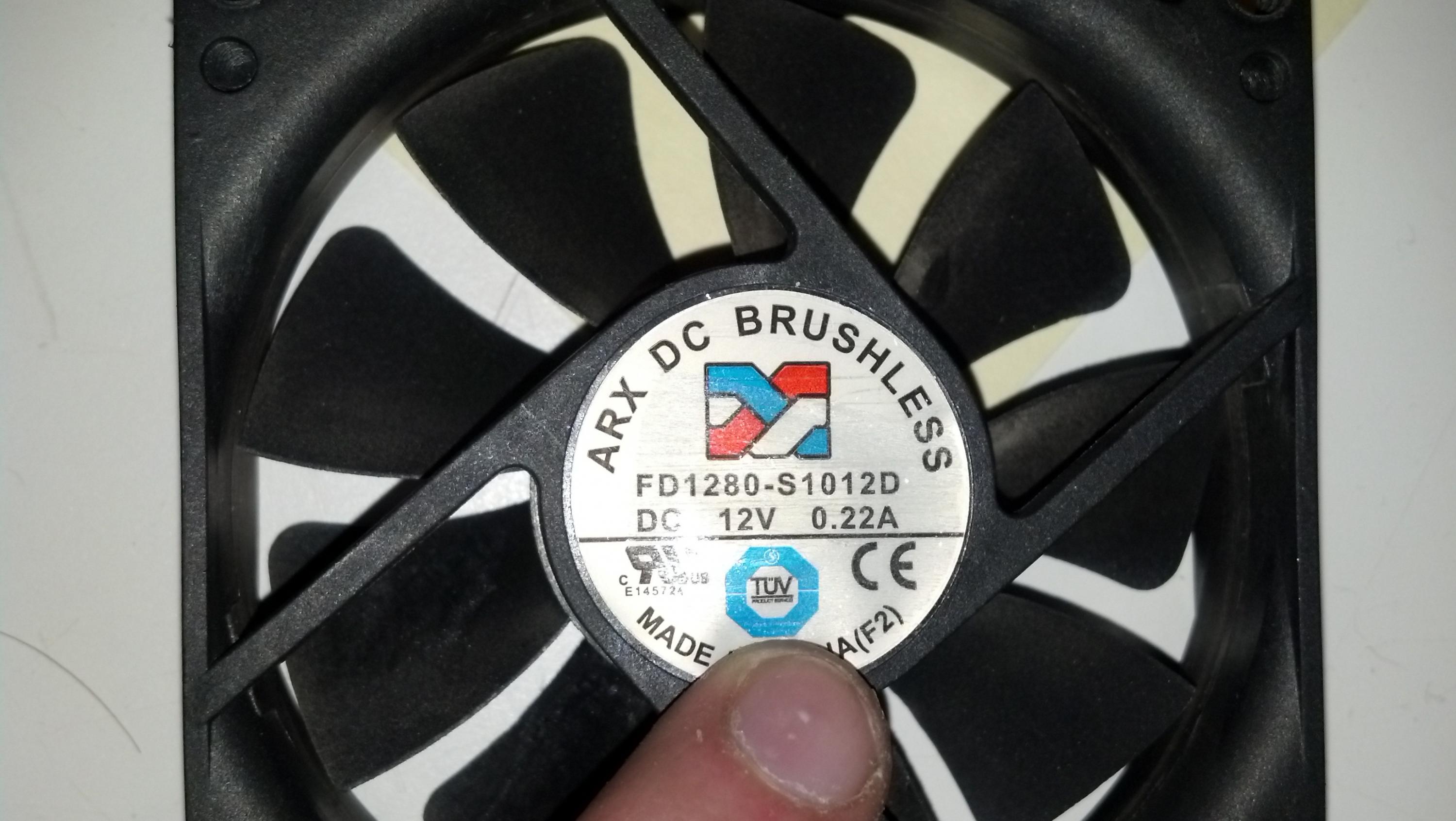

                      #670
                      I'm going to steal Behemot's line and say "prepare your vomit pale"
                      I can't believe this was used in a computer for years. Those poor components. 220uF input caps, four 2A diodes, D4242 switchers, 10A for 3.3V, 16A for 5V, and two 3A diodes for 12V One cap for 12V filtering. "Pentium 4 ready" ?!?! those diodes would barely be able to handle JUST a P4 let alone everything else that uses 12V!
                      Fan is made by Foxconn, sorry for the blurry pics they didn't seem blurry till I uploaded them
                      Maybe it's called "Everest" because it would need to run at the top of Mt. Everest to do over 150W without overheating?

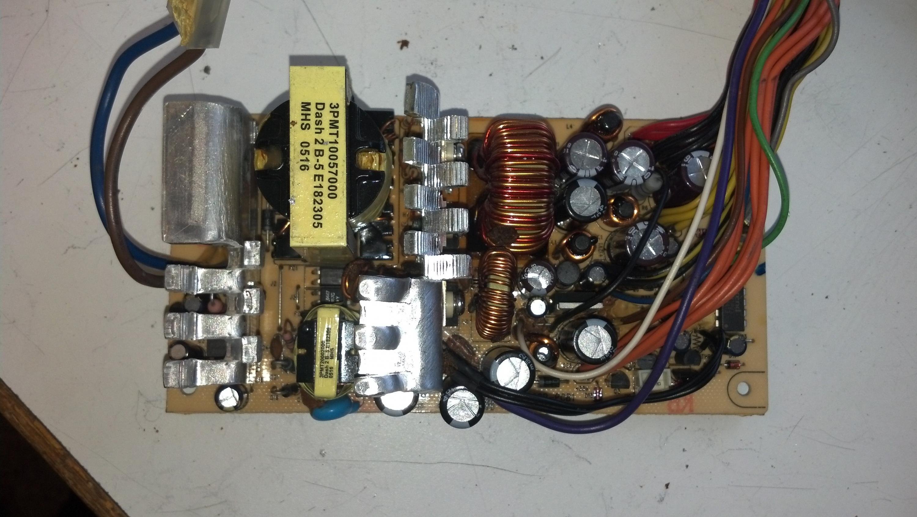

                            #673

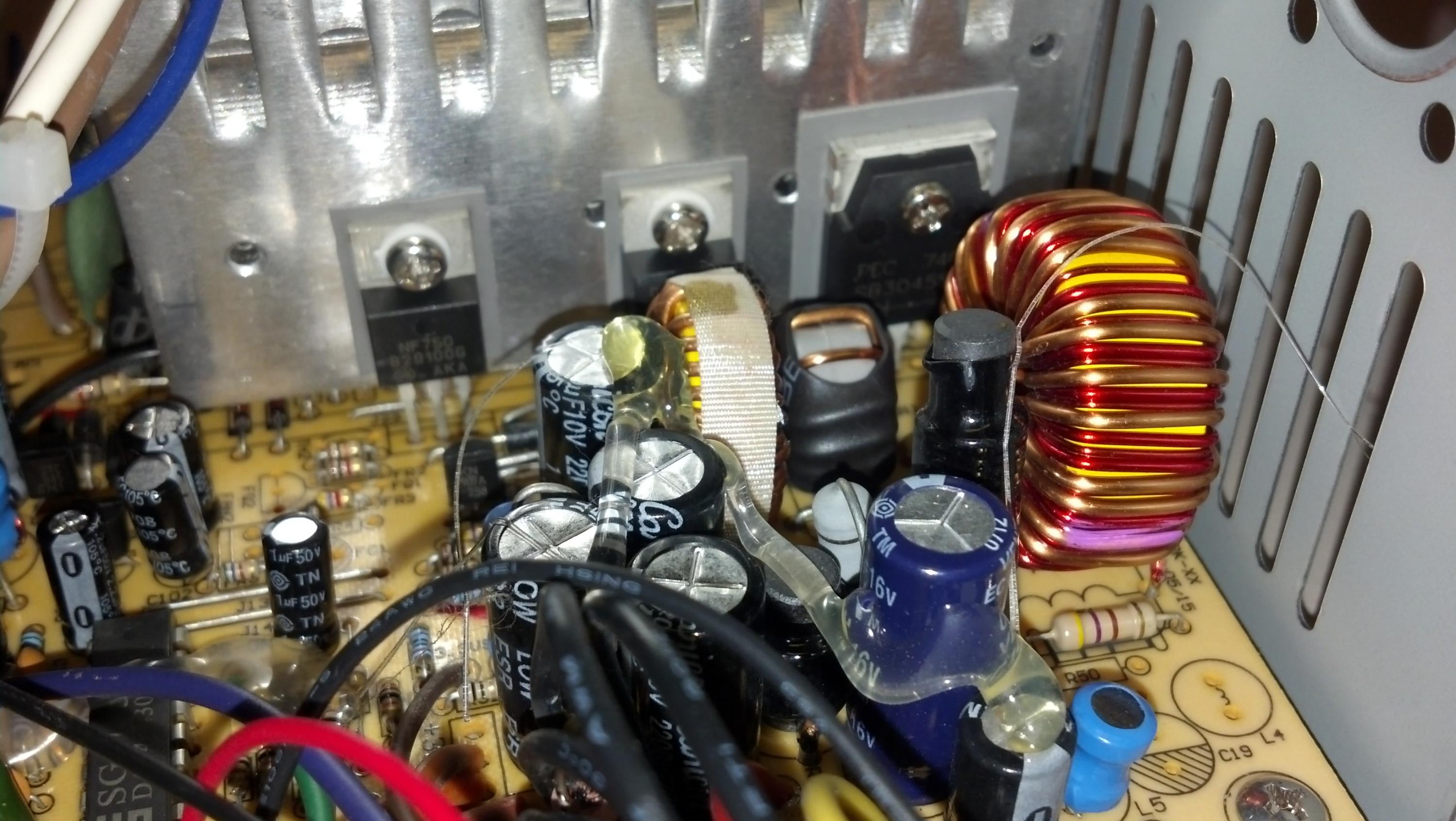

                            Wow, look at how smokin hot that filter choke got!
                            I guess those caps survived because they weren't mounted next to any hot components xD
                            What is wrong with the psu? Does the 5vstby read 5v, or does it read 20v?

                              #674
                              Looks just like the free-with-tigerdirect-case power supplies.
                              Because it is.
                              Looks like undersized traces overheated, discoloring the board... The winding varnish is not discolored.
                              What isn't?
                              No X-rated line-to-gnd caps
                              "Invisible" RFI/EMI filter- that's ok since the "FCC" logo is fake
                              Undersized wiring, complemented by overfusing
                              But at least the standby transistor is heatsinked!
                              25v, with lots 'o ripple- the 5VSB cap, yes, just one of them, seems to be "hiding out" behind the heatsink...
                              A Deer, perhaps? "Model number" (that they pulled outta their ass) is the same format. xxB-450.

                                #675
                                Because it is.
                                What isn't?
                                In "what is wrong with it" I meant, is there a short on one of the rails? Blown transistors? 5vsb overvoltage, etc...
                                Lol at the 25V on the 5vsb!

                                  #676
                                  If a little (voltage) is good, more (voltage) must be better!

                                    • 3741
                                    #677

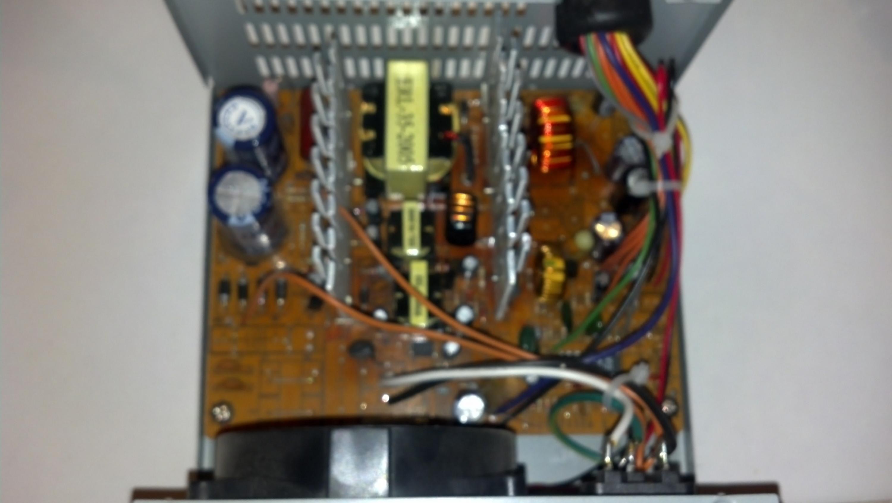

                                    Wait till I get more pics, the minimum load resistor on the 12V got so hot that the PCB next to it is almost black and all the color bands faded off! I have a junk Intel mobo here with bloated KZG caps and a Pentium D. I will load it up until it explodes

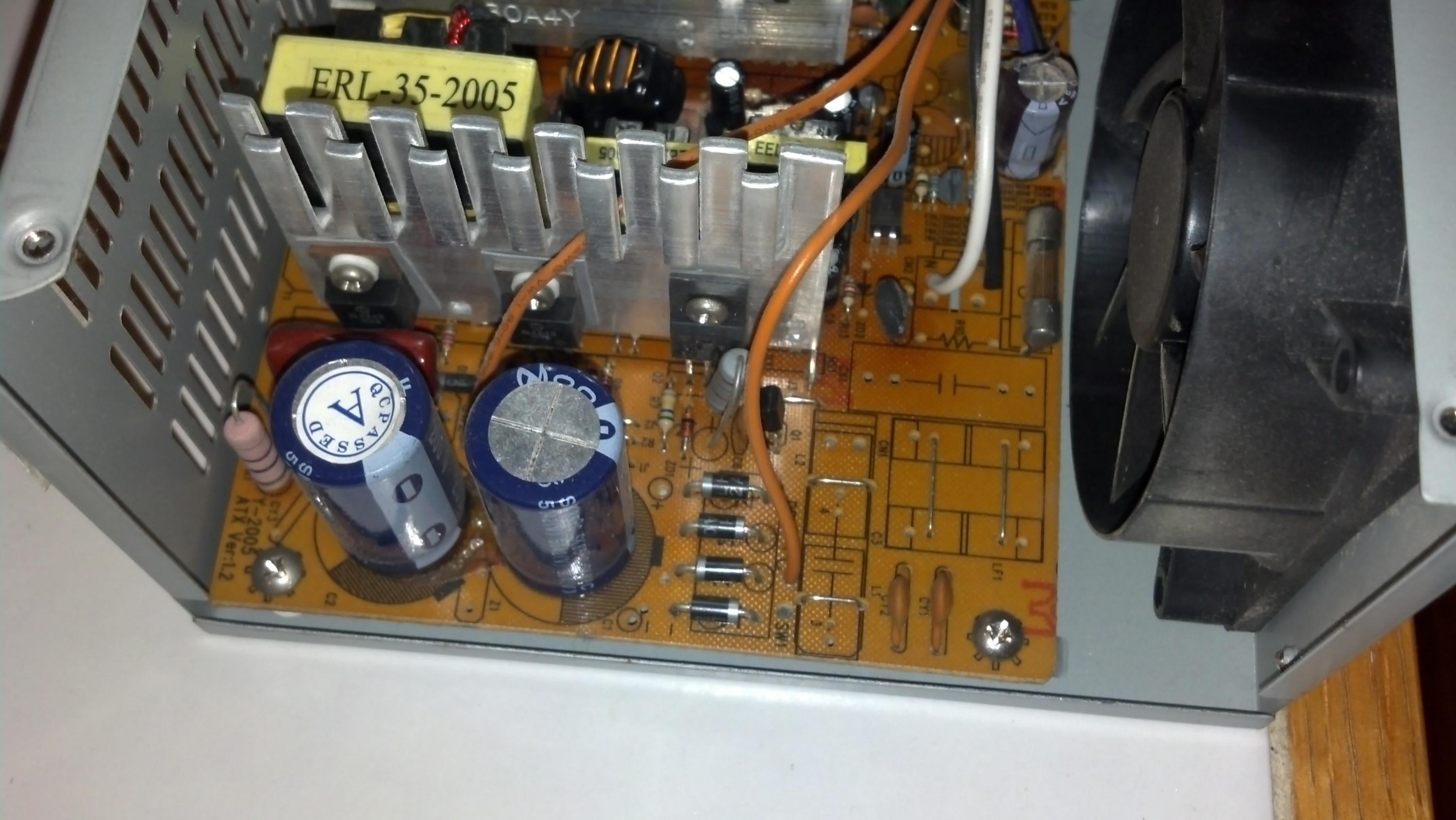

                                      Linkworld LPK2-30. I am somewhat surprised by this thing actually, but it still sucks. 470uF Fuhjyyu input caps. Really surprised to see a 6A bridge and 12A TO-247 switchers. What else is surprising, no fast recovery rectifiers, and the biggest one is on the 12V. 3.3V = 20A, 5V = 20A, 12V = 30A. And...it even has a good size inductor on the 12V, but a Fuhjyyu cap... Sleeve bearing fan wired straight to the 12V 5V minimum load resistor is burned up.
                                      I would consider recapping this and replacing the fan if the main transformer wasn't microscopic.
