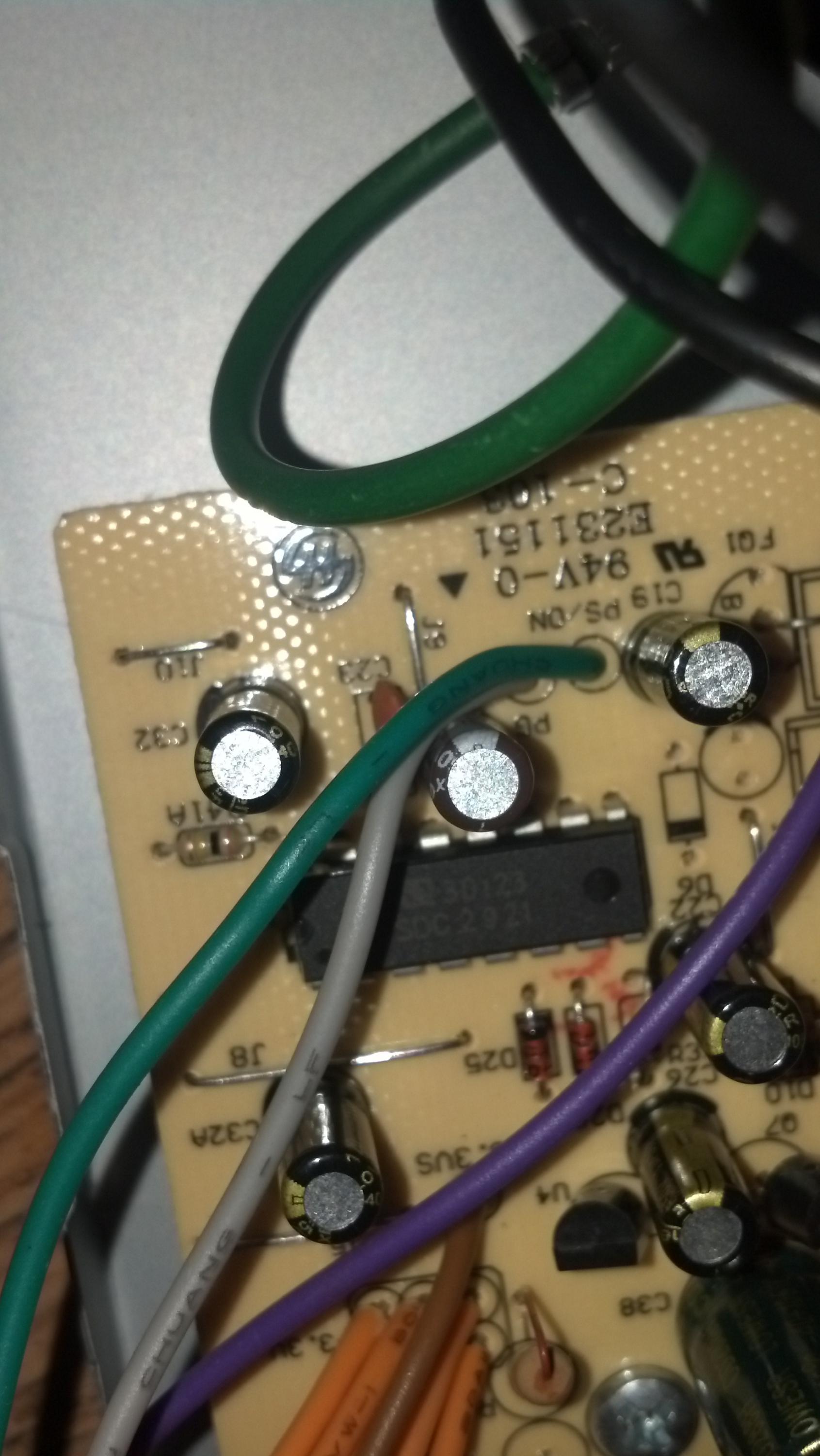

Looks very much like glue to me. They typically use glue on big capacitors and other large parts during assembly.
Many times a fault is not visually obvious. Capacitors can also dry out, causing the same failure but no visible signs. Only way to check for sure is with an ESR and capacitance meter.
 Mine actually look different though, I couldn't for the life of me get a good picture of them with my phone but this is the best pic I got
