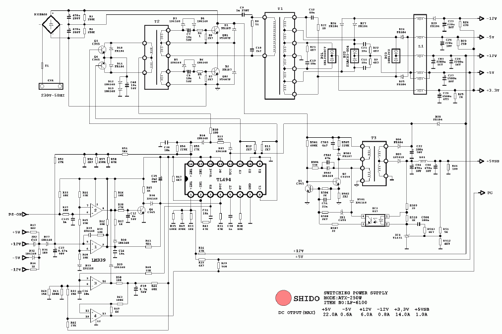

            #45
            Re: Tecnoware FAL501FS12 does not turn on
            Pin# 12 (vcc) is supplied by the standby transformer, Check the voltage on the driver transformer (arrowed) Also check the voltage on the two transistor bases.
            What is the number on the other ic in the secondary?
            Use the Secondary Ground to check all voltages on the secondary side (black probe on ground)
            This schematic might be close.

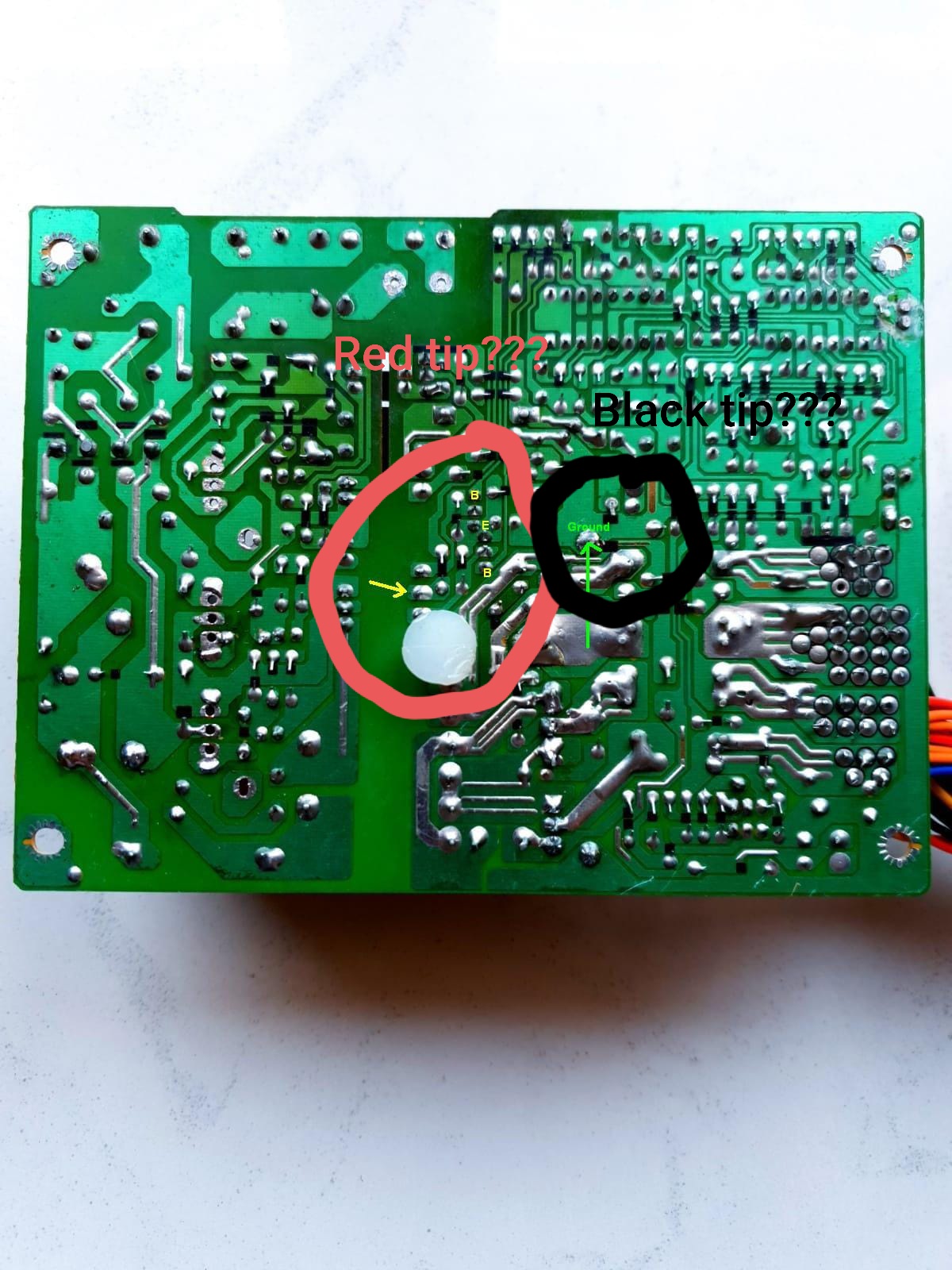

              #46
              ok, I have to put the black tip on the mass and test with the red one the points you have indicated to me? if I'm not mistaken the second ic is lm339n for safety in a while I look
                I don't understand what the secondary ground is

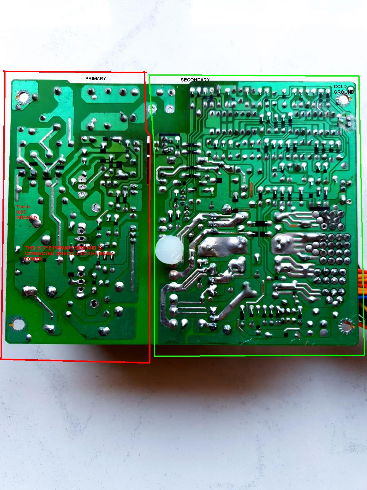

                  #48
                  You don't understand the difference between the primary side of the power supply and the secondary?
                  The primary side is connected to the mains high voltage and could be deadly if you don't know what you are doing.

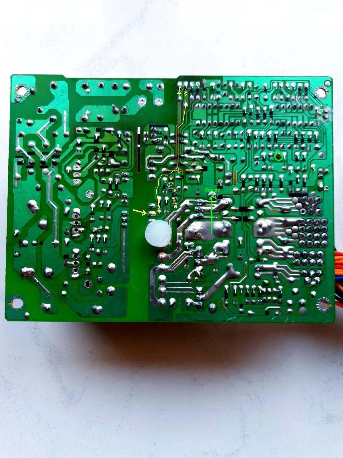

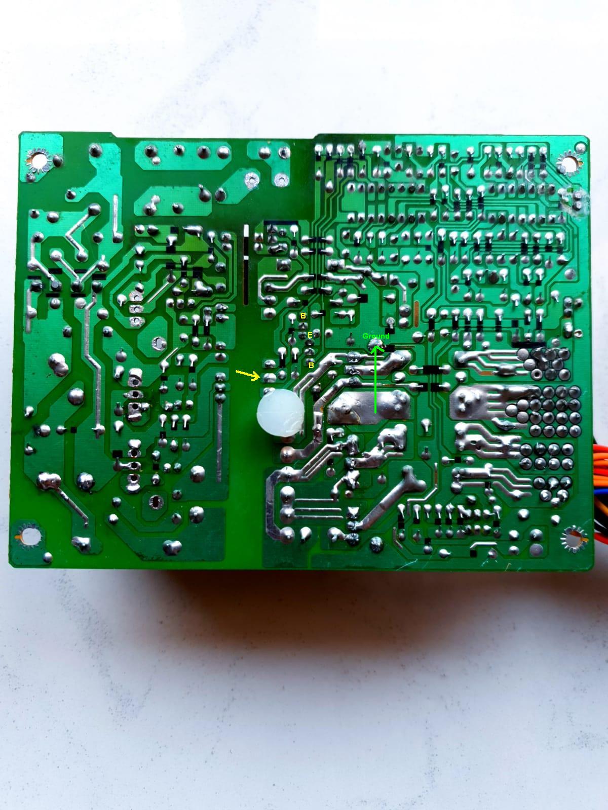

                      #50
                      See the picture

                        #51
                        Yes this is correct placement of the probes, The schematic in post#45 should be closer to your power supply

                            #53
                            Then with the power supply in standby the voltages are these
                            Driver transformer (yellow arrow) 1,50v
                            B 2.25v
                            E 1.50v
                            B 2,25v
                            With the power supply running
                            Driver Transformer (Yellow arrow) 1,85v
                            B 1.50v
                            E 1.47v
                            B 1.52v

                              #54
                              what should i check now?
                              • R_J
                                • Jun 2012
                                • 9532
                                #55
                                That voltage for the driver transformer (arrow) is low, look at the schematic (R12 2.7k) and follow the line on your board, it should have 16v on one side of that resistor. Also check the 2 transistors and the diodes connected to that drive transformer.

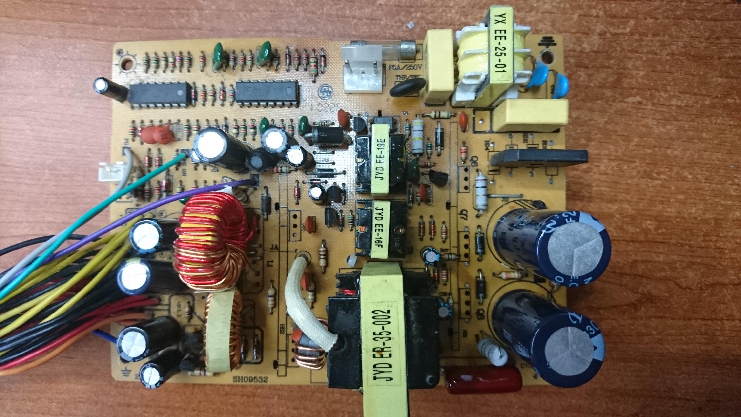

                                      #58
                                      Okay, now I'll send you a photo without heatsinks
                                      • falcontech
                                        • Oct 2013
                                        • 470
                                        • italy
                                        #59
                                        here she is
                                        to the eye it does not seem to me that there are open resistances
