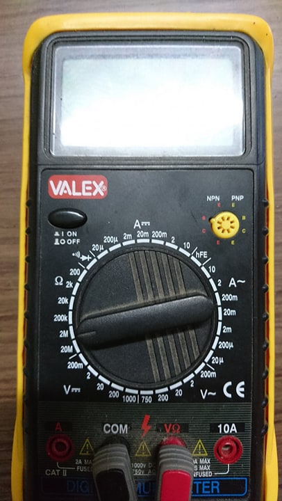

                            This is my multimeter, the only value I can see is when I put the knob on ohm 2m with everyone else it doesn't give me anything, I repeat one of the resistances signals me .216, the other with the same colors gives me 0 in all positions in ohms (naturally out of the circuit)

                              #34
                              Re: Tecnoware FAL501FS12 does not turn on
                              Are you saying that you have to measure everything with your DMM in the 2M Ohm position? The other Ohm settings don't work? If that's the case, you want to invest into a new DMM, maybe even a auto ranging one.
                              • falcontech
                                • Oct 2013
                                • 484
                                • italy
                                #35
                                yes it is exactly what I said, I have another one and that I believe is with the measurement of the ohms in automatic, but that also signals me. 216, so this measurement is wrong? what should the multimeter measure with that resistance?
                                • CapLeaker
                                  Leaking Member
                                  • Dec 2014
                                  • 8352
                                  #36
                                  216 what? ohms, k ohms, M ohms...
                                  just a 216 of something doesn't mean anything. When you measure Ohms, the power supply is off, correct? If you have the PSU on while doing measurements in Ohms, you get false readings.
                                  Find some resistors in different known values, like 100 ohm, 1 kOhm, 100kOhm, 1 MOhm etc and see if your DMM can read them correctly out of circuit. Also make sure the battery is good. Some meters don't show correct readings when the battery is almost dead.
                                  Reading components in circuit can be tricky as it depends on the circuit if a component can be read properly or not.
                                  So when you come across a component that has a questionable reading, always take it off the circuit and retest.

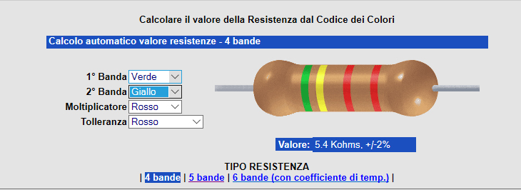

                                    Caps I have already done this verification, I have measured a resistance of 100 ohms and the tester gives me 99.8 so the tester works regularly, I have also made the verification with the tester which has automatic ohms and gives me the same measurement, on the display indicates me M ohm .216, I don't know what to tell you, tomorrow I will buy two based on the colors and see if the measurement changes, however with this online meter http: //www.associazionemarconi.com/calcolo/codice_resistenze_elettriche_4.html gives me 5, 4 Kohm
                                    • R_J
                                      • Jun 2012
                                      • 9633
                                      #38
                                      The resistor you are trying to measure the resistor (based on your picture) is likely 220KΩ 0.5% NOT 5.4K If one measures 216KΩ that is very close to the correct value, if the other one checks the same as the probes not touching anything, then that resistor is considered OPEN
                                        yes you are right, with that little program online I put the colors backwards sorry
                                        • falcontech
                                          • Oct 2013
                                          • 484
                                          • italy
                                          #40
                                          usually I adjust with the golden or silver band to understand the value but in this case I got confused
