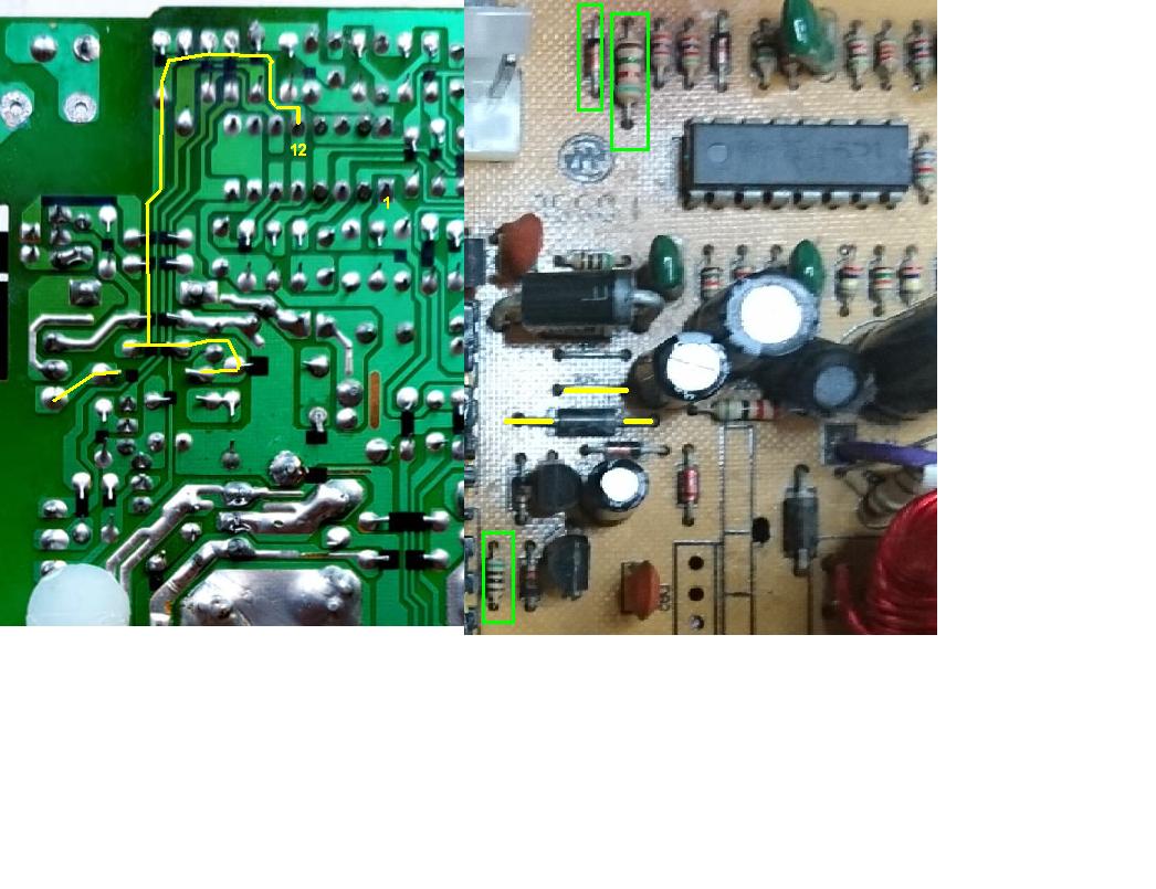

    can you tell me if this transistor can be problematic?

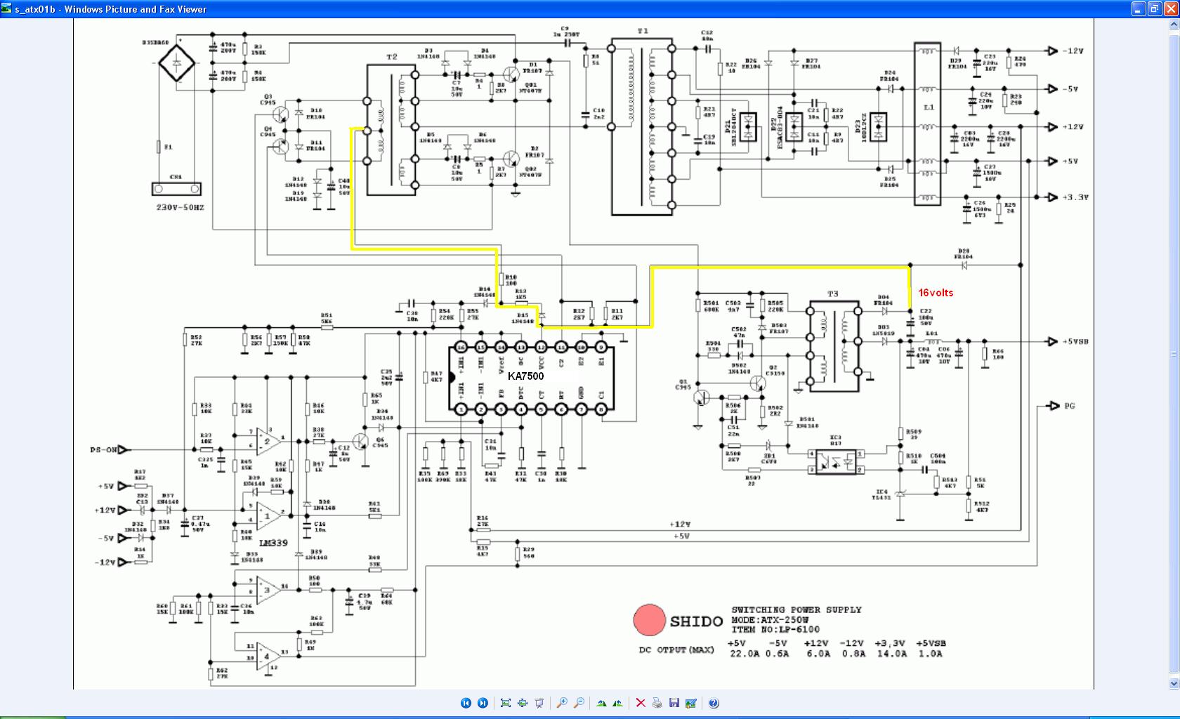

      I do not know if there is a problem with the transistors, If they were shorted they usually burn the 10Ω (next to the driver transformer) or the 1.5K (next to the small diode near the white plug and fuse)
      The KA7500 has vcc but also needs to be turned on, If it is turned on and working, it will output drive waveforms to the two small transistors connected to the T2, these small transistors drive T2 which drives the two primary transistors.

        Re: Tecnoware FAL501FS12 does not turn on
        so what do I do? of course I try to change them, if that is not the problem how do I proceed?

                Do you get any voltage on the +5 or +12 (even 1or2v) when you turn on the power supply?
                There is 16 volts on the KA7500 pin 12 which is good. There should also be part of that voltage (10~12v) going to the drive transformer, I traced the path so can you check the small diode next to the 1.5k and the 1.5k and the 100Ω (in green square) I also marked the schematic

                    Is there any other voltage on the KA7500? I know pin 12 has 16 volts but what about the other pins?

                          I only asked if there was a small amount of voltage on the 12 volt line to see if the power supply tried to start and maybe shut down. It is not that important now.
                          It is important to have voltage on the drive transformer. That voltage supplies the collectors of the two 2sc945.
                          On the KA7500, check pins 16 and 15

                                          maybe mark on the picture or schematic what you changed. Just by trying to catch up on this thread it makes my head spin!
