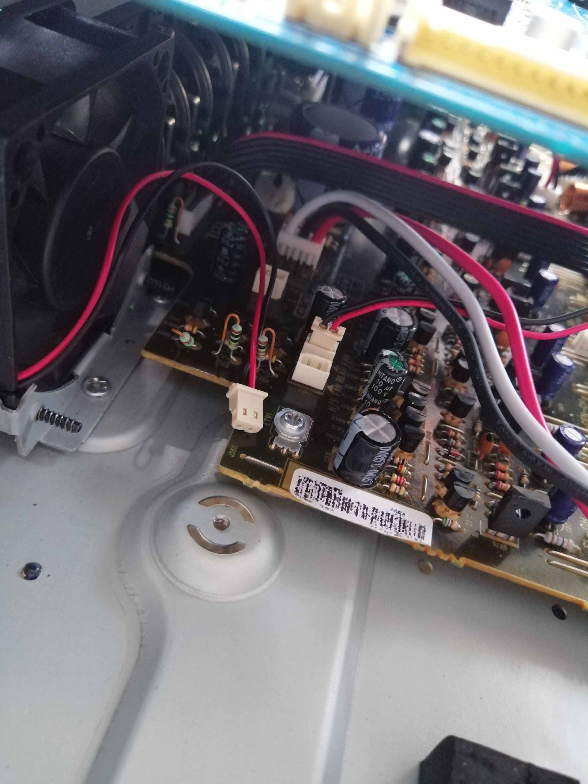

    Greetings!
    Thank you in advance for your understanding, I am writing to you through a translator.
    A Harman Kardon AVR171S amplifier was given.
    The history of the machine is as follows:
    It was faulty when I bought it, I want to fix it.
    I replaced the HDMI switch and one of the DAC ICs in it.
    After that it worked without a problem.
    I watched a movie using the amplifier, and at the end the amplifier got really hot.
    The cooling was faulty, I will fix this later.
    I switched it to standby mode, waited for it to cool down, then took it apart to fix the cooling.
    After that, the machine did not turn on.
    The standby LED lights up orange.
    It does not respond to the power button or remote control.
    Pressing the surround mode button for 5 seconds does not reset.
    The power supply only supplies standby 5V.
    The STM microcontroller starts, it is not in reset due to low supply voltage (by IC1503), the correct 3,3V is present.
    By visual inspection, there are no faulty, burnt parts or humped capacitors.
    On another forum, I was advised to check the voltage value of the POWER_DOWN pin, because the PC95 optocoupler may be faulty.
    I measured at the input of the optocoupler (PC95):
    AC 0,75-0,82V; DC 0,38-0,45V
    On pin 15 (POWER_DOWN) of connector BN65:
    AC 2,47V; DC 0,56V
    I think here that the DC 0,56V is low for the processor, that's why it won't turn on.
    Voltages measured on some legs of the controller:
    1. PROTECT: DC 3,32V
    2. POWER_FAIL: DC 3,32V
    3. POWER_DOWN: DC 1,89V
    Do you think the optocoupler is faulty and that is why the device does not turn on?
    Is it because the amplifier does not turn on because it does not detect the correct input mains voltage?
    Does anyone have an idea where I should look for the error?
    (Unfortunately, I don't have an oscilloscope, but if you ask for a measurement, I will do it with my multimeter and report back with the results.)
    I trust your experience,
    I really want to use the amplifier.
    I have attached the service manual.
    Thank you, Thomas

      Re: Harman Kardon AVR 171S - standby led lights up, does not turn on
      The temperature sensor was mounted on the power supply (on the 12V voltage stabilizer) instead of the heat sink of the amplifier transistors.
      Someone tried to fix the amplifier before me, I wasn't the first.
      If that doesn't help, I'll install a fan controller (https://www.aliexpress.com/item/1005004752252602.html) for proper cooling.
      They have worked great for my computers, it will be good here too if the built-in controller is faulty...
              No, the amplifier has 2 wired fans.
              On the ali' control panel, the fan pwm leg is connected with the input connector pwm pin, it is not used to speed control.
              Or what are you thinking?
                      Well.
                      I measured the digital PCB.
                      And it's the worst.
                      The microcontroller have shorted.
                      How to replace that, I really don't have idea.
                      Okay, the IC is available, but the program. . .
                          Where can you short circuit? Anywhere.
                          Any capacitor, any resistor, IC or transistor can go into short circuit.
                          I found it by unsoldering the components one by one, measuring, unsoldering, measuring... in the end there was nothing between the +3.3VC and the GND line, only the controller.
                          Of course, it is worth searching for each part and island.
                          There is the injection method, but I haven't tried it yet.
                          With this method, the short-circuited component can be heated within the circuit,
                          and it can be determined from the rate of alcohol evaporation or found with a thermal camera.

                                • Bjurstrom
                                  • Aug 2023
                                  • Norway
                                  Hi Everybody .
                                  i got a AVR 171S for free yesterday , "same" symptom as you describe . Standby light is on , when i power it on , white light for aprox 10 sec, no text in display and then back to orange.
                                  Put it straight on my bench and popped the hood , a strange hissing sound from the SMPS , started meassuring the voltage lines and soon found out 12 V + was missing .
                                  Regulator IC97 (7812A ) ok , but the smoothing capacitor C 933 was all dried out . Replaced cap , unit is up and trunning :-)
                                  Hope this helps someone :-)
