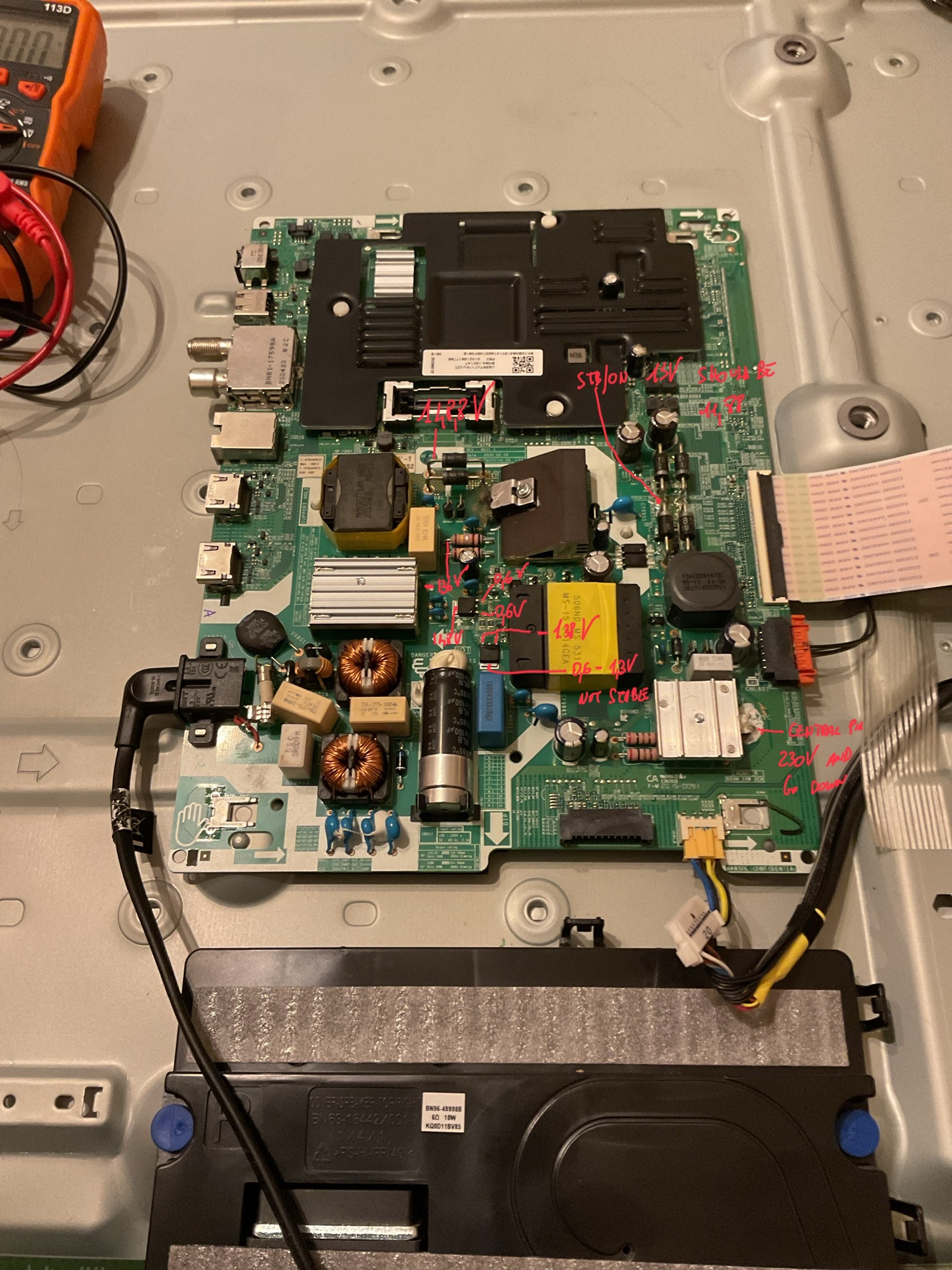

    Hi guys, I’m back here my friend give me her tv, that doesn’t turn on and no standby red led. When u plug in the cord the red led of one two second is on, then turn off. If you push the power button or the remote the red led blinks but nothing happen. I give u some photo with voltage, don’t look the fuse….because I blow it for mistake nd I dint have the right replace so I just put it for test the tv. The standby voltage should be 11,88 volt on the diode, but I have 13 volts. I put in the photo the different volts I test and there are someone negative…I don’t know if it s normal. On the led the voltage is not stable start around 240 and drops, this happen if the led are plug in in the main board or also if plug off…someone can help me? Thanks for all

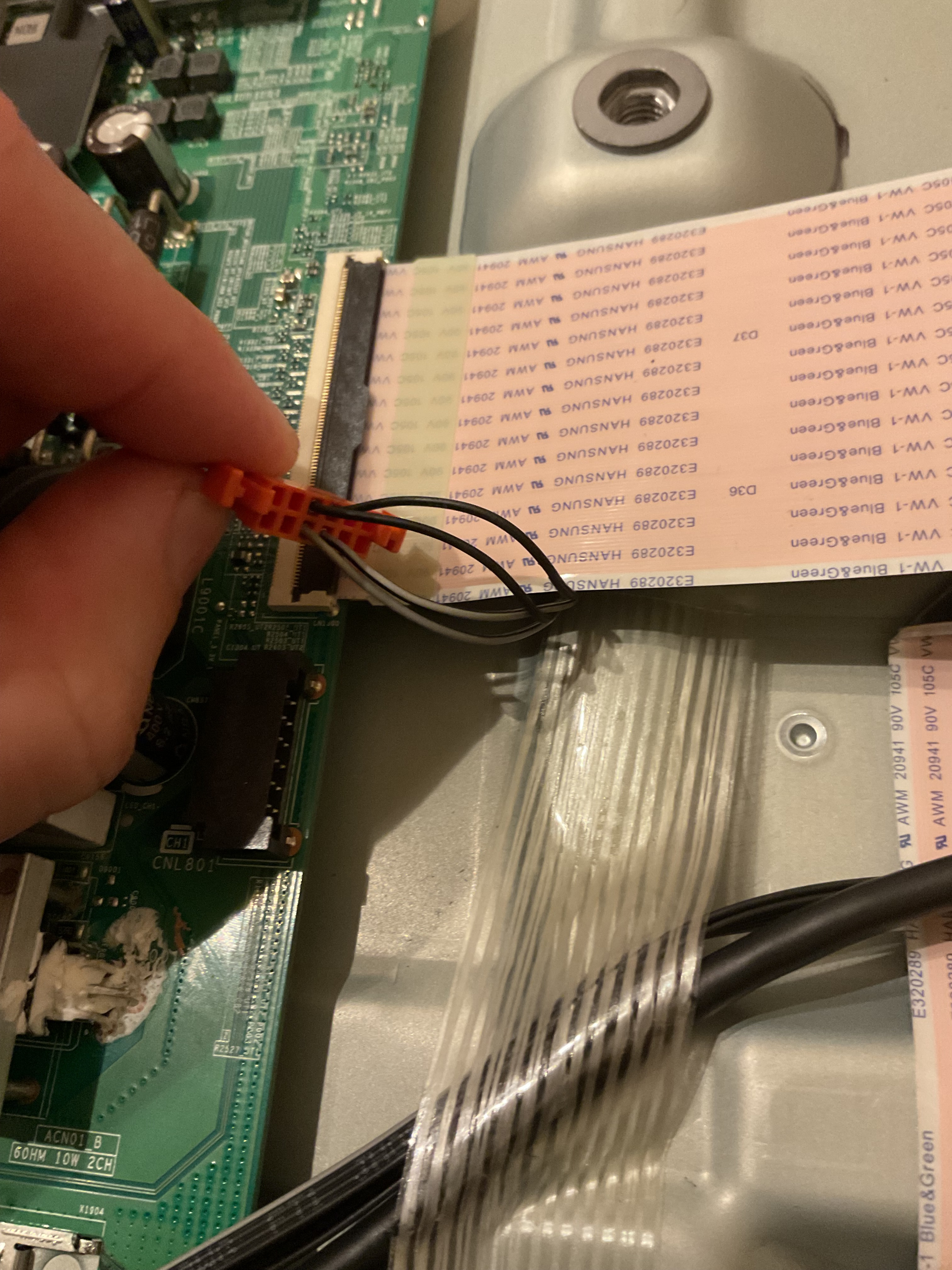

        Test the Backlights with a Backlight Tester.

          Thanks for your answer the connector has 4 wires, under a grey and a black grey, upper two black. Do u know what is the positive and the negative?

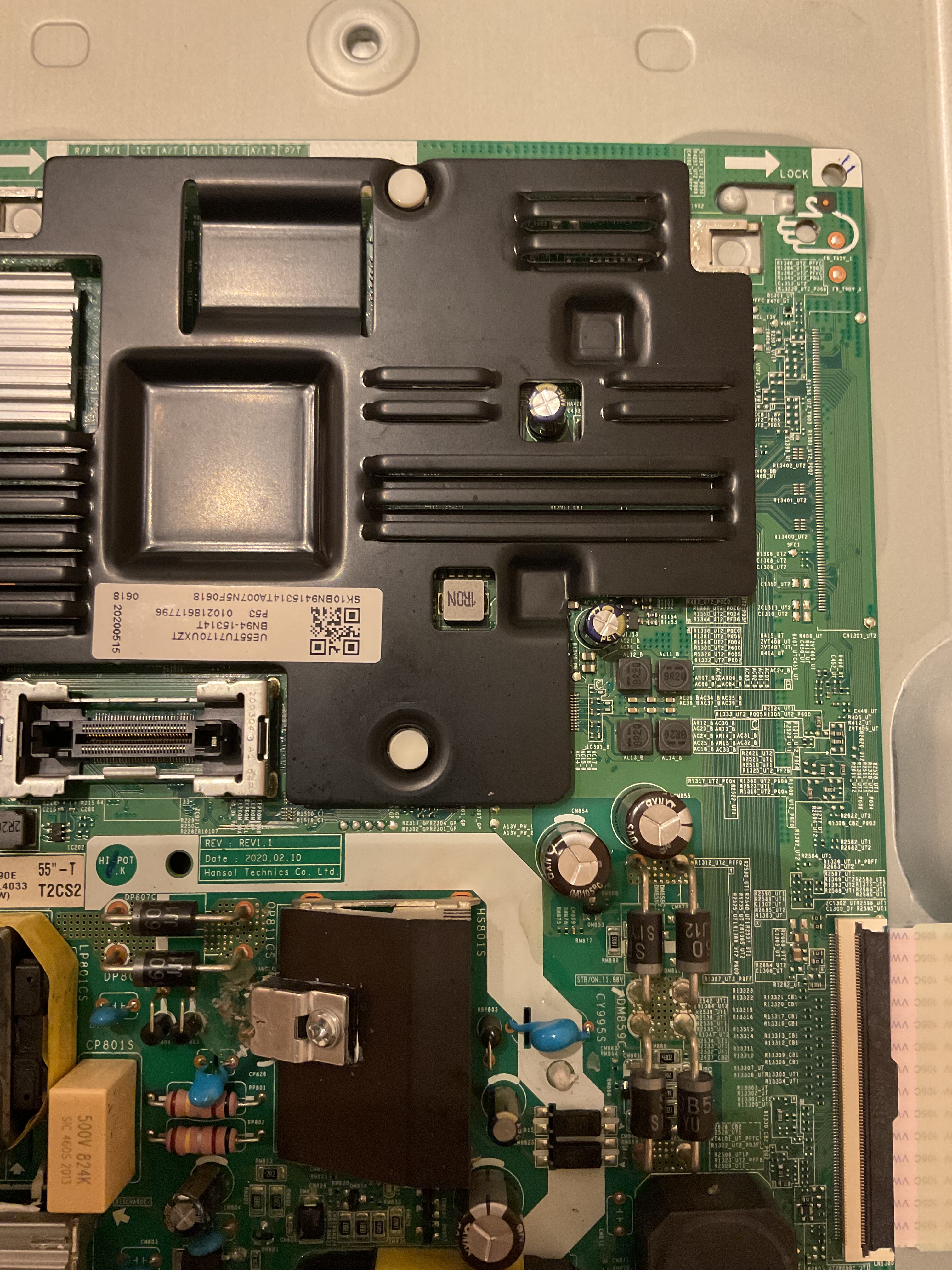

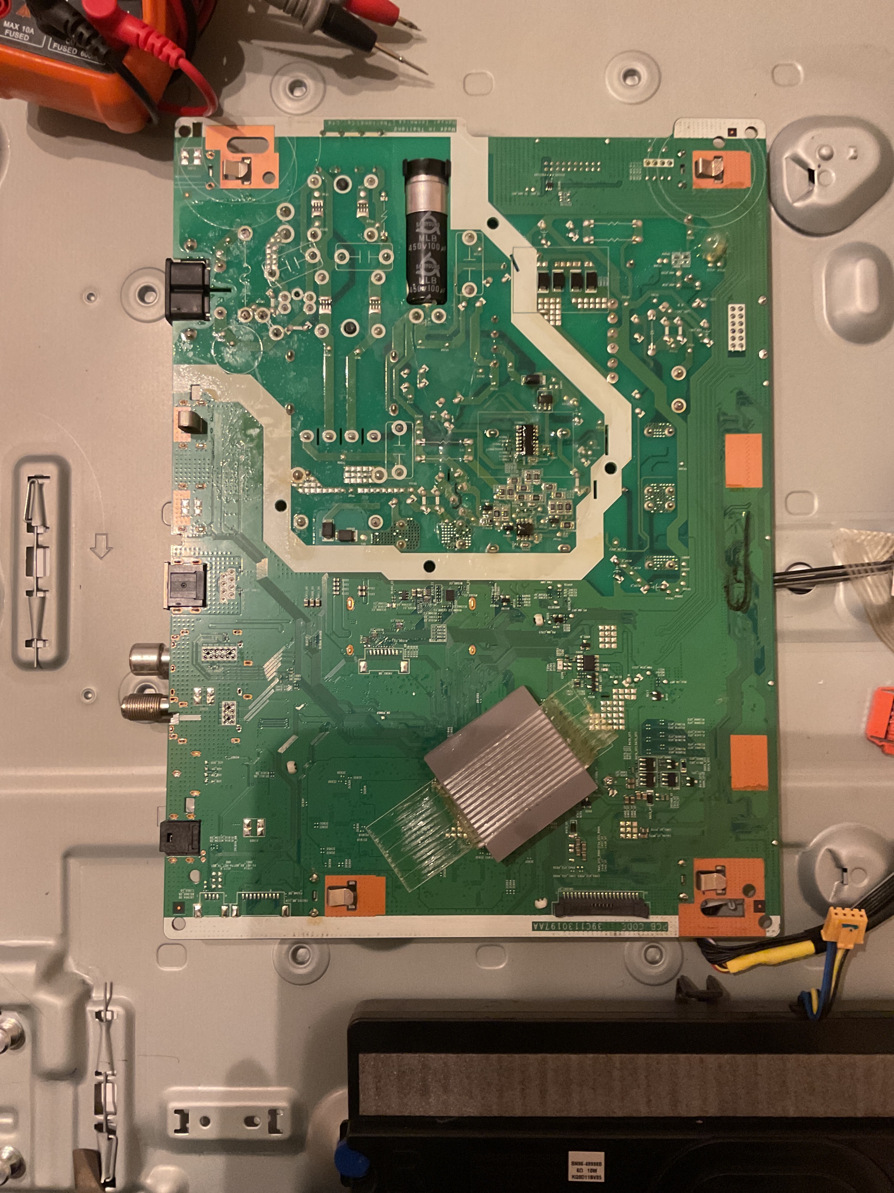

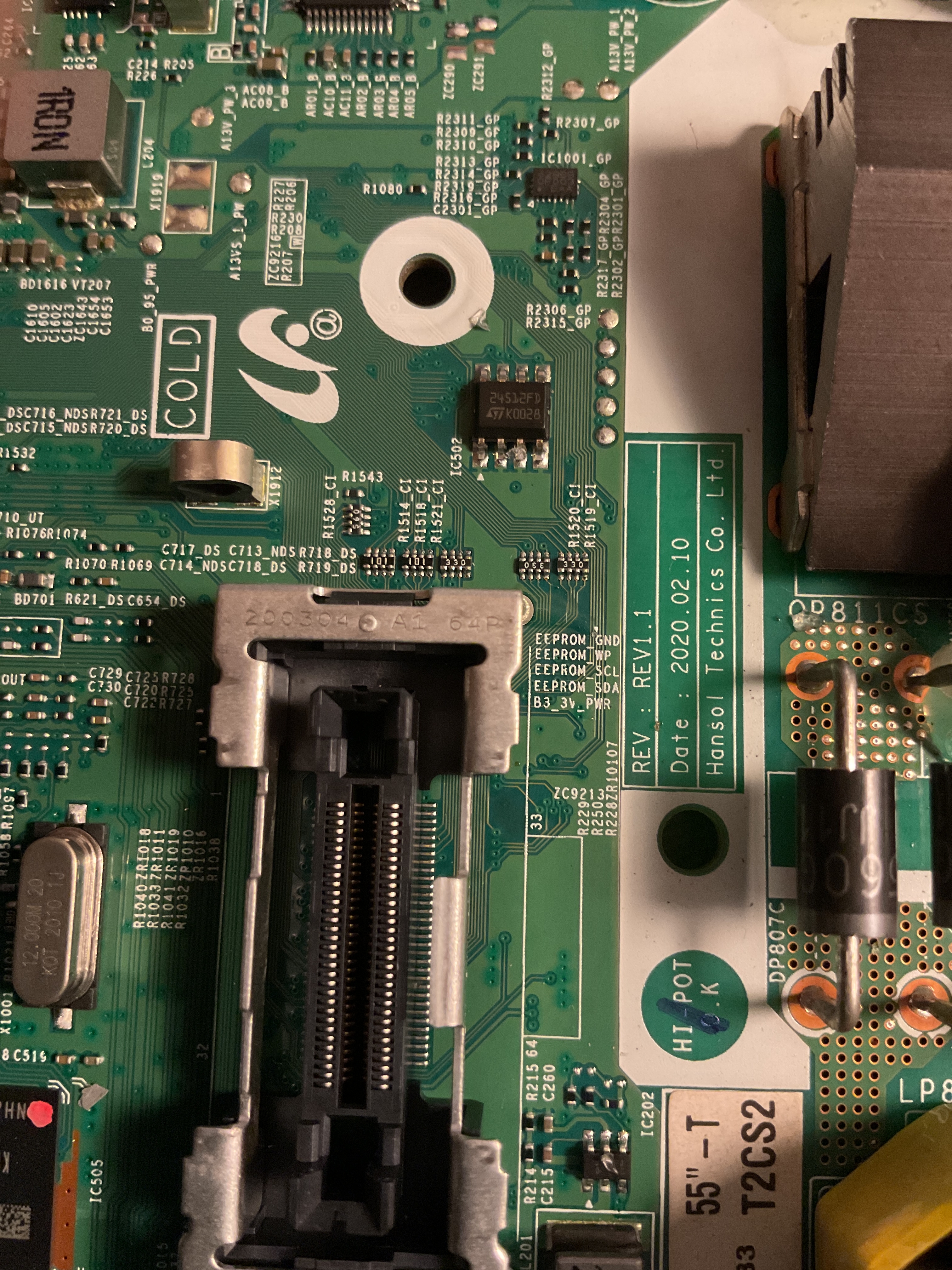

            Hi guy im back after change the back light of the tv but still the tv doesn’t turn on.
            the model of tv is ue55tu7170u, i put one photo of the main board. When i plug in the cord of tv, the standby led turn on for a second then all is black, no back light no standby led nothing. If I press the buttons on the remote I see the standby led flashes but nothing happen. I put some voltage I have, the standby voltage on the main board should be 11,8 volts but I have 13,1 volts not sure it s ok. And in some coil I have the 3,e volt stable, the 5 volt stable, on some diode I have 0,8 to 1,3 volts that is not stable always change. And the back light start with 250 volts but goes down…someone can help me it s a board problem or I need to flash the eprom I really need your help thanks

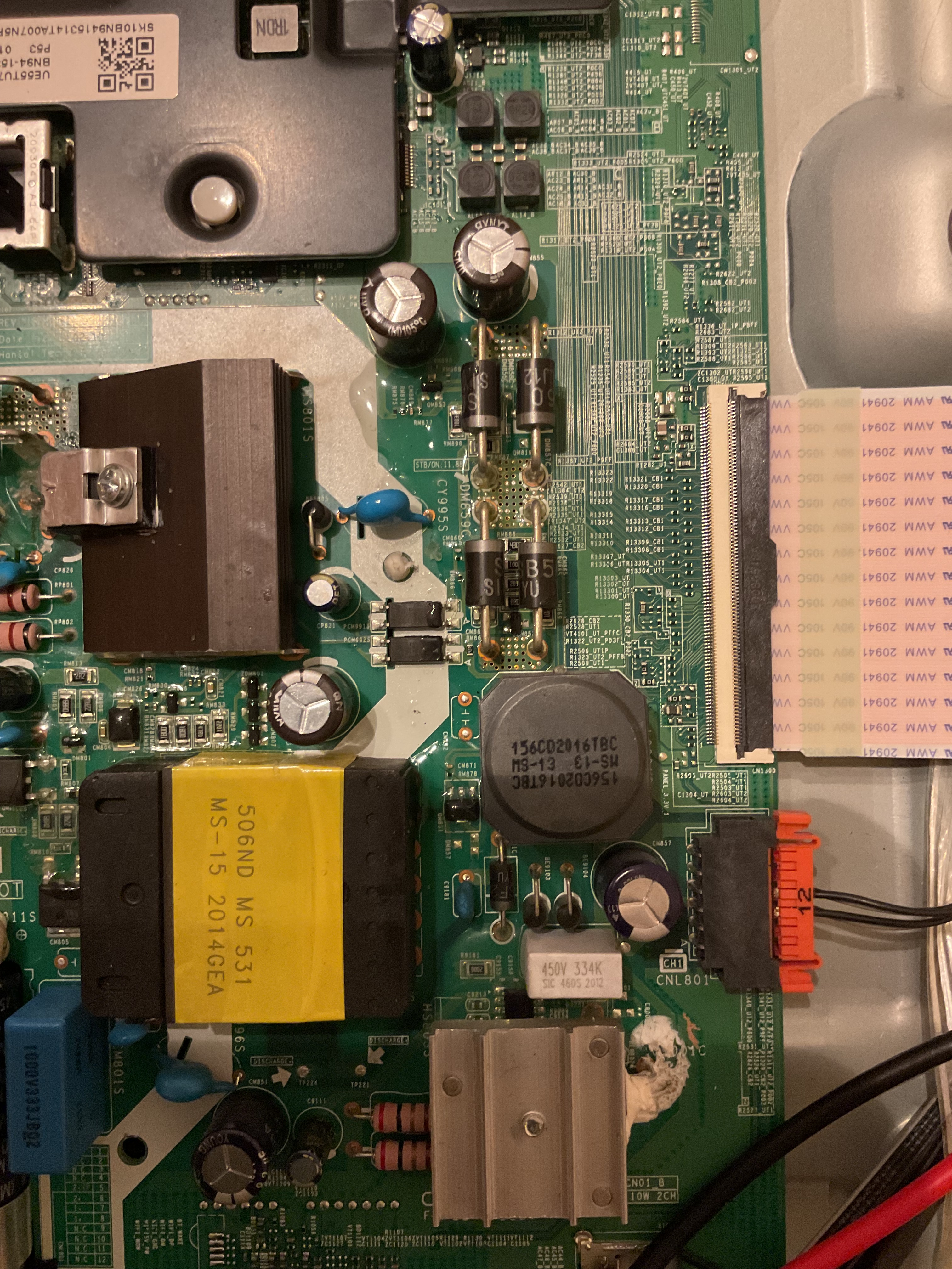

              I forget to put the photos sorry
              • PNI E.
                • Nov 2024
                • 101
                • Italy
                The eprom should be ic502 and code 24512f that should be a m24512 eprom.
                  It contains all the settings of your TV, regions, serial numbers, MAC address....​

                      It is better to unsolder this chip (eeprom) and save its data (dump), so that later you can experiment and if anything return everything back, it is useless to look at this dump, since it is individual in each TV, you just need to throw in the firmware from the same working TV for diagnostics...
                      Try connecting via terminal via UART and see what the log outputs.
                        and you have the dump for this model? where can i find?

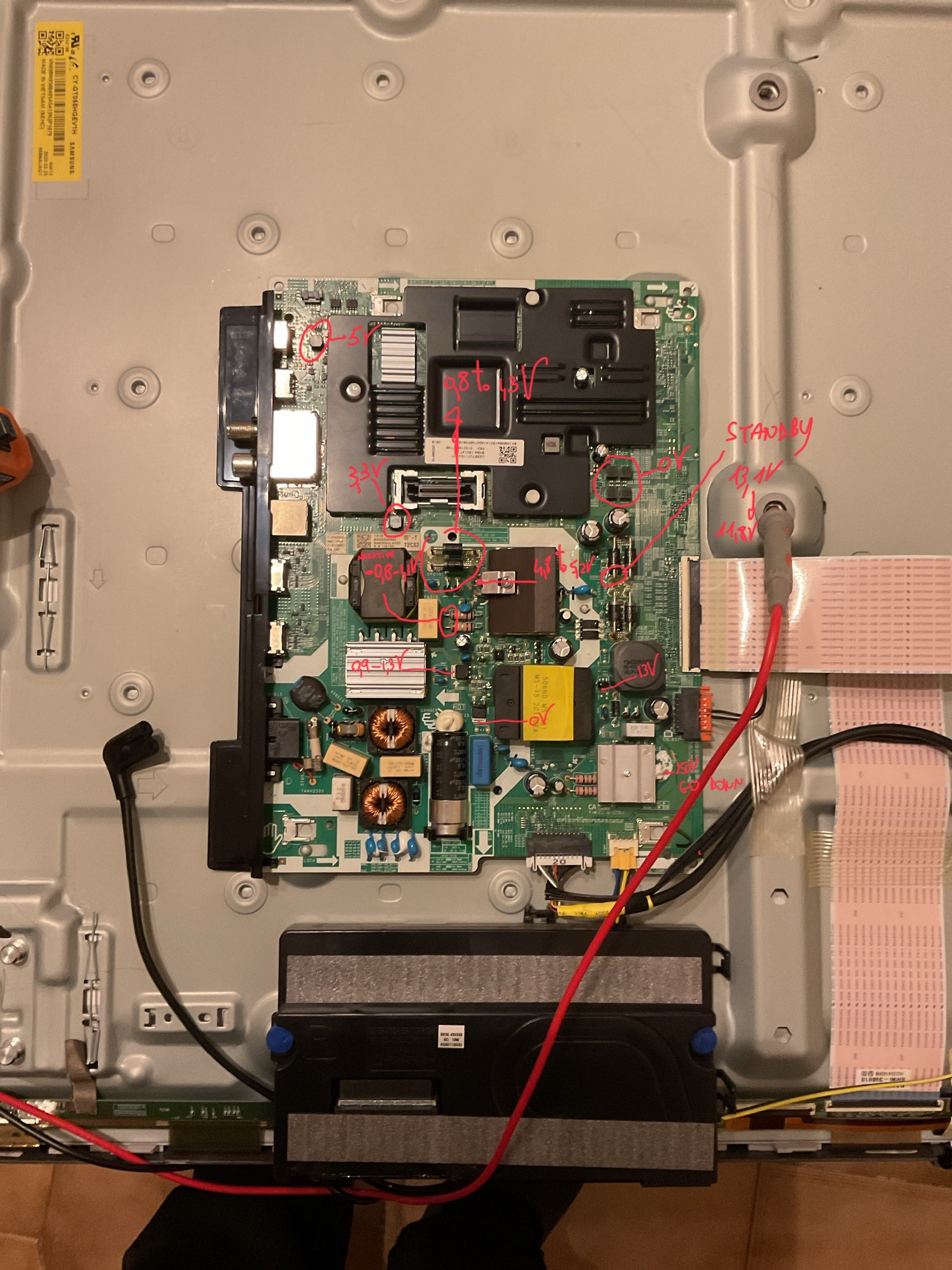

                          How does the TV behave with the FB_TRDY_1 and FB_TRDY_3 jumpers installed and the LVDS cables disconnected?
                            thanks, for help me.
                            i tried to turn on the tv with the ldvs cable off, but nothing changed. So I tried with Ldvs plug in, but with the buffer board disconnected first the right side but nothing changed, then the left side I could not disconnected because there arrive the ldvs, so I try to cover the pins with the tape but nothing changed. The tv when you plug the cord for a second the standby led turn on, then disappear. So the tv look like all death no back light no sound nothing, but if u press the button on the tv or the remote control u see the led flashing until u press it and then stop. Honestly I didn’t jump the the fb.
                            but I desolder the eprom and red with neopragrammer and ch341. I went to search ic, and select i2c and then st. Here I have two option m24m01 and m24m02 honestly I tried with both the types, and I have all blank chip. So or I’m wrong something or the ic is empty. But maybe I wrong, I read your posts here and u talk about a modification on the ch314 black.
                            i try to make the jump and I say u what happen. Thanks for your support

                              Select I2C - "Generic" - _24C512 (3.3v)
                                I did but nothing change, all is 00, I give u the photo of the first page and the last, but they are all the same….
                                  You didn't answer anything about the jumper...
                                    This is how it should be, the data is here and is in the middle of the dump.
                                      This is how it should be, the data is here and is in the middle of the dump.​
                                      Sorry I make now the jumper but nothing changed, do I have to check some voltage?
                                        24_512_IC502
                                        your dump inside have some letters symbol etc...mine is al point like this ........................... in all the dump you have only .................... these points
