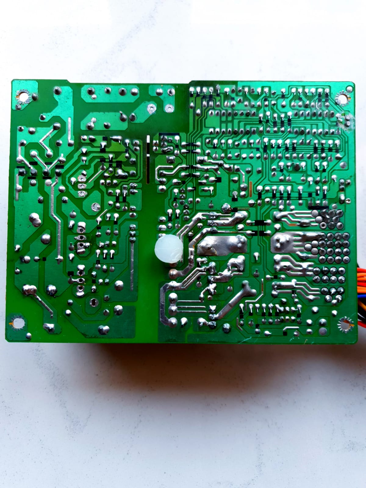

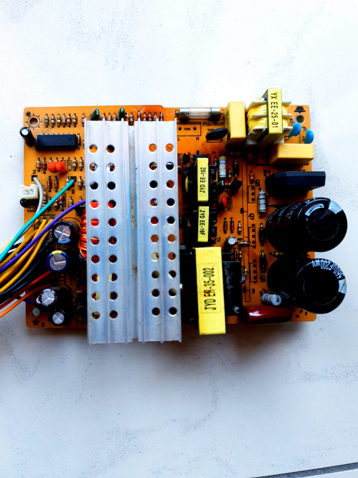

    Hi everyone I would like to repair my power supply that does not turn on, it is a FAL501FS12 tecnoware, I have already done some testing, on the primary the mosfets are good, same thing on the secondary, there are 5 standby volts, I have replaced a capacitor swollen on the secondary, I noticed that the large capacitors on the primary do not give me the same voltage, both with the power supply in standby and with the power supply turned on, the capacitors are from 560uf 200v, measuring them one from 210v (both in standby and on) a 99V one (both on standby and on) if you need the photos I can attach them, I wait for someone to help me thanks

    Pictures are always helpful, as it helps people to see what we are dealing with. So please post them.
    As I mentioned in the other Tecnoware FAL501FS12 thread (copy-pasta'd from there)...
    Since you are in Italy and you have 230V AC line voltage, the total *DC* voltage across the two big capacitors should be about 230 x 1.41421 = 325V DC. Thus, each cap should have about 160-170V DC across it, with or without the PSU turned On.
    You appear to have unbalanced voltage across the primary caps. Please check again to verify. If that is the case, those primary caps may be bad.

                              • falcontech
                                • Oct 2013
                                • 470
                                • italy
                                Re: Tecnoware FAL501FS12 does not turn on
                                They are the pictures let me understand what are the resistances to check, so I also replace the rectifier bridge thanks
                                • CapLeaker
                                  Leaking Member
                                  • Dec 2014
                                  • 8212
                                  the big 200V capacitor next to the bridge rectifier looks bloated to me.
                                    it's one of the old ones, but it's working I tried it on another power supply, however even with the new ones it does the same problem, now I try to change the bridge
