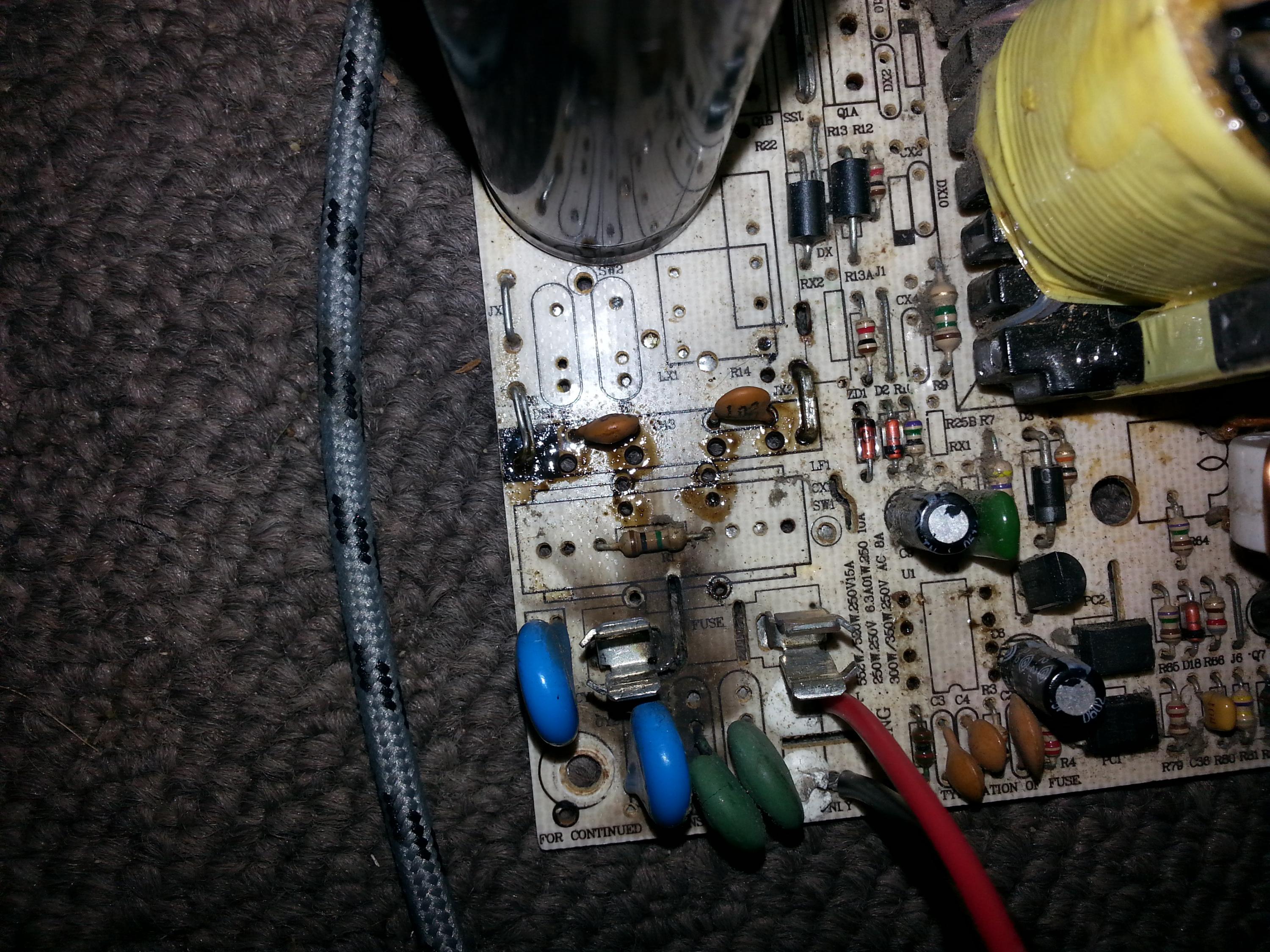

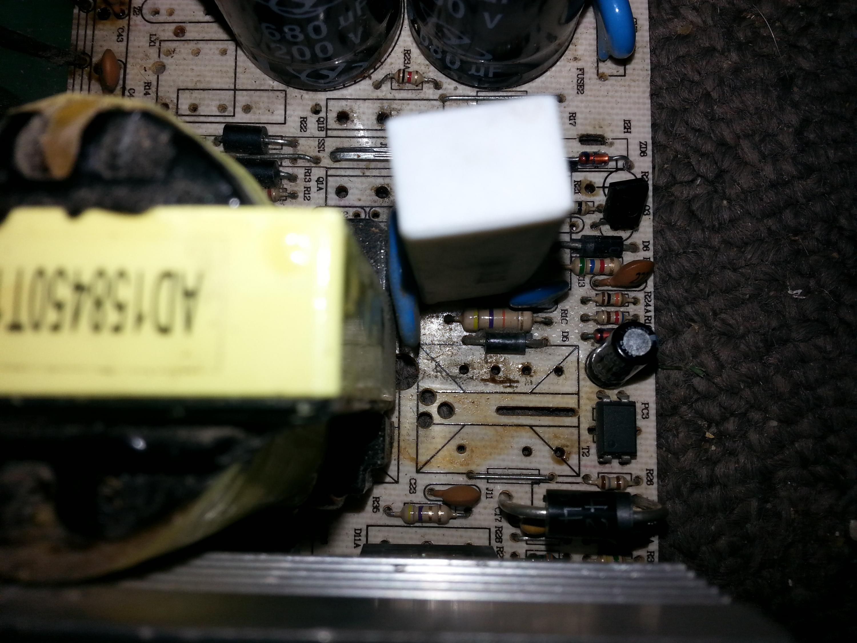

    I'm pretty sure that i've removed all the components that i just put back on.
    Have included a photo, just in case you can spot any that i've missed, or should have removed
    But the bulb is still glowing.
    So i tested the AC and CD sides separately at the rectifier circuit board holes, and noticed that 1MΩ again that i previously couldn't find (so it wasn't due to my body resistance, although coincidentally that what it roughly measured while holding onto the test leads normally) it was hidden under the X capacitor. So the AC side looks normal, and i've put the capacitor and coil back on.
    And there is no short on the DC side.
    I thought that the 1MΩ might not be due to a resistor, because i didn't see it on a schematic that i was looking at (attached below) - but it obviously does (and shouldn't there be one of these in the schematic?)
    What's the function of that resistor, as i'm picking that it's not a discharge resistor for the primary capacitors, as it looks like R1 and R2 in the schematic would do that job.
    And as any short arising (which neither of my meters is showing) across the DC side, looking at the the schematic, could something be going on with those two transistors that is causing a short when the power is switched on? (assuming that my PSU is similar enough to that - hey, it's got two BJT transistors on the primary, and has an LM339, which looks like it's for the 5VSB)

      Hmm. So bulb is still glowing even with the new bridge rectifier removed?
      Looking at the first picture, I see two more components that may be playing tricks on us: those orange "102" ceramic caps by the bridge rectifier (C43 and...?) Remove them permanently and don't put them back on. They aren't really needed.
      I also see that there is a lot of black sooth under where the fuse was and the area nearby. You might want to scrape/clean that with some IPA, as the sooth can be conductive.
      And while looking there, I see that one of the green disc components next to the fuse holder (looks like two NTC thermistors) has a crack in it. Check and maybe also post part number here, just to confirm what it is.
      Lastly, I see a small blue ceramic cap (not the large one) next to the big white resistor in the 5VSB circuit, is still installed. If I recall, that cap is part of the snubber on the 5VSB. Remove it as well.
      The 1 MOhm resistor is there to discharge the X2 cap(s) on the AC side. Otherwise, if you disconnect the PSU from the wall and it so happens that you do this while the AC line voltage is at its highest peak, the X2 caps will be fully charged... or at least until the big electrolytic caps on the DC side start discharging, after which point, the small charge stored in the X2 caps will flow through the bridge rectifier and discharge the X2 cap. But if the above happens, there could be a period of possibly several second where if you touch the metal prongs on the PSU plug after unplugging it, you might get a slight shock. Also, the 1 MOhm resistor is there to provide a current path in case the AC is suddenly disconnected and there is still a current flowing through the common-mode chokes. Inductors don't like sudden interruptions in current, so they always need to be provided a safe path in case of sudden disconnection. The 1 MOhm resistor provides a function for that as well.

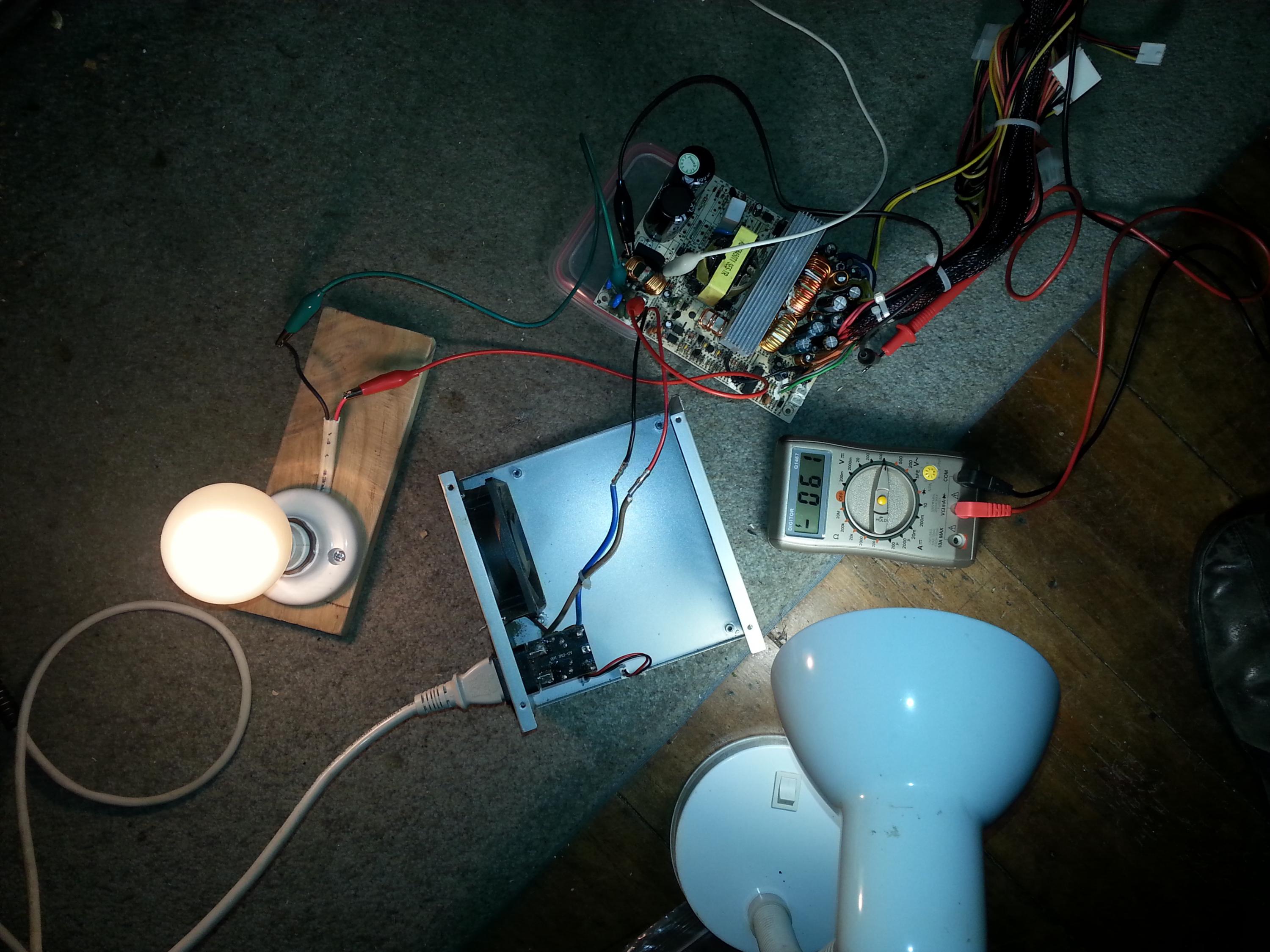

        So i've removed those other components and got rid of the sooth (i thought that that may have being burn marks into the board from so much soldering/heat, because it wouldn't come off with isopropyl alcohol and a cotton bud - so as you suggested, i went over the board scratching it off with the test probes (perfect for the job!) - it came off like crusty flakes.
        But the 60W bulb still comes on as seen in the photo below:

            Took off the white resistor - Bulb still continiously Glowed.
            Removed the rectifier and put it in a good PSU, and it goes well - bulb briefly lights
            then dims out in about a second, in line with the primary caps charging up.
            And the fan starts up when i jump-start it
            So it really looks like the rectifier is not the problem

              So did you try measuring the voltage across the two big caps when the PSU is plugged in and the bulb glowing?
              No, but I do have a 16V 4.5A laptop adapter though.
              Yes, that will be fine. Let's see what results you get above for the voltage across each cap, though. Then we will see where to go from there.
                No - but i have just measured it now.
                Across the +ve of one cap and the -ve of the other cap, as soon as the switch is flicked there 55-60V DC and then it quickly goes to 40V, and over the course of about a minute it drops in (roughly) exponential decay towards 21V (by then it's falling at a slow rate of 0.01V/s)
                Just across the outer cap there is an initial voltage of 19V that instantly drops to 13V and then, in the same fashion as above, falls to 12.6V after about a minute
                And ditto across the inner cap 30V > 22V > 10.4V

                  That's a very strange result.
                  It looks almost as if there is some active device somewhere pulling the voltage down to that level. Still, I assume this is with all primary transistors removed, so this shouldn't be happening.
                  Is your bridge rectifier installed correctly? - i.e. + and - polarity going properly to the big caps? With no primary transistors and no 5VSB transformer, there should be no current path to conduct across the two big caps. Keep removing components until you get somewhere. Clearly there must be something that we're missing that I can't seem to see in the pictures.
                  Once you get a result after removing/re-installing something, repeat once or twice more to confirm which component or part is causing the change in symptoms. In other words, we need repeatability. If you remove a component and the circuit stops (or starts) doing something new, then re-inserting same component should restore back old behavior. If not, check everything that you're doing to make sure you're not introducing an error somehow.

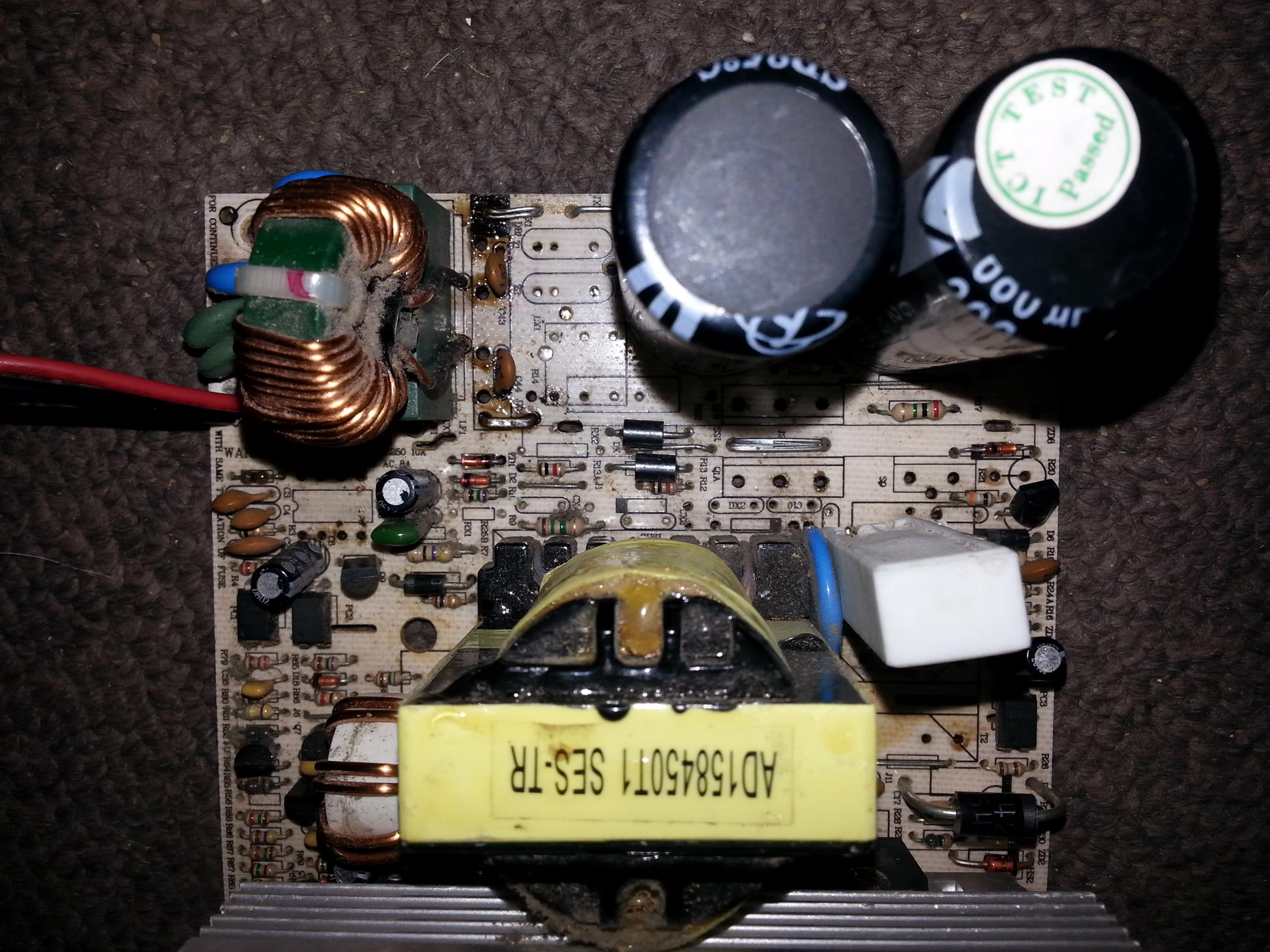

                    Which two transistors? I thought all the ones on the primary side are gone.
                    There is two small BJT transistors (but ignore that, because i figured out that i have no idea what they are for)
                    Yes.
                    There is obviously a short, or low resistance happening somewhere, so why can't i find the it using the multimeter? - that would make this a lot easier.
                    I get 1Mohm ohm across the AC legs of the installed rectifier (that 1Mohm resistor) which makes sense, and across the DC legs i initially get 30Mohms that falls to 9Mohms over the course of a few minutes and keeps falling. Does that sound normal? (shouldn't there initially be low resistance and then it be rising as the primarys slowly charge up?)

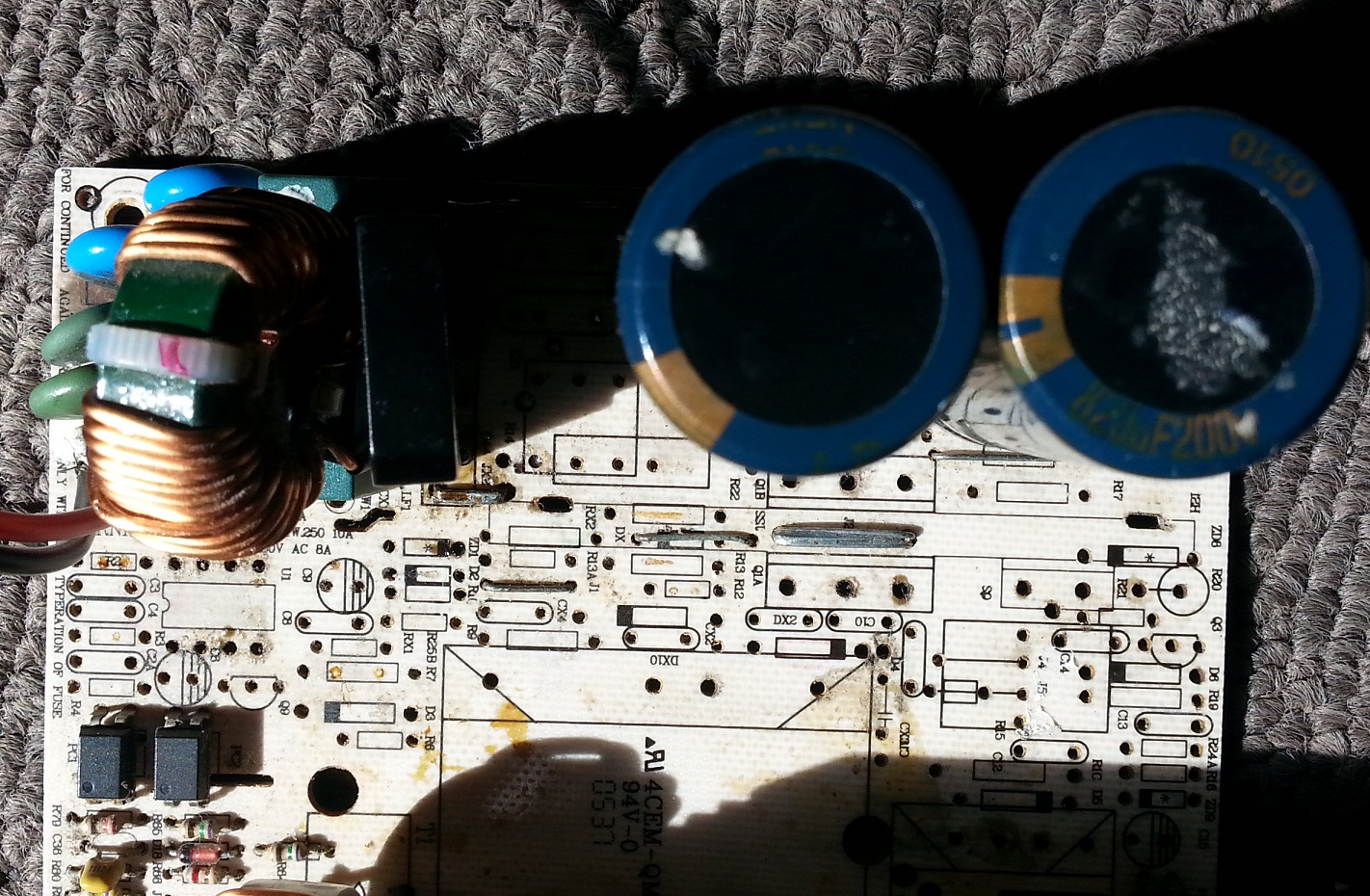

                    What's the odds that the replacement primary caps are bad (or were destroyed after fitting them and turning it on), as well as the original ones?
                    I just removed one of the primary caps, and the bulb didn't glow.
                    Then put it back in, and then the bulb glows.
                    Swapped it for one of the original ones and the bulb glows
                    Swapped the other one with the original (so that both of the original ones were back in), and the bulb glows.
                    I measured the original caps with the ESR meter and got readings of 0.037 and 0.041 ohms
                      Well, if they are on the primary, then I guess it doesn't hurt to remove them too, just in case (though I don't see how they can make the bulb glow when they are not connected in any way that will allow so much current to pass through them.)
                      Yes.
                      Multimeter only measures DC resistance and based on a low-voltage test.

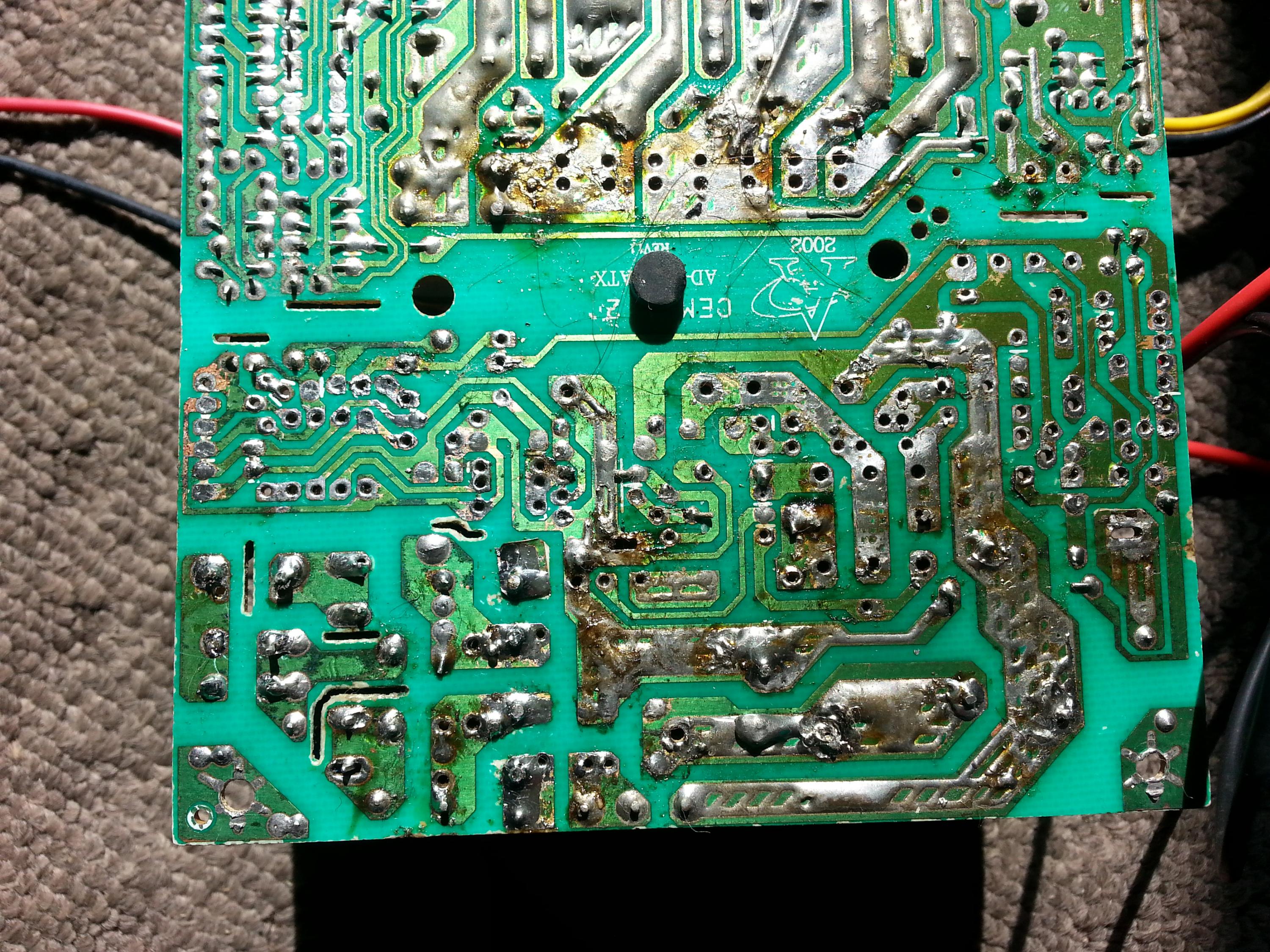

                          Well i removed all of the components, two at a time, that were connected to the DC legs of the rectifier, and the bulb still glowed, so then i removed the green NTC thermistors that were noted earlier, and the bulb didn't glow.
                          The one that is cracked, (and a chunk of it fell off of it when removing it) measured 42 ohms and the other one 9 ohms - according to the datasheet it seems that they should be in the Mohms range, so they were shorting out the AC input - that's why i couldn't find the short, because i was testing further into the circuit.
                          Maybe you meant "test" when you said "check"?
                          The board is a mess now, with traces lifted in several spots, courtesy of my 'practising' on it, and have lost that big resistor, so there is no way that i would risk using it now.
                          The initial reason why i wanted this PSU is no longer valid because i thought that i had to use a particular board with more than 2GB Ram for the internet; but the issue was with firefox (the current computer that i'm using has 3 GB of RAM and if FF pulls up to around 2GB it starts locking up the page with a circular throbber on top, and sometimes it just crashes - i'm going to get around to trying that version of Opera that you suggested)
                          What sort of design is this PSU, and would you rate it on par with one of those ISO or Hyena power supplies, as opposed to a Liteon or Hipro?
                          Is a 5VSB IC controller preferable to what this PSU has?
                            The NTC thermistors are on the AC side, so when you remove them, AC no longer gets to the bridge rectifier... hence why the bulb stopped glowing.
                            Need to remove components on the DC side of the bridge rectifier to find out what causes this. If nothing, at least in the end you'll end up with a bag full of components for re-use.
                            The cracked one is reading high-resistance and is consistent with how one would fail. After all, these are just temperature-dependent resistors whose resistance goes down with an increase in temperature. So like other resistors, their failure mode is high-resistance or open-circuit.
                            The one that is measuring 9 Ohms might be OK, depending on the room temperature. SCK 054 should be about 5 Ohms at 25C ambient and higher resistance with colder temperature (or lower resistance with higher temperature.) Your multimeter may also add an Ohm or two...
                            So yeah, these aren't the issue of your PSU and they are not shorting out the primary - not unless you solder them accidentally in a spot meant for a Y2-class cap.
                            Can't be as bad as this, can it?

                                Have removed all of the primary DC components and thoroughly cleaned the backside of the board - but the bulb still glows (no surprise there)
                                  master hoarder
                                  • May 2008
                                  • 12175
                                  • Bulgaria
                                  #56
                                  Re: Task TK-940TX-DF Blowing fuse
                                  That is not possible.
                                  How are you wiring the incandescent light bulb? Across where the fuse goes? Also, are you sure it's an incandescent light bulb and NOT LED or flourescent? Bridge rectifier still OK (showing two diode voltage drops when red multimeter probe is on [-] leg and black probe on [+] leg, with power disconnected from PSU of course.)
                                  Looking at this picture...
                                  https://www.badcaps.net/forum/attach...9&d=1595749921
                                  ... how about bridge the fuse and wire the bulb between where the brown wire and red wires attach instead (that is, separate connection between brown and red wire, then put incandescent bulb across there.)
                                  All I can think of is that there is a mistake in the wiring of the bulb if bridge rectifier is OK. May also remove the two blue Y2 caps as well, but I doubt that will do the trick.
                                  This is a single layer PCB and I don't see any solder bridges across traces, so it really isn't possible for the bulb to be glowing still.
                                  Also, you said you removed everything from the primary side, but keep the high-resistance balancing resistors across the two electrolytic caps still in the circuit.
                                  PCB doesn't look that bad at all, by the way. Still serviceable.

                                    As you can see, in post #43, the bulb is wired across the fuse holder
                                    Yes, the bulb is an old type incandescent filament type, that heats up
                                    I reinstalled R9, the 1.5Mohm resistor, that was across the -ve of one primary cap and the +ve of the other (AKA, the outside terminals).
                                    Looking at other PSU schematics, it seems that the usual balancing resistors are something along the lines of two 330K resistors, one across each capacitor - but not looking like that in this PSU - so could it be that there is only one balancing resistor?
                                    The bulb still glows after bridging the fuse holder and connecting it between the red and brown live wires.
                                    The rectifier tests as you say it should with a double diode reading one way and nothing the other way.
                                    The two blue Y2 caps are not shorted (not even high resistance on the Mohms range) so is there any point in removing them?
                                    I checked the fuse holder that i installed, to make sure that i didn't do something silly - but that's on correctly, and not in contact with any other component
                                    Also replaced the primary caps, with correct polarity orientation, with the other ones that i previously had in there; and still the bulb glows. (and managed to lift another trace while doing so)
                                      No, there should always be two balancing resistors of equal value. 300-500 KOhms will do (but again, both resistors have to have equal rated values.)
                                      That alone can't cause the bulb to glow, though.

                                      On a more serious note, do you have something with a powerful heating element in your house? Perhaps a kettle or hair dryer or a loose heating element from a stove/oven? If yes, get the one with the highest power you can find (1 KilloWatts or more would do nicely), but also not something that is too high and would overload the breaker/plug/wires you're testing the PSU with. Then connect that heating element / device in place of the incandescent bulb, power it up, and let it rip. HINT HINT HINT: you may want to do this outside. Most likely you will end up blowing up the bridge rectifier and big caps if there is still a short-circuit on the PSU board. So if you have a set of crappy no-name primary caps from a junk PSU, you may want to put those in the PSU instead. Also put a bridge across the NTC thermistors if you'd like to save them (and to not limit current in any way to the heating element.) Extra credit: put multimeter to measure voltage across the primary caps while doing this experiment. If whatever is causing the short on the primary burns out before the bridge rectifier and the rest of the wires, then you will see a healthy ~150-170V DC across each cap (or 330-340V between [+] and [-] on the bridge rectifier.) The reason to use a big heating element is so that much more power can be passed through the primary side. So in the worst case, the heating element will fully power on, and the breaker in your house won't trip and you won't end up with melted plugs anywhere (except perhaps for melted traces on the PSU board.)

                                        Could it be possible that that 1M ohm resistor, that's between the AC input rails, is faulty, and only shorts out when high voltage is applied?
                                        Would it be OK to remove it and test again with the bulb?
                                        Yeah i have a spare stove element that i can use.
                                        How long should i "let it rip" for? Until the caps/rectifier explode or one of those voltages shows up on the meter?
                                        It really doesn't look like this PSU has those two balancing resistors that you speak of - the only components that are connected to the fat trace where the primary caps connect together, are two MOVs. Apart from that there is no tee off.
                                        You can clearly-enough see this in the last photo that i posted - (moving from right to left) there is the two holes where the two cap legs have gone through, there is a blob of solder, an empty hole that was originally empty, and then two holes for the MOVs. That's it. Not even any jumper! Can't even see two same value resistors on the photos of the board, that have a yellow multiplier.
                                          No, resistor failure mode is always open-circuit or higher resistance.
                                          Yes, you can remove it and do the bulb test again, but it shouldn't change anything.
                                          Maybe a minute or two or 5 tops.
                                          Something should pop/melt at that point if it's faulty / weak conductive path. If you do have a hard short-circuit on the primary of the PSU, though, the heating element will just run at full power (so beware how hot it can get.)
                                          I usually do this with a 1200 Watt toaster oven, since it's all closed up and don't have to worry about heat from the heating element melting anything.
                                          That's poor design.
                                          With two caps in series like this, balancing resistors of equal value should always be installed. Otherwise, one cap can take on a larger voltage than the other (due to differences in internal impedance and also capacitance), which can result in a cap failure over time.
                                          Maybe I gave this PSU more credit initially than it deserved. If the manufacturer didn't get this right with the balancing resistors, who knows what else they got wrong / goofed up.
