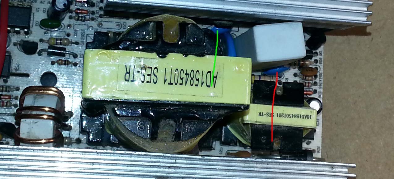

    The element was drawing 1.5kW during the period of six minutes, and the DC voltage across the caps (the rectifier DC terminals) only rose from 1V to 3V.
    No fireworks either

      Re: Task TK-940TX-DF Blowing fuse
      The rectifier tests good after that - so doesn't that suggest that the fault is either in the green X Capacitor or the 1Mohm resistor?
        Originally posted by socketa
        Well, that was uneventful
        No fireworks either
        Wow, something must be shorted "hard" for that much current to pass and nothing burn out.
        Heck, I'm surprised the bridge rectifier survived. 1.5 KW @ 230V line is ~6.5 Amps of current. Probably was running it right at the limits.
        3V across the caps? That's a little higher than 2 diode voltage drops added together (probably originating from the bridge rectifier when loaded with such current.)
        That brings another item to check: is your EMI/RFI coil/choke oriented properly - i.e. AC coming in on one side and exiting the other through the other to the bridge rectifier. If the leads happen to be flipped by 90 degrees on the PCB, you'll be shorting out the AC input... though that would have showed up as s short-circuit when you checked the input of the PSU. So that may not be the issue here... but still check.
        Perhaps it could be the green X-cap indeed. Though if the bulb doesn't glow when the bridge rectifier is removed, then the short has to be on the DC-side.
        Try it and see so you can verify. The green X-cap is only there for EMI/RFI suppression, so you don't really need it for anything.
        The 1 MOhn resistor can't be the issue, because, again, resistors always go open-circuit or high-resistance when they go bad. By Ohm's law, the input voltage at the wall would need to be 6500 KV (or 6,500,000V if you like) to drive 6.5 Amps through that 1 MOhm resistor.
        And just for fun, the power dissipated from that resistor with that voltage and current would be 42250000 Watts (42.25 Mega-Watts!!!)
          i removed the rectifier and the bulb stopped glowing - so the AC side seems to be good.
          Then i connected 230V across the AC legs of the removed rectifier (with the bulb in series) and the bulb didn't glow - the voltage across the DC legs is 211V DC and 96V AC - is that good?
          Tested across the DC holes in the board and get 35M ohm that slowly decreases.
          The bridge rectifier still tests good, according to that test that was done earlier on.
          Surely we must be getting close to finding the culprit by now!?
              Looks like it.
              Without a capacitor on the output of the bridge rectifier (i.e. between + and -), you get sinwave pulsed DC, which will read somewhat close to the RMS value, but not quite (will vary between multimeters)... so 211V DC doesn't seem bad. If you take the green X2-cap from the PSU's AC side and connect that across the bridge rectifier, then measure the voltage on the bridge rectifier, you should get around 340V DC stable. AC measurement would be irrelevant. Just make sure the X2 cap is rated for 250-275V AC / 400-450V DC (usually for X2 class, that is the minimum rating anyways, but always worth checking first before plugging things in. )
              OK, but while it is decreasing, does it still stay in the MOhm or high KOhm range after, say, 10-20 seconds? You can also try hooking that 16V laptop DC power adapter across the two caps (mind the proper polarity, of course) and see if it sparks / short-circuits. If yes, the short is still on the DC side somewhere.
              Close? We should have had the PSU fixed by now.
              I still can't fanthom what is causing an apparently almost dead short-circuit with power applied, yet nothing when checked with a multimeter. There are not only no active (transistor) devices, but no high-current paths available on the primary DC side (aside from the caps being damaged somehow... but I doubt it.)
              Bad comes to worse, you can take the two high voltage electrolytic caps, wire them in series with proper discharge/balancing resistors, then hook the bridge rectifier to them and test with the bulb. The caps should charge to around 340 DC total (about 160-170V across each cap) depending on line voltage and bulb shouldn't glow. If it does, either the caps are bad or you wired the circuit incorrectly.

                                          #80
                                          I used a tube to locate the buzzing, and it's not coming from the primary caps area.
                                          As far as i can hear, the light buzzing is coming from the small 472 Mohm blue cap (red line), and after i turn it off and on until the loud buzzing happens, it is coming from the adjacent side of the big white resistor (green line), possibly the other small 221 ohm small blue cap or the larger one.
