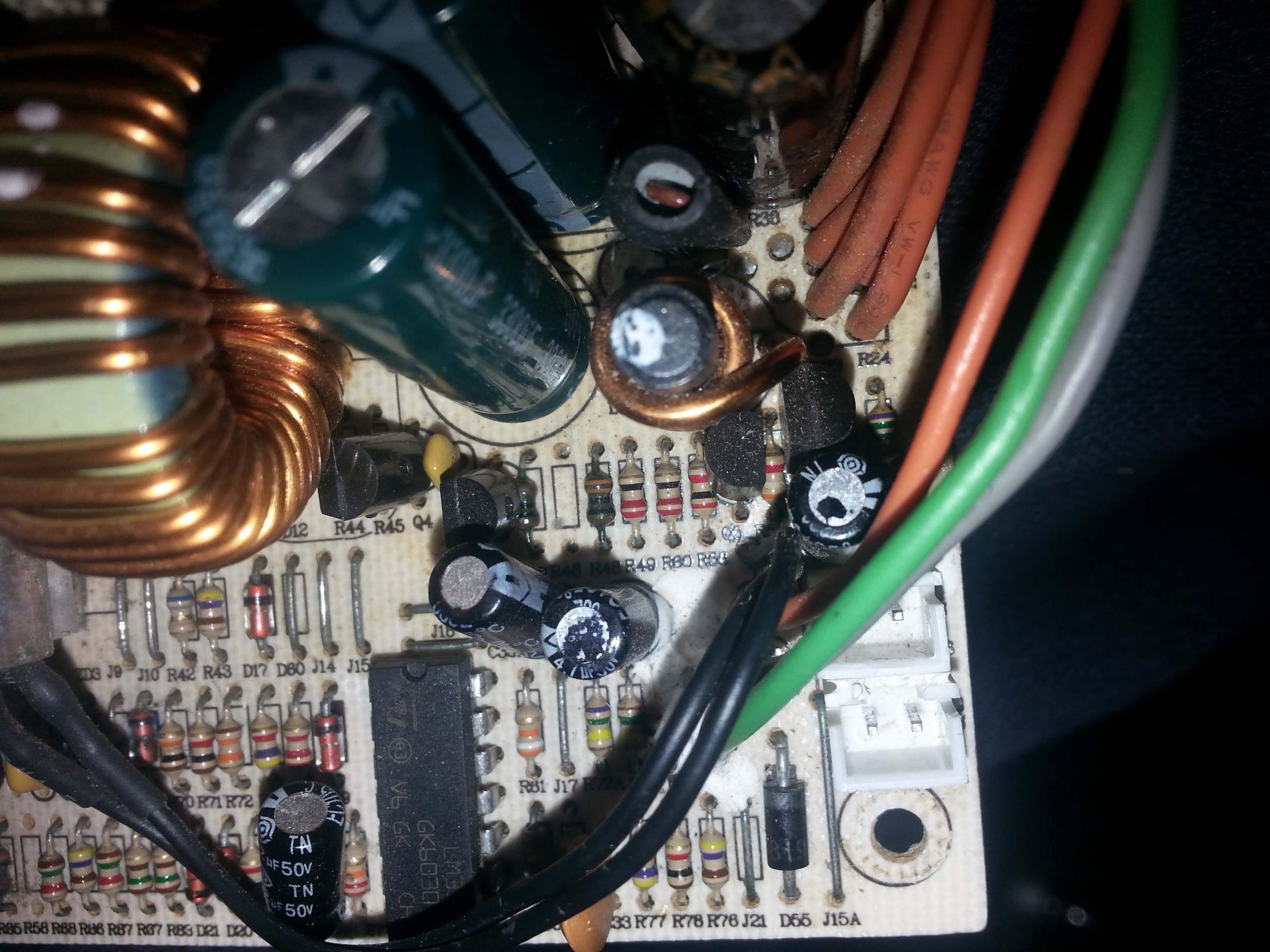

    Originally posted by socketa
    As far as i can hear, the light buzzing is coming from the small 472 Mohm blue cap (red line), and after i turn it off and on until the loud buzzing happens, it is coming from the adjacent side of the big white resistor (green line), possibly the other small 221 ohm small blue cap or the larger one.
    The numbers on those caps indicates their capacitance and not their resistance.
    caps with numbers xx5 = x.x uF
    caps with numbers xx4 = 0.xx uF
    caps with numbers xx3 = 0.0xx uF = xx nF
    caps with numbers xx2 = 0.00xx uF = x.x nF
    caps with numbers xx1 = 0.000xx uF = 0.xx nF
    * where xx = 2-digit number
    (Also, nF = nanoFarads, uF = microFarads)
    So 472 = 4.7 nF and 221 = 0.22 nF

      Wiggled a primary cap and noticed a spark, and noticed that i hadn't soldered it in so great.
      But, foolishly, instead of just soldering it up good , i removed them and put the originals back in.
      The buzzing didn't happen, the bulb briefly lights up, the fan spins for a second then stops, and i hear a brief tiny squeak sound from the PSU after turning it off for about 10 seconds.
      No squeak sound when turning it on.
      If i just use the 100W bulb alone, the bulb stays lit, i hear a much louder squeak sound when turning it on, the fan twitches, and i hear the same soft squeak (an un-squeak?) sound after about 10 seconds, as before, after turning it off.
      I get the same result now, regardless of which of the three pairs of caps i use.
      So i don't know if replacing the caps caused another fault.
      I suspect that it fixed the buzzing, but the buzzing (which i'm assuming was a loose primary cap leg that was arcing with the surrounding solder) may have created a condition whereby the PSU could power up with good voltages. So maybe there was two problems and i fixed one, which subsequently brought an underlying one to the surface.
      Or maybe the impedance of the parallel bulbs is still too high for the PSU to start?

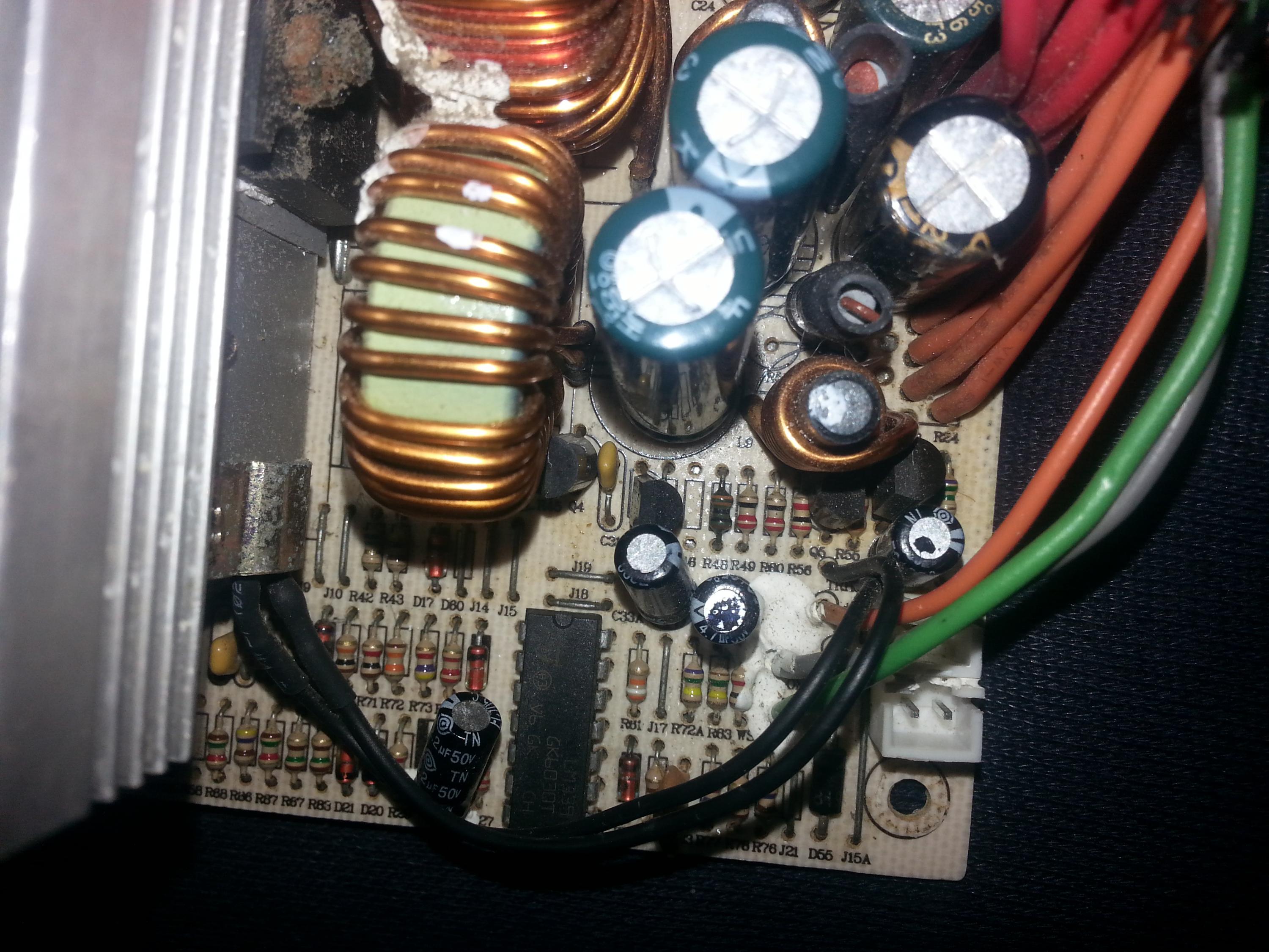

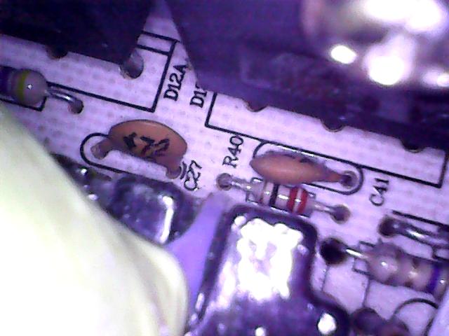

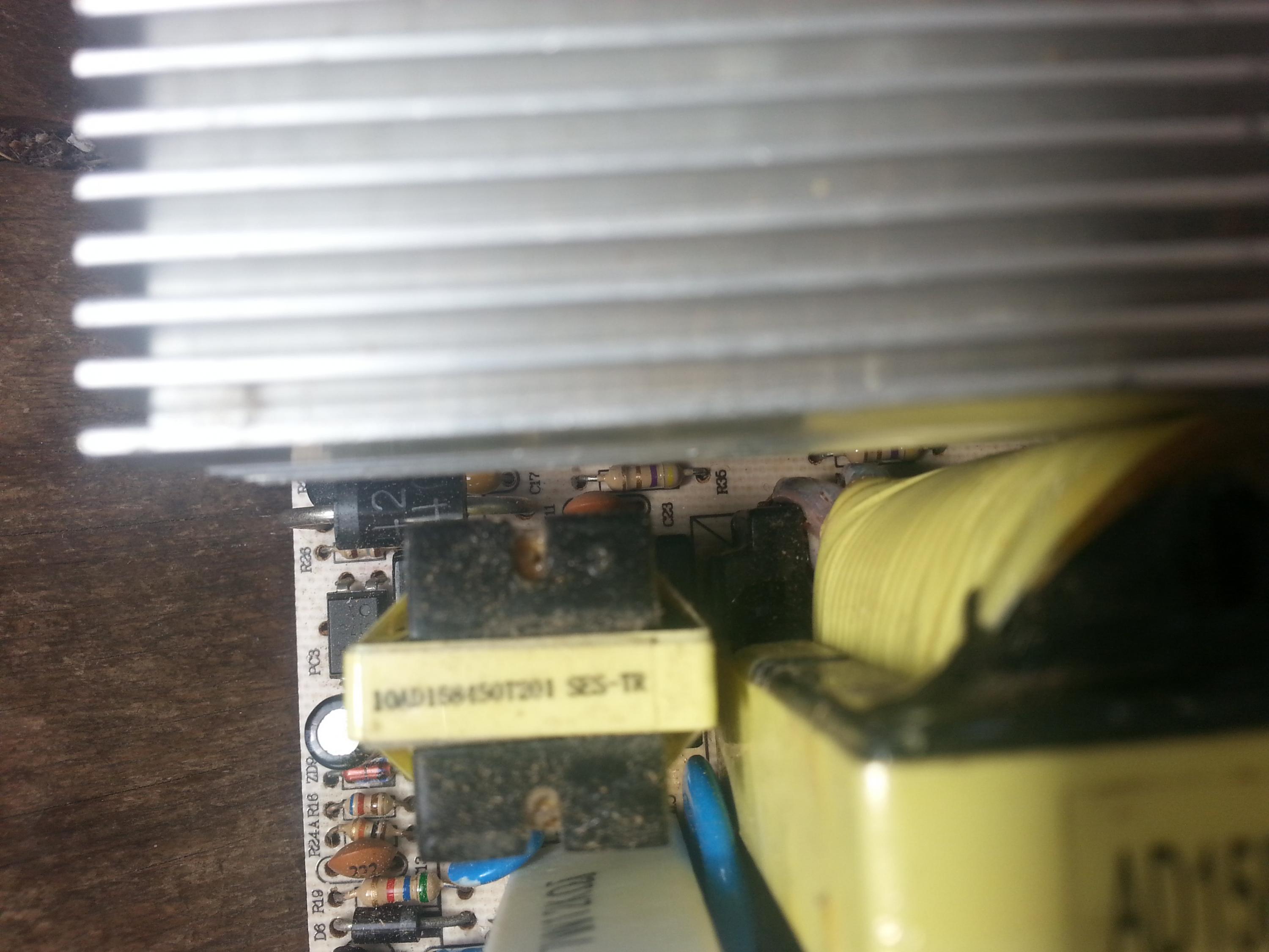

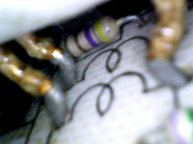

            #85
            Re: Task TK-940TX-DF Blowing fuse

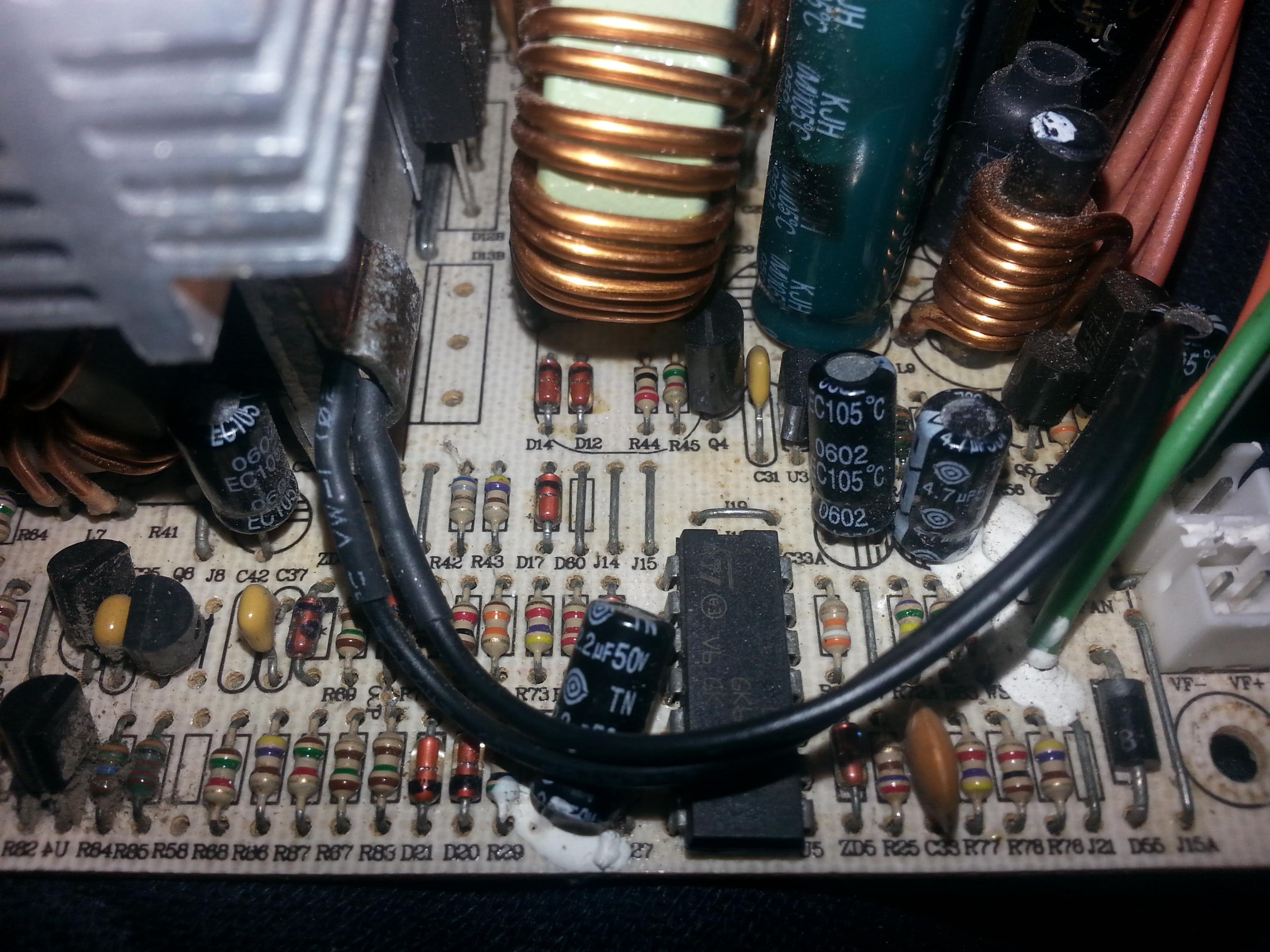

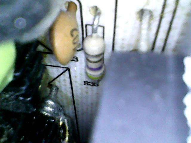

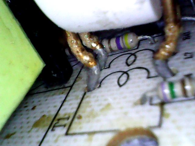

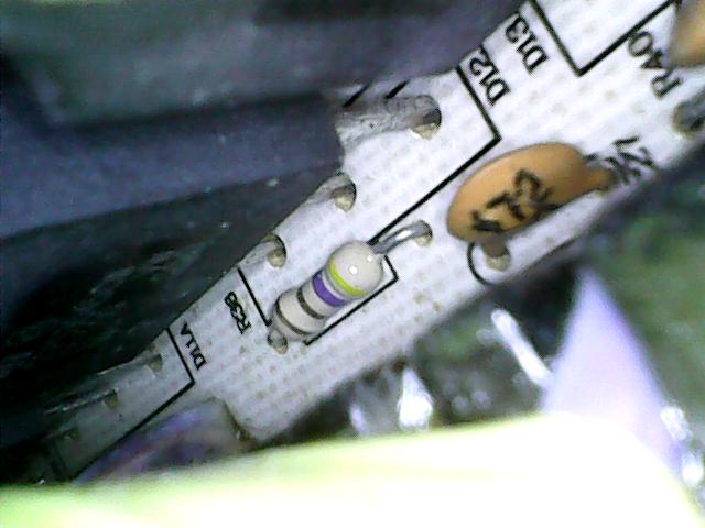

            I found the 3 snubber circuits, all 4.7 Ohm 1/2 watt sized resistors. And there are no shorted caps or open resistors
            Since these snubber circuits are connected directly across the transformer output pins, you won't be able to check the components in circuit
            I saw no need to lift any component, because, according to the following logic:
            Each circuit is essentially a resistor and capacitor connected together in a closed loop.
            If you place the meter leads across the resistor (which is the same as "placing them across the capacitor") and get a measurement that matches the resistor, then that means that the resistor is good, and that the capacitor is not shorted. If the capacitor was shorted then the meter would read as a short because one could rightly say that it's parallel with the resistor.
            For quite some time i've being inclined question what i'm told, because from a young age i refused to eat animal meat, but, at that time, someone told me that sausages were mostly bread crumbs, so i became somewhat addicted to them, and sausage rolls, for many years; not really understanding, or considering, what i was doing - until one day not long after i started eating mince pies, i noticed a piece of artery inside one. That was the end of that 'venture', and also the beginning of being vegetarian. I still didn't know about why cows make milk (incredibly many folk don't!) ... could go on with a long story, but suffice it to say that i'm constantly amazed at how easy it can be to miss stuff, that in hindsight, is blatantly obvious after the application of minimal thought, quietude, or/and assistance
            Attached is some photos of that resistors (which all tested good, at 4.7 ohms) and caps.
            The first pic looks like "102" is printed on the cap, and the other two caps have "472" printed on them.
            The colours on the three resistors are yellow, violet, gold; although due to lack of sunshine, the yellow looks green in the photos.
            Also attached, is a photo of the back of the board, with the three snubber circuits drawn in yellow.
            The snubber at the bottom has a jumper on the right hand side (vertical yellow line) which i initially missed, and so i was looking for the path back to the transformer (hence the irrelevant diode that i drew in)
              That is true.
              So looks like your snubber circuits are OK.

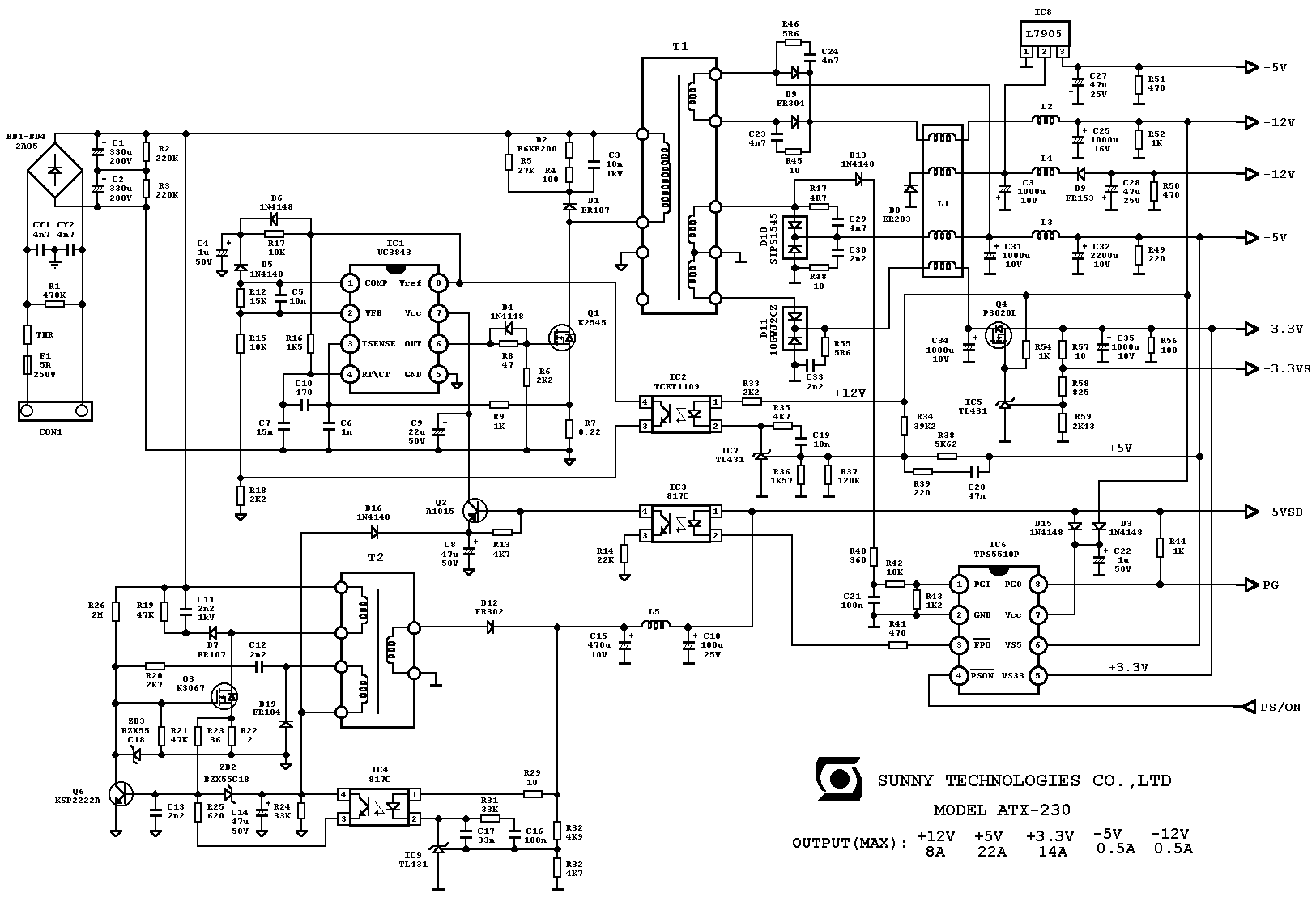

              Ok, looking back at the circuit once again...
              ZD8 is related to the 5VSB circuit only: it appears to be used as a limiter for the voltage on the Gate of the 5VSB MOSFET. Since the 5VSB seems to be working normally, I suppose everything is good there.
              However, that does raise the question: when you try to power on the main PS and you hear the PSU squeak, what happens to the 5VSB? In other words, try measuring the voltage on the 5VSB when you do this experiment. We want to see if the 5VSB drops out or not. If it is, that would be a problem. To get more accurate result, first put a load on the 5VSB - something in the range of 0.25 to 0.5 Amps should do (so connect something like a 10-20 Ohm resistor to the output of the 5VSB - that 1.5 KW heating element should have about 6.5 Ohms resistance, and probably even that will do the trick.) Then plug in the PSU, but keep main PS turned OFF, then see if the 5VSB still outputs 5V. If it does, try powering on the main PS and see if the 5VSB continued to supply 5V. The reason we want to do this is because the 5VSB circuit also has a primary side auxiliary winding that feeds the PWM controller on the primary side for the main PS. If 5VSB is unstable or dropping out, the main PS will not work either.
              As for ZD1.....
              That one is for Gate voltage protection for the main PS MOSFETs.
              With that said, both ZD1 and ZD8 should have Zener voltage ratings that are less than the maximum rated Gate voltage of the 5VSB and main PS MOSFETs.
              i.e.
              ZD1 Zener voltage < V_GSS of main PS MOSFETs
              and
              ZD8 Zener voltage < V_GSS of 5VSB MOSFET
              However, the Zener voltage of these Zener diodes should also not be too low, because then the MOSFET's may not get fully driven On.
              This means the Zener voltage of these Zener diodes should be close to the rated V_GSS of the MOSFETs, but just slightly lower.
              So if you used an improper Zener diode for ZD1, that could cause the MOSFET to not get fully driven On and thus not switch properly, leading to OPP/SC protection kicking in.

                I removed ZD8, and it looks like it has 18C printed on it,
                which looks to be a zener voltage of 18V
                V_GSS of K2746 = ± 30V
                So the zener that i used is quite a lot lower.
                I've now replaced it with a C27 Zener instead, but no change in test result
                Mind you, i wasn't super hopeful about that completely fixing it; because why would the 5V and 12V rails briefly spark up as good, but the 3.3V rail be way under spec? You'd think that they would all be affected if either of the main switching transistors were having consequential issues.
                So that just leaves that mag-amp circuit that you mentioned.
                I traced out what i could, removed the minimum load resistor which measured 15 ohms, so that i could check the other resistors (see photo), but when i put one lead of my meter on 3.3V rail and the other one on the earth rail to test the 3 resistors (the first one doesn't count, because the +S wire is connected to the 3.3V rail in the motherboard connector), their total resistance should be (330 + 110 + 22)ohms, but the meter reading keeps on going up to over 1K.
                Those two diodes, that i drew in test good.
                  OK, that's good to know. At least we eliminate that as being a possibility as well.
                  Before i remove the transistor and the shunt regulator to test out of circuit, would you say that the zener diode that i replaced with the C27 diode was an acceptable replacement (was the closest value zener that i could scavenge of other parts PSUs), and wouldn't be the cause of PSU shutting down?
                  From what I understood, there was no change in behavior when going from the 18C to C27 Zener, correct?
                  Actually, there are two factors when considering the Gate protection Zener diodes: one is, as mentioned in the previous post, the maximum voltage the Gate of the MOSFET is rated for. So the Zener needs to have a Zener voltage less than the gate. The other factor is the drive voltage. In the case of ZD1, this would be the Vcc voltage going to the PWM controller (UC3843 IC). Note that the UC384x family of PWM controllers is rated for 30V absolute max for Vcc. So with that in mind, we know the voltage that the PWM controller outputs could be up to 30V, depending on Vcc, but not more than that. So Z1 needs to be selected to have a Zener voltage that is higher than whatever Vcc actually is in the circuit (but not more than 30V, because UC384x PWM IC is not expected to output more than that anyways.)
                  Thus, the C27 Zener you used should be a good fit. Not only should it protect the MOSFET Gate from going over its maximum V_GSS voltage (30V), but should also protect the PWM IC in cases where the MOSFET can go bad and conduct Drain-to-Gate (opening the possibility of a high voltage leaking back from Drain into Gate.)

                    Just out of interest, is the 3.3V derived via a mag-amp in this schematic,
                    http://danyk.cz/s_atx01u.png,
                    and if so, where is the mag-amp?
                      Yes, it is.
                      In that circuit...
                      SD1 is the 3.3V rail rectifier
                      L4 and L(?) are the 3.3V rail filter coils
                      C18 and C19 are the output filter caps
                      R28 is the minimum load resistor
                      And the mag-amp circuit components...
                      L2 is the saturation coil/toroid (the white one next to the main transformer in your PSU - looks like L7, I think.)
                      Q5 is the mag-amp switching transistor
                      Q6 (TL431 - it should really be labeled as "IC" and not "Q" in the schematic) is the current shunt regulator for the 3.3V rail.
                      D8 and D9 are the diodes for the mag-amp coil
                      R26 and R27 (1k VR) are the resistors forming a resistive divider to set the 3.3V rail voltage to 3.3 Volts.

                                        I think that it's a similar setup as in the attachment that i've included - My PSU has the same 2Mohm resistor that is between the +ve DC and the zener

                                        Would the PSU have a 5VSB critical cap, and, if so, what circuity configuration would i be looking for, in order to find it?
                                        (maybe there's one in the attachment that i've included)
