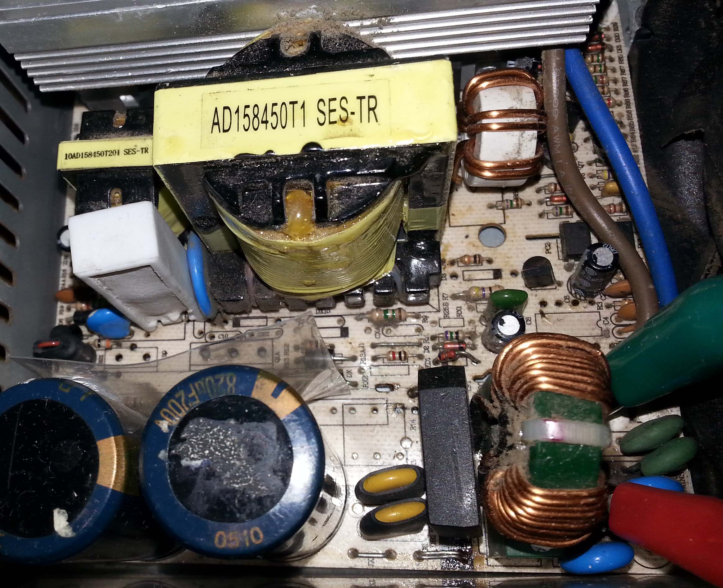

                Re: Task TK-940TX-DF Blowing fuse
                No power selector on this PSU - so that rules that out.
                Attached a photo with the components removed, just to confirm that i removed the right ones.
                Additionally, there is 1 Meg ohm resistance measured across phase and neutral - is that OK? And would that cause the light bulb to glow brightly?
                  Yup, you got them.
                  Yes, that is normal.
                  Well, there aren't that many paths left, but possibly there is still something shorting on the DC/rectified side of the primary side.
                  Discharge the primary caps (putting your soldering iron's wall plug across each cap's leads for a few seconds will do the trick), then measure resistance between (+) and (-) leads on the bridge rectifier. Keep the multimeter connected for a few seconds, as the capacity of the input caps may show a low resistance at first. With this test done, if the resistance raises and is not low (over 200 Ohms), remove the two orange MOVs. I know you mentioned you measured them and they aren't shorted, but perhaps they could be conducting at live voltage. Now try plugging in the power supply and see if the bulb still glows. If yes, there are only two more possible paths from faulty components that can cause this.
                  The first one is the blue ceramic cap between the 5VSB transformer and 5VSB MOSFET (i.e. next to that big ceramic resistor.) Remove that and try the bulb test again.
                  Bulb still glowing? If yes, the last possible path is... and this is very unlikely... that one or both of the primary caps are bad and arcing internally when charged. Remove both caps and try the bulb test again. If the light bulb still glows, take a good picture of the bottom side and post it here. I know there is one on page 1, and I've been using it extensively to trace the circuit on this PSU. But just to make sure something isn't shorting there or something hasn't changed in an unexpected way since that last image.
                  So again, just a run down of the procedure:
                  1) discharge primary caps and test resistance between + and - of bridge rectifier. Post value here.
                  2) remove MOVs and perform incandescent bulb test again. If NOT glowing, STOP. The MOVs are likely bad. Otherwise continue below.
                  3) Remove blue ceramic cap next to white ceramic resistor near 5VSB MOSFET area. Perform incandescent bulb test after this. If NOT glowing, STOP - ceramic cap is likely bad and failing when charged. Otherwise, continue below.
                  4) Remove both primary caps and perform incandescent bulb test. Post here if bulb still glows or not.
                  Also, between each step above, it probably IS good idea to try and discharge the primary caps as detailed earlier with a soldering iron plug or something similar. That way, if you get to one of the test steps above where the bulb is no longer glowing because the short on the primary is gone, then the PSU will likely end up with its primary caps charged at high voltage (about 170V DC each) - at least for a few moments/minutes until the discharge/balance resistors across the caps discharge them. Thus, for extra safety, I like to make sure those primary caps are discharged.

                            1) 210pF
                            2) Still Glowing
                            3) Removed but didn't test because the bulb still glows after its removal
                            4) Still glowing (why am i not surprised?) after removing the transformer and the resistor(1Ω)
                            Just brought some keyboard cleaner today - so that was good timing.
                            Cleaned it as much as i could, and couldn't spot any blobs or spashes that would have caused a short.
                            How the heck is the bulb glowing when all that i'm getting between phase and neutral (of the power plug socket), with fuse inserted, is 1MΩ (that "discharge resistor")?
                            If i just connect the bulb in series with a 1MΩ resistor, and nothing else, would it glow like that?

                              Good question.
                              I double and triple-checked everything from the last photo you uploaded and there are no possible low-resistance/impedance paths left to ground. That is, again, assuming you have removed the MOVs behind the bridge rectifier.
                              This only leave the bridge rectifier and/or possibly something wrong with your incandescent bulb setup.
                              Do this first: take a known good ATX PSU and connect it to your series incandescent bulb. Make sure there is nothing connected to the output of the PSU (i.e. no motherboard or anything.) Now plug it and see what happens. Does the bulb still glow?
                              If not, then remove the bridge rectifier on the Task PSU and replace with another bridge rectifier, if you have a spare one. Otherwise, you can use 4 regular diodes too in place of the bridge rectifier (but they need to be rated for at least 400V DC reverse blocking voltage, or more.)

                                Looks like we may have got it!
                                Took out the PBU805 bridge rectifier and replaced it with a RS405L and the bulb didn't come on. It's a downgrade to 600 Peak Reverse Voltage, is that still perfectly acceptable?
                                Back at the start of this process i did remove the bridge rectifier and it tested good (and still does) according to this video:
                                https://www.youtube.com/watch?v=K-oNaQvMQco
                                and i also tested to both AC Legs, which over all equates to 4+4+2=10 tests in total, that all tested good, according to the diagram in the video.
                                So the rectifier tests good but it is bad! (i double checked that the bulb lit, by tacking the original rectifier onto the reverse side of the board before attaching and soldering the replacement in)
                                Looks like it shorts out only when voltage is applied - thought that there was something odd going on when there was no contact between the power plug pins, but the light came on.
                                I've put the MOV's, heatshrinked resistor, small blue cap, and 5VSB transformer back in, and the bulb remains unlit.
                                    Yay, about time, lol.
                                    I guess I should have suspected the BR earlier to save on removing all of those components. But it's such a weird failure, as diodes usually fail short-circuit or occasionally open-circuit if enough current is forced into them. Have not seen one, at least on my bench, fail like yours, where it only breaks down under load. But I do know it is a possible failure mode... just extremely rare.
                                    Yup, 600V is fine.
                                    Even 400V will work, though that would be cutting it very close (could certainly fail with a power surge, as the DC voltage at the caps is nominally ~340V.)
                                    Should i keep replacing the parts ( in any specific order?) and doing the bulb test, after each component?
                                    You can place back all of the 5VSB parts (including test 5VSB transistor) and then do the bulb test. If the 5VSB still has the replaced/good caps on its output, we should hopefully see the 5VSB come up now.

                                      i put all of the parts back (and replaced the shorted zenner ZD1, that you can see just above the rectifier in post #27) except for that big pink resistor that i lost, and the other two large FETs - turned it on, and the light bulb instantly glows, and no 5VSB.
                                      I'm starting to think that the original rectifier might not be the cause of the problem
                                      When i test, in circuit, across that heat-shrinked resistor, that's next to the 5VSB transformer, i get a hard short - is that a clue?
                                      That "1MΩ discharge resistor" that i previously mentioned, doesn't exist, because when searching for it on the board, and not finding it, and after looking at a few PSU schematics, i eventually realized that it was the resistance of my body as i was holding the probes with my fingers onto the power supply wires.
