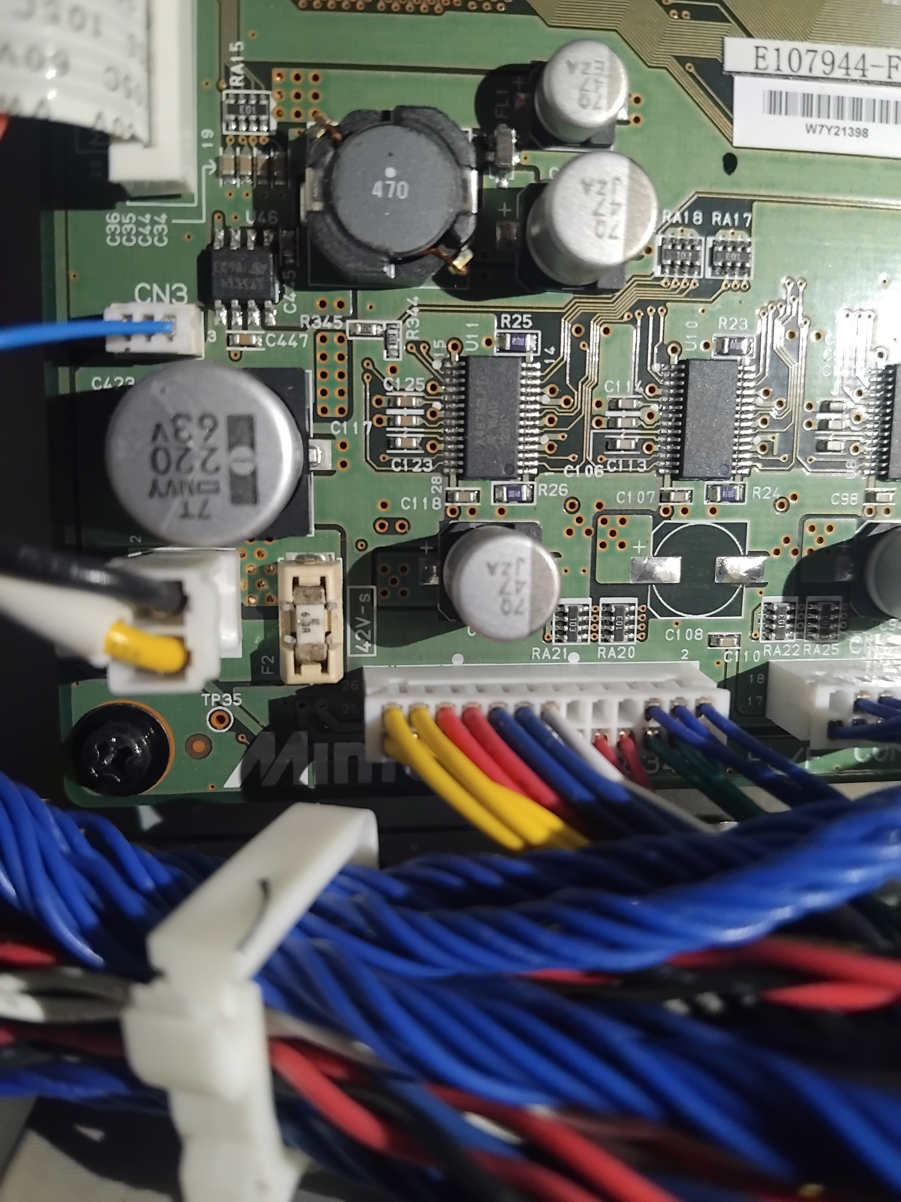

    Hi guys,
    I'm inexperienced with electronics repairs, I've done a little bit of soldering caps and whatnot, but i have a blown fuse on this mimaki printer I got which I have bought a replacement for.
    How do I remove this type of fuse (see picture)...it kinda looks like it would pull out of that bracket but it didn't come at first pull and I didn't want to brute force it incase it's soldered on there like most of the rest of the components.
    Anybody know how to remove this type of fuse?
    (The fuse is toward the bottom of the image labeled F2)

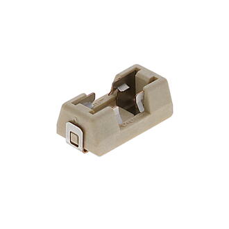

ID:	3661731 You should be able to remove the fuse from the fuse holder.

        Thanks, I thought so but was not 100% and didn't want to damage something just pulling on it, ended up coming out nice and easy
