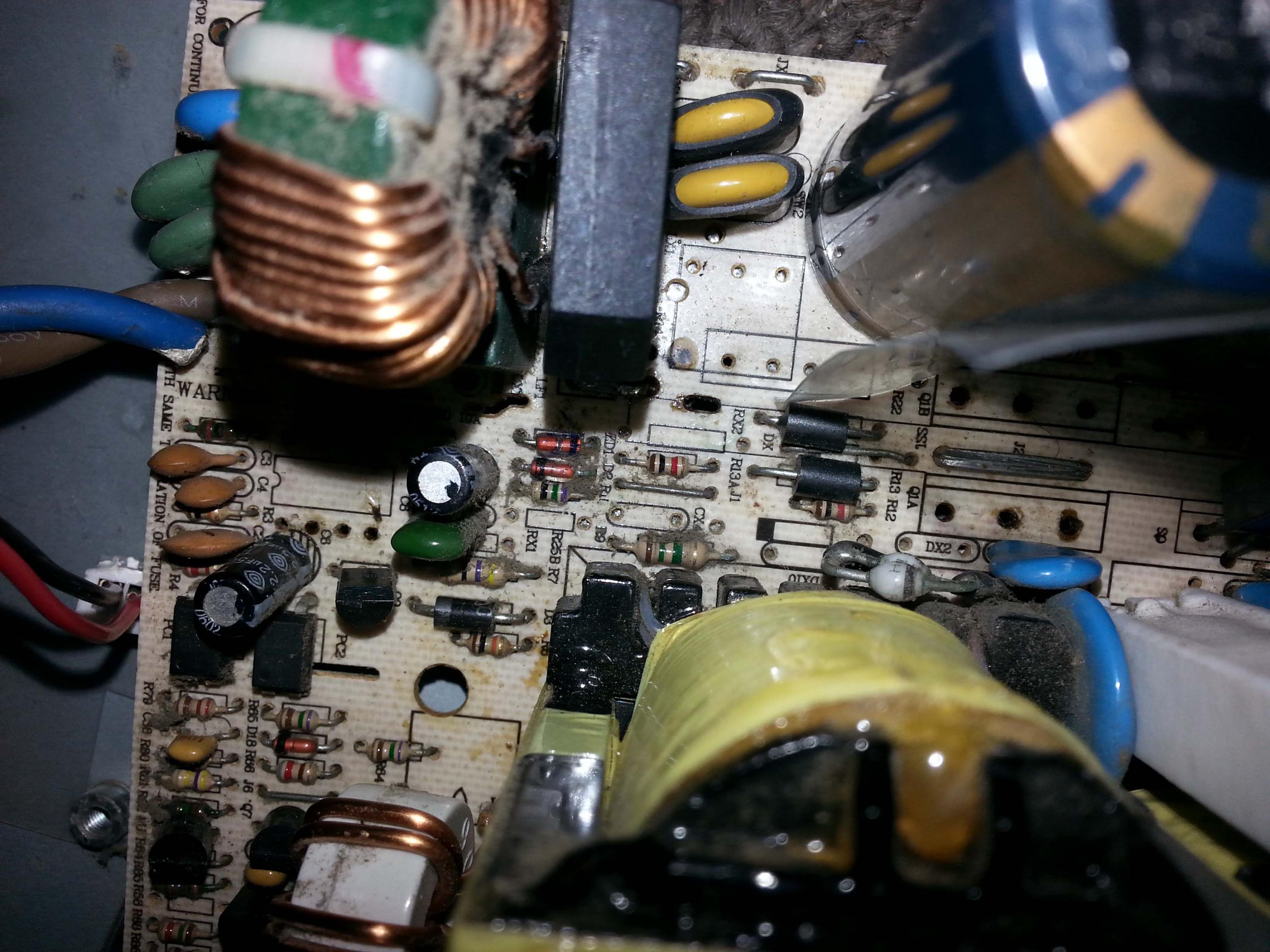

    I saved this PSU from a PC that someone threw out
    The teapo output caps are bulged
    It's got a TL384P chip on the primary side.
    Plugged it in, turned it on, it worked for a few minutes, and then the 10A fuse blew (leaving the surrounding area blackened).
    Then i put fuse holder in, and a new fuse, and it blew again the instant that i switched the power on.
    There is no short from live to earth when it is unpowered, so what could be causing the fuse to blow?
    By the looks of it, it's probably not a very good PSU but i wouldn't mind trying to get it working because it has longer power connector wires than my other ones.

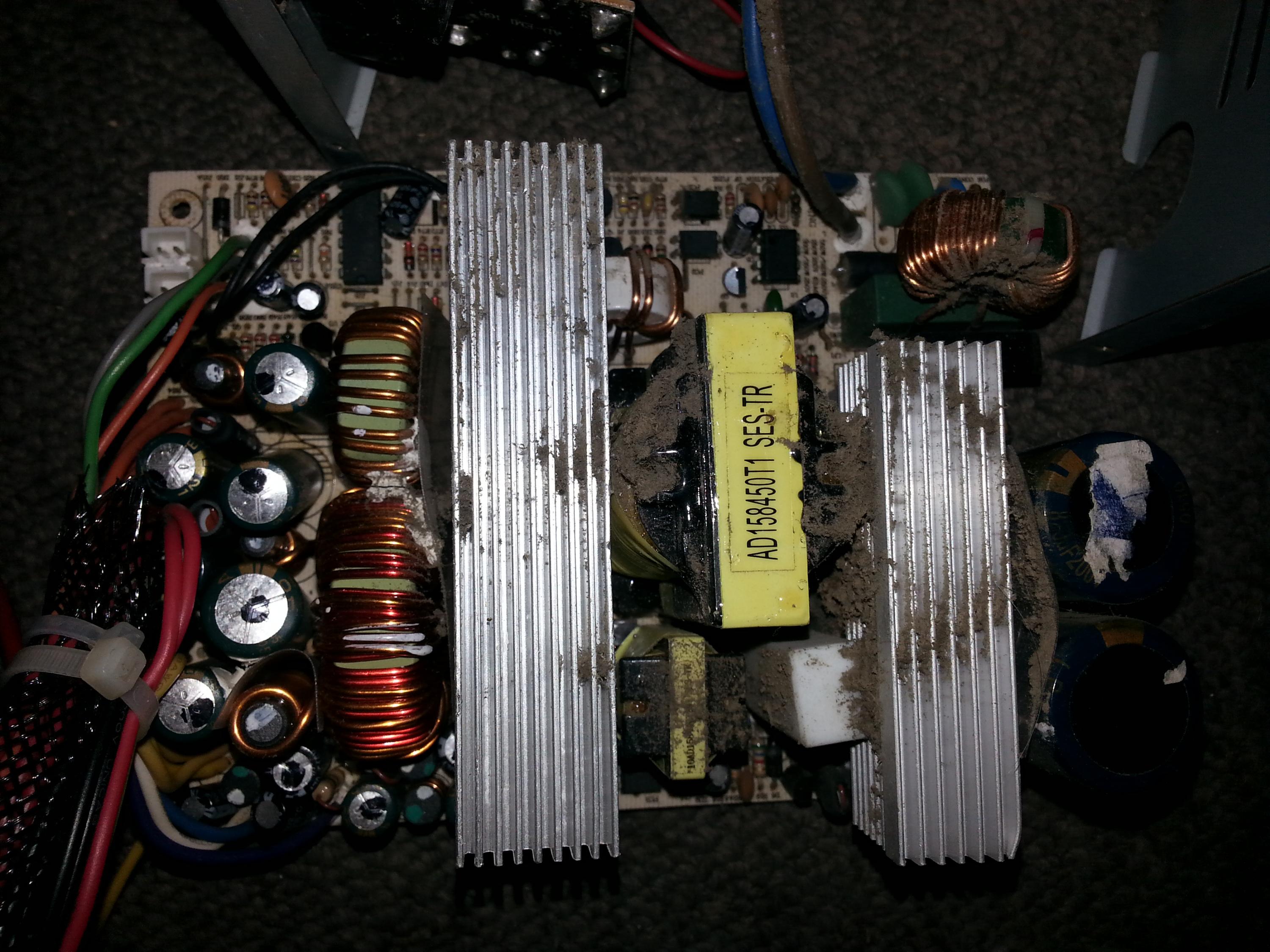

      Took off the Bridge rectifier - TOK
      Then a K2746 - No shorts
      Then had to remove the heat sink and there was a shorted K2746 field transistor on the other side of it. (managed to lift a trace - note to self: remember to dont push on soldered components)
      Could the bad secondary caps (or is is the Fuhjyyu primarys?) have caused the transisor to short?
      Yep, the two primary caps are LP 820uf 200V, which measure 740uf and 750uf, and about 0.05 and 0.03 ohms ESR.

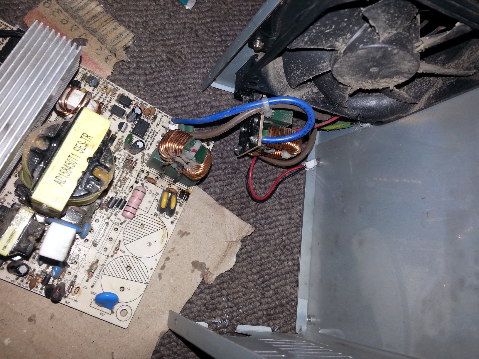

        Did the PSU have a separate board with a HUGE coil attached to it on the primary? If it's there, then you may have a dead APFC, and could very well be the reason for the failed transistor. Fuhjyyu primaries + APFC = no bueno. If my memory serves me right, I would also check the TL384P on the primary, as on mine that went bad too.

          Only this next to the fan - it's not really "huge" - so no APFC?
          How do i test the TL384P? - do i have to remove it and test for shorts?

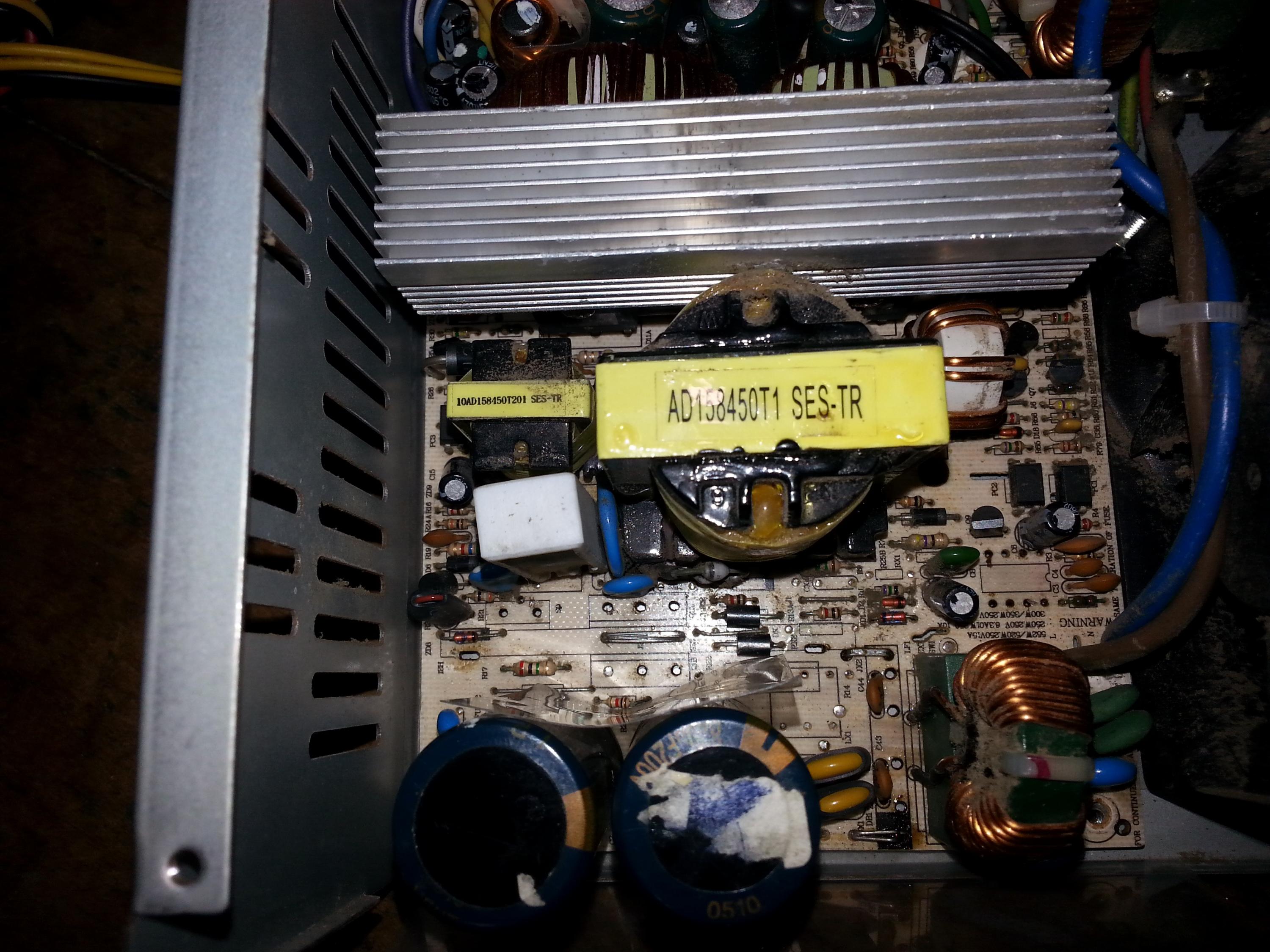

              Let's first see if the 5VSB circuit is working and stable. No point to try to troubleshoot the main PS if the 5VSB is not working.
              To do that, first replace all output caps on the 5VSB and any small caps on the primary side of the PSU. Next, keep the TLP384P, K2746 primary MOSFET, and R22 removed from the PSU. Do install back the primary input caps, though.
              After this, get a 60-100W incandescent light bulb and wire it in series with the PSU's live input wire. This will prevent the fuse from blowing up should anything else be bad or short-circuited. Now plug in the PSU with the bulb in series and see if you get 5V on the 5VSB output (typically the purple wire on ATX connector).
              If not, then we will need to troubleshoot the 5VSB first.
              If 5VSB is working, then check R22 for open-circuit (should be a low-resistance resistor - 0.1 Ohms, if I am reading it correctly from your pictures). If the damage was minimal, you should only need to replace the K2746 MOSFET to get the PSU running... and the output caps, of course. But if not, you may need to replace the TLP384P IC as well.
              As a quick test, you may be able to replace the K2746 MOSFET with any other N-channel MOSFET that has the same or higher rated voltage and rated for at least 2-3 Amps continuous. Don't worry too much about the other paramters - at least not for performing this basic test. With the MOSFET replaced, and R22 and TLP384P IC reinstalled, the PSU should work if all else is OK. DO keep the incandescent light bulb in series with the PSU, though. If it stays lit when you plug in the PSU, then likely either the TLP384P IC or the driver circuit for the MOSFET are faulty. We will go from there if that is the case.

              That's just an EMI/RFI common-mode inductor ("choke"). Stops RFI from leaking from the PSU back into the grid and EMI from going into the PSU and showing up as noise on the outputs.

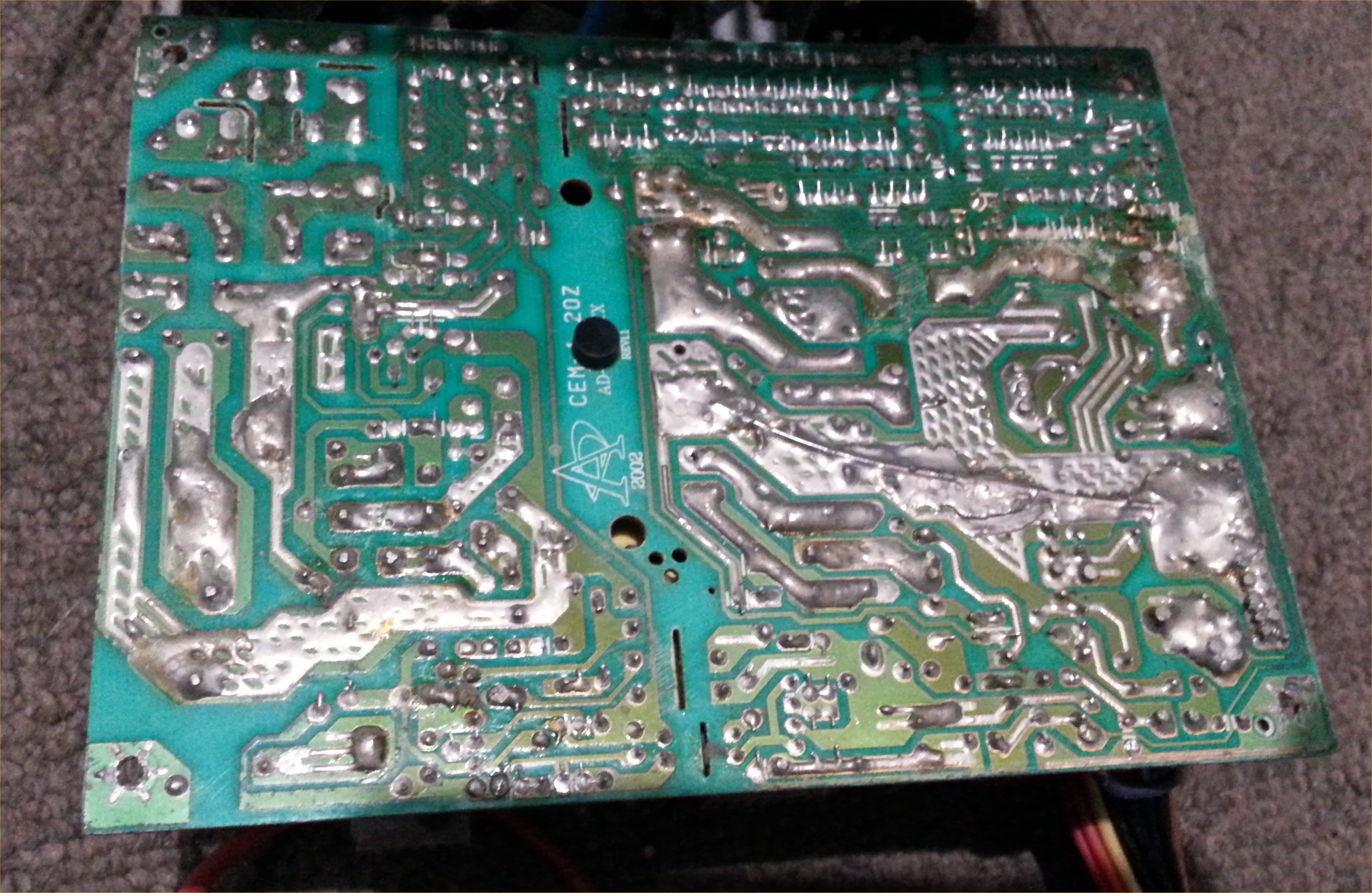

                So, with the three components still removed that are bolted to the heatsink, as well as the pink R22 resistor and the TL384P removed (which wasn't shorted anywhere), and with the primary caps back in, and a new fuse (got a few to spare), i turned it on and don't have any 5VSB voltage (i haven't changed the caps yet because the ones around the 5VSB wire aren't bloated, and i think that there should at least be some voltage present regardless).
                BTW there is a short on the PCB where pins 2 (VFB) and 5 (Ground) of TL384P were removed.
                  Hmm...
                  I can't find a datasheet for TL384p. Are you sure this isn't a TL3842p (or TL3843p??)
                  As for the short-circuit on pin 2 (VFB), don't worry about that yet. However, do check resistance between pin 7 (Vcc) and primary ground (- lead of bridge rectifier.) If it's shorted, then we may have problems.

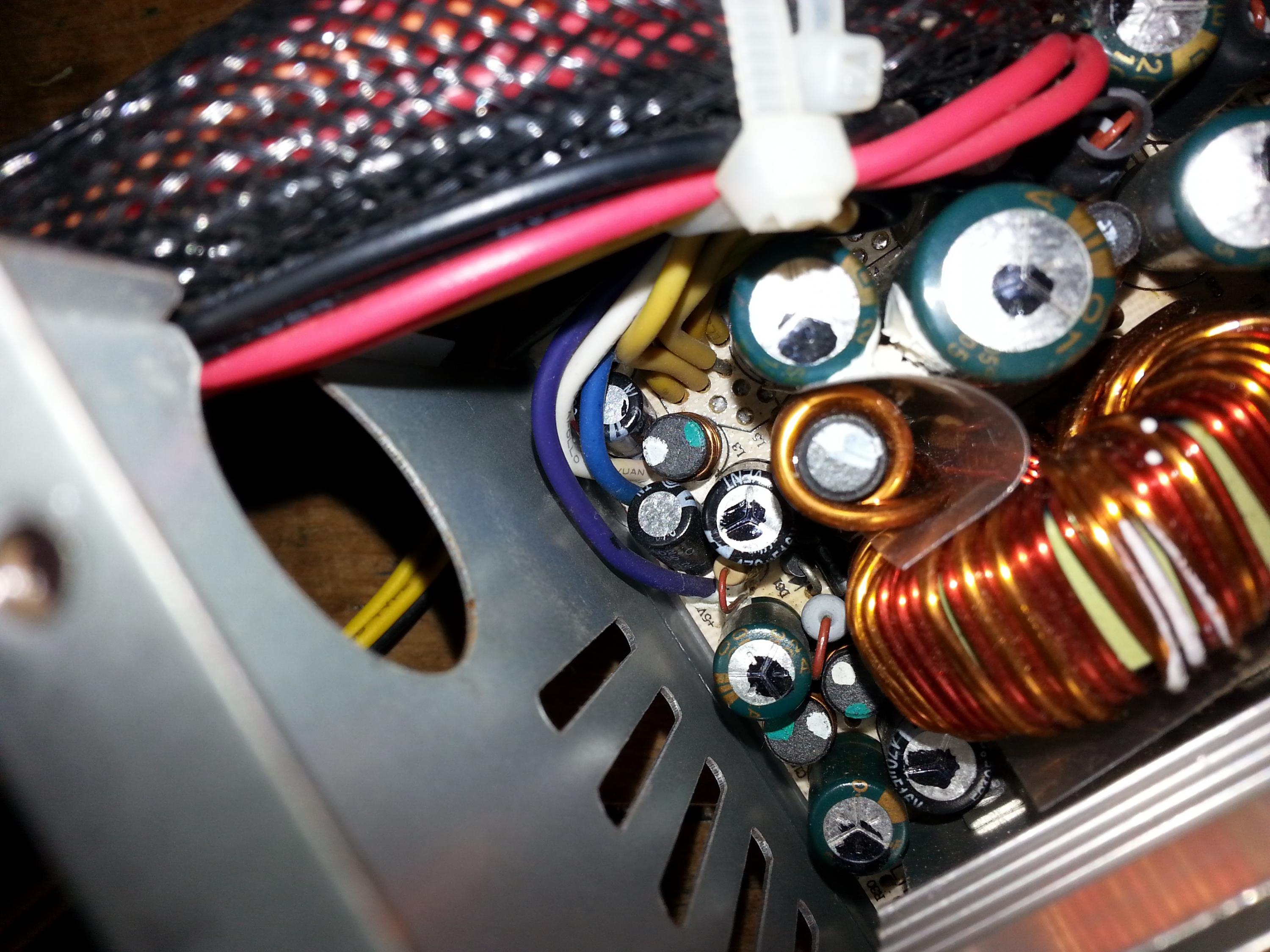

                      There was two Teapo 1000uf 10v caps that were on the 5VSB rail (you can see them in my last image - one tested OK, but the other one, after the coil with the blue and white dots (is that the PI coil?), tested bad with the bung bulging out of the bottom.
                      I put the good one back in, after the coil, and used an LGZ before the coil.
                      I removed the small Fuhjyyu 50V 22uf cap that is next to the small transformer, and it tested 22uf, and it has an ESR of 1.94 ohms, which i get the feeling is way too high, and the datasheet doesnt give a measurement for impedance.
                      If the ESR is bad can i use a 33uf samxon GF to replace it?

                        1.94 Ohms is not terrible. Small 5x11 caps can have up to 5 Ohms ESR sometimes and still be considered "in-spec" by the datasheet.
                        If no mention in the datasheet, then I guess it is best to replace it.
                        I think it *should* be OK. Going up in capacitance one notch is typically OK. Generally, 5VSB circuits are not too picky about those "critical caps" either, as long as their ESR is good and their capacitance is reasonably close to original. But just to be on the safe side... if you have 10 uF caps instead (fairly common value), you could put two of them in parallel for a total of 20 uF. That would be a lot closer to specs.

                        Looking at the circuit again, that white ceramic resistor is probably part of the snubber circuit, so no reason it should have failed (but if failed, can cause catastrophic results, so good that we checked it.) I originally thought this was Source/Emitter resistor for the 5VSB main transistor.
                        One a second look, that appears to be the heat-shrinked resistor next to ZD6 and R21 (can't read its designator.) Remove that one and measure it out of circuit. I think it should be low resistance value.
                        Also, when you performed your 5VSB test, this was with Q8 (or is it Q6?? I can't tell from the pictures) still installed, correct. This Q8/Q6 transistor would be the one next to the R21 designator. That is the "main" 5VSB switching transistor.
                        In addition to that, also remove the small TO-92 transistor next to the heat-shrinked resistor I mentioned above. It's probably going to be either a C945 or 2N2222A or something similar (an NPN BJT, typically.) Get a datasheet for it and check for proper forward diode readings between Base-Emitter and Base-Collector (i.e. red multimeter probe on Base and black multimeter probe on Collector or Emitter.) And no connection / open-circuit between Emitter and Collector, regardless of probe orientation.

                                  Looking at this picture:
                                  https://www.badcaps.net/forum/attach...1&d=1586164479
                                  ... you see the two orange components that look like ceramic caps in heatshrink tubing (close to the bridge rectifier) - take those out and measure the resistance across them. These are MOVs, and they short-circuit when the PSU has been exposed to high surge voltages. For the fuse to blow with such violence, I suspect one or both of these may have shorted. If you measure them with your multimeter and you get very high resistance (several MOhms) or open-circuit, then they are OK. Then that means something else is shorted - either on the main PS or the 5VSB circuit.
                                  After this second fuse blew, check all of the components mentioned above in the previous posts to make sure they are still good.
                                  And for the 5VSB test, do it with the K2746 MOSFET and R14 *removed* - these components removed will essentially cut off the main PS from the PSU, so you can test just the 5VSB right now.
