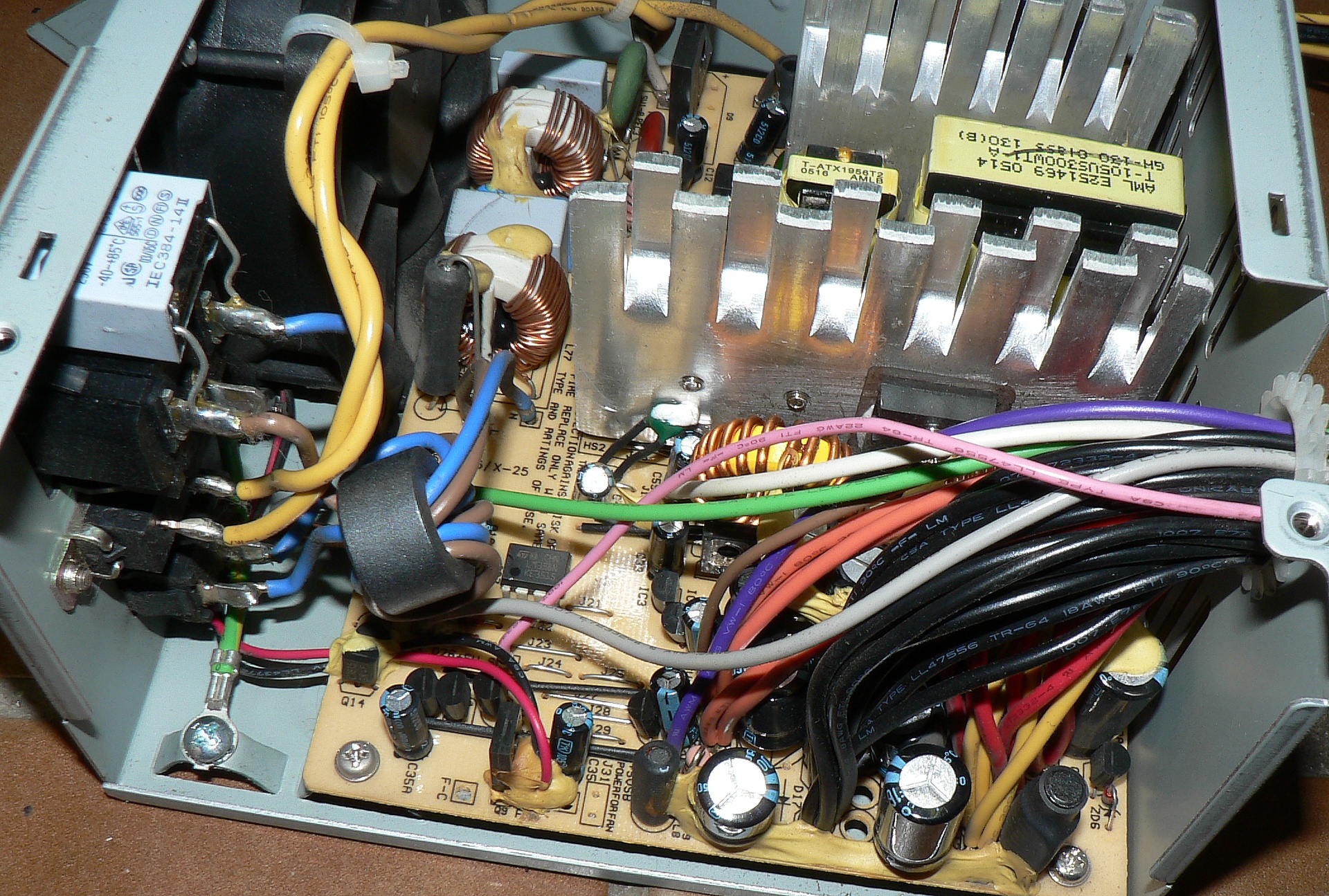

                          #1152
                          My Teapo LXK 470uF caps (ex 200W FSP) are the same size and diameter as HEC 220s, with Su'scon 220s being slightly smaller; all three being 200V rated.

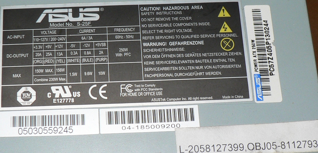

                              I've dug this in junk to use under a project I am leader of (a room for students for making architecture models). It was whole ASUS Vintage-AE1 computer. According to UL, this PSU seems to be some kind of Bestec. Notice how they solved any potential problem with +5 V SB by using big 2200uF Chemi-Con KZE on the rail. I think that saved them huge number of RMA's. It seems built well enough to do 250 W even with those 470uF Fuhjyyus or what crap that is on primary.
                              There has been two bulged Chemi-Cons KZG on the board, near MOSFETS next to AGP. Most likely there has been more powerfull graphics in there before. Now one thing is replacing all KZG's on the board with KZE's which I mined on other dead boards anyway. But other thing would be replacing those Jamicons inside the PSU. You see, I won't get them paid much easily, the pricks here would talk bullshit abotu conflict of interests and so. And I won't be giving my nice Chemi-Cons KY for free, right?
                              So I will just consider that a test. It will mine bitcoin for me 24/7 (as a reward for those caps on board but with that Athlon 64 3000+ it's not like I'll make fortune on that, probably less than a buck a year ) next to regular office-like use. After like half a year (if it won't start crashing sooner) I will have a look at the caps. If they'd be all shit, than I will say the usuall stuff: I will repair it for 1/3 the price of a new so-so PSU, your choice

                                #1155
                                Definitely looks like a Bestec. Those primaries are probably CapXon. Nice, gotta get something for your work

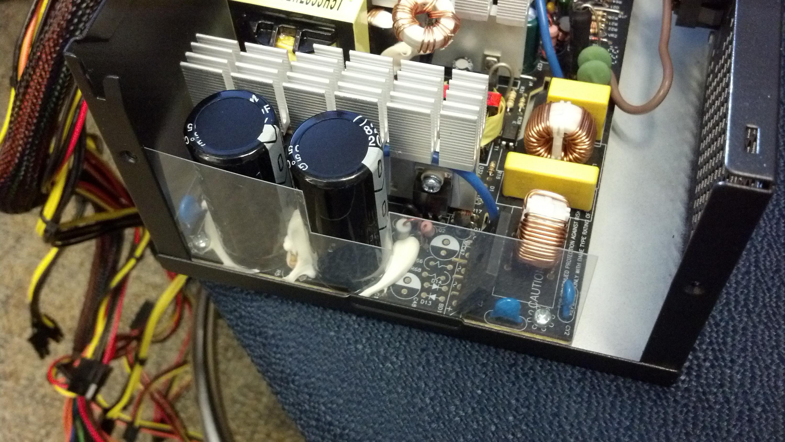

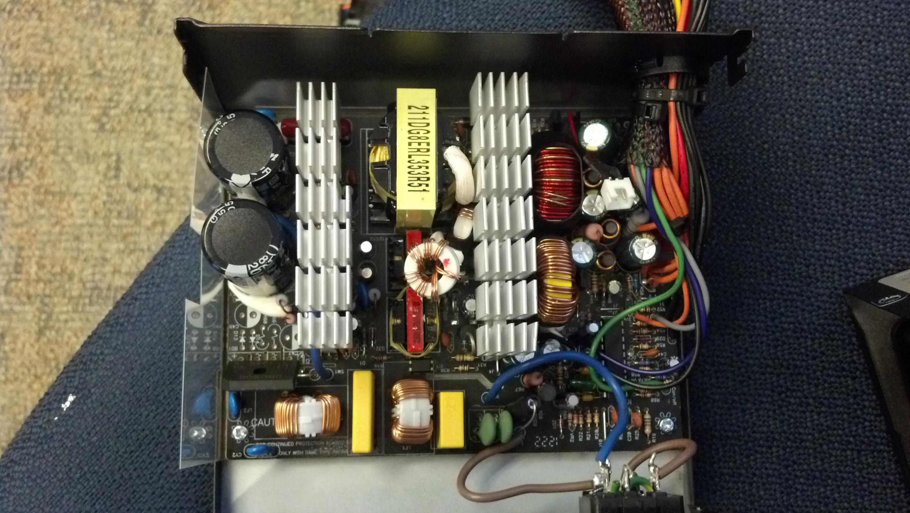

                                  #1156
                                  Decent Andyson unit. Not 500W though. Good heatsinks, nice input caps for a non PFC unit, GBU806. I think it's good for 350W, the transformer probably couldn't handle more than that. 30A schottky for all rails. Gonna recap it and put it in a build with a Core 2 Duo and a GTX 260, should be perfect for that. What do you guys think about it?
                                  • Behemot
                                    • 4845
                                    • CZ
                                    #1157

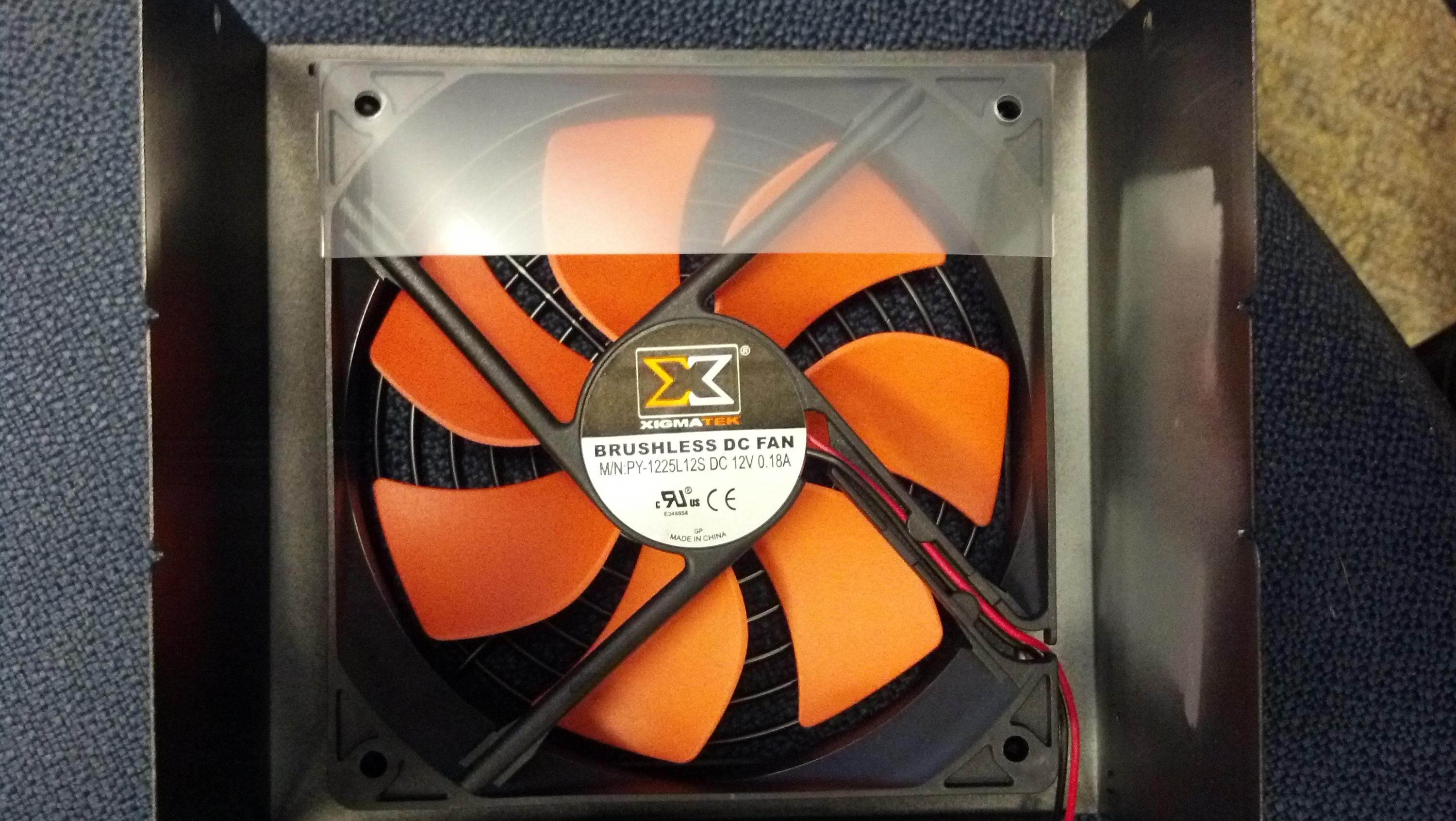

                                    Yeah, transformer seems to be ERL-35. Well if you have equipment, try to load it? Maybe it works on higher frequency? Cause to be honest, many bigger supplies which DO provide their rated power do NOT have huge transformers as well. Maybe there is something on it?
                                    Btw remove that plastic crap on the fan…

                                      #1158
                                      Does it make a difference that this thing is designed to only run on 115VAC? Doesn't the stupid plastic thing direct air flow? i wish i had a load tester
                                      • Behemot
                                        • 4845
                                        • CZ
                                        #1159
                                        I think that just the rectifying bridge has to be twice the current. There should be voltage doubler arroudn those caps so after that you have 325 V, too.
                                        Yes, that is the idea, now in reality it only effective decreases total airflow. How that could be good for anything I don't understand. On some PSUs, for example OEM Seasonics, that plastic thing is even wider.

                                          #1160
                                          The plastic does help, leave it there.
                                          It creates a difference in air pressure which keeps air pockets from being created so the air actually moves out of the power supply.
                                          You can experiment with some cigarette smoke and low rpm and by replacing the lid with the fan with one that's transparent so that you can actually see the air trapped there.
                                          Yes, it's voltage doubler, you can see the blue wire going to somewhere between the two large caps.
