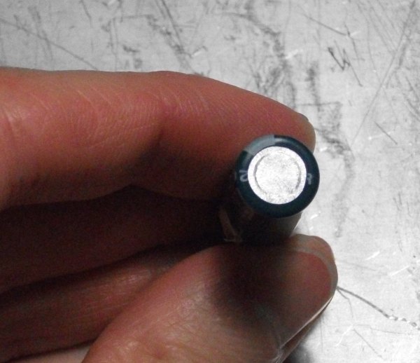

    Big explosion! That's an "Ark" cap, correct?
    • pdavid
      • Jan 2011
      • 279
      • Hungary
      #1762
      Now that's interesting. There is a circular shape punched into to top of the cap but its not deep at all. I'll take out for an examination when I'll have the time. The psu works btw and voltages are stable so the caps can't be that worn.

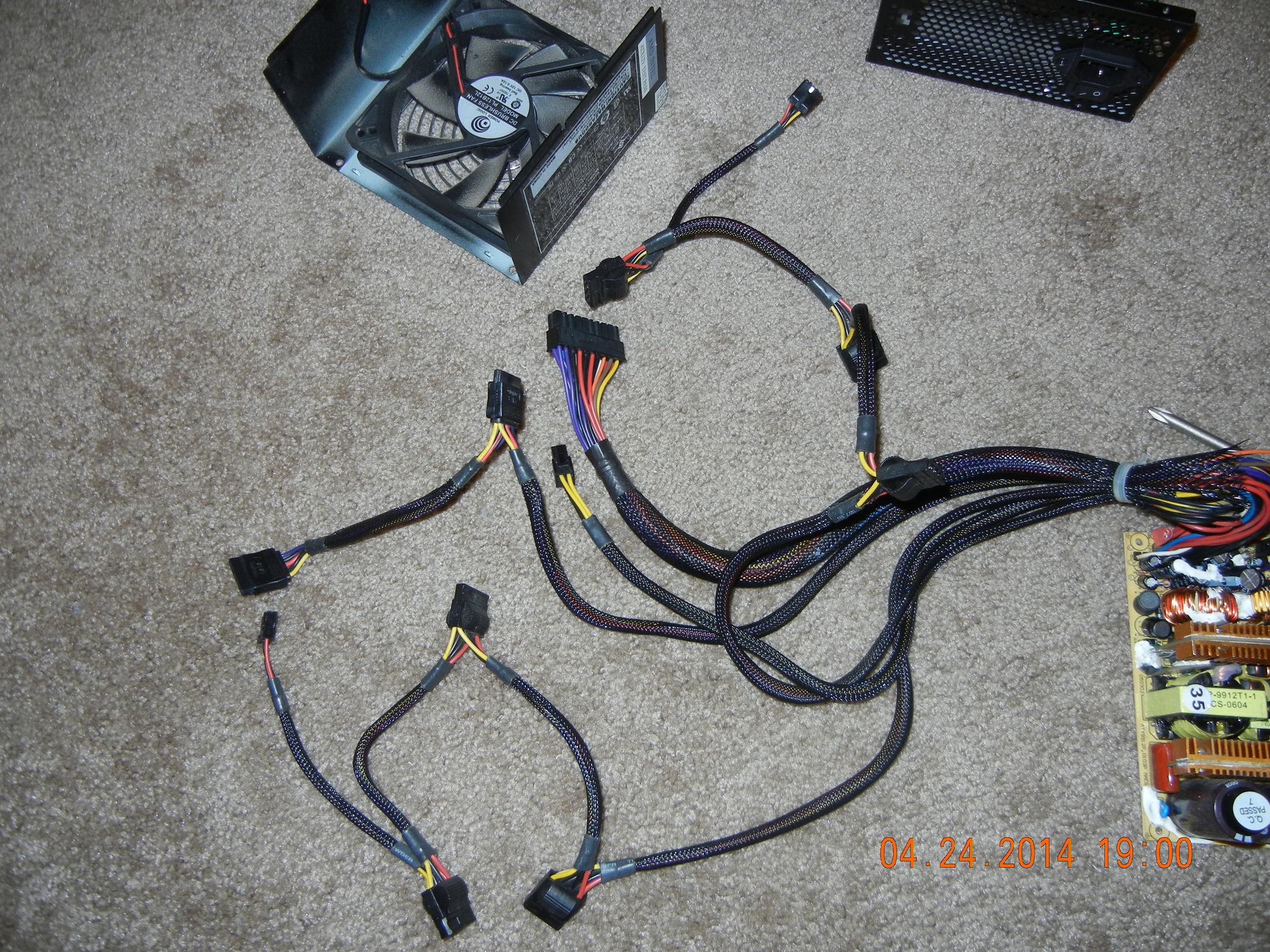

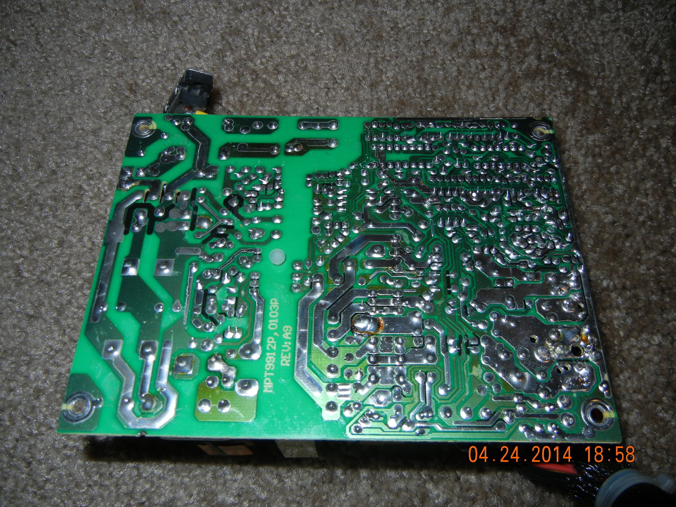

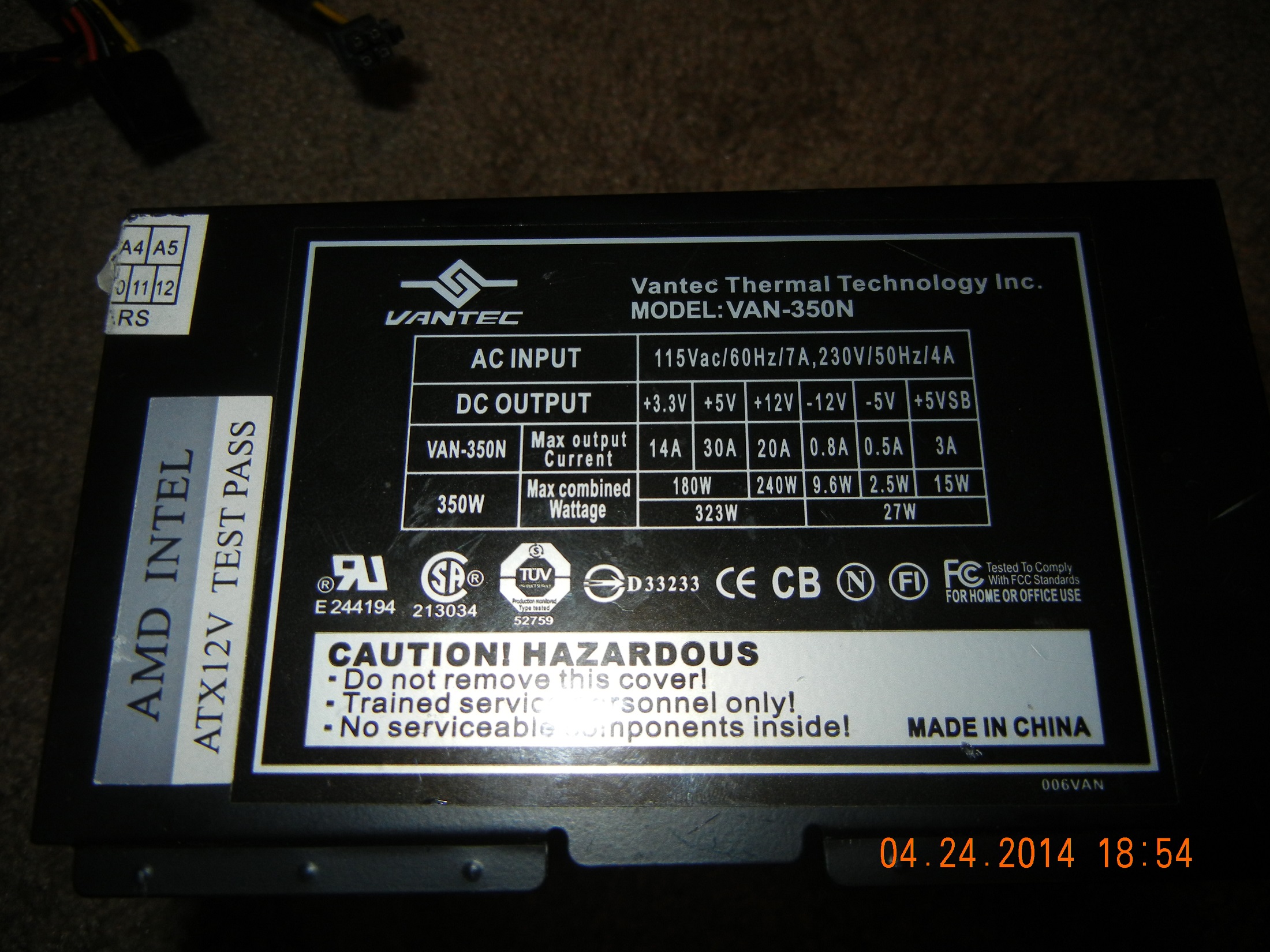

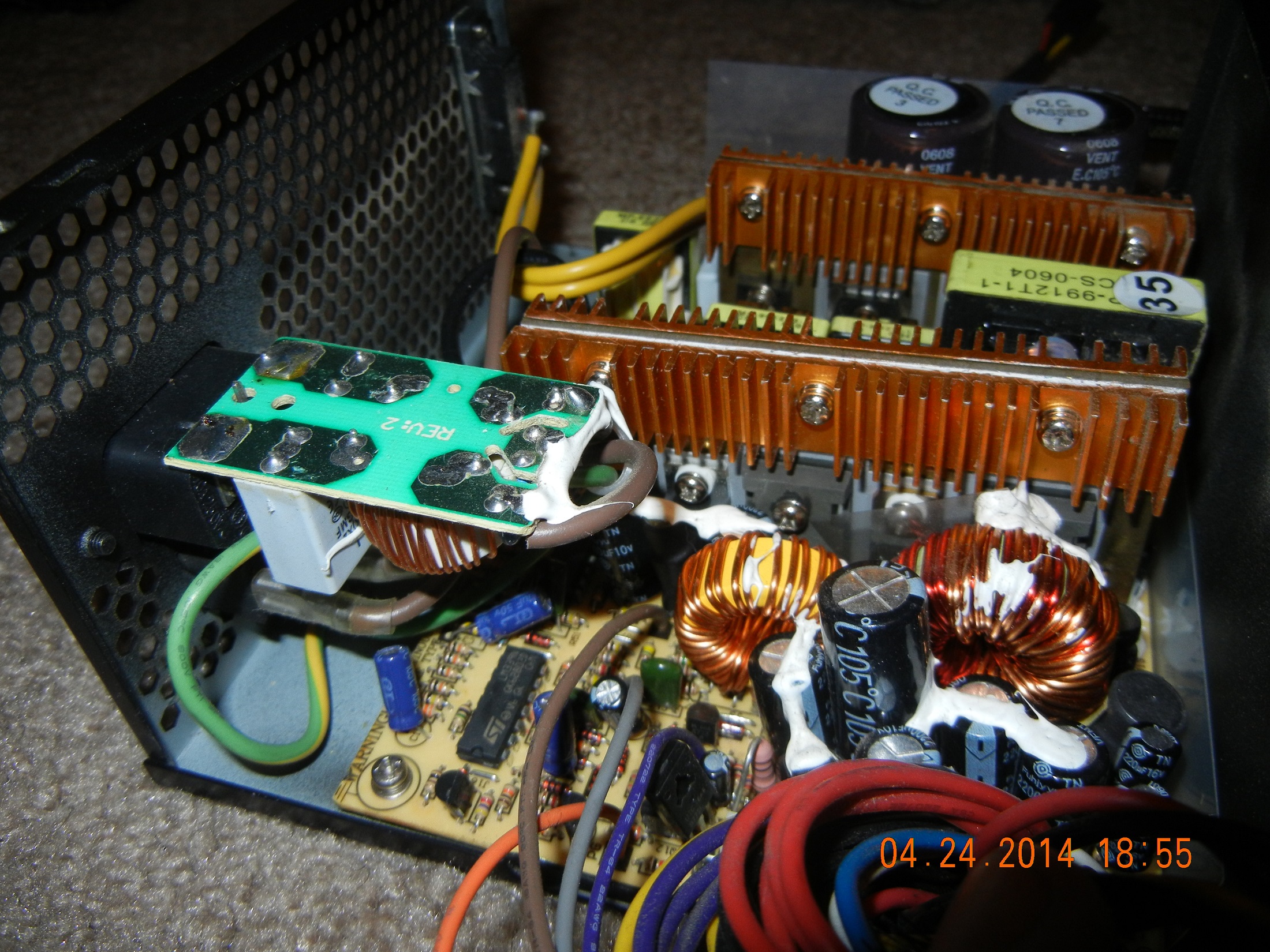

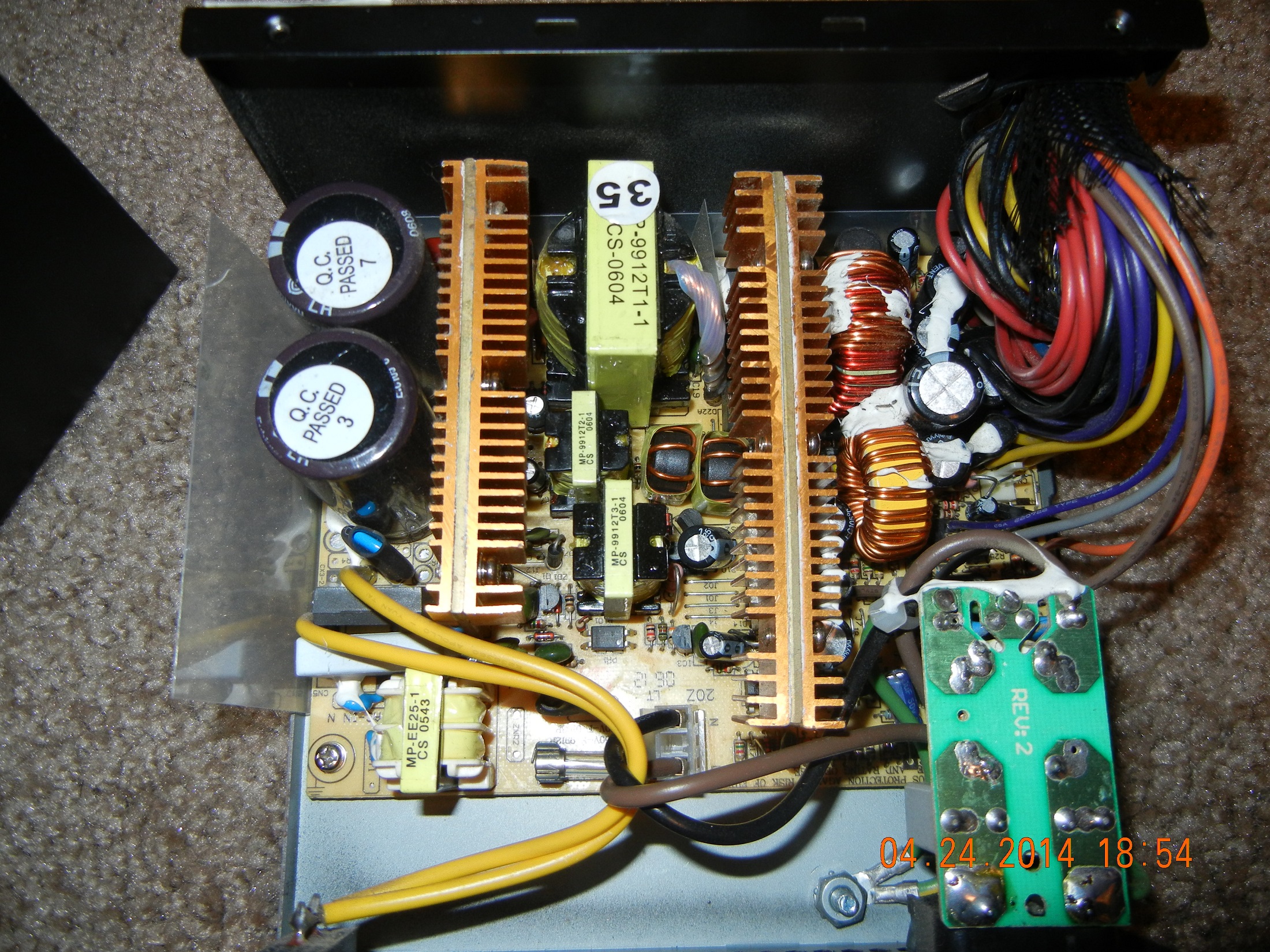

                Vantec VAN-350
                I saw this Vantec power supply sitting in the used pile at the local computer recycling center, for $8. Once I glanced through the grille and saw the Power Logic logo and Fuhjyyu caps, I figured it could only be...Macron!
                It looks like a beefed up MPT-301. It's definitely overbuilt for 350W.
                Full input filter (with a nice MOV), 8A bridge, 1000uF input caps, huge for 350W! Must have great hold up time. Switchers are Fuji Electric 2SC3320's rated for 15A. 5V has two 40A schottkys, 12V has two 16A ultra fasts in parallel, 3.3V has single 40A schottky. Besides a few blobs, the soldering looks pretty good. Surprisingly, none of the caps are bulging, they may be out of spec though. TL494 and LM339N IC's. Nicely sleeved cables. Besides new caps, all it really needs is maybe a 12V silicon upgrade, and a 4 pin addition to make the motherboard connector 24 pin

                  #1768
                  Re: Vantec VAN-350
                  Yay, a Macron! That's another favorite of mine. This particular design is very solid. It's simple, but a workhorse nonetheless (with good caps). I see they used the white glue on yours. The regular MPT-301 usually use the tan crap.
                  Just watch out for those loading resistors on the output. I see a 10 Ohmmer near the 3.3V caps. There's probably a 24 Ohm in heatshring tubing on the 5V rail. I suggest moving the 24 Ohm to the 3.3V rail, and installing a 50 or 100 Ohm on the 5V rail. The 12V rail doesn't really need one if it will be used in a 12V-based system. IIRC, there may have been loading resistors between -5V raild and 12V rail and -12V rail and 12V rail. But anything dissipating over 0.5W should be changed, IMO.
                  Nice!
                  Micro Center used to sell used OEM PSUs for $5, but they stopped now for some reason (maybe out of stock). I was always tempted to buy one each time I went there, but never did. Saw many HiPros, Deltas, and Lite-ONs. Kind of wish I did now. Last time I saw an older 250W Newton geared towards a 5V-based system. Looking through the grilles, it was packed full of UCC and Rubycon caps. Only downside was 2-transistor 5VSB and the 5VSB transistor was free-standing (no heatsink). I should have still gotten it, though.
                  Also that "AMD INTEL ATX12V TEST PASS" sticker.
                  Great find! One computer will be very lucky to have this.

                    #1769
                    I like them too, besides caps, they make some really quality units.
                    Yeah I'll change around the resistors, I have some 100Ω ones sitting in my stash just in case. I haven't run into any issues yet by removing just the 12V dummy resistor.

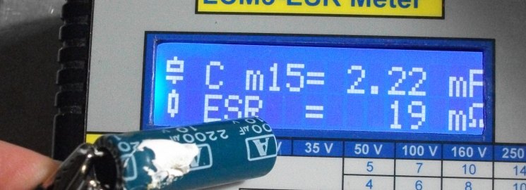

                      I took some esr readings on that cap with no vent from the AT HIPRO. It doesn't seem to be leaky or out of juice. The psu runs the fan at 12V always, not temperature controlled, very loud. Also that server worked in a comfy 20C enviroment.

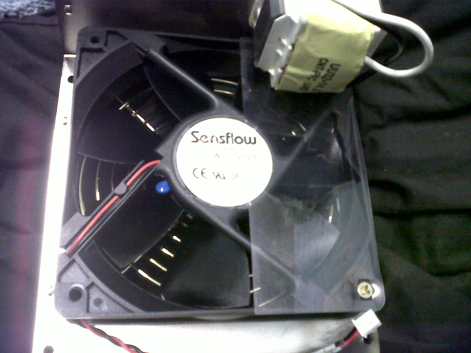

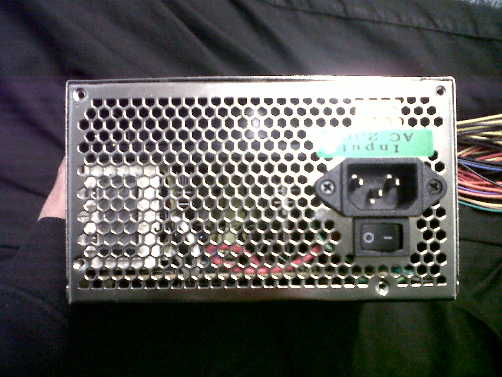

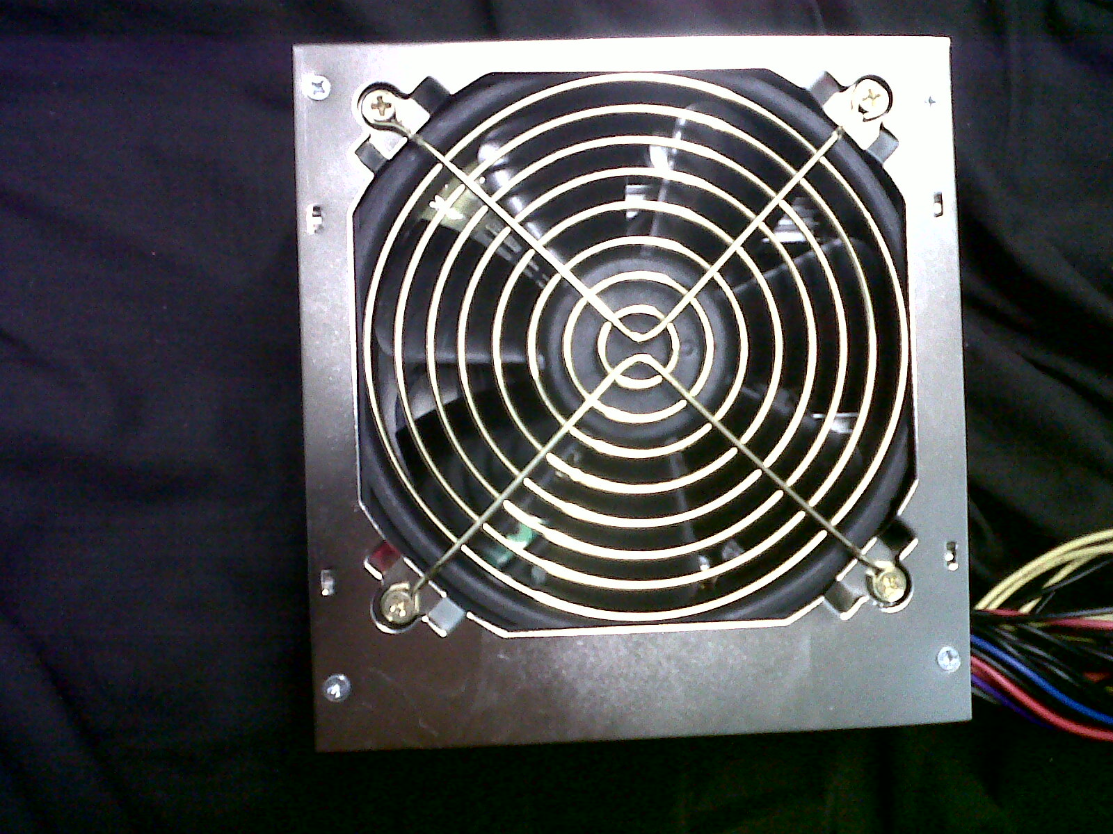

                        a question.
                        has anybbody seen a psu with a 120+mm fan that's half blocked intentionally so all the flow goes to the front of the psu where the heatsinks are?
                        i just got one - it's really strange to see!
                        (EZcool 650w - yea right!)
                        • goodpsusearch
                          • Oct 2009
                          • 2850
                          • Greece

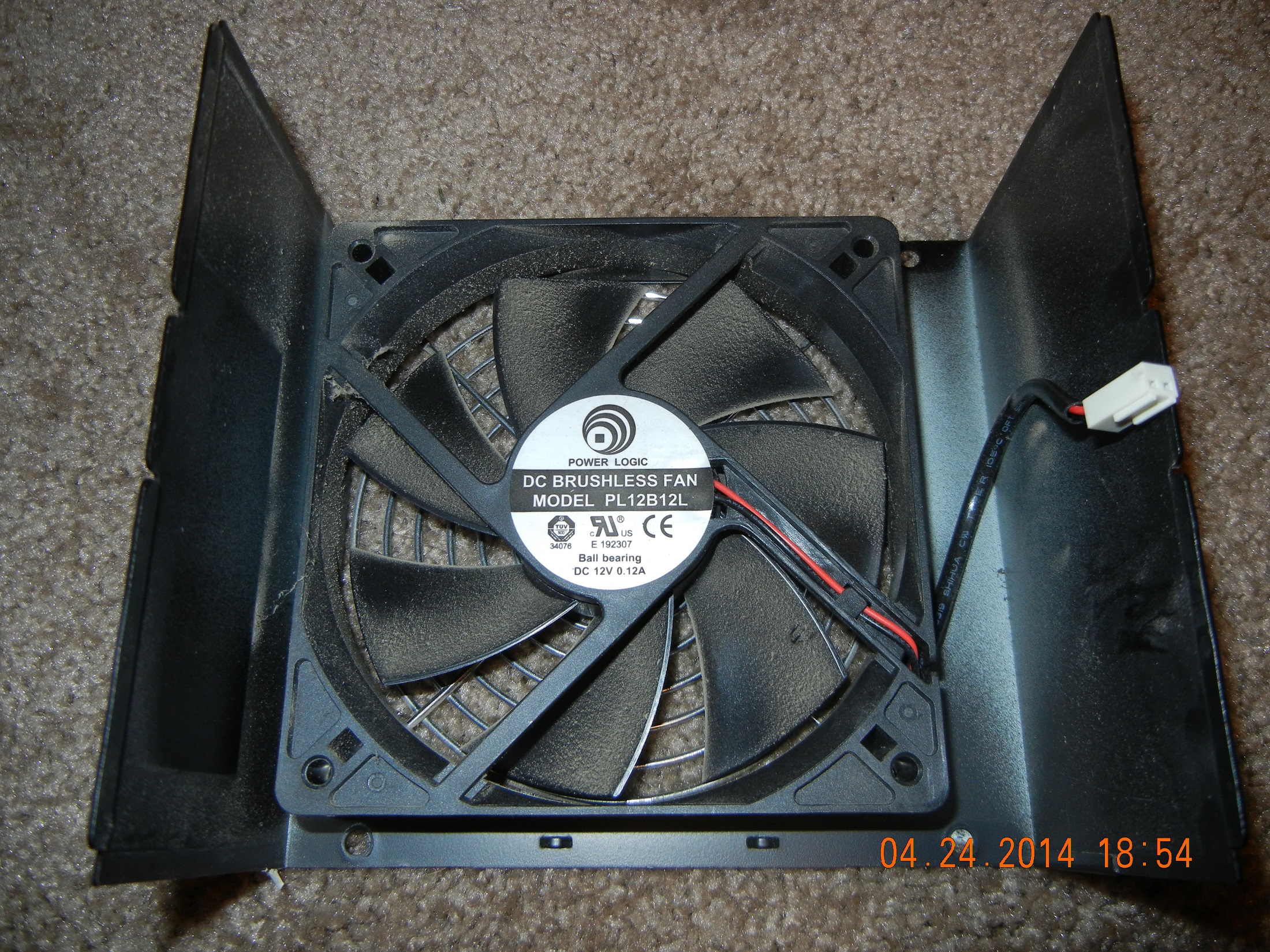

                          #1772
                          Most of modern psus with 120+mm fans do that with a plastic sheet.
                            • 31288
                            #1773
                            yep, plastic sheet screwed&glued.
                            first one iv seen though.
                            pointless given the fan even at 12v was silent and almost flowless.
                            and very blue - atleast the leds worked!
                            i replaced it with a max 94cfm thermally-controlled Delta i had spare!

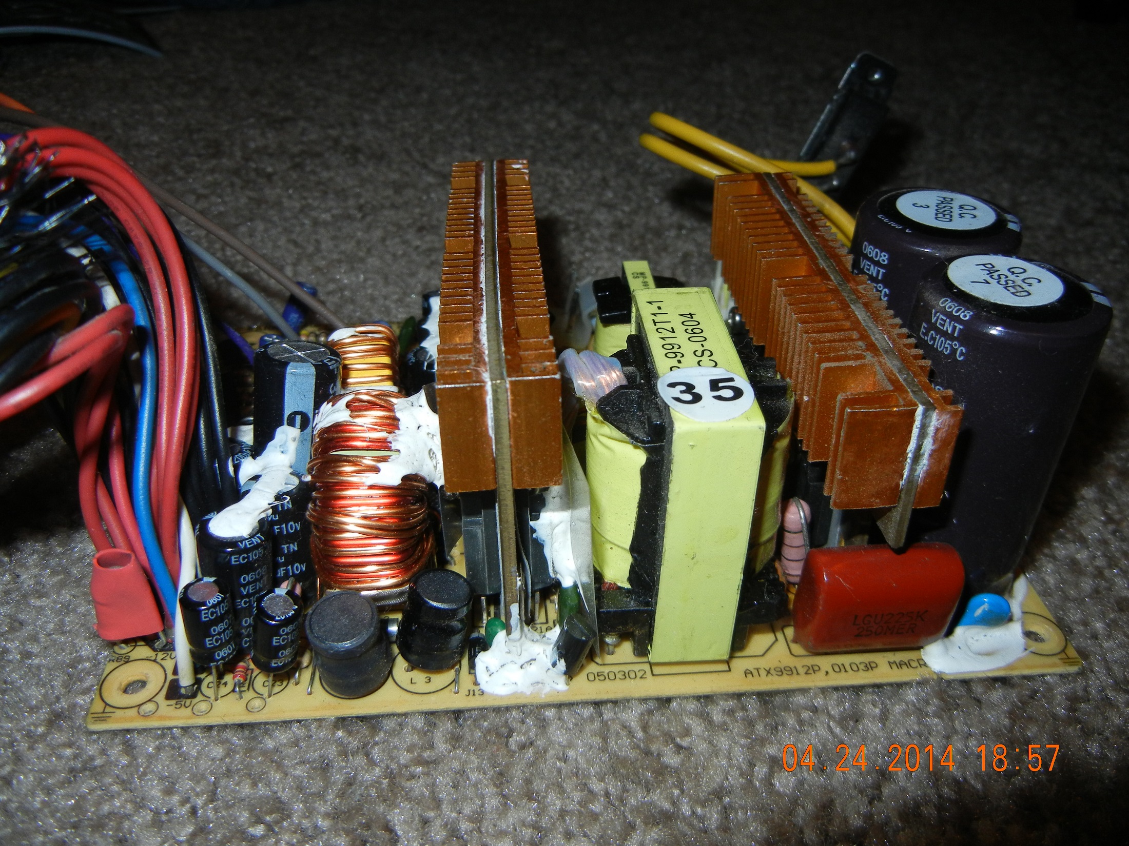

                              #1774
                              Those MPT-30xxx and 40xxx units with the atx98xxx patform lack the Pi coil on both 5V and 12V rail.
                              That's true. I bet they could do ripple in spec, although it would be nice to have the PI coils

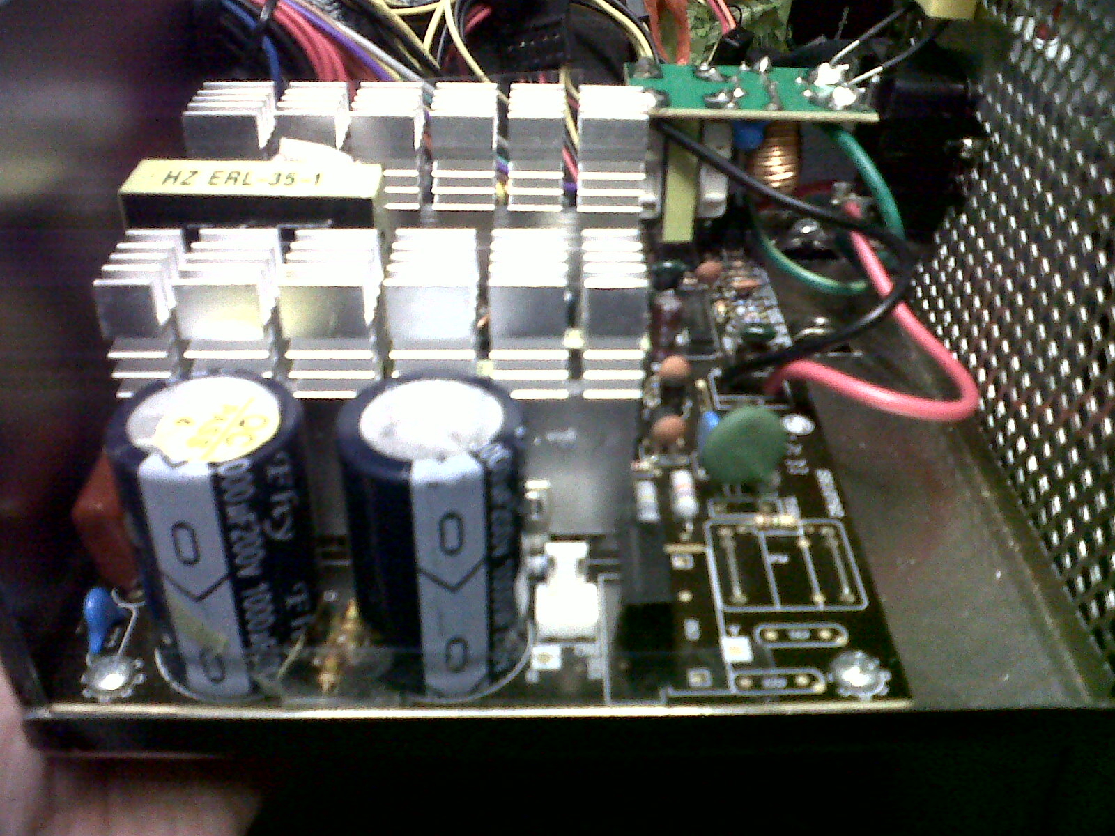

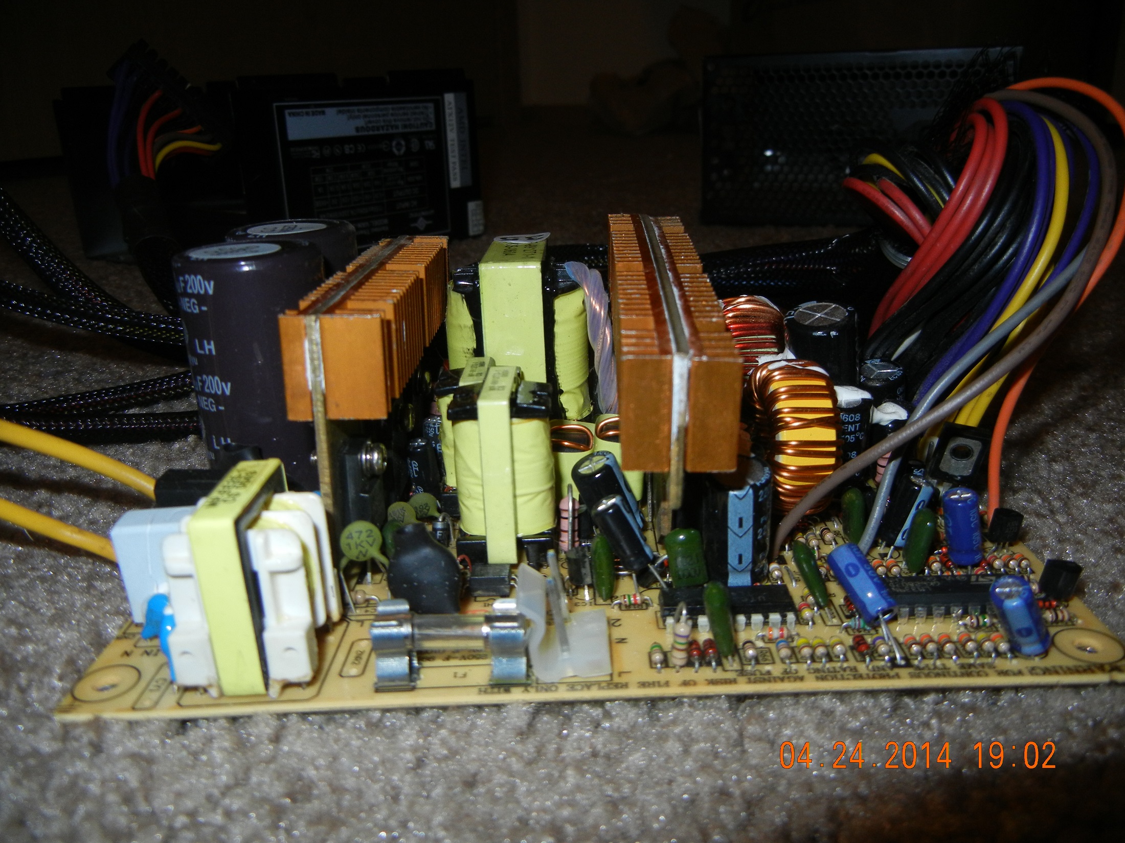

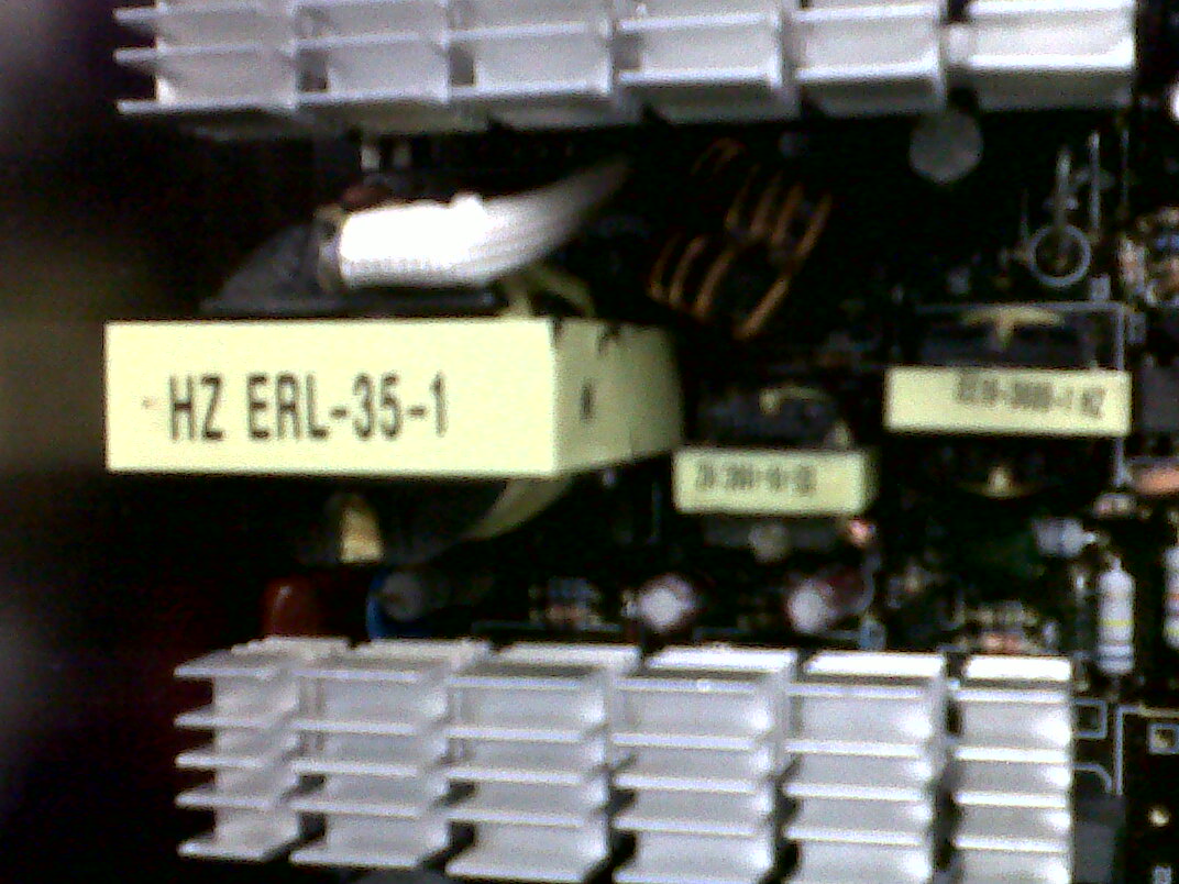

                                #1775
                                i'll pull the case open later & let loose with the cam.
                                i was going to share anyway incase someone can id the actual make.
                                  • 31288

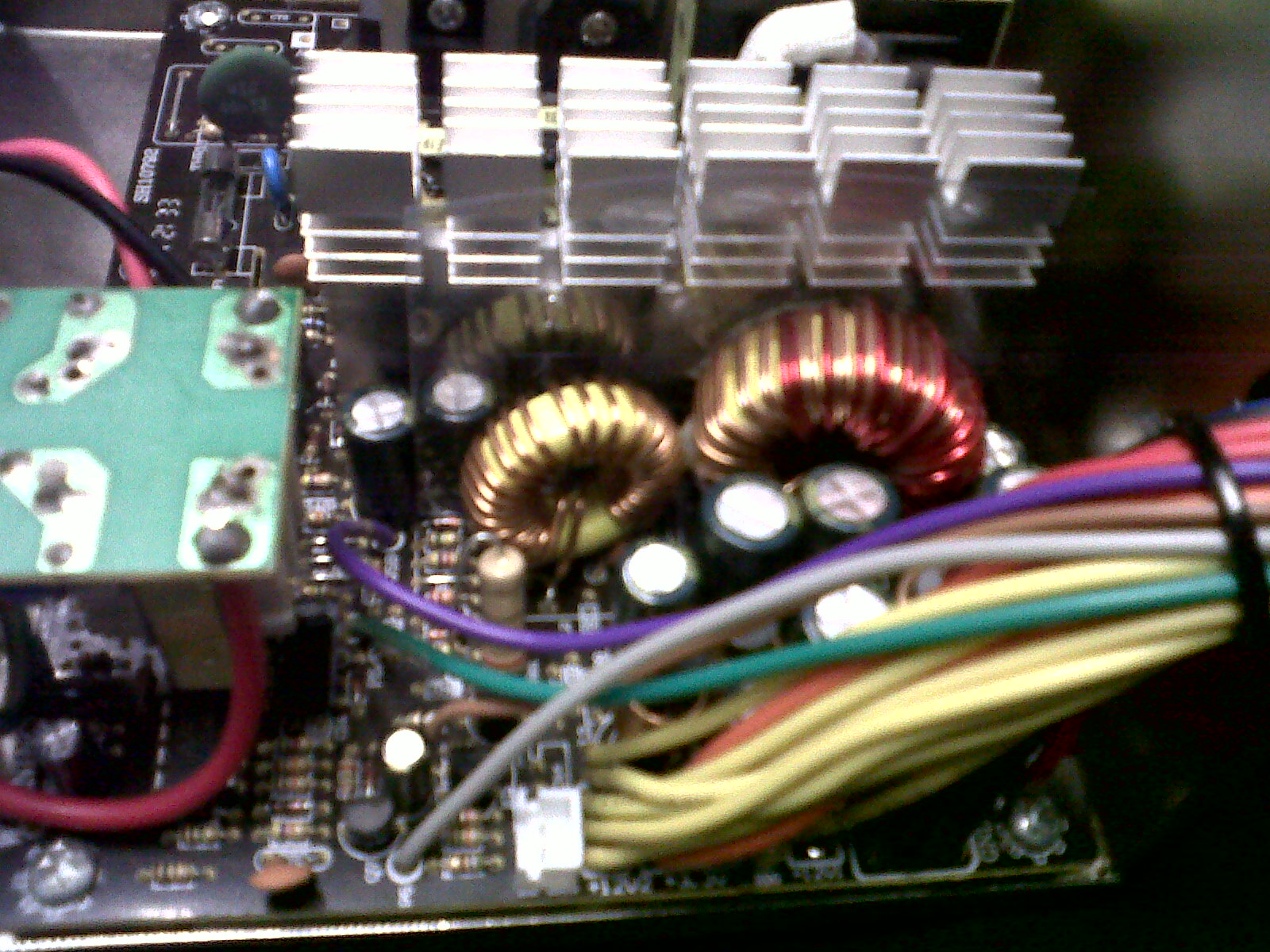

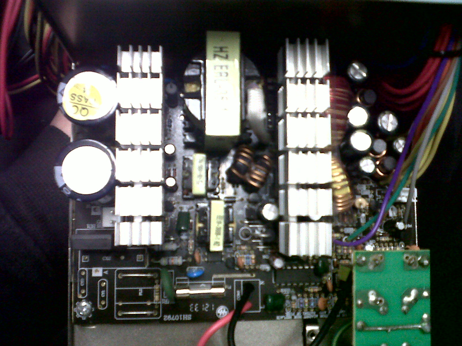

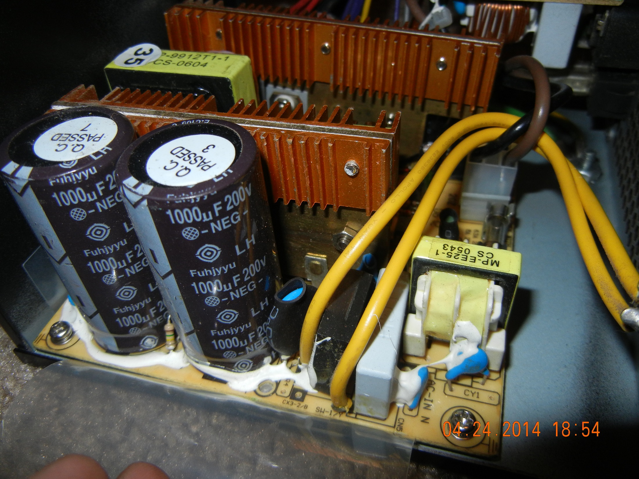

                                  #1776
                                  o.k. you asked for it!
                                  this really is a pile of crap.
                                  primary caps are 1000uf 200v "Fhy" brand.
                                  it uses passive PFC (it's under a year old!!!)
                                  bridge rectifier is kbl406
                                  primary transistors are wi3009-0 in to247 large package.
                                  controller ic is az7500bp
                                  secondary caps are "chengx"
                                  this "thing" claims the following spec.
                                  3.3v 38a
                                  5v 40a
                                  12v(1) 20a
                                  12v(2) 20a
                                  -12v 800ma < probably the only honest value!
                                  5v-standby 3a
                                  total 650w
                                  the standby circuit looks like it's just a fet driven transformer with opto-isolator feedback.
                                  about the foto's - that's NOT the original fan.
                                  • mariushm
                                    • May 2011
                                    • 3799
                                    #1777
                                    The plastic is there to direct the air flow towards a region of the power supply and cool it better.
                                    Without it, a large volume of the air would just get out directly through the grill in the back of the power supply and on the other side you'd get some points where air would be "stuck" in place and not move through the case properly.
                                      • 31288
                                      #1778
                                      i understand that,
                                      but just blocking the airflow is a waste of energy, if it was angled at 45' instead of 90' it would put a lot more air into the target.

                                        #1779
                                        Looks like a decent PSU after some new caps. I'm not sure who the OEM is but it looks similar to this "Shaw" PSU that c_hegge reviewed: http://hardwareinsights.com/wp/the-2...ply-roundup/4/ I bet those Fhy caps are ~680uF
                                        • goodpsusearch
                                          • Oct 2009
                                          • 2850
                                          • Greece
                                          #1780
                                          It looks like a 350 watt psu, maybe able to do 400W not for a long period of time.
                                          It is important to test the primary caps real capacitance and check secondary rectifiers ratings.
