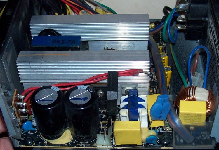

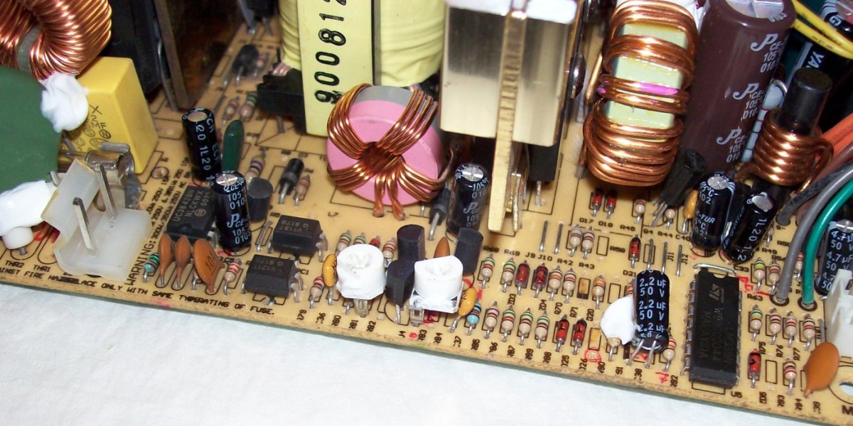

    I recieved a bunch of atx psus to fix them asap. Some of them had signs of repair attempts. Two lightweight guttless mtec, and jnc went to the thrash imediatlely.
    This ATLAS has pfc and somewhat decent buid, but it's clearly not going to do 400W. According to the markings it may be a DEER. That smd chip has "2003" written on it. Came with missing caps and blown mbr1645 on he 12V rail. Put and mbr2045 there and recapped it. Works.

      #762
      But is it a real PFC coil or a fake one made from concrete?

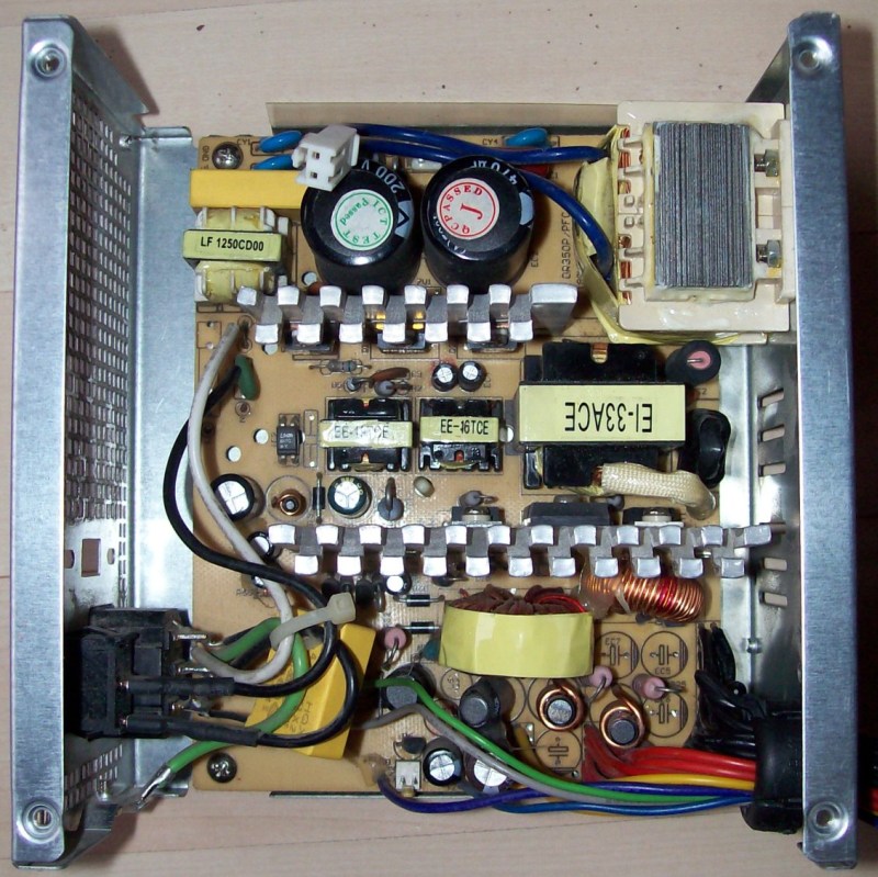

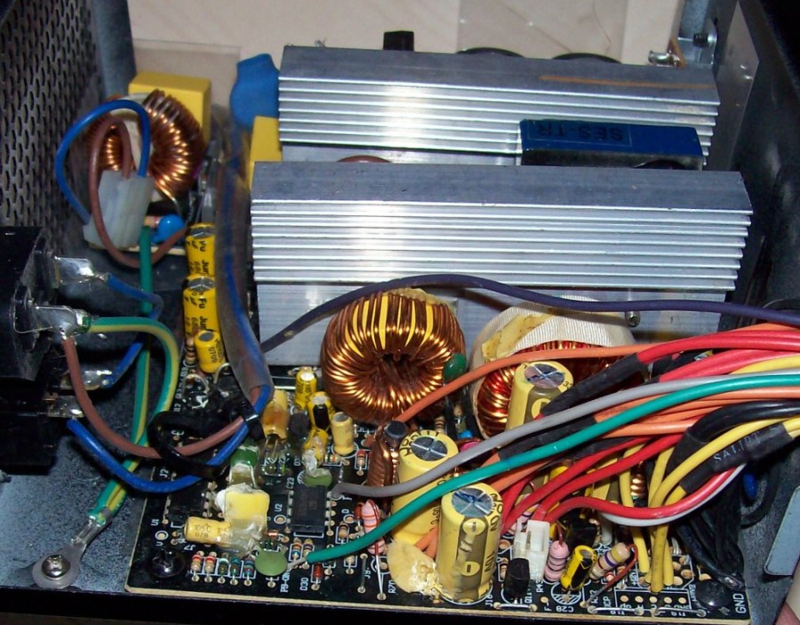

        Next was an FSP300-60PLN that had a stuck fan. I removed the dust and replaced all the caps, primary too just in case.
        I thought the 480W Xilence is probably just bad caps... I was wrong.
        It's a mess. Pcb is like a black dried waffel, buid is clumsy and component ratings are lame. All wires are 20awg and this unit has 8pin cpu and vga! Look at those resistors tied together on the primary. Soldering is a mess too.
        Are those even real Panasonic caps? One cap on the secondary simply fell out when I dissasembled the case.
        This is how it came out of the factory.
        The claimed OCP is non existing. Label says: WARNING - HAZARDOUS

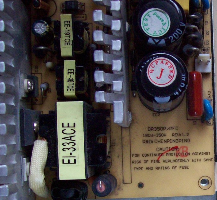

        Since I've gone into details for this one let's see the component list.
        Somewhat decent emi filtering.
        6A bridge rectifier.
        Two 470/200 Matsushita primary caps.
        Two 2sc2625 transistors and 2n60 fet for standby.
        5V and 3.3V has an mbr3045 each. 12V has one mbr1645.
        All the small and secondary caps are GL.
        Connectors and the fan are red... wow
        This unit is a truly late-evening-shift product

          #764
          I looked closely on the pfc coil and it has wires
          or they made a realy good pattern into the mold and even painted it copper
          also has a polyester capacitor in it.

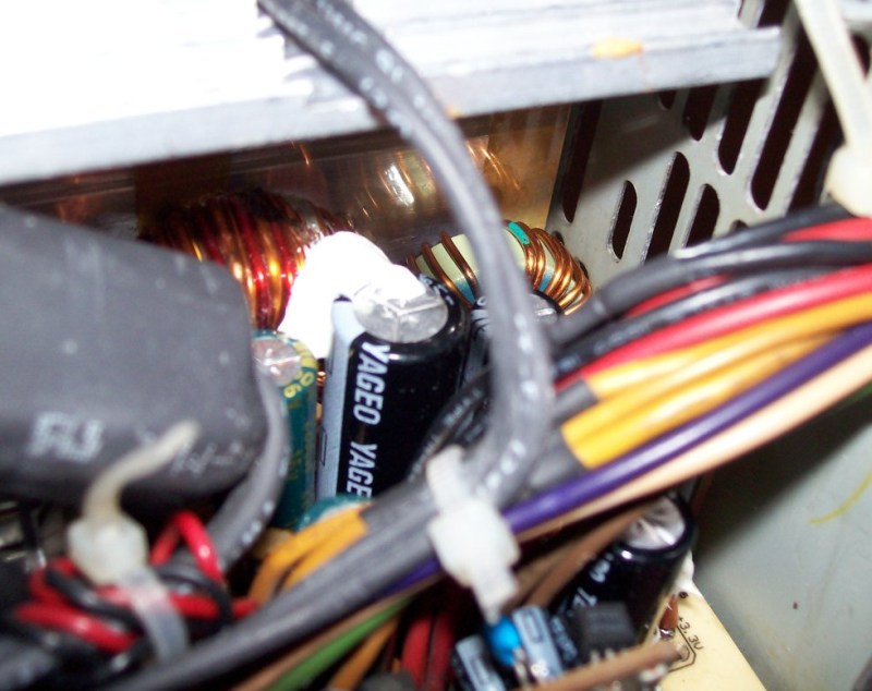

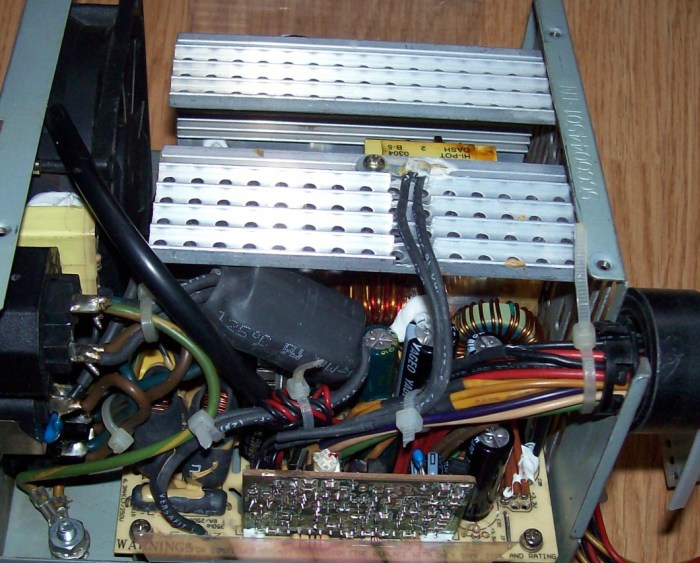

            Last one from the bunch.
            A somewhat modded Enermax EG465P.
            It had wierd secondary caps among the originals which were probably from motherboards I think. Those caps were out of spec and the psu didn't start. Someone added trimmers to adjust voltages too. I really wanted to keep this unit.

              If you don't mind me asking, what are the schottkys of the FSP300-60PLN? ^^; It looks like it has an ample amount of power on the +5V and +3.3V rails so I would think at least 30-40A for both those rails...

                That Xilence one is a Leadman.
                EDIT: Don't tell me you're recapping them with Teapo!
                  Secondary diodes are 5V: MBR4045; 3.3V: MBR3045; 12V: MBR20100.
                  The unit has 20pin motherboard, 4pin aux and a bunch of peripheral cables. I think it's an oem unit for hp or dell systems maybe.

                            • 4059
                            #773
                            WOW, that xilence is a real piece of crap!
                            And that Atlas has a real PFC coil!
