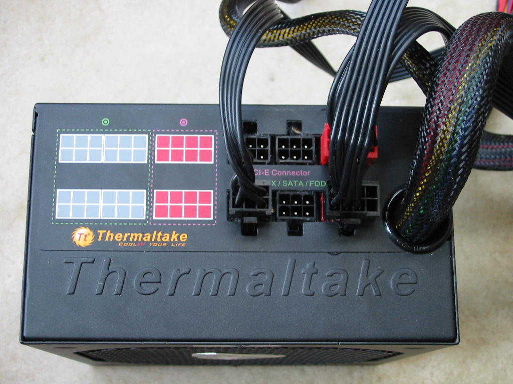

      Front (modular connector panel):
      https://www.badcaps.net/forum/attach...1&d=1504989516

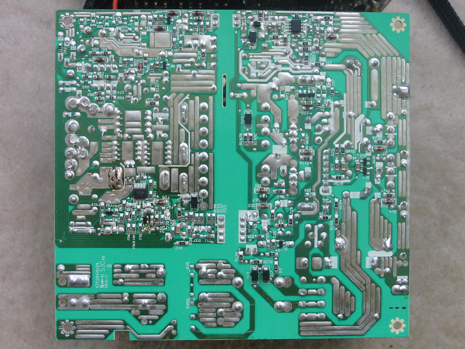

      Bottom / solder side:
      https://www.badcaps.net/forum/attach...7&d=1497722153
      https://www.badcaps.net/forum/attach...8&d=1497722153
      https://www.badcaps.net/forum/attach...9&d=1497722153

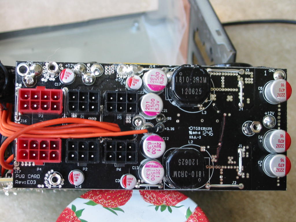

      DC-DC buck regulator board for 3.3V & 5V rails as well as modular connector:

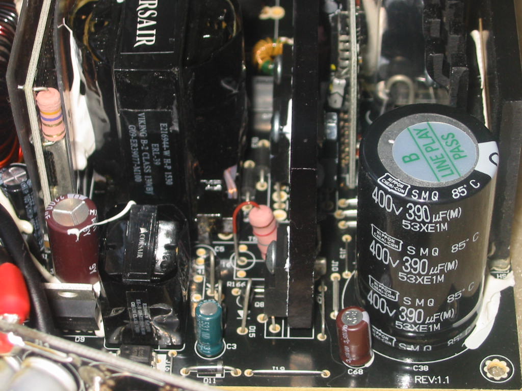

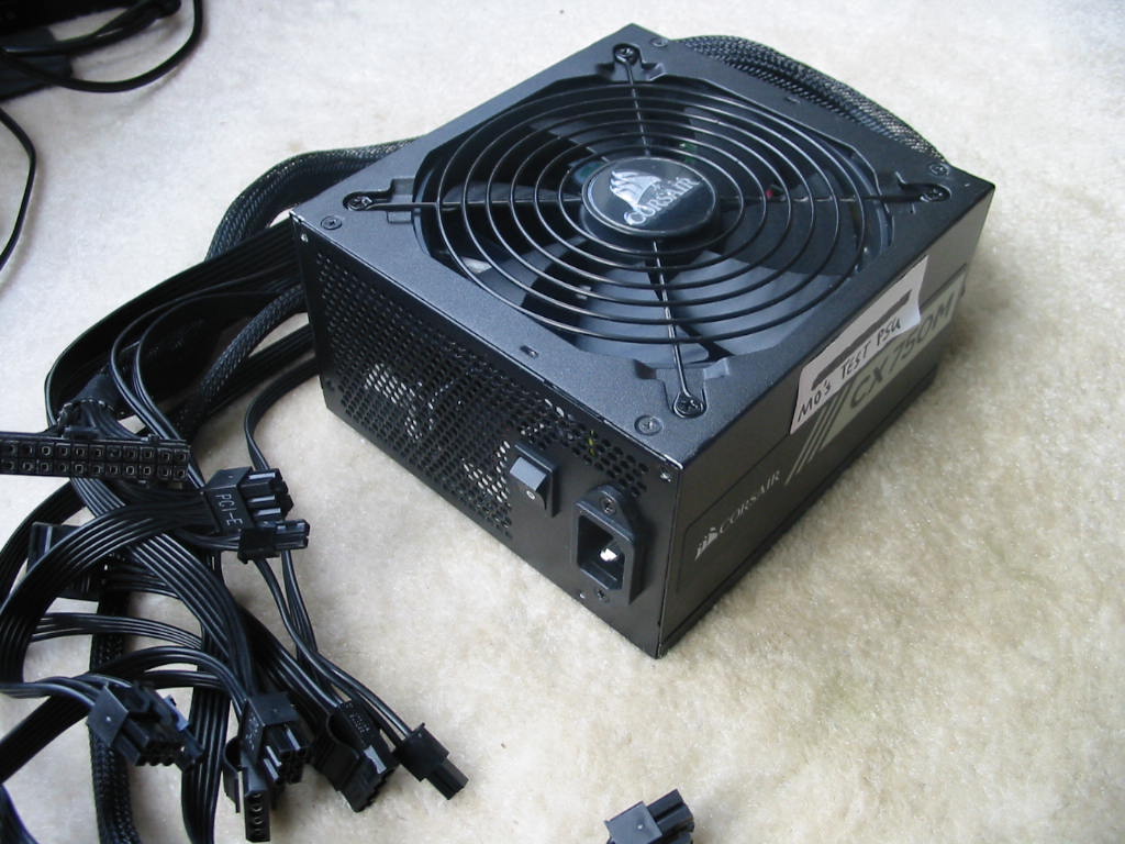

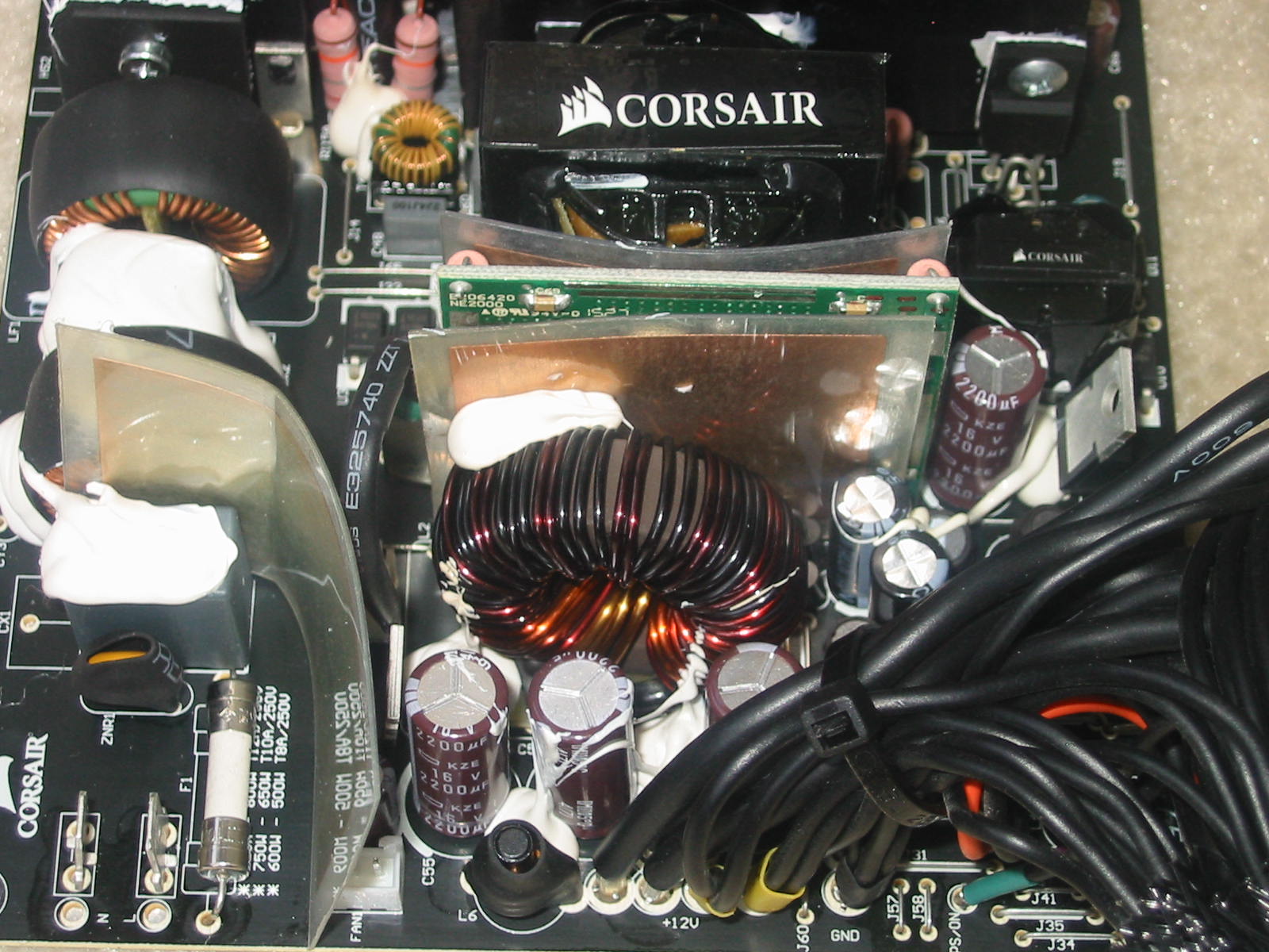

        This time I have a Corsair CX750M for you (model 75-002019). No detailed component break-down again, as there are many reviews of this PSU already. Here they are, if you like to read:

        And here are my pictures. I will start with an overall shot:
        https://www.badcaps.net/forum/attach...1&d=1505081452
        Top removed:

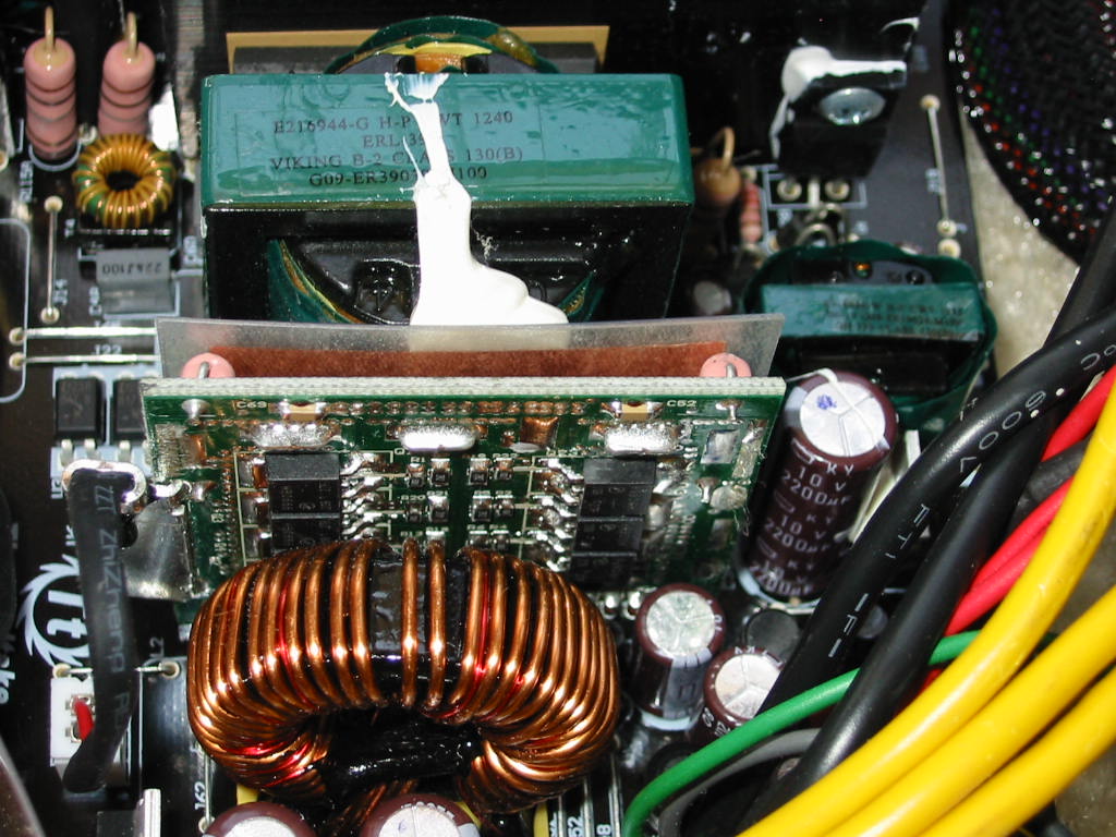

        Primary Side:
        Secondary Side:

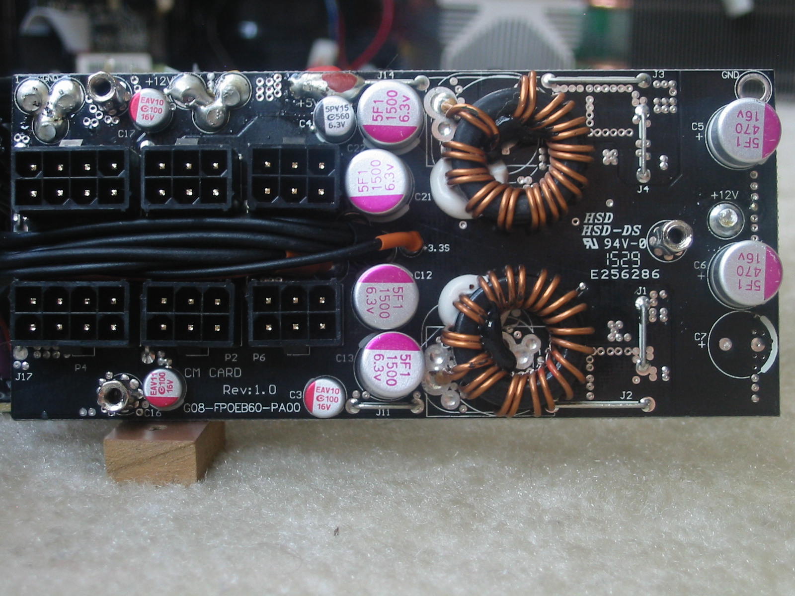

        DC-DC board with modular connectors:

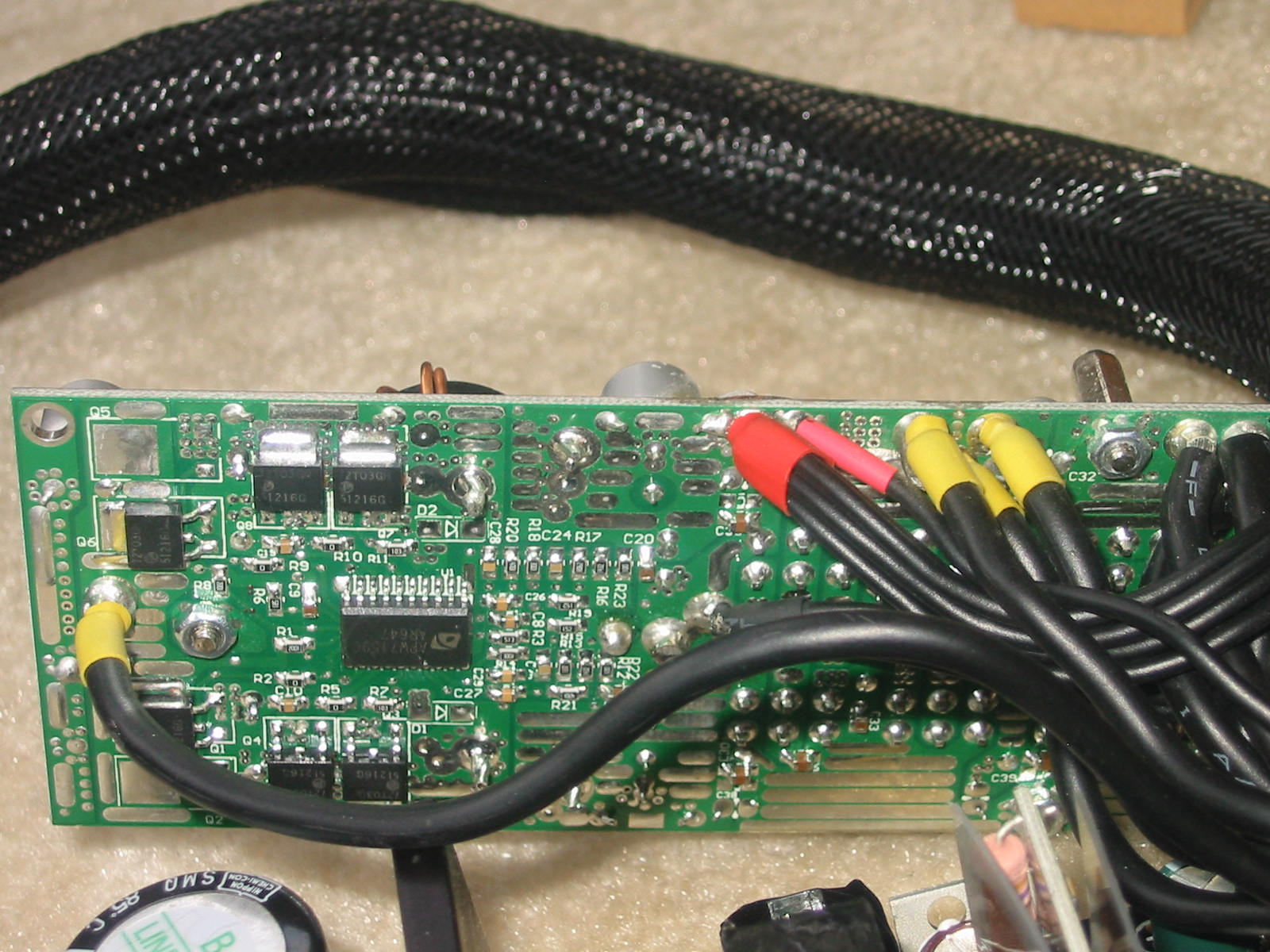

        Solder Side:

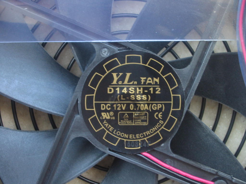

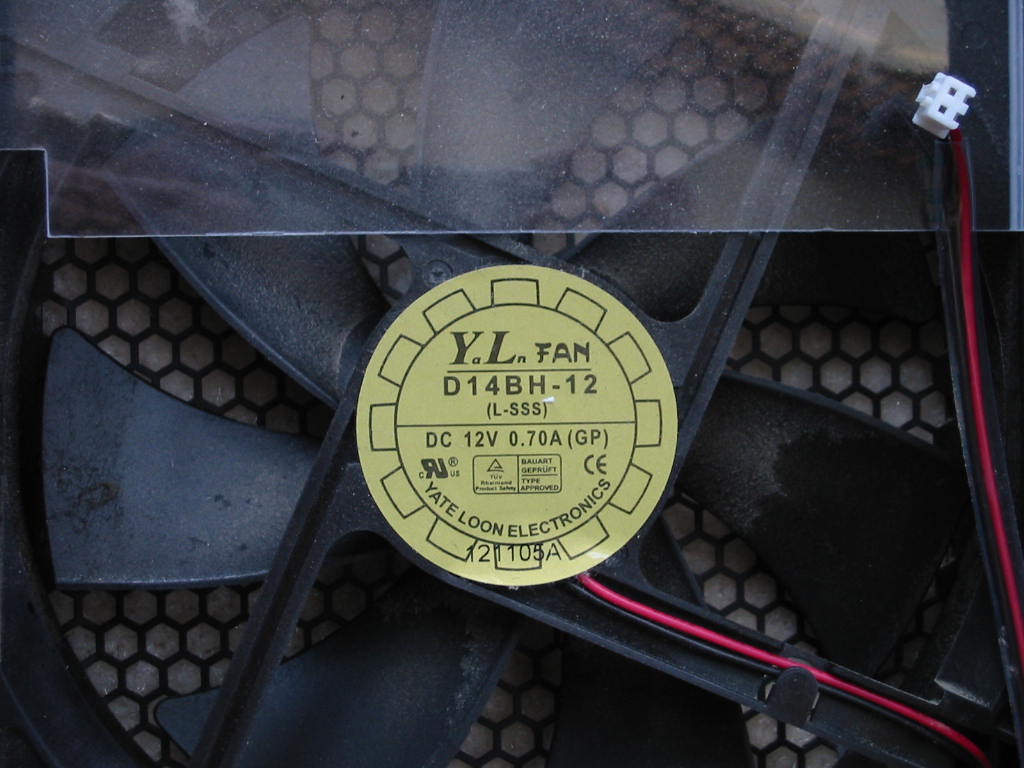

        Fan:
        https://www.badcaps.net/forum/attach...1&d=1505081550

        I got this PSU a few months ago for free because it was said to emit a bad/burning smell. For a long time, I could not find anything wrong with it or where the smell was coming from, so I used the PSU for short testing. But then one day, I used it for about 30 minutes and that smell came back. Turned out to be the output filter inductor for the 12V rail. You can see in the above picture of the secondary side that the wire is quite darkened. Indeed this is what what emiting the smell. After running the PSU again untill it stank and then opening it, I checked the temperature on the output filter inductor, and it was showing over 120°C on my thermocouple meter.
        So yeah, this PSU also has a problem, just like its bigger sibling posted above. However, this one has it with the output inductor, whereas the Thermaltake one had a blown primary cap and fuse.
        Two major random failures for this platform doesn't exactly inspire confidence IMO. We also had another at work a few months back, but I didn't get to open that one to see what was wrong. In any case, these aren't that reliable, it seems. Or maybe I was just unlucky to see that many go bad.

          390uF for a 750W and 470uF for an 850W is a joke.
          680uF should be the bare minimum. 390uF is something you'd expect in a 500-600W PSU, maybe even 650W...
          Besides:
          Do you know why the cap and the coil failed??
          PS: Interesting that you see the PUQ only with some kind of 'modular' module and DC-DC.
          Makes me wonder if CWT tried to sell this plattform to OEMs - and they didn't want it.
          And the DC-DC module is some kind of plan B to be able to sell this +12V only unit to consumers...
          €dit:
          WIth the corsair unit, doesn't look the primary switcher heatsink discolored too??
                          Yeah, that's true.
                          Nope. Both were customer units from what I know.
                          Though I can tell you that the Corsair came out of an average modern build with a GTX 1050 or 1060 video card and some i7 CPU, if I remember correctly - nothing that drew more than 250 Watts peak under load. So why the output coil burned, I have no idea. Not like anything got in the PSU either - it was fairly clean when I opened it (only a few tiny dust bunnies) and the fan was facing down (in a PC case with bottom-mount PSU). So nothing could have leaked in there to short anything. Looks like just a random failure to me right now. But I could be wrong, of course.
                          I think that's just from my pictures, but I will have a look at it again in more light in the next few days.
                          For now, I am actually thinking of transferring the fuse and primary cap from the Corsair to the Thermaltake PSU so that I have at least one working unit. Not sure what to do about the burned inductor in the Corsair. I'm thinking re-heat and demagnetize, then rewind with new wire.

                          That would be the least of problems for me. I can fix any sleeve bearing to be quiet again and work for a very long time. Ball bearings on the other hand, there's not much to do about them when they go bad.
