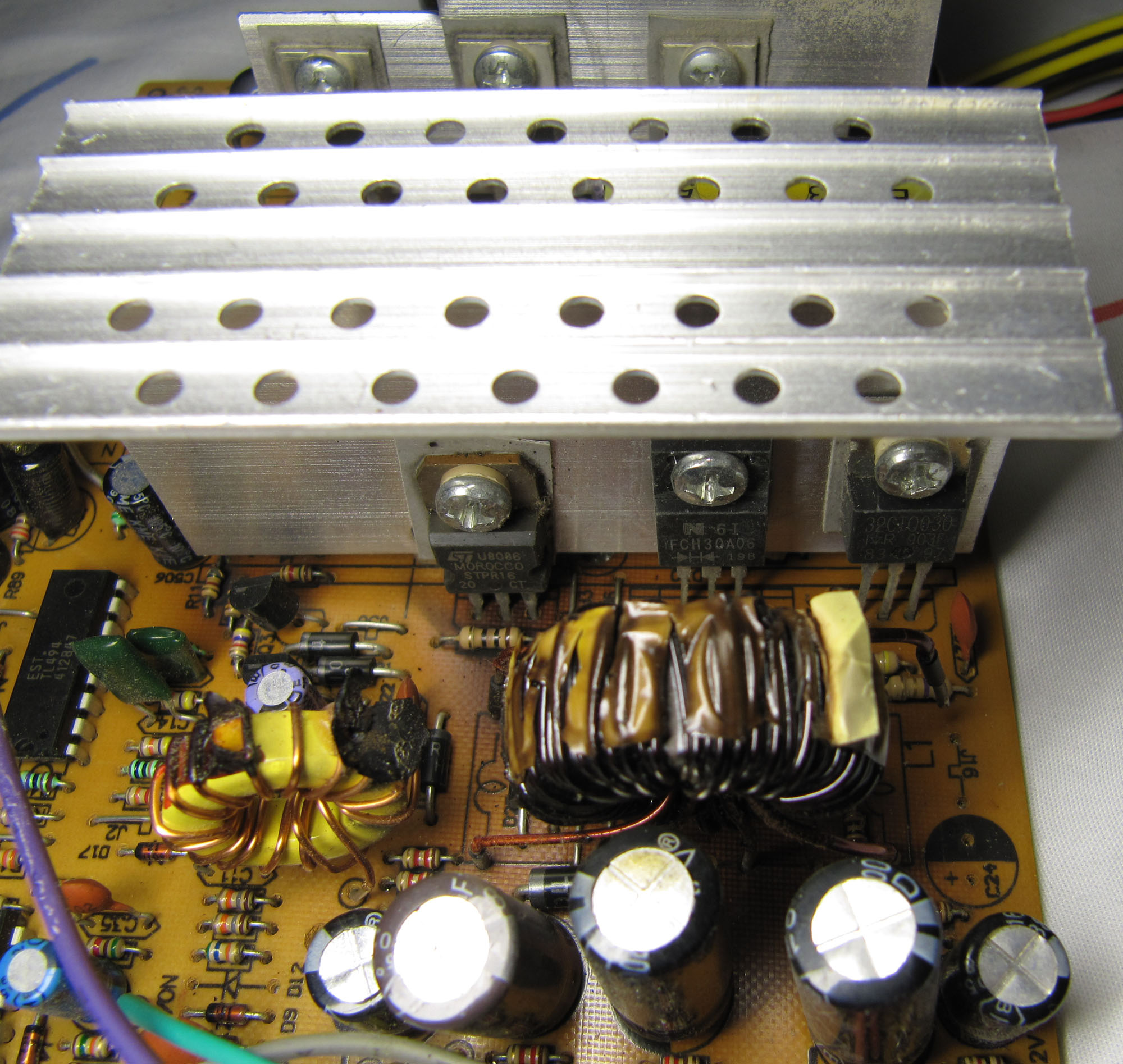

            #1685
            Powertech ATX-450W
            Those things are still available here for 18euros!
            As you can tell from the label, it is an ancient design, come on, 16A on 12V?? But even more strange is the fact that 5vsb is rated 1.5A. 2.0 ampere on 5vsb became a standard more than 12 years ago! How is this thing sold anyway?
            The fan stopped moving and the toroid coil burnt, then desoldered itself from pcb!
            This is one of the worst power supplies I have seen:
            -Inadequate input filter with fake Y caps
            -4 diode treatment with tiny diodes.
            -No PFC. But they placed a connector for passive pfc in the wrong spot. Notice that there is no connector on the "PFC" area of PCB but there is a connector probably for PPFC on a place after the 4 diodes! The most unexplainable, the 2 leads of the connector are soldered on the same PCB trace...
            -The primary caps are only 330uF but at least their real capacity is 340 and 350uF respectively.
            -ERL 33 transformer and 13007 switching transistors
            -16A @ 12V, 30A @ 3.3V and 30A @ 5V
            -No pi coils, except 5vsb. 3.3V and 5V output filter has only 1x 2200uF cap, 12V has 2 caps (1000uF and 470uF) and 5vsb has 2x470uF and a coil.
            -No mag amp coil for 3.3V! The main transformer has an extra output for 3.3V The burnt toroid coil regulates both 5V, 12V and 3.3V! Have you seen something like that before? The small toroid coil is jumpered from PCB, just like the PPFC connector! Can anyone explain why?

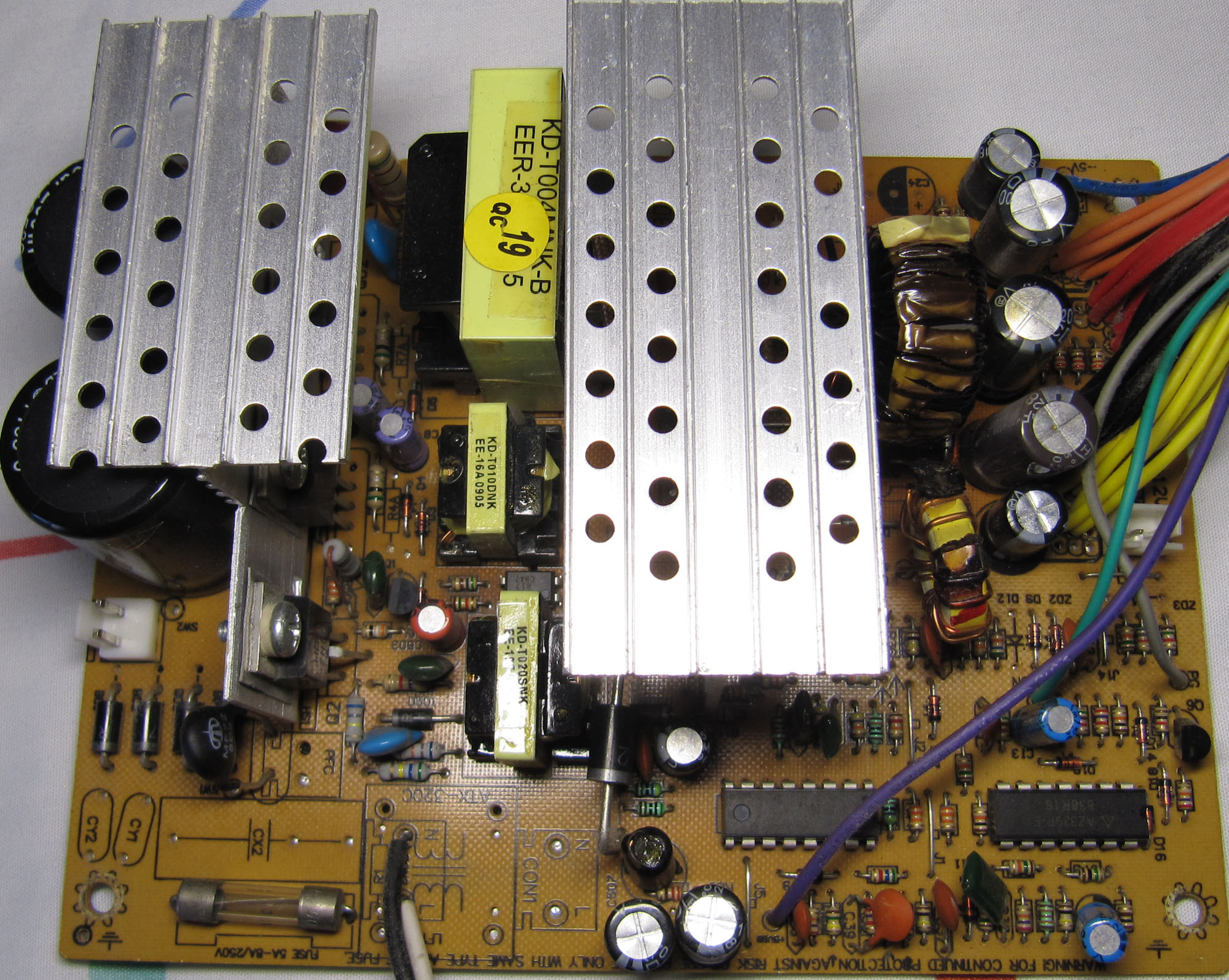

              #1686
              Powertech ATX-450W datasheets:

                #1687
                There is a place for PFC on the right of the heatsink, where that varistor is located. It says PFC on pcb.
                The other connector is for 110/220v selection. I think it's open-220v, shorted-110v, like in this image: http://www.seekic.com/uploadfile/ic-...7102399533.gif (the E switch)
                • goodpsusearch
                  • Oct 2009
                  • 2850
                  • Greece
                  #1688
                  But its leads are shorted permanently.
                  • mariushm
                    • May 2011
                    • 3799
                    #1689
                    On the PFC connector you're basically supposed to connect a large inductor... that's what passive factor correction means. If you short it, you just skip the inductor, no problem but no pfc.
                    Instead of just shorting the connector and have a jumper in place, they used a varistor to limit the inrush current going to the rectifier diodes and the capacitors.

                          #1692
                          Yes, I agree about that.
                          I am refering to the connector they actually put after the 4 diodes:
                          https://www.badcaps.net/forum/attach...1&d=1388768415
                          See? It doesn't make any sense. Whatever you put there (PFC coil, jumper, etc) it is permanently shorted and out of the circuit. I think they really messed up with their designs. I can't find another reasonable explanation.
                          • mariushm
                            • May 2011
                            • 3799
                            #1693
                            Yes, I meant thermistor. Varistors (or MOVs as some call them) are used for other purposes, like protection against excessive transient voltages.
                            re picture above as you posted it just as I replied: yes, that doesn't make sense.
                            If that's really for PFC, it only makes me think the board was designed from the start to have a fake passive pfc inductor. At some time, there were lots of power supplies with fake pfc inductors.
                            But if it's for 110/220v selection, then it's just an issue of connecting that to ground or to neutral, so it's possible only one wire in that connector was used and the switch was connecting the wire to neutral or ground - i forget now exactly how the connection is made and I don't feel like looking it up.

                                #1695
                                Because it's a cheap crap PSU, that's why. I really can't make any sane explanation other than that.
                                All I can say is, I've seen this before in a extremely cheap L&C/Deer PSU where the traces on the PCB bypassed the PI coils on the outputs. Yet for some reason, L&C must have forgotten about it, so they added PI coils in the PSU. Really funny because those PI coils did exactly nothing. I think I uploaded pictures of this somewhere, but I can't seem to find where.
                                Anyways, those PI coils did find a new home, though. I pulled them out and installed them in another L&C that didn't have any and didn't have those stupid bypassing traces.
                                Yes, only once. It was in a gutless Cyberlink PSU built by Channel Well Technology (it's based on their ISO line, but extremely stripped down). I don't think I have uploaded pictures of it yet, but I definitely should (in the gutless thread, though). It powered a Pentium 4 PC that drew its power from the 5V rail. How it didn't die, I don't know.

                                  #1696
                                  Wait a minute, If I'm tracing things out correctly, it looks like the smallest coil is actually in charge of the 12V output, and the larger burned one just does the 5 and 3.3V rails. That's very weird design, though.
                                  • goodpsusearch
                                    • Oct 2009
                                    • 2850
                                    • Greece
                                    #1697
                                    The smallest coil is shorted by PCB.
                                    Here, have some pics that show it better:
                                    • c_hegge
                                      • Sep 2009
                                      • 5219
                                      #1698
                                      Ah, Ok. I thought the small coil was where the diode is, although this means that the 12V had no toroid coil at all! I would hate to think what the ripple would have been like. I actually feel sorry for the system it was powering.
                                      • goodpsusearch
                                        • Oct 2009
                                        • 2850
                                        • Greece
                                        #1699
                                        All the lines, including 12V use the burnt toroid coil....
                                        • c_hegge
                                          • Sep 2009
                                          • 5219
                                          #1700
                                          Ah, yes, I see that now. Sometimes, it really does help to look at things on a 22" screen and not a tablet.
