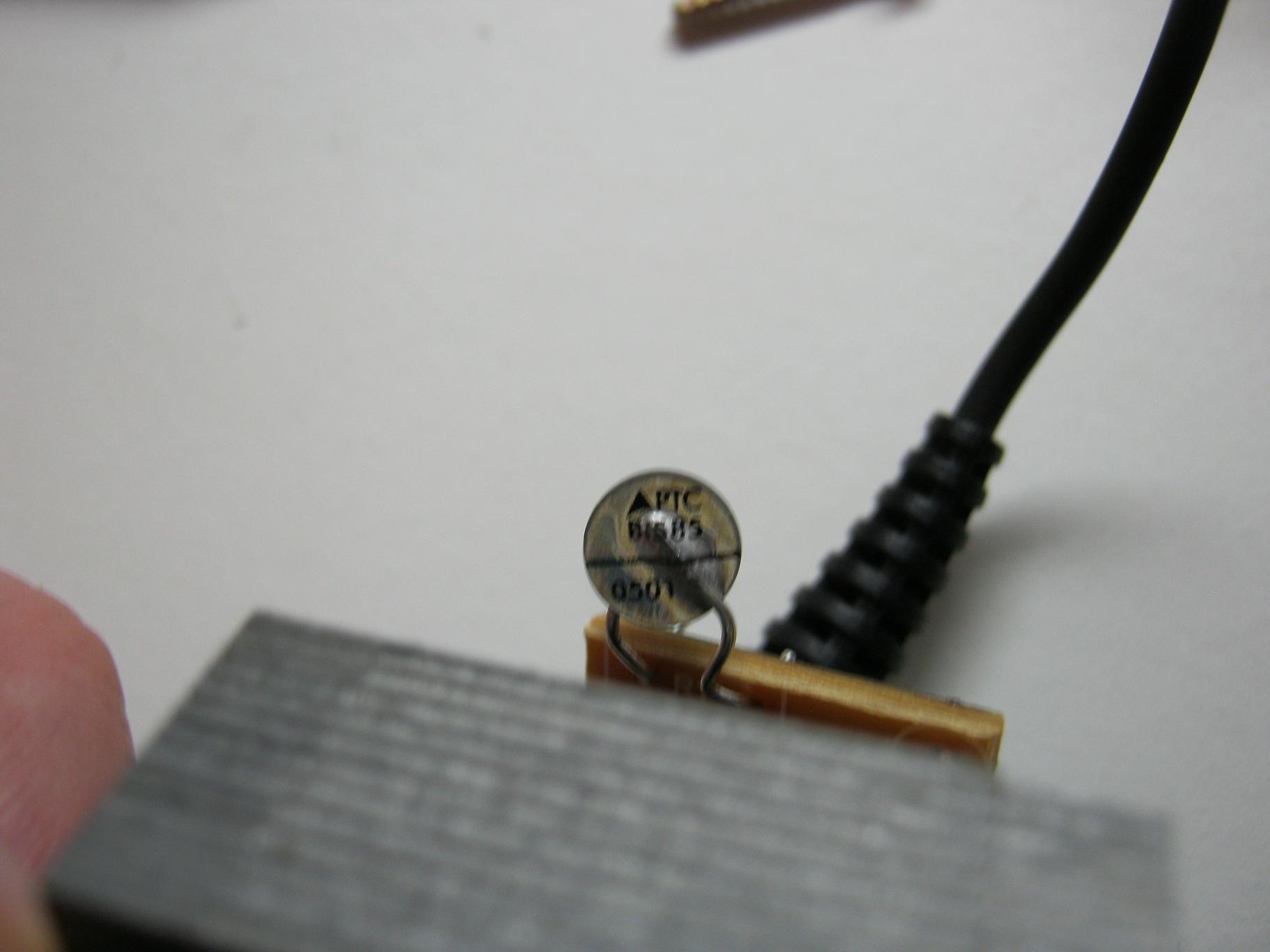

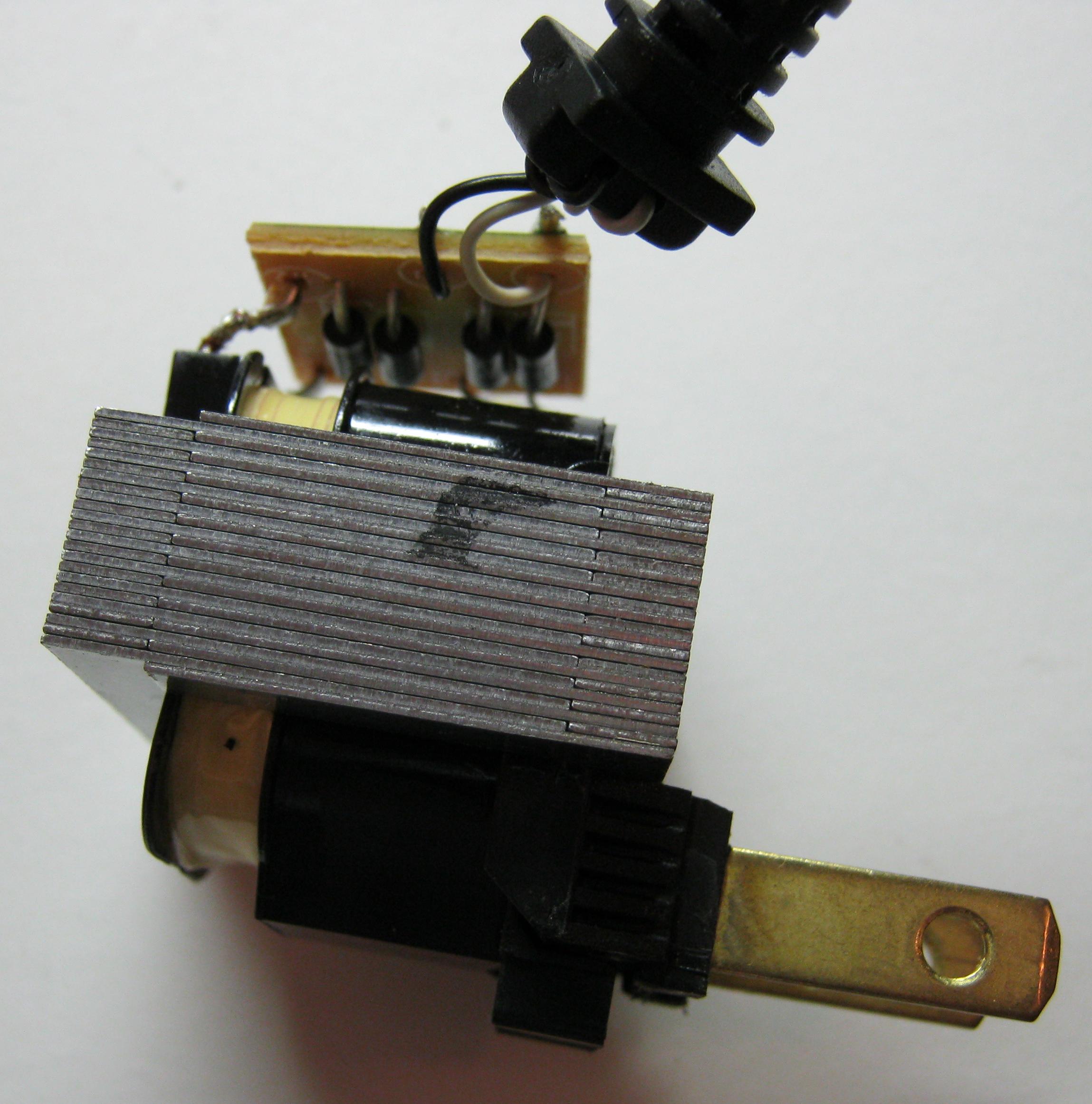

                        Nokia ACP-7U
                        Yes, that's it. There is no filtering.
                        The last picture shows the temperature protection device. It measures 0.1Ω at room temperature, and it appears to go open at 125°C. It wasn't touching any component, so I don't know how well it really works as a protection device.

                                  Originally posted by lti
                                  Nokia ACP-7U
                                  A linear phone charger? There must be a regulator in the phone or something.
                                          Nokia ACP-7U
                                          Oh so many components inside! I think it might work with just 1 rectifying diode, why spend money on all 4?
                                          It is not even switch-mode.
                                          This sets a new standard for BAD.
