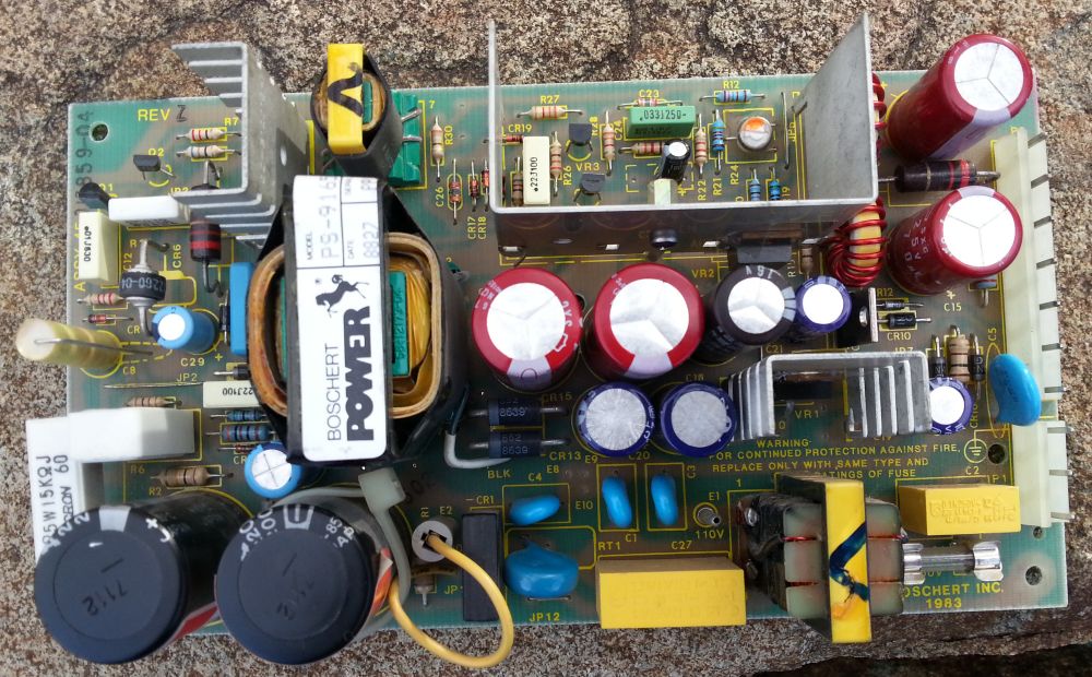

      Boschert PS-9165 (from a Unisys S40DISK unit):
      2x 220uF 200V Panasonic primary units.
      2x 2200uF 16V Chemi-Con SXC before +5V inductor and 1000uF 25V Chemi-Con SXC after it.
      680uF 16V Chemi-Con RX before +12V inductor and 470uF 25V Chemi-Con SXC after it.
      220uF 25V Jamicon WG on -5V and -12V regulator inputs and 100uF 25V Jamicon WG at each negative regulator output.
      Other electrolytic capacitors not mentioned are Nichicon and Chemi-Con.
      MBR1645 +5V rectifer.
      BYW29-150 +12V rectifier
      1N5822 rectifier each before -5V and -12V regulators.
      KBL04 input bridge rectifier
      BUW12 primary switcher.

        Wow, that is a beauty!

          i used to see dozens of psu's built like that from ASCOT.

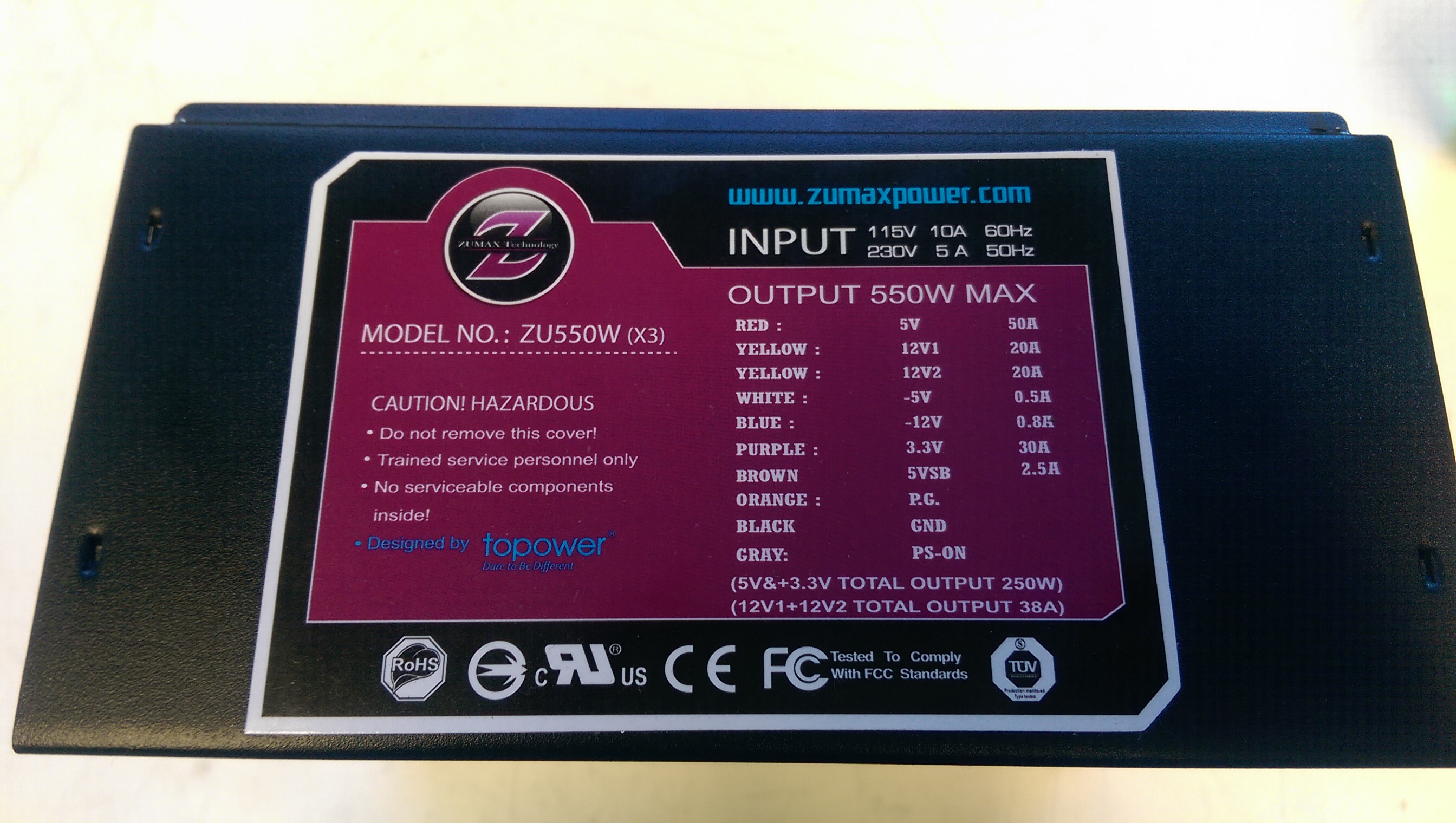

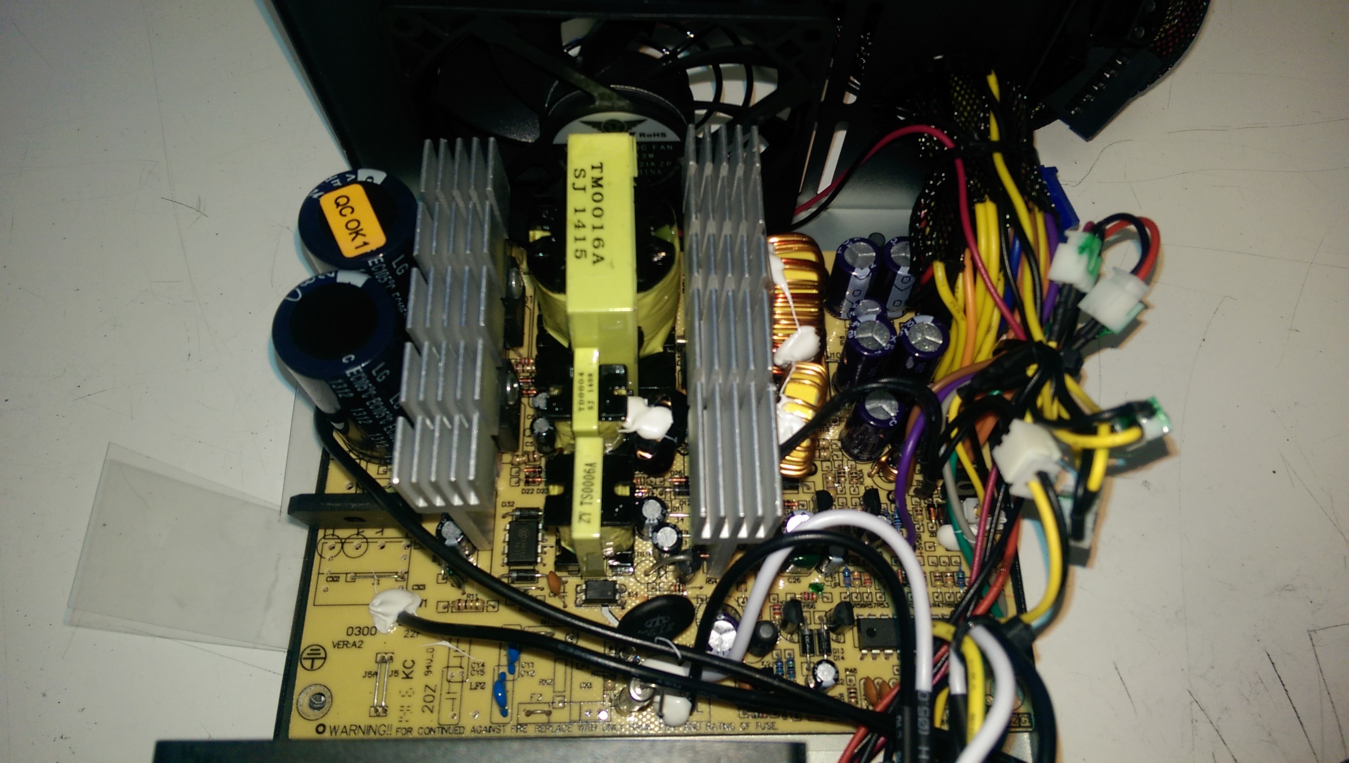

                        Zumax ZU550W (X3)
                        Topower seems to be dead, but I guess Zumax still makes some decent PSU's (Although still overrated) A lot of "Topower" PSU's with the Topower UL number actually have Leadman units in them...Leadman at their worst too.
                        Anyways...

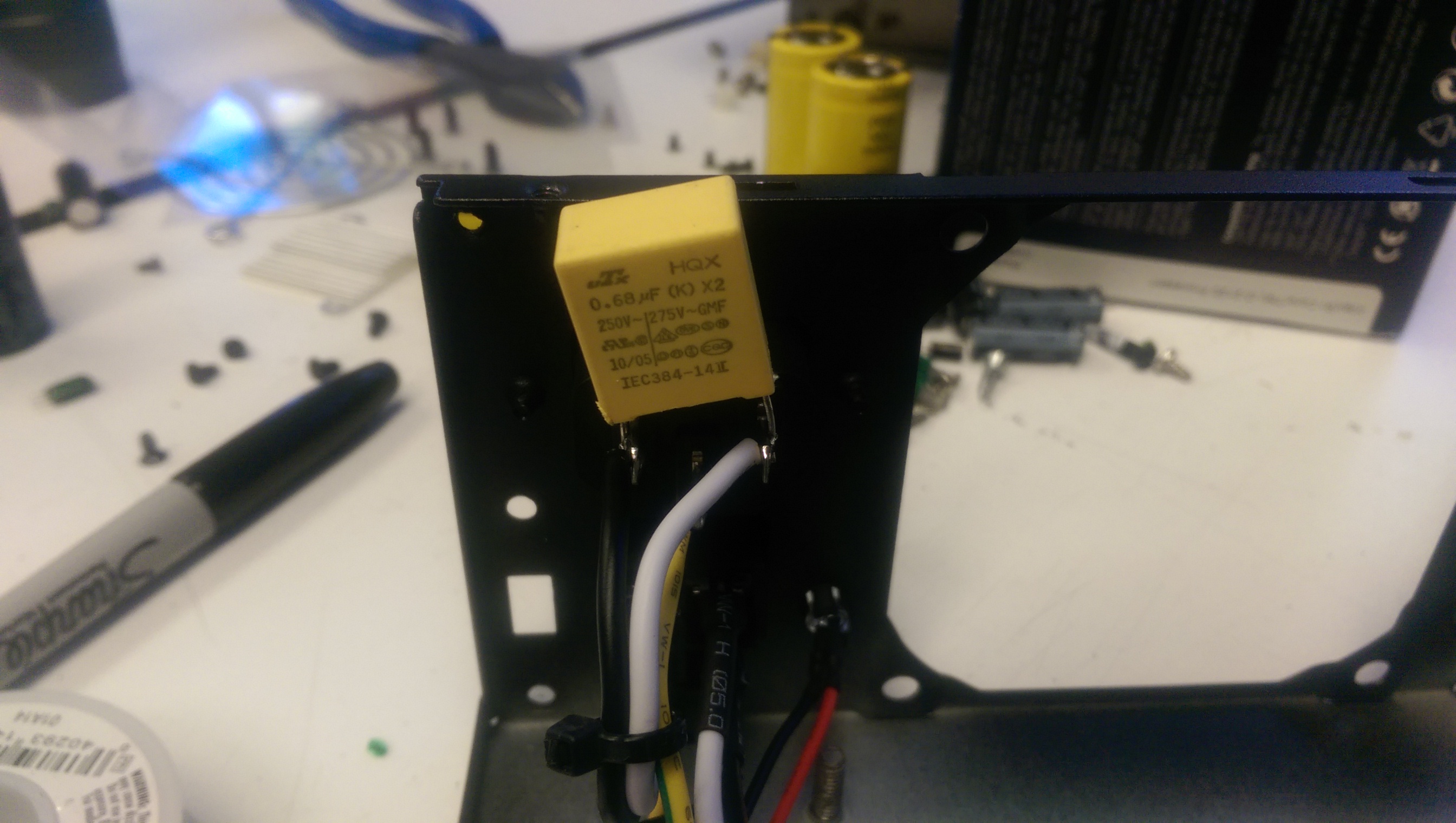

                        This one looks okay. I hate the lack of an input filter though. Those are not proper Y caps. There are no spots for coils (or maybe there is, LF1?) and all my scrapped X caps are too long for the slots provided. So all I did was replace the 3 fake Y caps with real ones, soldered an X cap to the receptacle, and added a beefy heatshrinked MOV, they all came from a dead Bestec (It had so much tan glue that I deemed it not worth the fix) I know it's not a complete input filter but it's something. Those Jun input caps read 690uF and 700uF. It uses 13009 transistors. From first glance I thought it was double forward. I'm going to go out on a limb and say that I think this thing could do 400W even with 13009's because they have everything going for them. TO-247, good sized heatsink, no 2 transistor so it doesn't have to share more heat with the extra transistor, plenty of bulk capacitance, good sized transformer that shouldn't saturate under 400W, and two fans in push-pull configuration. What do you guys think?

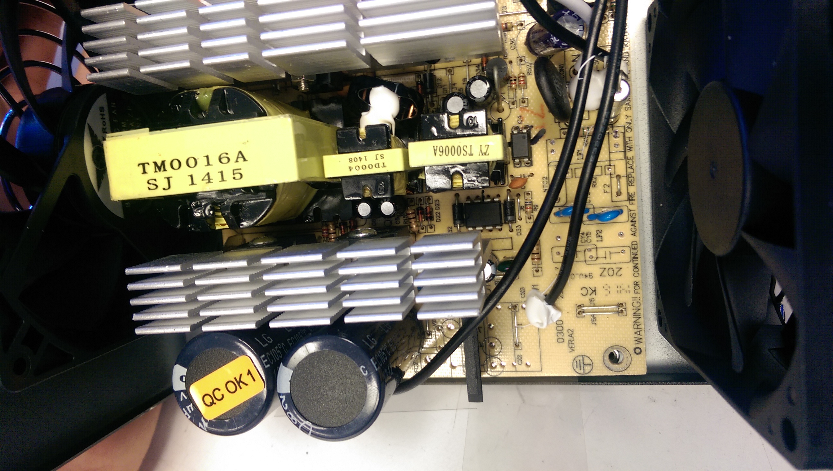

                        The 5V and 3.3V are rectified by one MBR3045CT each, and the 12V uses two MBR30H100CT's in parallel. Not bad. It looks like this PSU uses the same base design as the CoodMax that c_hegge reviewed. That one looks significantly worse and did 260W (He's on 230V though)
                        Link: http://hardwareinsights.com/wp/the-2...ply-roundup/9/
                          I agree. It all depends on the design now.
                          I can't believe that this thing did 330W+ using 470uF primary capacitors!
                          http://www.xbitlabs.com/articles/cas...400w-520w.html
                          This unit is sold for 25 euros here.
                          Meanwhile its US version did 420W using 560uF primary caps though:
                          http://www.hardwaresecrets.com/print...ply-Review/975

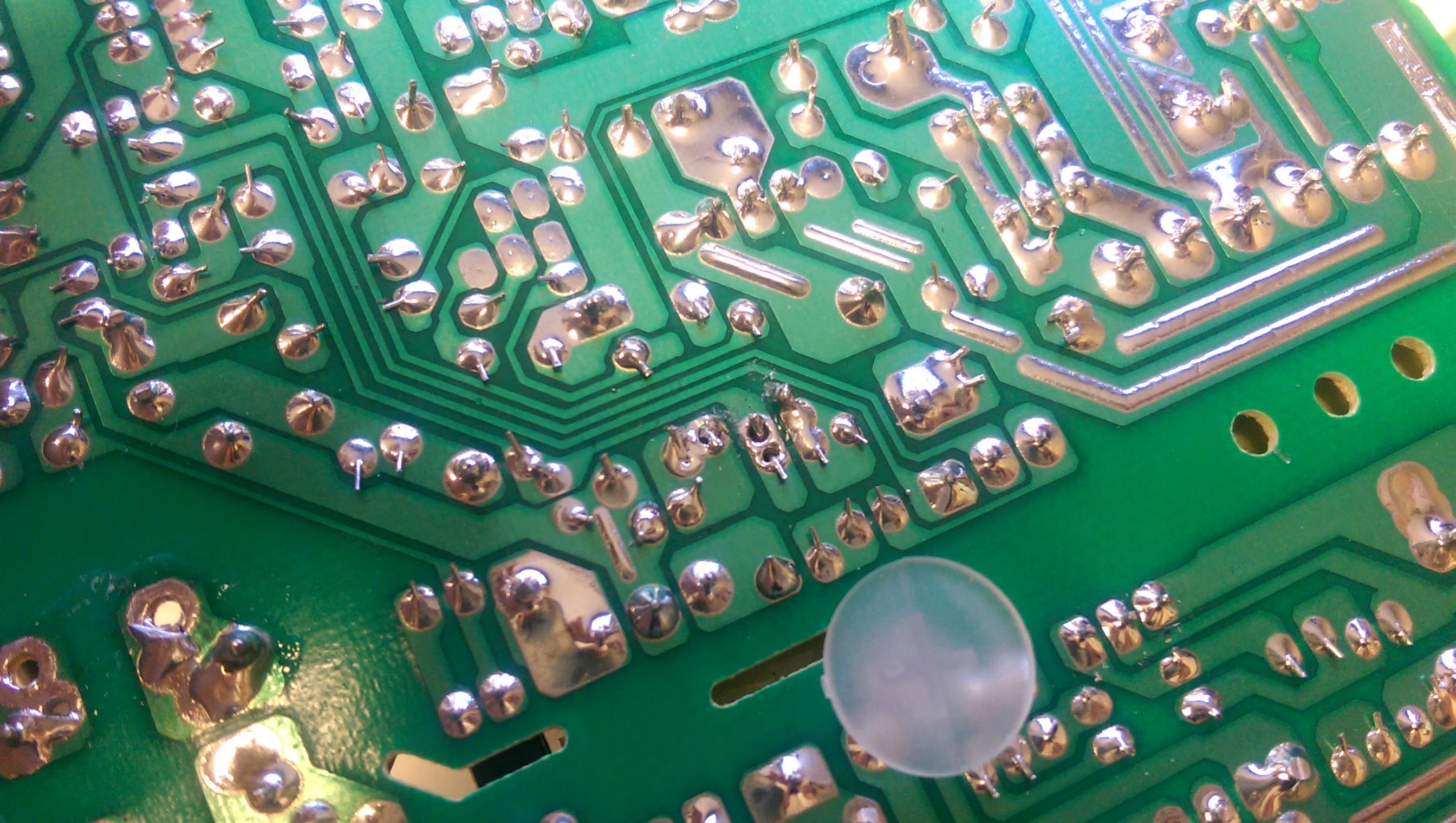

                            Isn't the reason that low bulk capacitance limits the PSU's ability because when the bulk capacitors reach their limit, they can no longer properly smooth the pulsed DC current, putting more stress on the switching transistors?

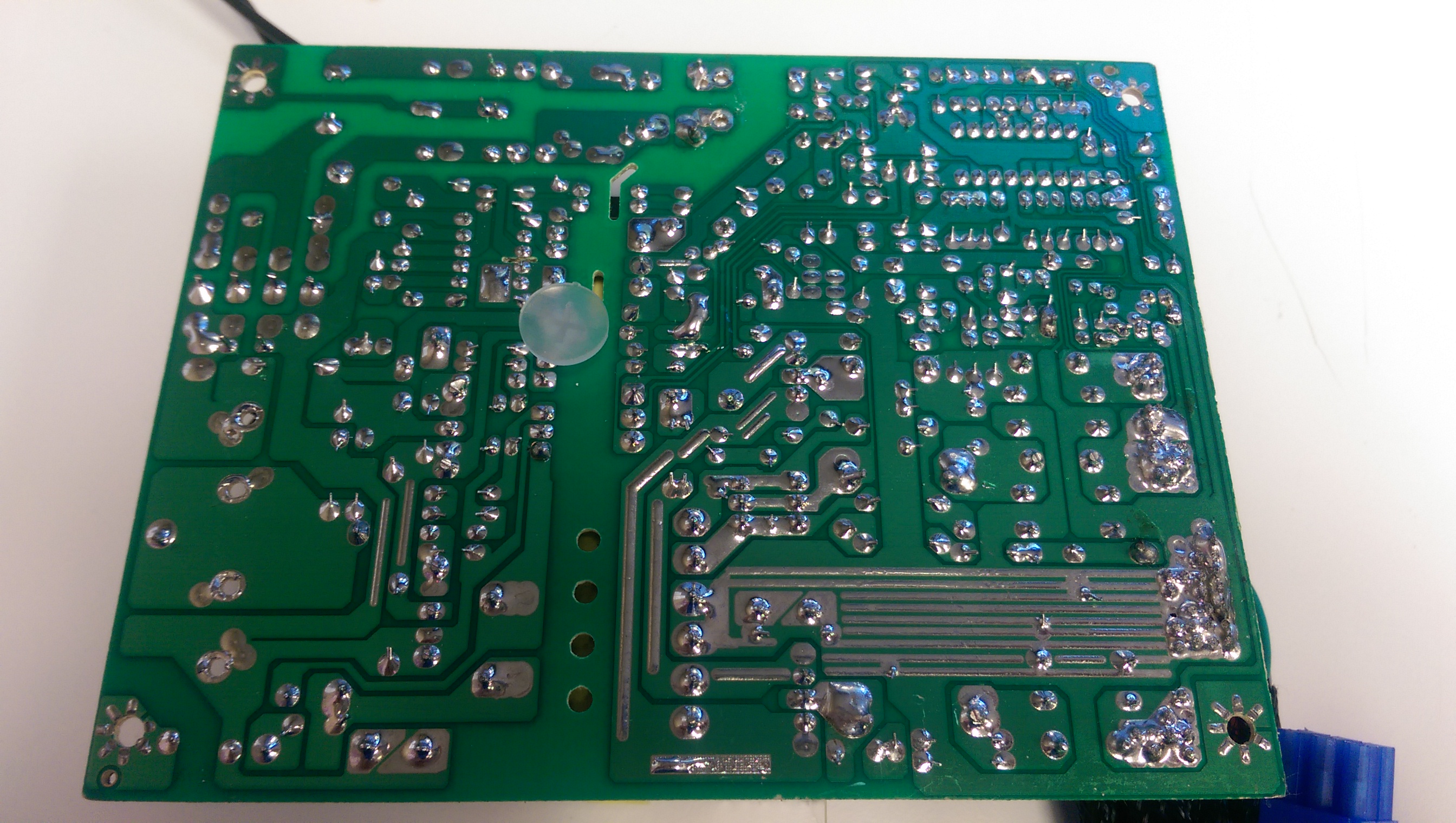

                            So I found this strange on this PSU...I was redoing some of the "blobby" solder joints, one of them being that big blob you see in the center of the solder shot. I removed it and saw that the blob had a total of 4 joints under it, and they're clearly separated. The PSU was functioning before, so was it supposed to be like that by design or should they be soldered separately? Going from left to right the joints are part of 1. Jumper wire, 2. diode cathode, 3. diode cathode, 4. zener diode anode

                              Nice PSU. Too bad the board silkscreen is such a mess. Everything else seems good. I like the dual 30A rectifiers on the 12V. That's a lot of beef for a half-bridge. Means it can do 30A on the 12V no problem, or 360W. The output filtering caps seem a bit small, though. With the PI coils, though, I doubt the filtering is bad.
                              260W for that gutless turd? With almost 80% efficiency before it died! - Now that is pretty amazing! Just look at the Sun Pro on the next page in that review .
                              If it works and doesn't do anything strange, then I guess it was supposed to be this way. Looks like something to do with the secondary auxiliary rail on the 5VSB circuit. No exact idea, though.
                                It is a mess isn't it :/ Yeah I like having rectifiers in parallel too, especially 30A Which is surprising on a PSU like this. The stock filtering caps are Asia'X TMX 2200uF 16V. I replaced them with 3300uF 16V Samxon RS from Behemot. Plus, if on the one c_hegge reviewed, that one did decent ripple suppression with two 1000uF 16V same series caps, and no coil. Indicating that it must be a good design.
                                I was surprised too. And with mine having higher rated 12V rectifiers in parallel, the efficiency is probably the same or better! (Because I'm on 120V)
                                I guess I'll just redo it as it was It's fully recapped now

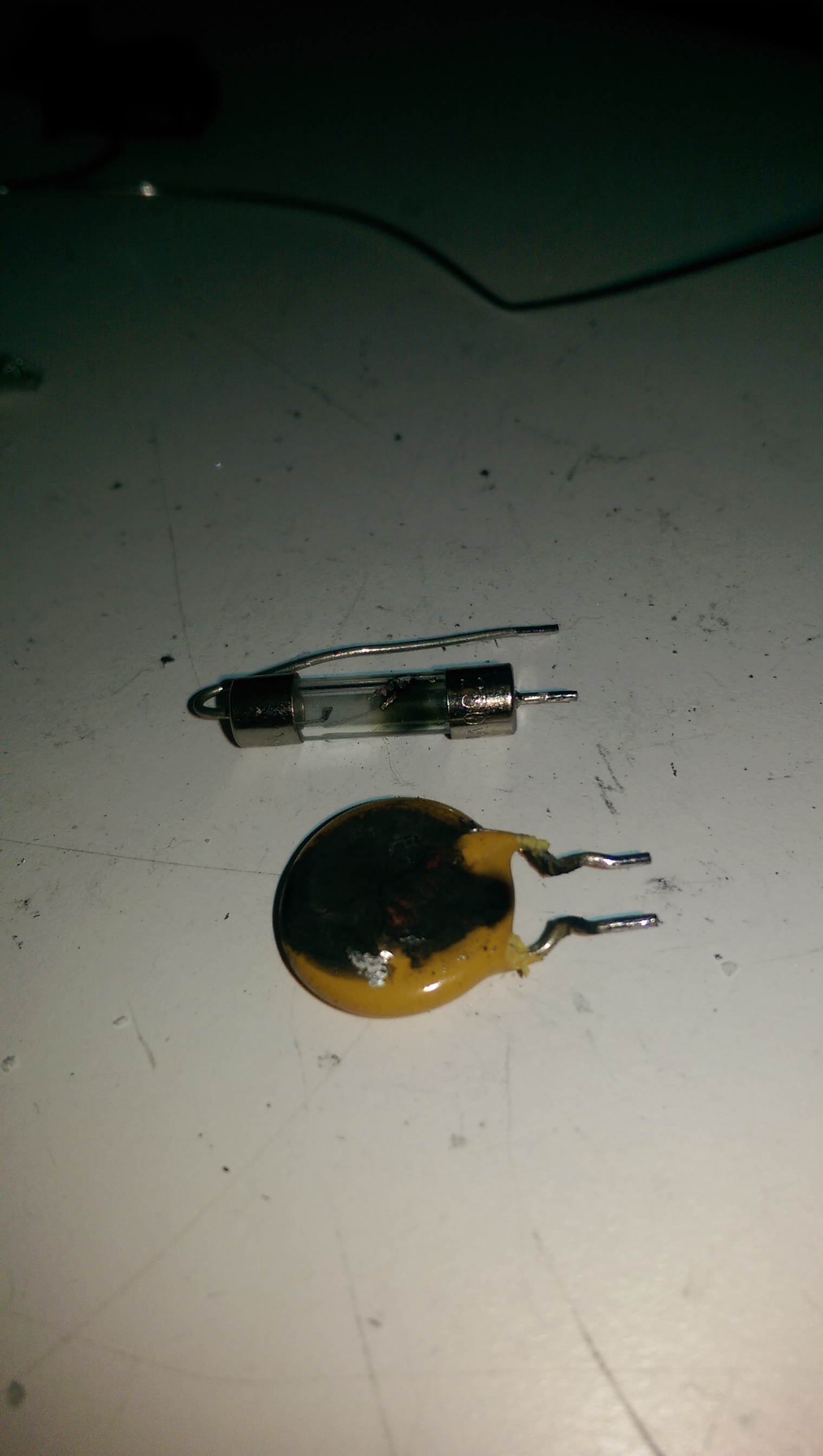

                                  Well, I tried being experimental and it literally blew up in my face. I soldered them separately and when I flipped the switch the fuse instantly blew and there's a black char on the top side of the PCB under the MOV I installed. Gonna replace the fuse and MOV in hopes of it being okay, after bridging those joints the way they were before.
                                    That's sad to hear.
                                    You may want to try this trick from now on when doing any "experiments"
                                    https://www.badcaps.net/forum/showpo...4&postcount=70
                                    Will save you a lot of explosions.

                                      I demand pictures of the carnage

                                          As you can imagine, the MOV is bad it reads 9.2Ω both ways. Looks like it did its job though. Safe to assume the BR is okay? I'm replacing the glass fuse with a slow blow fuse same rating.
                                          Edit: The bridge rectifier tested good
