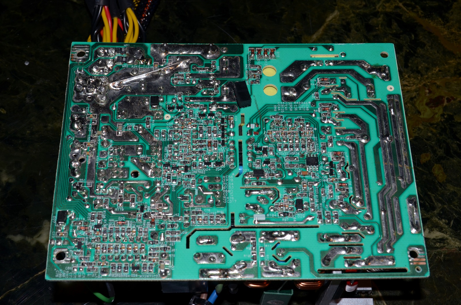

                      #1810
                      Some other units I have...
                      • goodpsusearch
                        • Oct 2009
                        • 2850
                        • Greece
                        #1811
                        I like the second psu. DC to DC converter. Can you post a photo of its label?
                        And why is the first psu scrapped? It couldn't be repaired? It's a HEC btw! I see it has(had) 4x 12V outputs, active PFC, I think it could do more than 500W if it worked.
                        • Stefan Payne
                          • 1267
                          #1812
                          500W LC-Power LC-9550, made by Andyson...
                          Attached there are more pics of that particular unit.
                          No, it's a dual rail output. It was scrapped because the ripple and noise was a piece of shit. Like 100mV on the minor rails and 200mV on +12V under full load.
                          But that's just what the chroma 6000 ATS put out, I have no idea how the voltage would look like...
                          The scrapped HEC is the 700W layout of the first Cougar series by the way.

                            #1813
                            LC-POWER (not L&C) makes good psus in general.
                            I would recap those JunFu caps and use it in my main computer.
                            The fact that the unit is 80 plus gold is another nice feature.
                            • Stefan Payne
                              • 1267
                              #1814
                              Not really. Though they are a lot better than they were a couple of years ago, with the LC-6550 (Huntkey made)...
                              Still, most of their stuff is better than everything MS-Tech or Inter-Tech has to offer...
                              Well, there are two 1500uF/6,3V Polymer caps before those two. SO I think they will last a couple of years - until the fan fails...
                              Doubt that's really 80plus gold. Rather something close to 80plus gold. Still: It's pretty cheap and has DC-DC, so even if it is not gold, it's on the rather cheap side...
                              For example: Here in Germany a prefered choice would be a Pure Power L8 (HEC made) for about 55€. The LC-Power is about 5-8€ more expansive than this HEC made unit...
