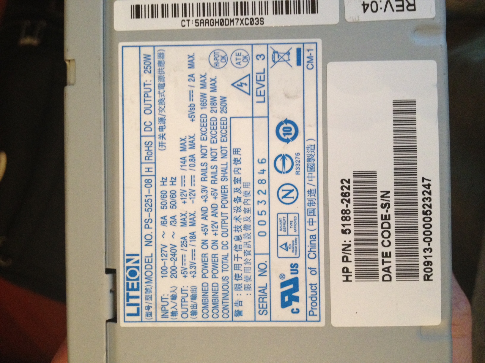

                Liteon PS-5251-08 250W, taken out of a HP desktop. Has only been in operation for less than 500 hours despite being 3 years old. No visible sign of damage.
                However the system it was powering would intermittently fail to POST. It would happen sometimes for a few days, sometimes giving POST beep codes, and at other times be fine for weeks. Problem has not come back after replacing the PSU with a Delta ActivePower 400W unit (several weeks ago). System is only a Pentium Dual Core (65W) with integrated graphics and 1 HDD, so should not have been an issue of insufficient power.
                Is this a good PSU? Any idea if the problem was due to an issue with the PSU?

                  Replace the capacitors, and check for bad solder joints.
                  That one is a keeper, note how it has a 7-pin DIP chip controlling the 5v standby! (No finnicky two-transistor self oscillating circuit, which could blow up and destroy the motherboard)

                    If the +5V Stby works a usual suspect is the start-up 'lytic for the PWM.
                      Some capacitors are so bad they fail just sitting there doing nothing. But I wouldn't expect LiteOn to use ones that bad.

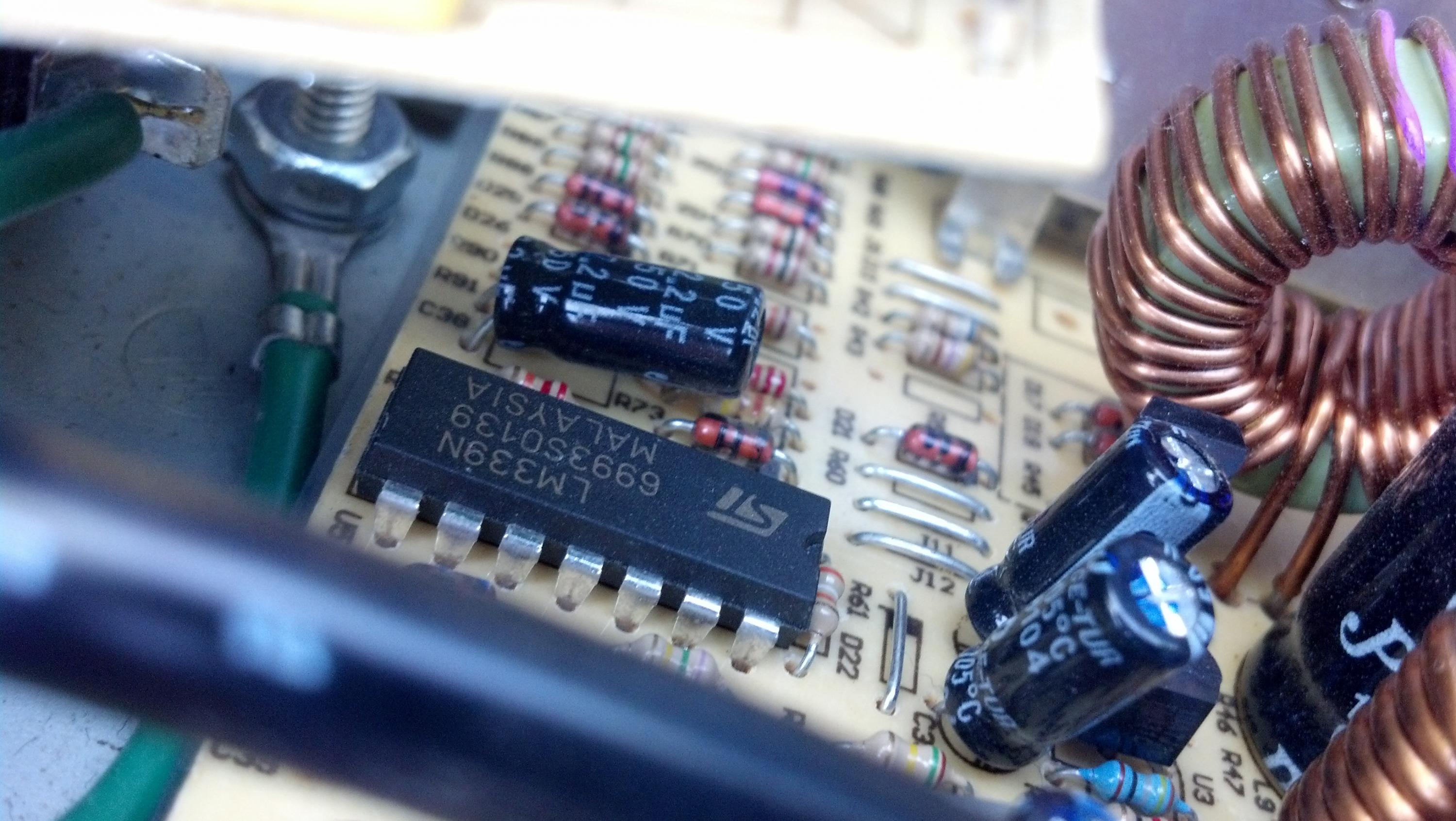

                        Got an old Enermax EG301P-V here. Paid $2.50 for it. For being made in 2001 I'm very impressed by this PSU.... It looks to be a single transistor forward design. It has a single Toshiba FET rated at 7A (It's a K2746) There's a slot on the other side of it, worth adding another?? Unfortunately it uses a 2 transistor 5VSB circuit. (Interesting where they placed the 5VSB circuit) Full input filter with 2 MOV's. 470uF input caps seems a little low for this design
                        That 8 pin chip there on the primary is a Motorola UC3842BN. I'm disappointed by the size of the transformer but then again it should be more efficient than a half bridge unit
                        On the secondary it has a 30A schottky for all the rails. An ST STPS30L40CW on the 5V and 3.3V (There is a spot for another schottky on both these rails) on the 12V it has a Shindengen Electric S30SC4M shottky. Is it worth adding shottky's to the 3.3V and 5V rail to increase efficiency?
                        As you can see, an ST LM339N comparator on the secondary. Love the nice Ball Bearing Globe Fan than spins very well still and plenty of oil on the bearing. Surprised to see none of the caps bulging too!
                        I was thinking of soldering on some SATA cables and a 4 pin for the main motherboard connector. What do you guys think of this thing?

                          Well, at 11-12 years old, I'd suggest replacing all the lytics - PW, LXZ, or FC would be good choices for the O/P caps. You could probably match the case size of the I/P lytics and end up with 560uF or 680uF parts. The -52 material O/P inductor toroid, 2SK2746 MOSFET switch and On Semiconductor (probably using Motorola-designed silicon) UC3842 all suggest a switch frequency above 50KHz. Nice heatsinks. If it would be useful to you it looks well worth refurbishing.
                          PeteS in CA
                          • Pentium4
                            CapXon Be Gone
                            • Sep 2011
                            • 3741
                            #1513
                            Thanks for the reply Pete. yes, all the lytics are going. They served their purpose well but I can't trust them anymore. I have tons of PW, KY, and ZLH on hand Yeah I love the style of heatsinks, tons of metal to air contact I was planning on putting it in an old S478 computer which I think would be perfect

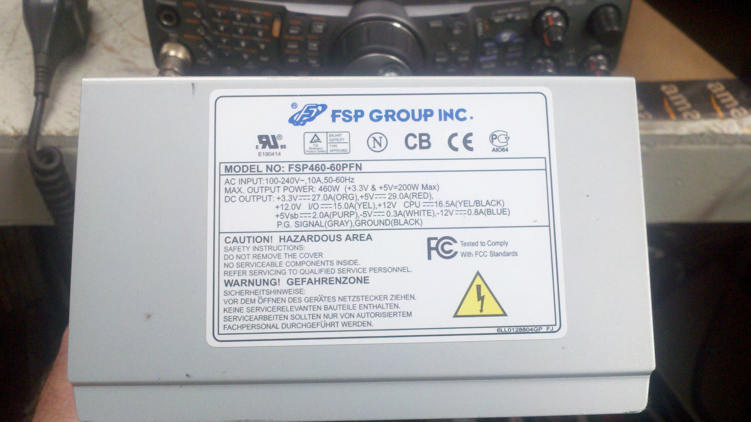

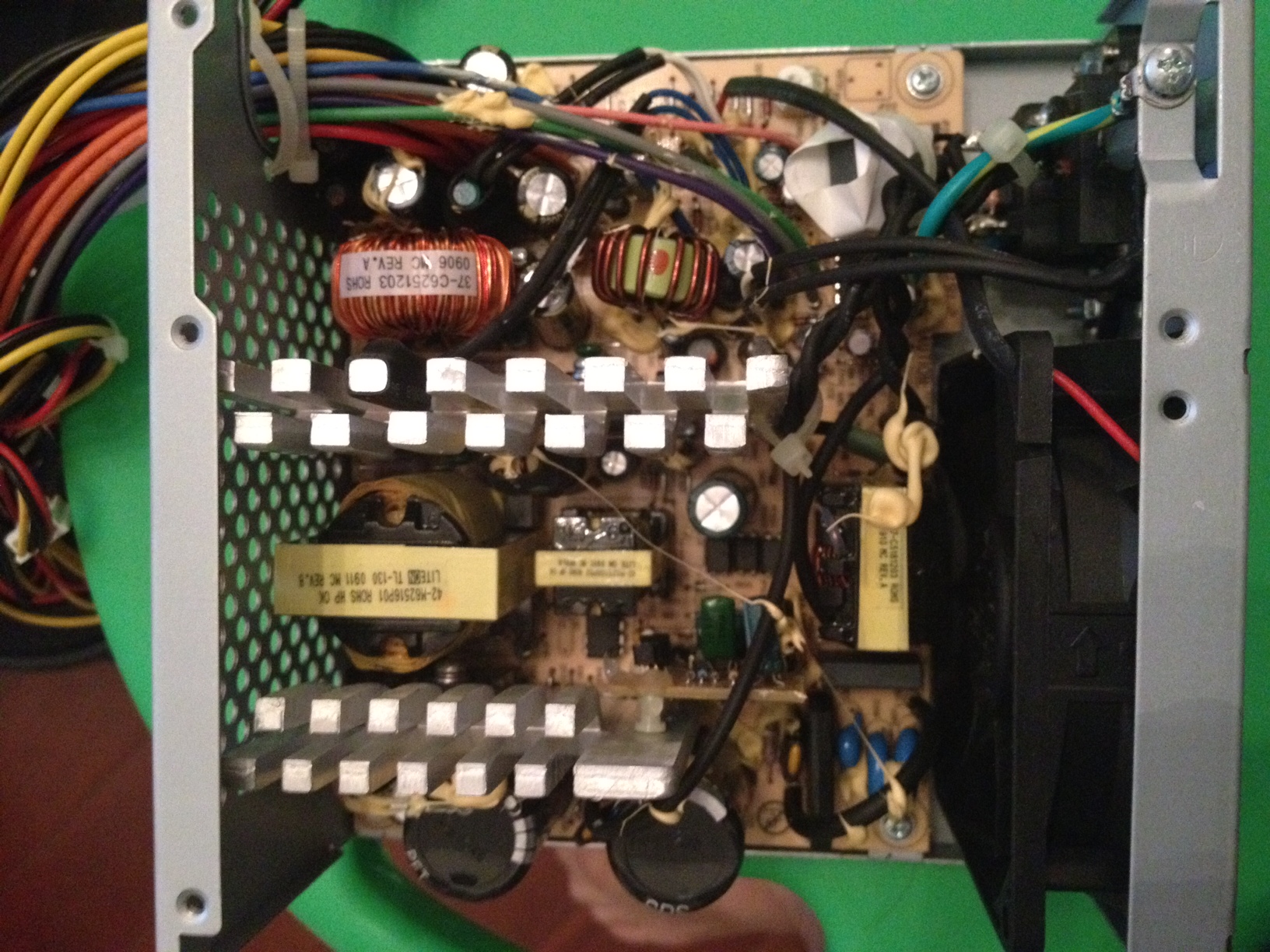

                              fsp 460.
                              the teapo sek were all open,high esr,and leaking out the bottom.
                              somehow lost the before pics.
                              probably the most substantial 400-500w unit i have seen.

                                At least it fits 12.5mm caps. I've seen some FSPs pull an Anrec and use 10mm parts, so the Panny FMs wouldn't be an option.

                                  The very same PSU was reviewed at X-bit labs some 8 years ago. Among the Teapo SEKs they fit a Teapo SX (or SD?) and some Teapo SCs in that particular revision of the PSU. It performs quite well in X-bit labs' tests but then I believe those tests are pretty lax to begin with...
                                  I don't think it's a great idea to use general purpose capacitors on the output filter of a 460W unit, even if they're 2200uF-4700uF.
                                  Do you mean that MOSFETs operate ideally at switching frequencies above 50KHz? Looking at the datasheet, Toshiba 2SK2746 doesn't look impressive but numbers don't always tell the story of course. I think more realistically the PSU above has a limit of 250W.

                                    #1517
                                    No, just that for a 20KHz-30KHz switching frequency a MOSFET isn't really needed. And the -52 core material isn't really needed in that frequency range. Just guessing based on the strengths of the parts.
                                    I'm not that familiar with the JP caps, but the KY series might be overkill, and the FM series might even cause a stability issue.

                                      That's a beautiful FSP unit, nice recap job too. Just curious, what brand fan did they use in that unit?
                                      Regarding that Toshiba FET, 7A is not that much at all. I ran it at 160W for an hour and the primary heatsink was surprisingly cool (88F), so it seems to be doing its job. I will load it higher later. Are you thinking that the KY caps will have too low of ESR? I don't have any Panny FM but I do have FC which are fairly similar, most of them are 1-47uF 50V caps though

                                        31*C is a surprising feat, but it would also depend on how responsive the fan is to the PSU's heat output as a whole (as well as the room temperature). Usually (at least as far as MOSFETs go) the quality of switcher is determined by their ON resistance (how much heat they waste, lower is better), their maximum power dissipation, how fast they switch on and off, specifications like RG, etc and less by the current rating (though since we're on the subject, bipolar transistors can fit more current into a smaller die and MOSFETs happen to be more voltage driven). It could just be the fact that the secondary is rather overspec'd with low VF schottkys which in turn improves the efficiency of the primary side. Since you asked about adding another schottky in parallel to increase efficiency, I think the voltage drops of the rectifiers by themselves are already low enough to be alright as is.

                                          Yeah I guess you are right about not needing to add schottky's in parallel. The secondary is indeed overspec'd a little. A little worried about the size of the transformer but I was only planning on using it in a ~110W system so I guess I will just recap it What's interesting is the same model number PSU on Newegg's old link has 22A on the 12V http://www.newegg.com/Product/Produc...82E16817103463
                                          But for curiosity's sake I'm curious what would happen first, if this thing was loaded heavily if the FET would blow or if the transformer would saturate. Might even do both and blow the FET when then transformer saturates
