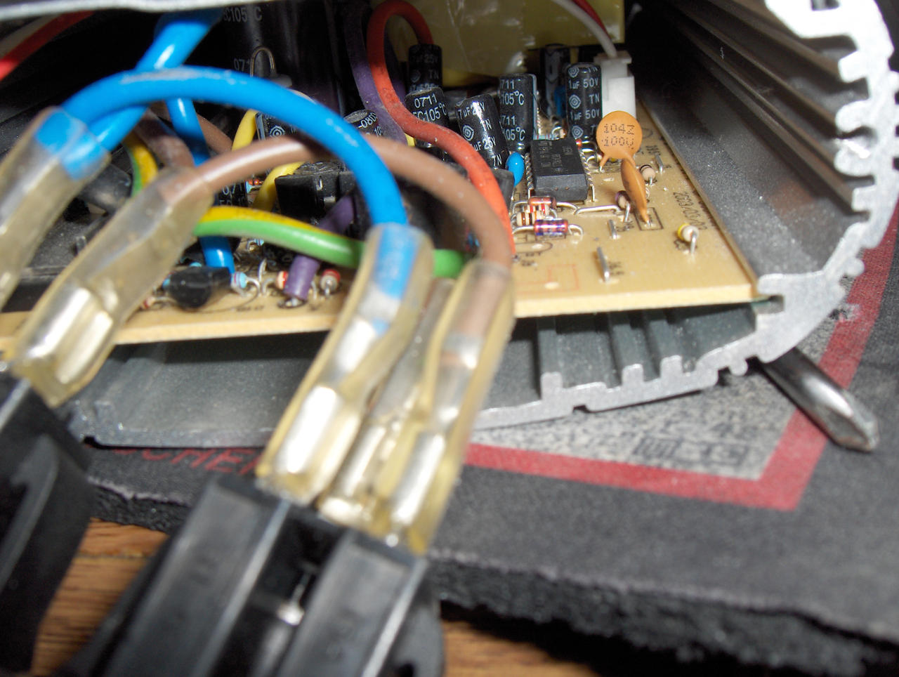

    ... it's full of Fuhjyyus !!!
    Since I don't use this inverter that much - stays cool, it still works fine. However I wonder how long it will be until it starts developing issues much like the Antec PSUs.
    The cover seems to have rusted into place so I can't get any inverter porn going here. Worth sharing I think, but we'll have to wait until I can get the cover off without damaging it.
    BTW this is the inverter that shocked me... literally. Maybe there is a real problem worth investigating...

      Alrighty here's a bit of side tOOB...

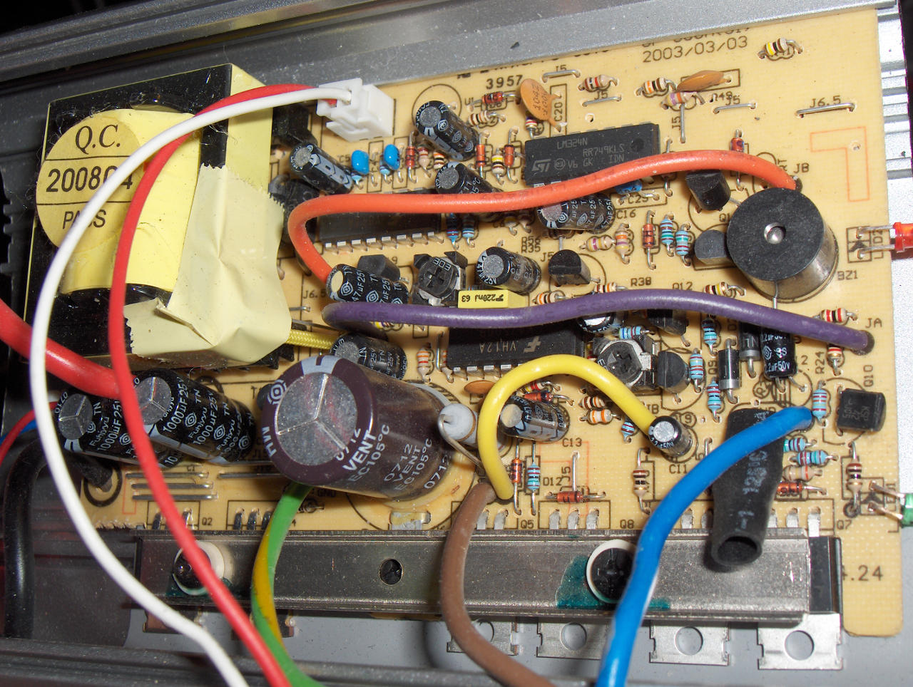

      And here we go, inverter p0rn...
      Thin Red/White wire goes to power switch
      Blue/Brown goes to outlets
      Fat red/black goes to 12VDC
      Thin red/blue goes to fan.
      Looks uncannily like the 80W inverter I repaired - dual KA7500/TL494 and H-bridge, except bigger capacitors and transformer (it is 4x the power capacity...) and has a LM324 (the 80W uses discrete it appears). The little 80W uses a single red/green LED and this one uses discrete red and green LEDs to indicate its status. The same structure but heatsinked main switches (lower left) and H-bridge (lower right) exists in both designs.
      Anyway, isn't it sexy? We see so many ATX PSUs, for a change we get to see Sima - a PSU's opposite - that converts +12VDC to 120VAC...

          But if it won't go bad... that means you've wasted money and time
          I've never run the inverter long enough to heat up. The "primary" caps in this PSU (the 1000uF Fuhjyyu TN's) are just like in on-line power supplies - they are charged by the alternator and discharged by the switching transistors. The "secondary" capacitor is the Fuhjyyu MH capacitor, a 200V (forgot, I think it's around 68 to 100)uF 105°C capacitor.
