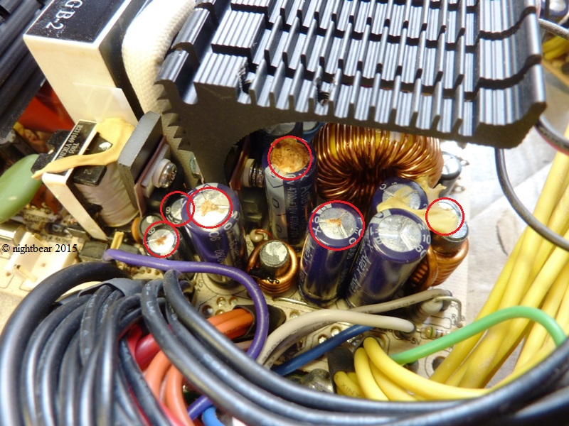

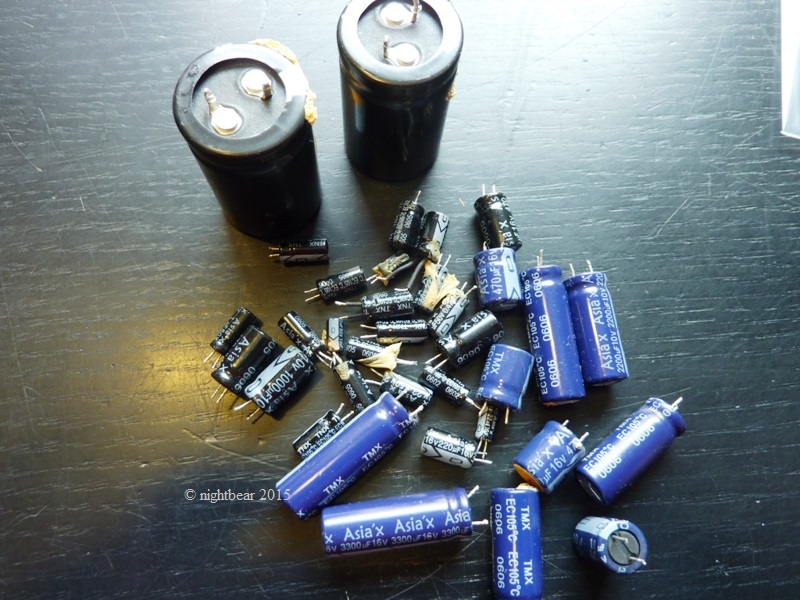

                I´m repairing a Tagan 480W PSU at the moment.
                After replacing all the bloated "Asia`X" = Fuhiyyu capacitors the PSU still wouldn´t start. No secondary voltages, no standby voltage.
                I found the PWM-Controller (a TL3842P) to have a resistance of about 100 Ohms between Vcc and Gnd.
                I have ordered a replacement and will report the results.

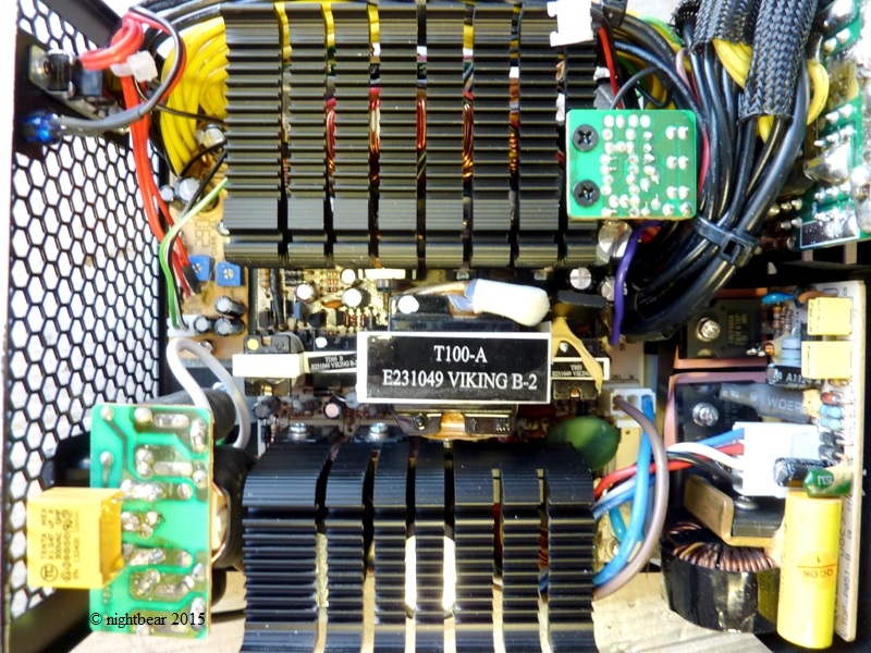

                  The PWM Controller (TL3842P) was indeed the culprit here.
                  After replacing it, the PSU works flawlessly again.
                  Here is the finished product:

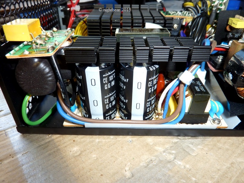

                        Yes, it´s a very nice PSU now with very little noise and enough power for most common systems. It has got a railsplit switch for +12V also.
                        With all the high quality capacitors it should now be ready for a considerably long lifetime.
                        I´m quite sure the TL3842P PWM-controller was the real reason for this PSU to stop working. The secondary filter caps (ASIA-X) all had a capacity of several hundred uF left so they probably would have led to instabilities but the PSU suddenly stopped worrking compltely - because the PWM-controller died.

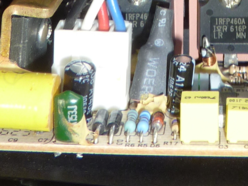

                          Clean that chloroprene glue you have there otherwise it's going to degrade completely and get conductive.

                            The glue has been generally removed in areas, where there´s contact to higher voltages. I left some traces on coils and tranformers to avoid mechanical or chemical demage when removing them. The bleeder resistors of the primary filter caps have some traces left on their outsides also but the pcb is clean.
                            But, you´re right - there´s still glue on the PFC board. I will take care of this soon. (see picture)
                            As for the capacitors, I used Nichicon GG on the primary side (not enough space for GX), Rubycon ZLJ (the smaller values), Panasonic FR and Nichicon HW for seconadry filtering.
                            Hope there´s nothing wrong with that.
