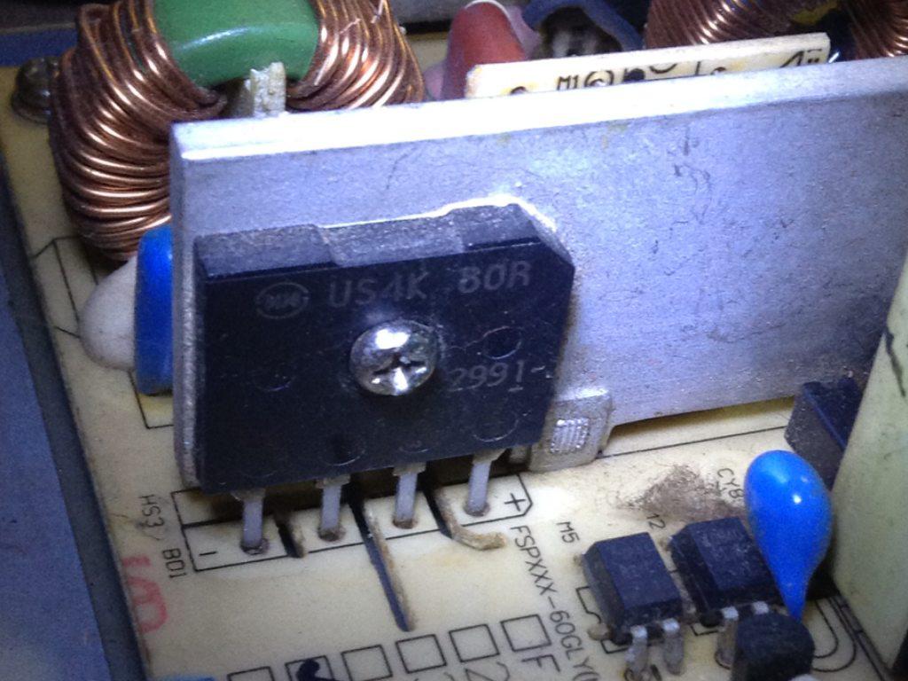

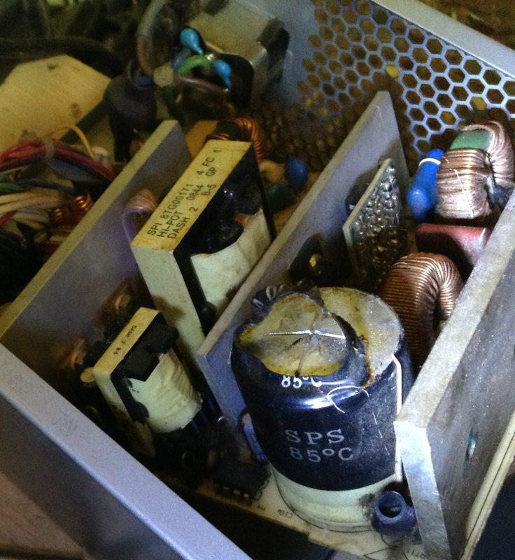

    I assume you mean the primary capacitor FSP psu.
    As user stj has suggested, I check the mains rectifier and it seems ok.
    The reason could be overvoltage, but also had four adapters plugged and at the same time and no one broke .
    It's curious, when I opened the source , a small insect came out. This psu is working out of a computer case, it gets so dirty
    Or just died by age, it is a bad, bad brand, OST (Taiwan Ostor Corporation) and a it's only 85ºC, not a japanese 105ºC.
    I had asked for a replacement for this capacitor , but now I understand that your mindset is I must find the reason why this capacitor had bloated.
    I had seen in this forum that usually secondary caps get bloated, but not the primary ones. And that's strange...
    Clearly I must replace both the primary condenser, because it's bloated, and secondary ones because at some point will too.

      rubycon make nice high voltage caps.
      the thing that i noticed on your bad cap is the plastic sleeve had shrunk - that's a sign of extreme heat.
        Yes, I've read that Rubycon manufactures excellent high voltage caps, and that I must to avoid those sold on eBay.
        I understand that the primary cap has signs of extreme heat, and other component has been the cause of that problem.

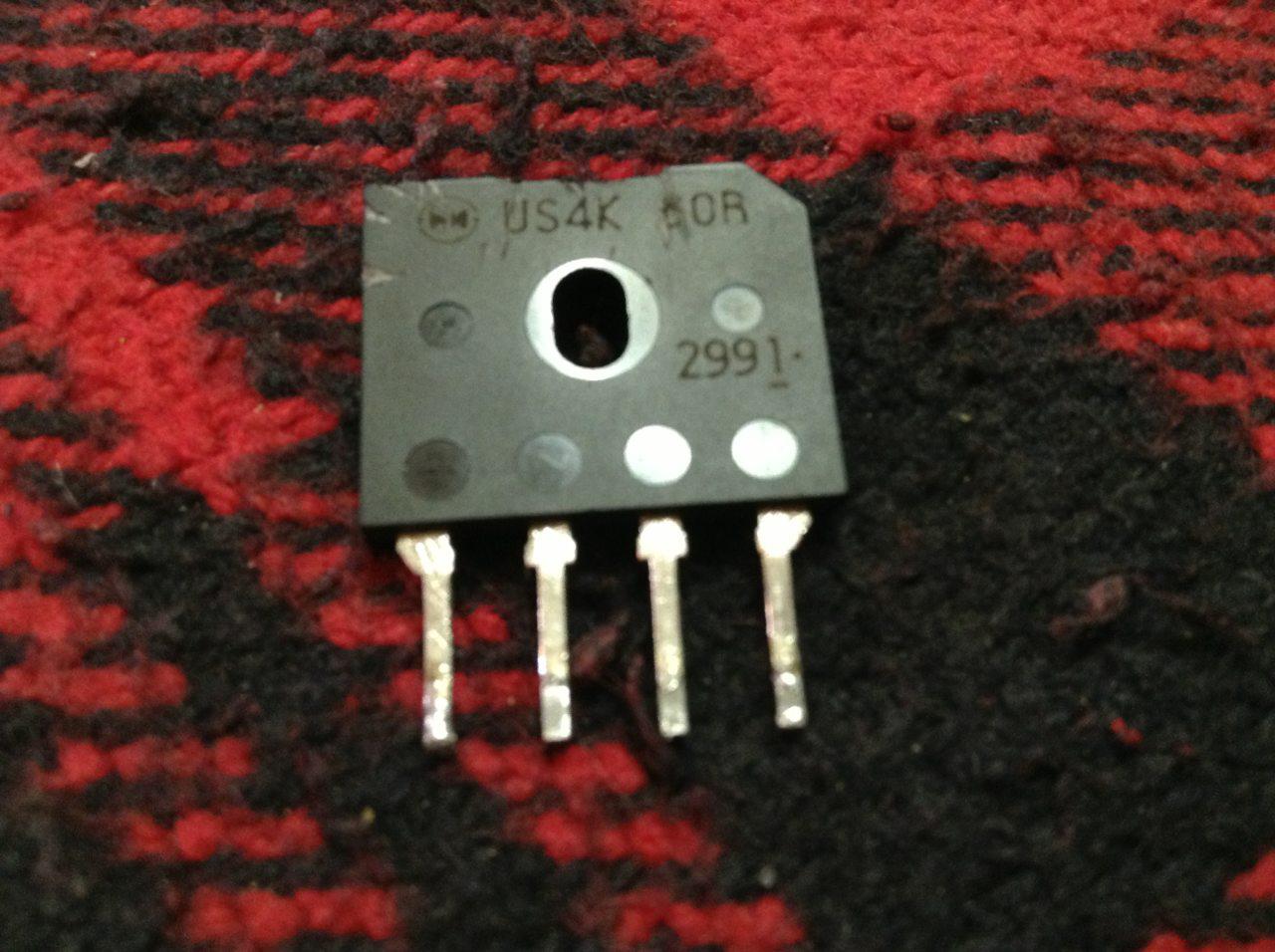

        So you told me to check the bridge rectifier, and after desoldered it I think it is OK , but you suspect that if I change the capacitor the problem will appear again, no?

          to test a rectifier,
          put one meter probe on the +,
          and the other probe on the ac pins one after the other
          you should get about .500 on diode test in one direction, and reversing the probes - you should get nothing.
          then do the same with the - pin and the ac pins.
          the rectifier is actually 4 diodes.

            Originally posted by ep9es

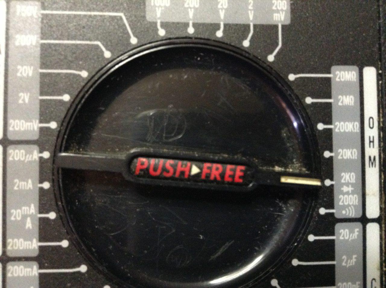

            Well, I'm stupid
            I was using in the multimeter the continuity scale(200R) but not the diode scale (2KR).
            I desoldered the rectifier.
            If the pins are like this - ac1 ac2 + , and the multimeter cables are Red(R) and Black(B), the measures are:
            -(R) ac1(B) 0.55
            -(R) ac2(B) 0.55
            -(R) +(B) 1.241
            +(B) ac2(R) 0.544
            +(B) ac1(R) 0.544
            +(R) -(B) infinite
            ac1(R) ac2(B) infinite
            ac1(B) ac2(R) infinite
            Other combinations, also infinite.
            Then, Is it ok??
            I will wait your answer to solder it again into the board.
            Then, the bridge is Ok, no??
              • 31304
              #66
              Re: Tagan TG480-U01 480W ATX PSU
              looks o.k. yes.

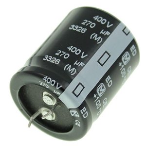

                Well, then I will replace the semi-broken primary cap and replace the secondary for security.
                The primary cap is 270uf 400v.
                Should I replace it with same capacitance or choose a 330uf 400v like similar FSP psu that I have seen? I read there's some tolerance to capacity changes but also read that other components will suffer because more current.
                The primary cap is a OST serie SPS 270uf 400VDC 85ºC 30x35mm(DxH) Ripple(120Hz 85ºC)=1.70
                http://www.ost.com.tw/products_ec_list.asp
                I would like to replace it with this one:
                Panasonic serie TS-ED EETED2G271DA 270uf 400VDC 105ºV 30x35mm(DxH) Ripple(120Hz 105ºC)=1.56 ESR(120Hz 20ºC)=0.491
                https://cdn.badcaps-static.com/pdfs/...b77415dbfa.pdf
                Maybe I'm obsessed with the choice of primary capacitor when it might be ok any 105ºC Japanese cap that meets similar ripple....
                  if you can fit 330uf or even 470uf then it's better.
                  i was thinking 270 sounded too small actually!
                  all my psu's have 680uf in them!
                  can you fit a 30mm wide cap in it's place?
                  because panasonic UQ series has a 470uf cap in 30 x 40mm

                    Yes, I can fit a 30mm wide cap (the same size as actual OST cap).
                    I had read in a web, maybe here, that if you increase uf also increase mA in other components because more energy every Hz, so they could suffer. It's only a caution.
                    Of course I can buy a bigger cap, but my doubt if then I also must replace diodes, or MOSFET, or .....

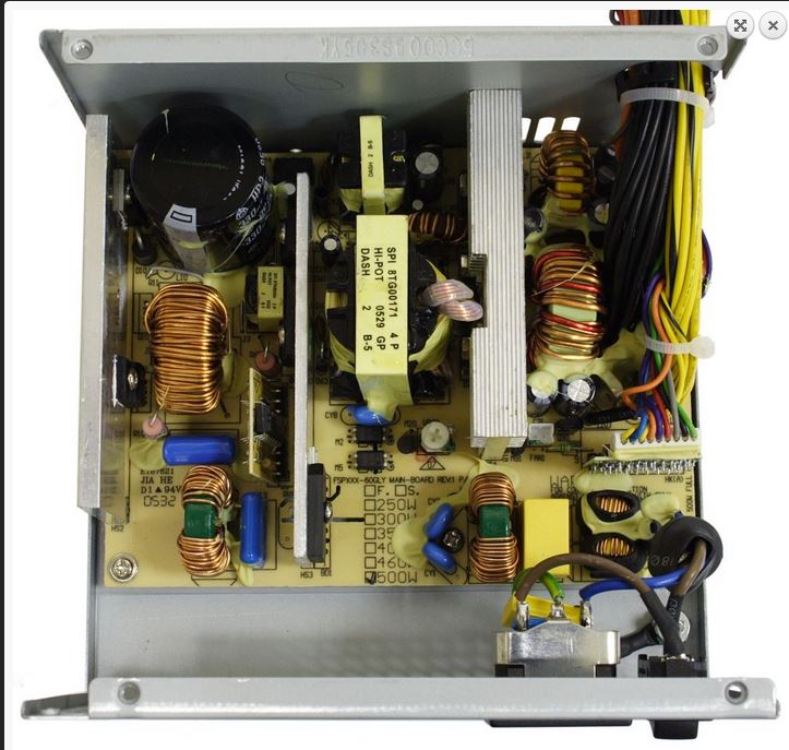

                    The attached photo is a FSP 500w (mine is 400w). It has a 330uf cap. Maybe I choose 330uf because it's easy to find than 270uf, and if possible 105ºC Japanese.
                    Also, as Behemot recommend to me, I must check/replace the diodes in stand-by circuitry because manufacturers often use GP 1N4007 instead of fast diodes.
                    Stand-by circuitry??
                    Luckily I've only seen 2 or 3 diodes (near Mosfets and near output cables)
                    I forgot to say that when I desoldered the bridge, I saw bad solder pins primary cap, so I resolder both pins (bad welt increase temperature)

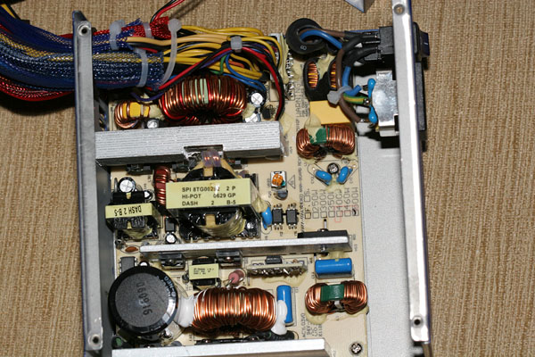

                      What kind of PFC is that crap? Another wonder like that 2x cap+2x diode+2x resistor Chieftec (Enhance) was using which just burned power and the caps always went bad?
                      In that Fortron, the two diodes are between the input cap and the +5 V SB transformer. D41 and D42 IIRC. There is a thread about extensive repairs of these units you can read there what goes often wrong.
                      As for the input cap, I suggest using 420V. FSP often used 420uF/420V caps in Blue Storms II (retail version of that) and I never seen any failed even though they've been Teapos or CrapXons.

                        Through the fan grill I can see one diode, as in this photo.

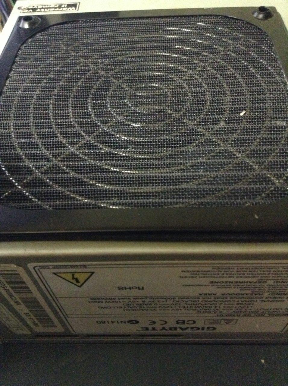

                        Sometimes, before the plastic of the capacitor is partially burn, I covered with the tablet a portion of the fan grill. But not the day which happens the burnt.
                        It was very dirty, so maybe that was the reason.
                        It is now with a grid that protects the main entrance of air.
