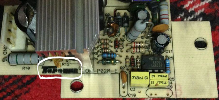

                    #49
                    Re: Tagan TG480-U01 480W ATX PSU

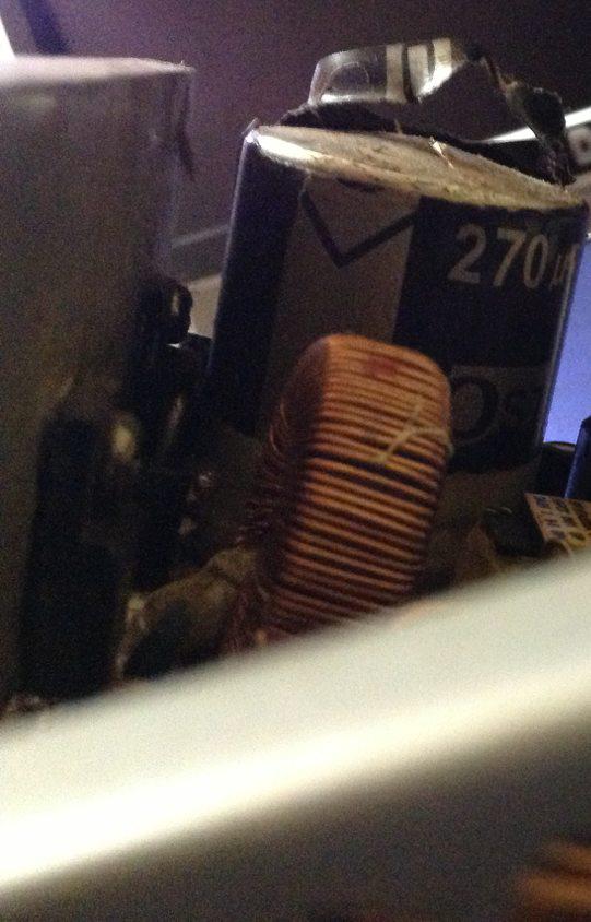

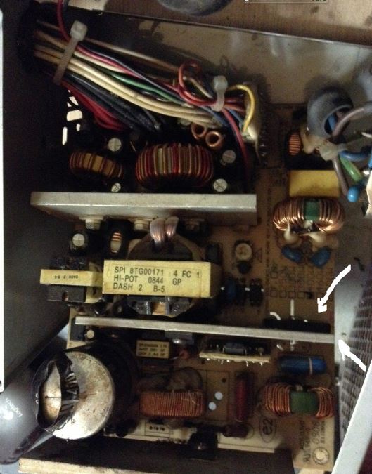

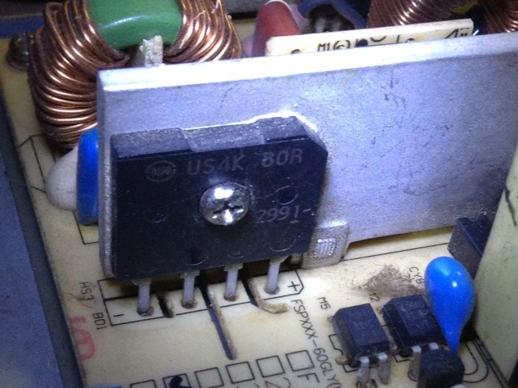

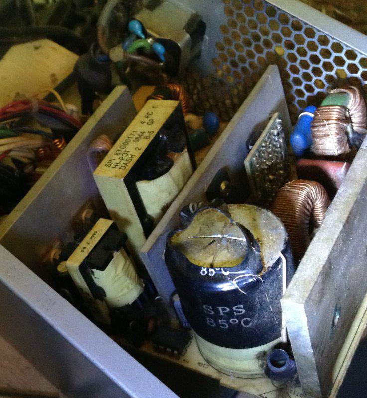

                    Hello.
                    I have a Tagan TG480-U01 (Topower) from 2004 and a Gigabyte GE-R460-V1 (FSP 400W).
                    I cleaned the Tagan psu in 2007 with compressed air , the fan began to turn at least 4000-5000-6000 rpm ( max in this fan is 1800 rpm), I was happy
                    because I thought it was going to be very clean, but when finished cleaning I note that it smelled of burning.
                    Logical, I had spun the fan so it had generated electricity, even too much.
                    Worried, I turned on the computer , it went on but I noticed that the external fan was not spinning. But the computer went ok.
                    If I pushed a bit of a fan blade, it began to turn, but there were times it stopped and I could not always be aware of pushing for reacting .
                    It was so for a few months until one day stopped working and as I had no time to research how to fix it, I decided to buy a new PSU Gigabyte GE-R460-V1 (FSP 400w ).
                    Actually I'm using the Gigabyte (FSP) in my desktop but 3-4 weeks ago when I turned it on, it started to smoke so a I quickly I turned off. I looked
                    through the grid and saw the plastic wrap from above the primary cap was burned but did not seem that the capacitor had burst and released liquid on
                    top.
                    Cross the fingers and try to light on to see what happened (could have fried the computer easily).
                    Until today I have the desktop 24/7 and do not want to turn it off because I understand or think the time that which suffers most the primary condenser
                    is at startup (from off) and not being on.
                    I know that my behavior is unconscious and I'm playing Russian roulette with my computer but I want to repair it ASAP.
                    The primary cap is a OST serie SPS 270uf 400VDC 85ºC 30x35mm(DxH) Ripple(120Hz 85ºC)=1.70
                    http://www.ost.com.tw/products_ec_list.asp
                    I thought replace it with this one:
                    Panasonic serie TS-ED EETED2G271DA 270uf 400VDC 105ºV 30x35mm(DxH) Ripple(120Hz 105ºC)=1.56 ESR(120Hz 20ºC)=0.491
                    https://cdn.badcaps-static.com/pdfs/...b77415dbfa.pdf
                    I was making the order for this capacitor when I found in this forum a thread of the same model from the other psu that I have completely broken, Tagan
                    TG480-U01 (Topower).
                    So I'll wait a few days to also buy caps for both.

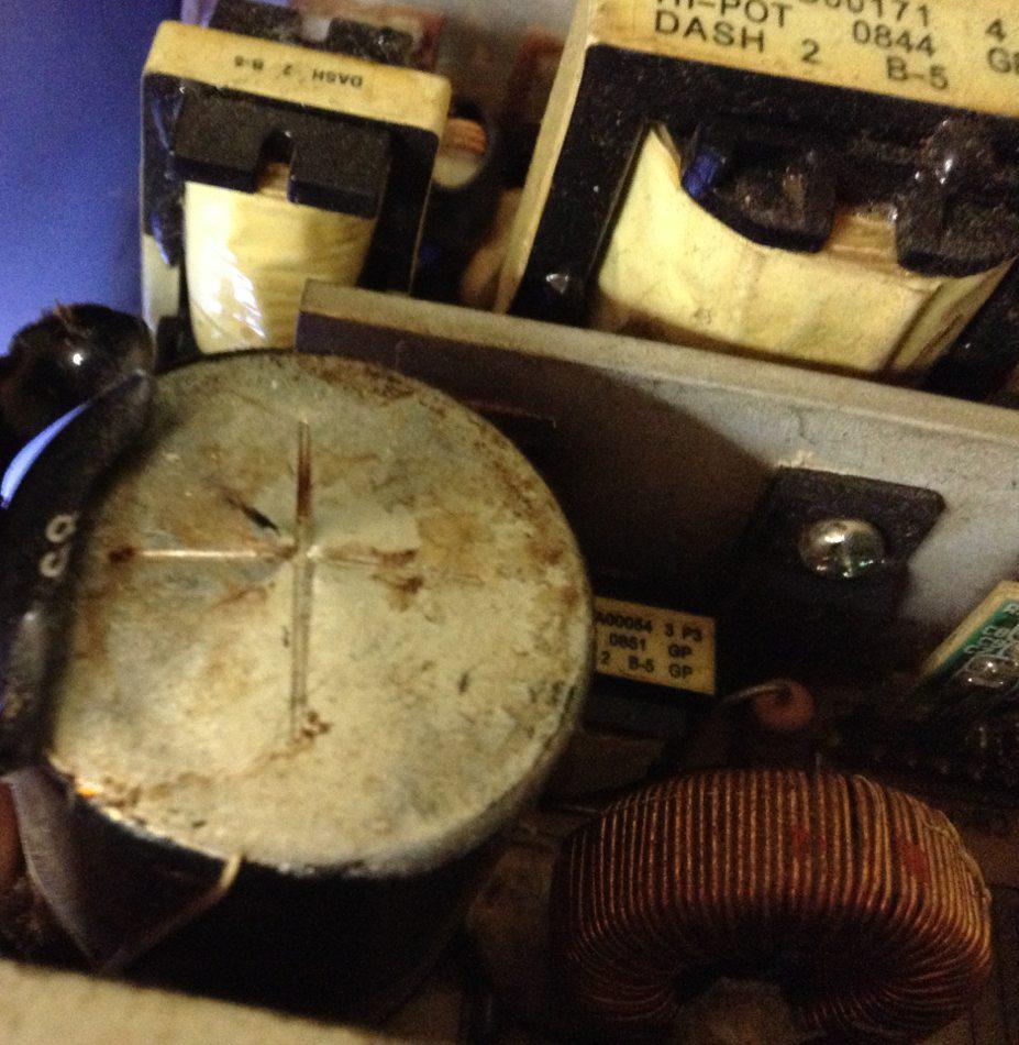

                      #50
                      that cap has got VERY hot,
                      there may be other problems that caused it.
                      you should check the mains rectifier.

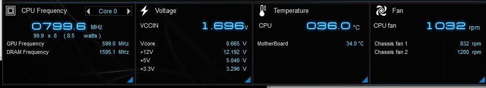

                        #51
                        Thanks stj for your quick answer to a newbie.
                        I'm writing now from the desktop with this psu (Gigabyte-FSP).
                        I only have a multimeter, no oscilloscope.
                        Now I'll search in google how to check the mains rectifier.
                        These are the voltages that motherboard shows.
                        Maybe the VRM in the motherboard is doing a hard job stabilizing bad voltages from the PSU.
                        Repeat from my last post, "I know that my behavior is unconscious and I'm playing Russian roulette with my computer"

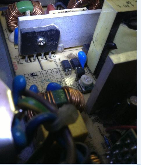

                          • ep9es
                            • Jul 2015
                            • 24
                            • Spain
                            #53
                            Checked diode function. (no desoldered, checked in circuit)
                            You're right about the bridge rectifier.
                            No diode between +pin/ACpin and NO diode between -pin/ACpin (check in both senses)
                            Only continuity between -pin and the screw
                            How is it possible this psu can works now??
                            Then I must replace the primary cap and the bridge rectifier.
                            Do I replace the same rectifier or do you recommend me an equivalent/similar??
                              • 31304
                              #54

                                Well, I'm stupid
                                I was using in the multimeter the continuity scale(200R) but not the diode scale (2KR).
                                I desoldered the rectifier.
                                If the pins are like this - ac1 ac2 + , and the multimeter cables are Red(R) and Black(B), the measures are:
                                -(R) ac1(B) 0.55
                                -(R) ac2(B) 0.55
                                -(R) +(B) 1.241
                                +(B) ac2(R) 0.544
                                +(B) ac1(R) 0.544
                                +(R) -(B) infinite
                                ac1(R) ac2(B) infinite
                                ac1(B) ac2(R) infinite
                                Other combinations, also infinite.
                                Then, Is it ok??
                                I will wait your answer to solder it again into the board.

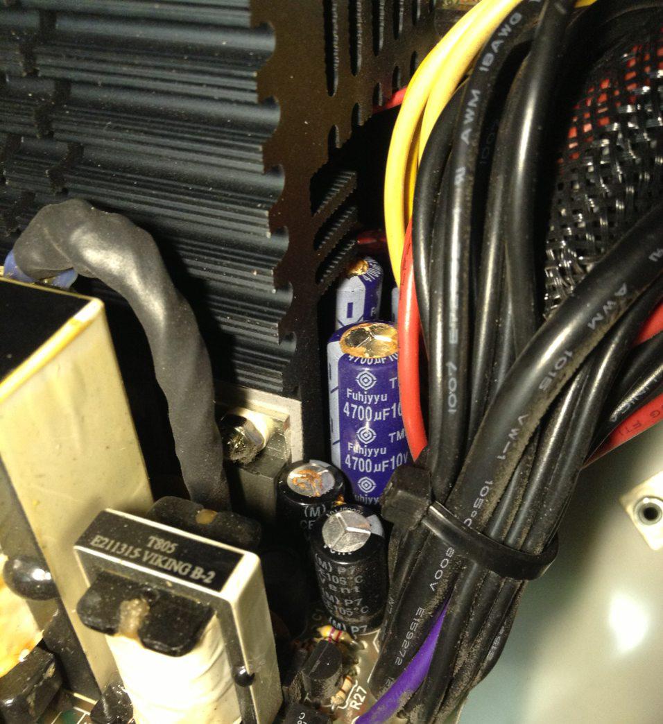

                                  #56
                                  PFC coil looks good.
                                  Just replace ALL caps and stop using that thing with bloated primary cap for gods sake!!! Switchers must be overloaded like hell and I don't want to see that ripple.

                                    #57
                                    Thanks for your advice.
                                    Of course, I want to replace the primary cap, and because you recommend me also replace ALL caps.
                                    They're not bloated and now I'm checking them using a digital multimeter:
                                    http://www.electricaltechnology.org/...h-digital.html
                                    This psu is a FSP one, but I also have a Tagan 480w to replace all the caps (Fuhjyyu) except may be primary ones (Panasonic).
                                    This thread is about Tagan psu. In the next post I want to explain you the caps that are broken in Tagan one and what caps to replace them (Panasonic).
                                    Because shipping cost, I would like to make only 1 order to the eshop for caps and other components (is it the bridge rectifier ok? ).
                                    Now the psu components are cold, so is it dangerous to switch on using this bloated primary cap?
                                      It is FSP GLN platform, the caps will fail so just replace them right away and you will be OK.
                                      I can supply you with caps, got D8 especially for these platforms. Also suggest checking/replacing the diodes in stand-by curcitry, they often use GP 1N4007 instead of fast diodes.

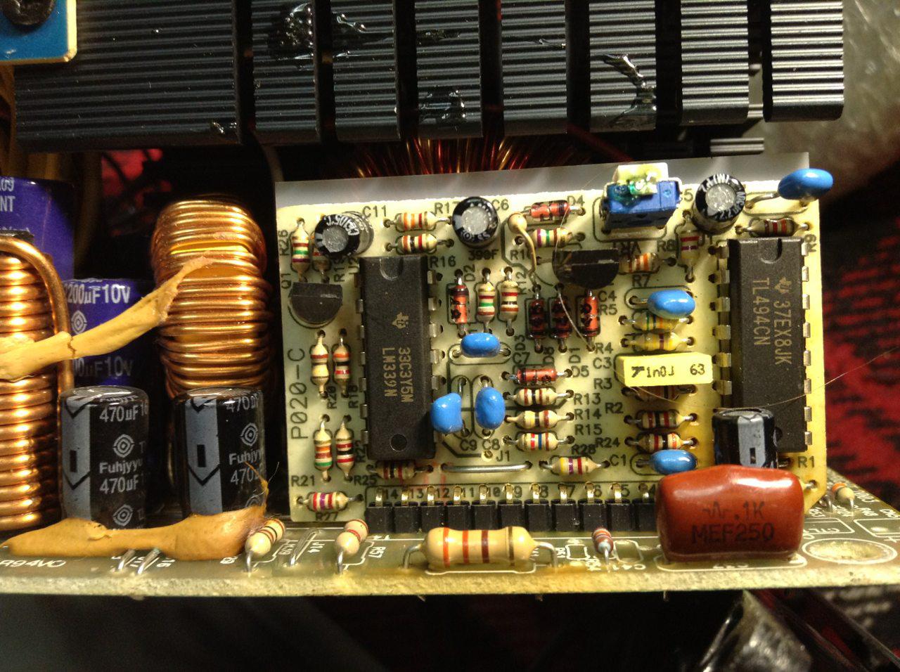

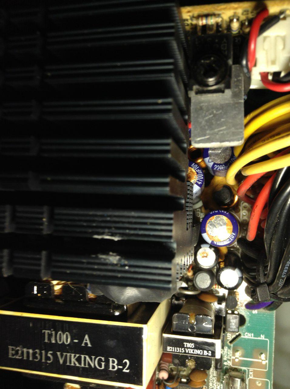

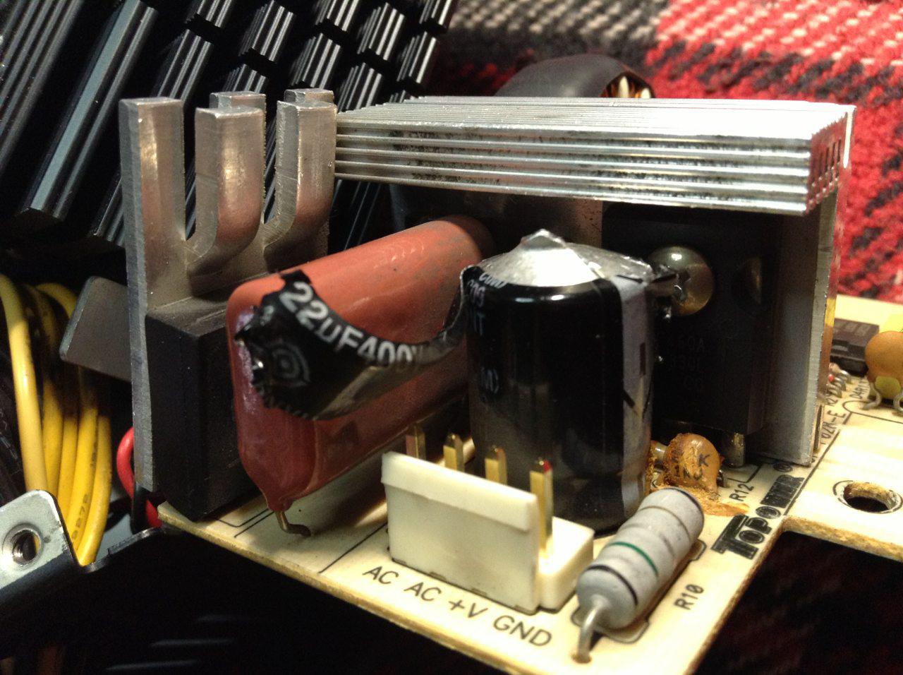

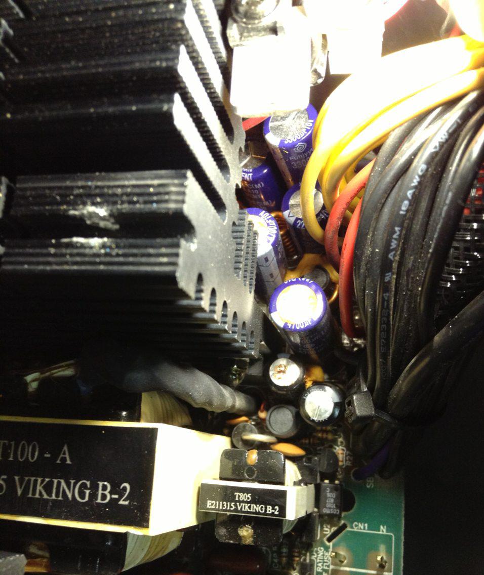

                                        I'll look at the characteristics of the other capacitors (fortunately in this FSP psu are few).
                                        This thread is about Tagan TG480-U01, and I have one broken.
                                        When I took and opened, I thought: "Wow, it's heavier than the FSP and (for me) very well built. It seems semi-passive!! "
                                        I had read some people say that Topower not be in the highest level psu's, but I think is enough.

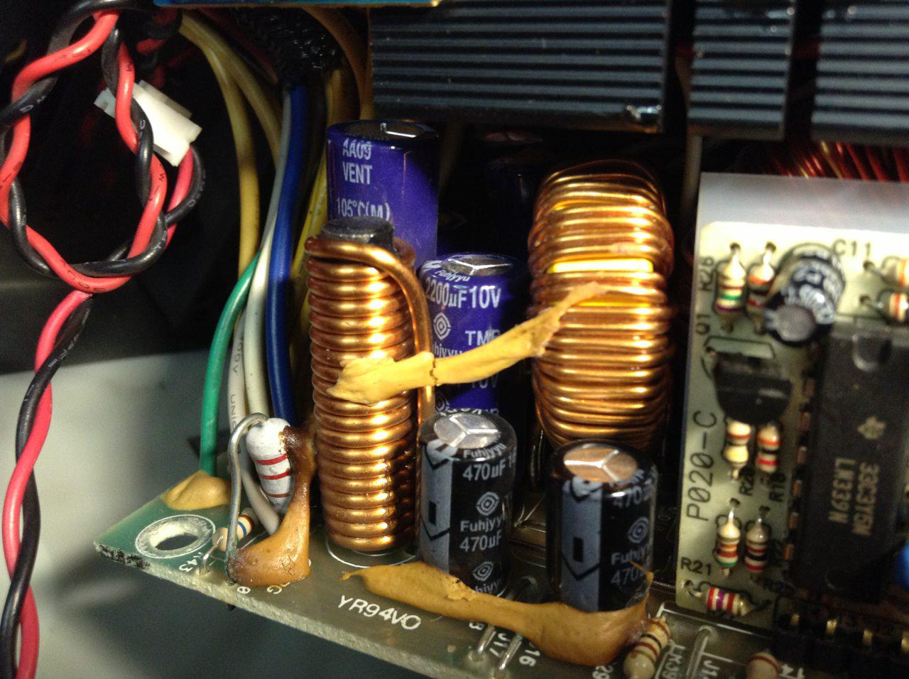

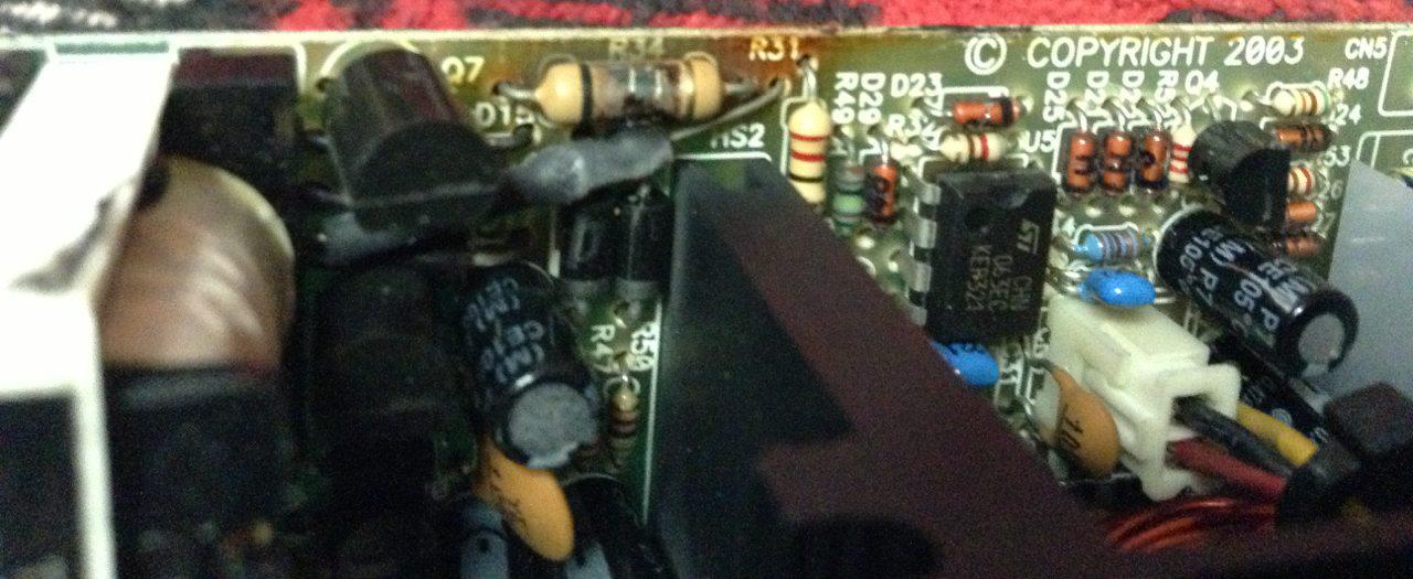

                                        In the Tagan psu I found these caps:
                                        - PFC board: broken 1x Fuhjyyu MK 22uf 400v 85ºC
                                        - Primary: OK 2x Panasonic 680uf 200v 85ºC
                                        - Secondary: want to replace
                                        2x Fuhjyyu P7 1000uf 10v 105ºC
                                        2x Fuhjyyu P10 4700uf 10v 105ºC
                                        2x Fuhjyyu TMR AA10 2200uf 10v 105ºC
                                        1x Fuhjyyu TMR AA09 3300uf 16v 105ºC
                                        2x Fuhjyyu P7 470uf 16v 105ºC
                                        Apart from these, I see more little capacitors, they seem ok, not bloated and are difficult to access.
                                        Seeing the specifications of these capacitors I think I can't use repeated capacitors because they have different capacitances .
                                        That is, I think I'll have to replace them with others with the same capacity and perhaps higher voltage.
                                        Behemot, your eshop is HV World, no??

                                          #60
                                          I think it also could be due to overvoltage.
                                          Or that cap was just lying around too long...
