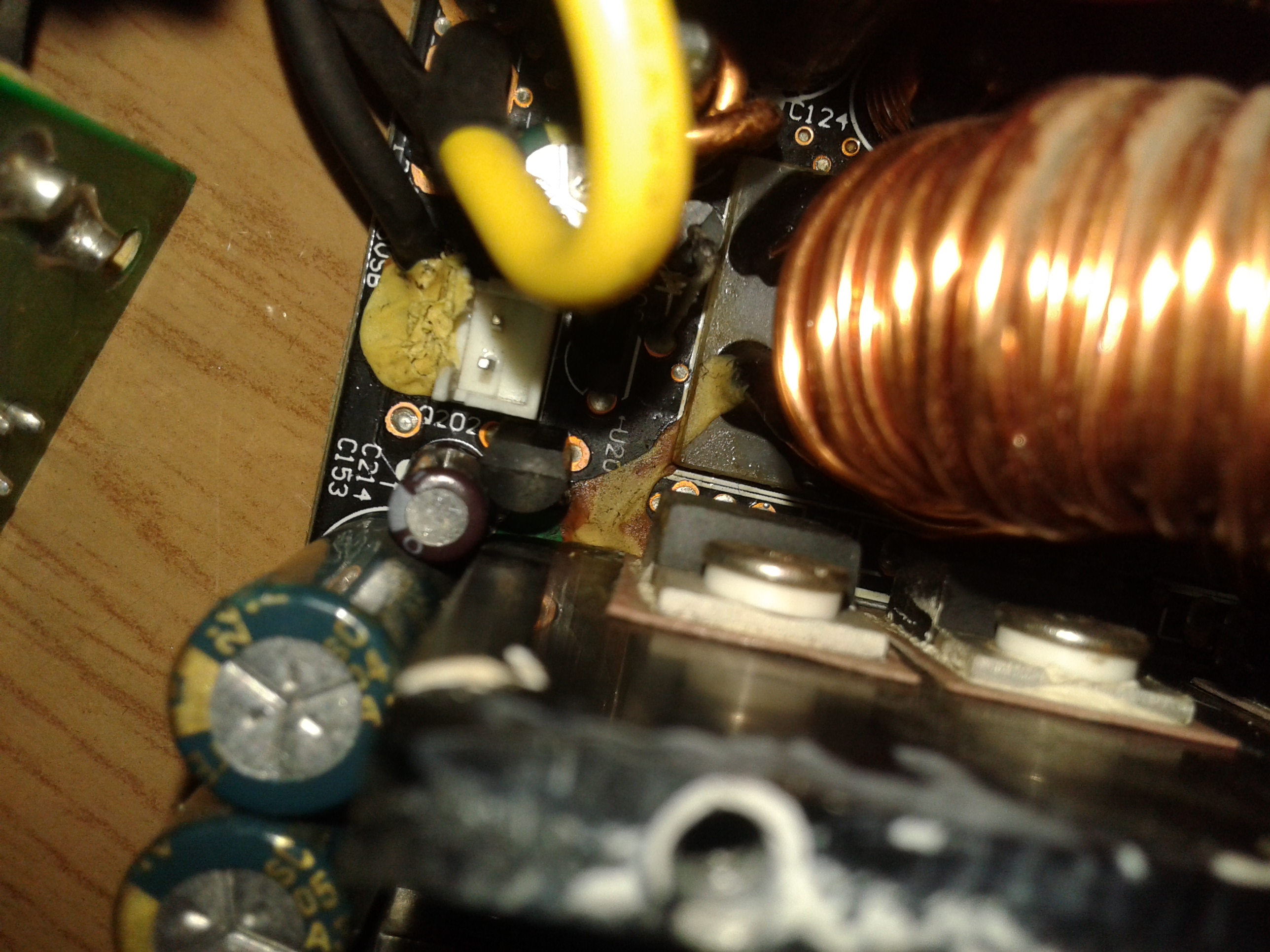

01-18-2017, 03:25 PM
Re: Cougar CMX 700W suddenly Went off
Was talking about a 20w watts though
Post
Cancel
Drack
Yup it's me
Join Date:
Nov 2016
Posts:
297
Country:
Venezuela
01-18-2017, 03:53 PM
Told you check d10 out of the circuit
Post
Cancel
abdorefky
Join Date:
Jan 2017
Posts:
19
Country:
Egypt
01-18-2017, 03:55 PM
Originally posted by
Drack
View Post
i just did, it's working fine . and in 1 direction only
Post
Cancel
Drack
Yup it's me
Join Date:
Nov 2016
Posts:
297
Country:
Venezuela
01-18-2017, 03:57 PM
Check the others too
Post
Cancel
abdorefky
Join Date:
Jan 2017
Posts:
19
Country:
Egypt
01-18-2017, 03:59 PM
Just found dark brown here too !!
abdorefky
01-18-2017, 04:01 PM
Reason:
adding the photo
Post
Cancel
Drack
Yup it's me
Join Date:
Nov 2016
Posts:
297
Country:
Venezuela
01-18-2017, 04:21 PM
Took it off, a short can make the PSU to shut off
Drack
01-18-2017, 04:40 PM
Post
Cancel
abdorefky
Join Date:
Jan 2017
Posts:
19
Country:
Egypt
01-18-2017, 04:55 PM
The fan ticks or makes something when you short ps on with ground or just dead?

Just dead Fan

stj
Join Date:
Dec 2009
Posts:
30775
Country:
Albion
01-18-2017, 06:49 PM
change all small caps.

abdorefky
Join Date:
Jan 2017
Posts:
19
Country:
Egypt
#29
04-02-2017, 11:16 AM
Changed all capacitors
Still nothing .
What about the secondary supervisor ? What should i do on it ?

abdorefky
Join Date:
Jan 2017
Posts:
19
Country:
Egypt
#30
04-02-2017, 12:58 PM
Behemot
View Post
that's normal condition, by pulling the signal down the supervisor starts the main power supply
Hello Behemot
Any idea about what i should do now ?

kc8adu
Join Date:
Nov 2003
Posts:
8829
Country:
U.S.A!
#31
04-07-2017, 12:52 AM
green corrosion behind q202.
dammed brown glue ate a trace.
