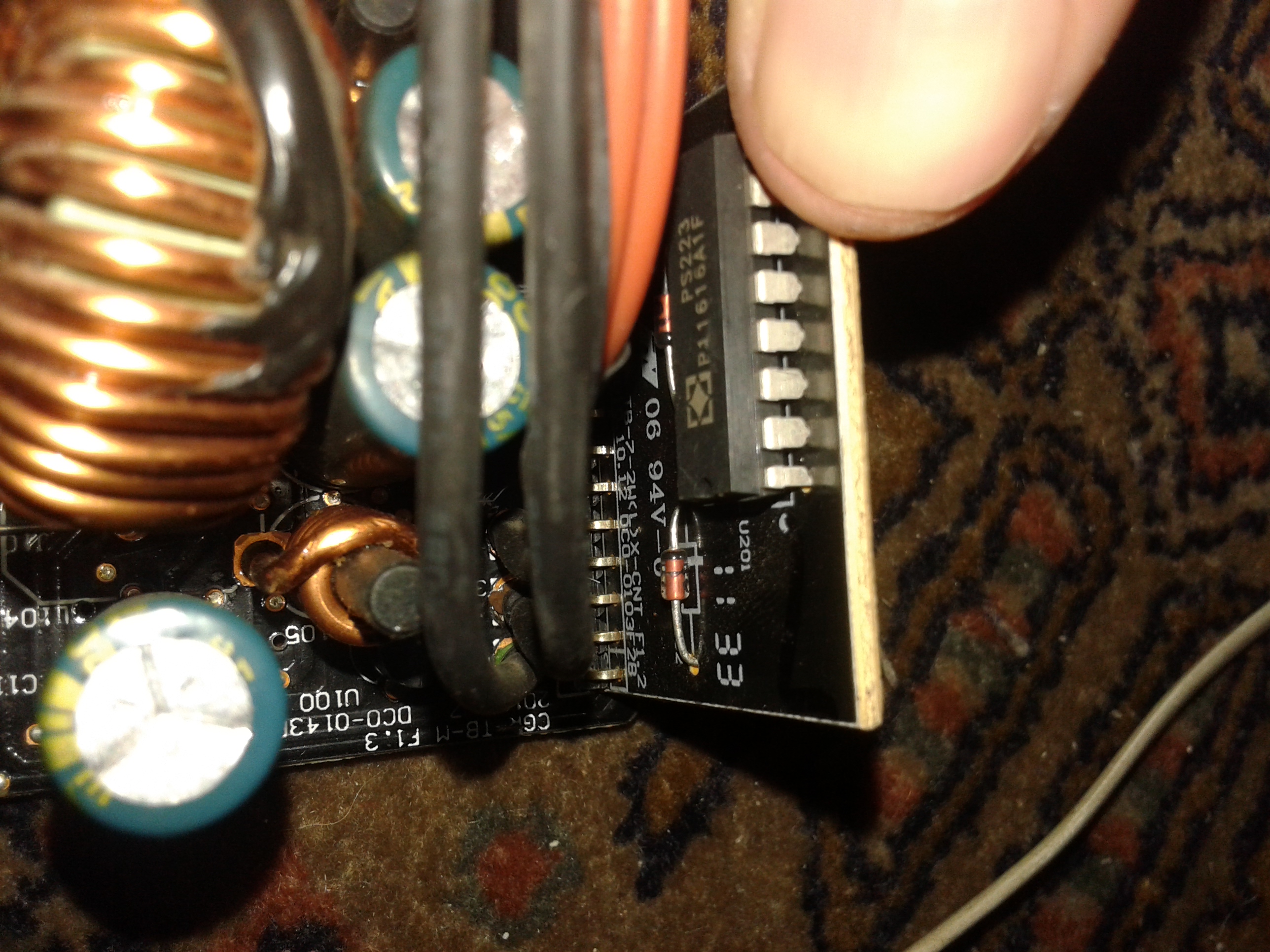

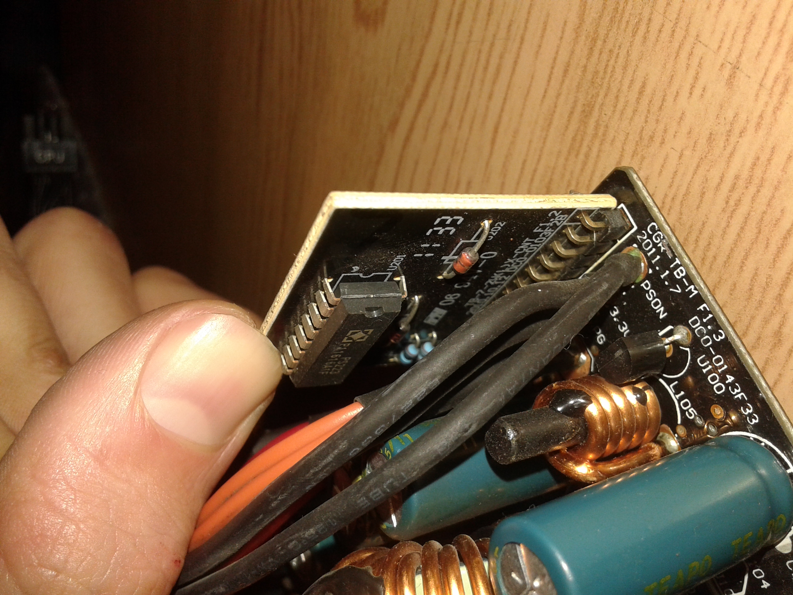

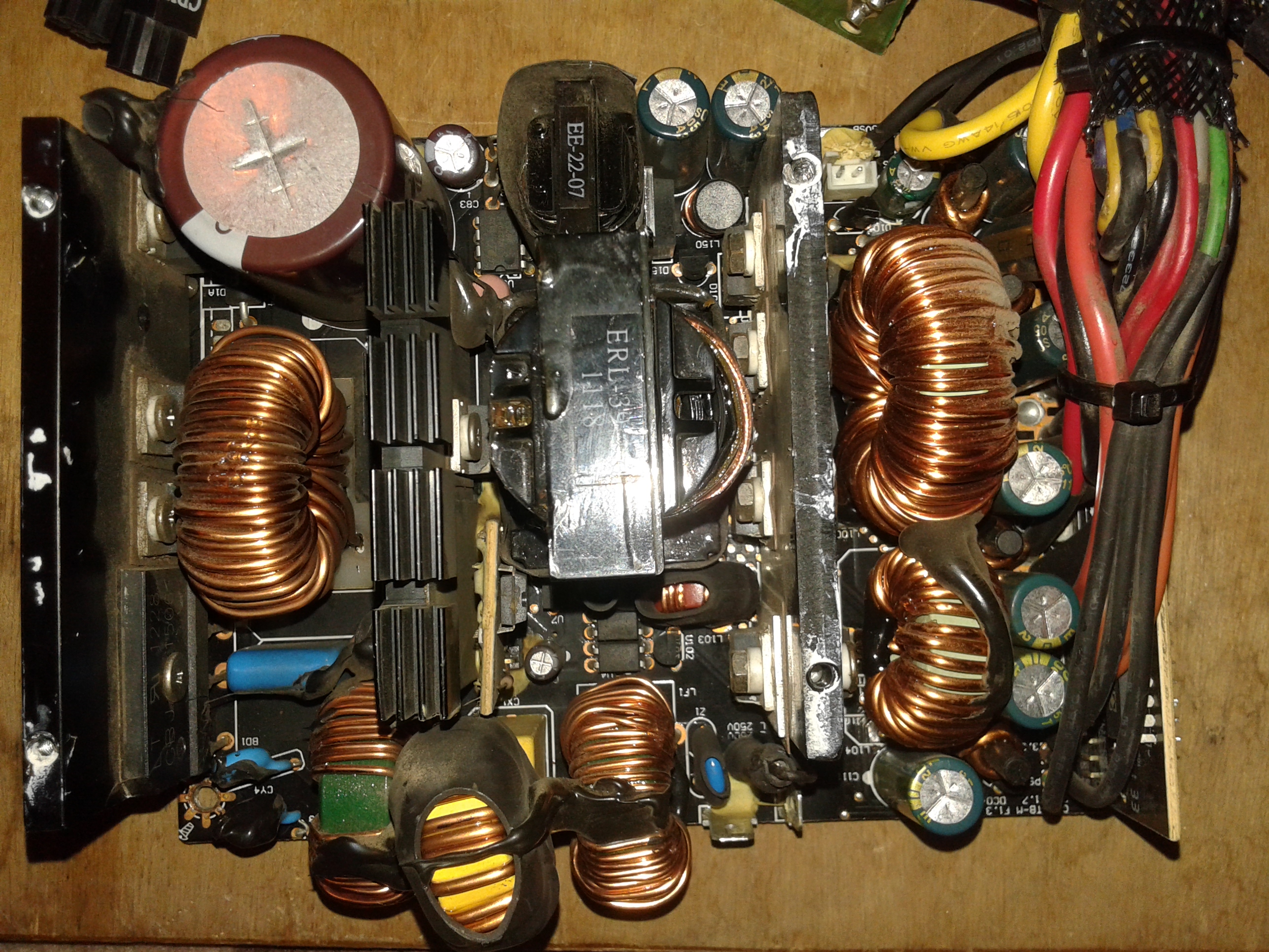

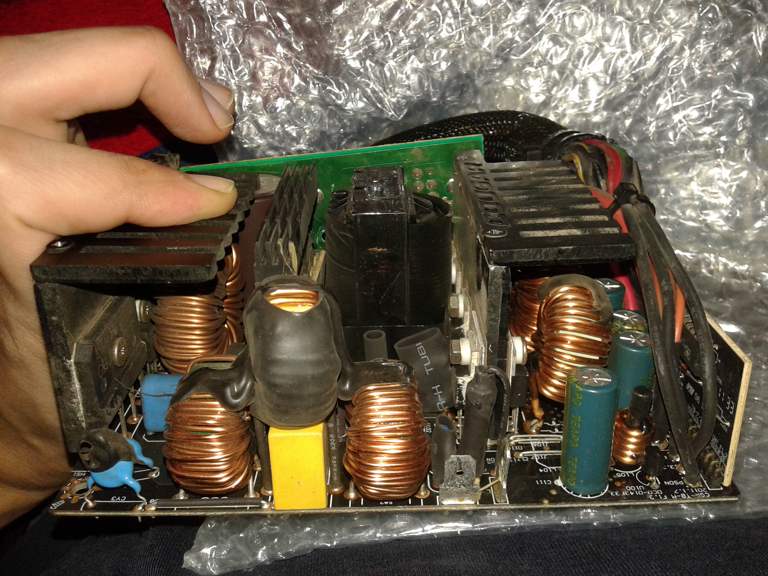

    i have : Cougar CMX 700W
    Model : CGR B2-700
    the power supply stopped working.
    i tried to connect the green wire with the black wire to activate the fan but still nothing ! .
    how can i troubleshoot such thing ?
    Thank you

      Re: Cougar CMX 700W suddenly Went off
      I'd also be looking for the 5V STBY rail first while the PSU is plugged in. If the STBY rail works, force the PSU on and check the DC voltatge on the main filter capacitor. Be careful, you are connected to mains voltage and if the PFC booster is running, there is 390V DC on that capacitor.
      Can you explain as best as you can what happend? Did it just turn off, or was there a bing bang, or is the fuse blown etc?

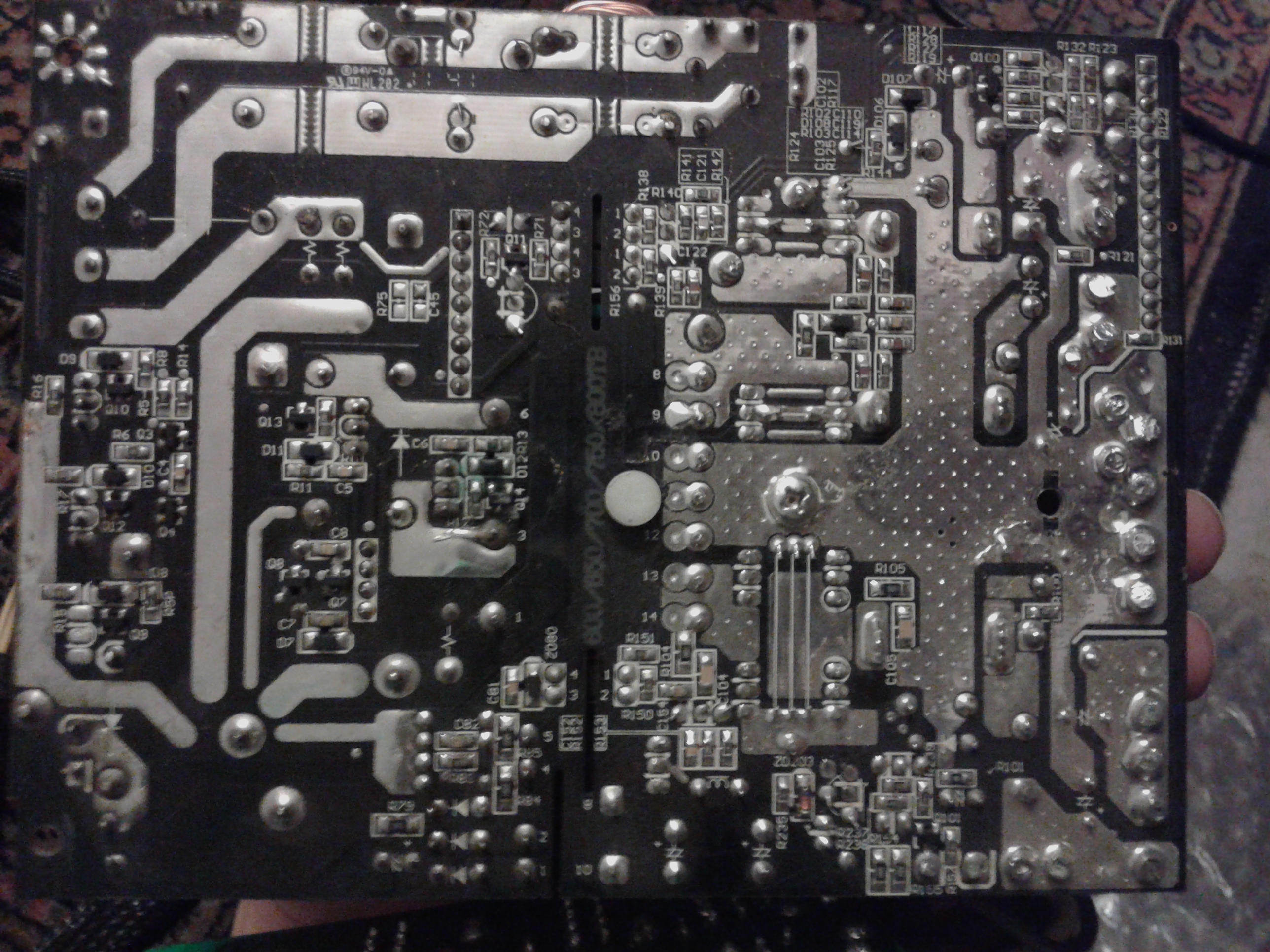

        I'd be curious to know if the thing is getting 5VSB too. When you hit the power while shorting PS_ON, does the fan tick for a second? I noticed that the daughterboard between the primary heatsink and main transformer is covered in what looks like conductive glue. Look closely to see if there are any burn marks there.
        Black PCBs look cool but make troubleshooting harder since you can't see discoloration very well
        Check the startup cap as well which looks to be that small cap by the large high voltage cap.
          good morning every one and sorry for the late replay.
          i have tested all voltages while shorting the PS_ON
          the only working one is the 5VSB ( and it doesn't need to short on PS-ON ) it on all time.
          all other voltages doesn't work .
          should i should more photos for the power supply ?
            The DC voltage on the main capacitor is 320
            about what happened : i tried to turn it on but it didn't !!
              i have made some Diode testest
              D81,D82,D83 = .455
              D24 = .345
              D10 = .310 ( but on the reverse it keep counting up and stop at 1.1)
              D6 = .445
                Addtional photo.

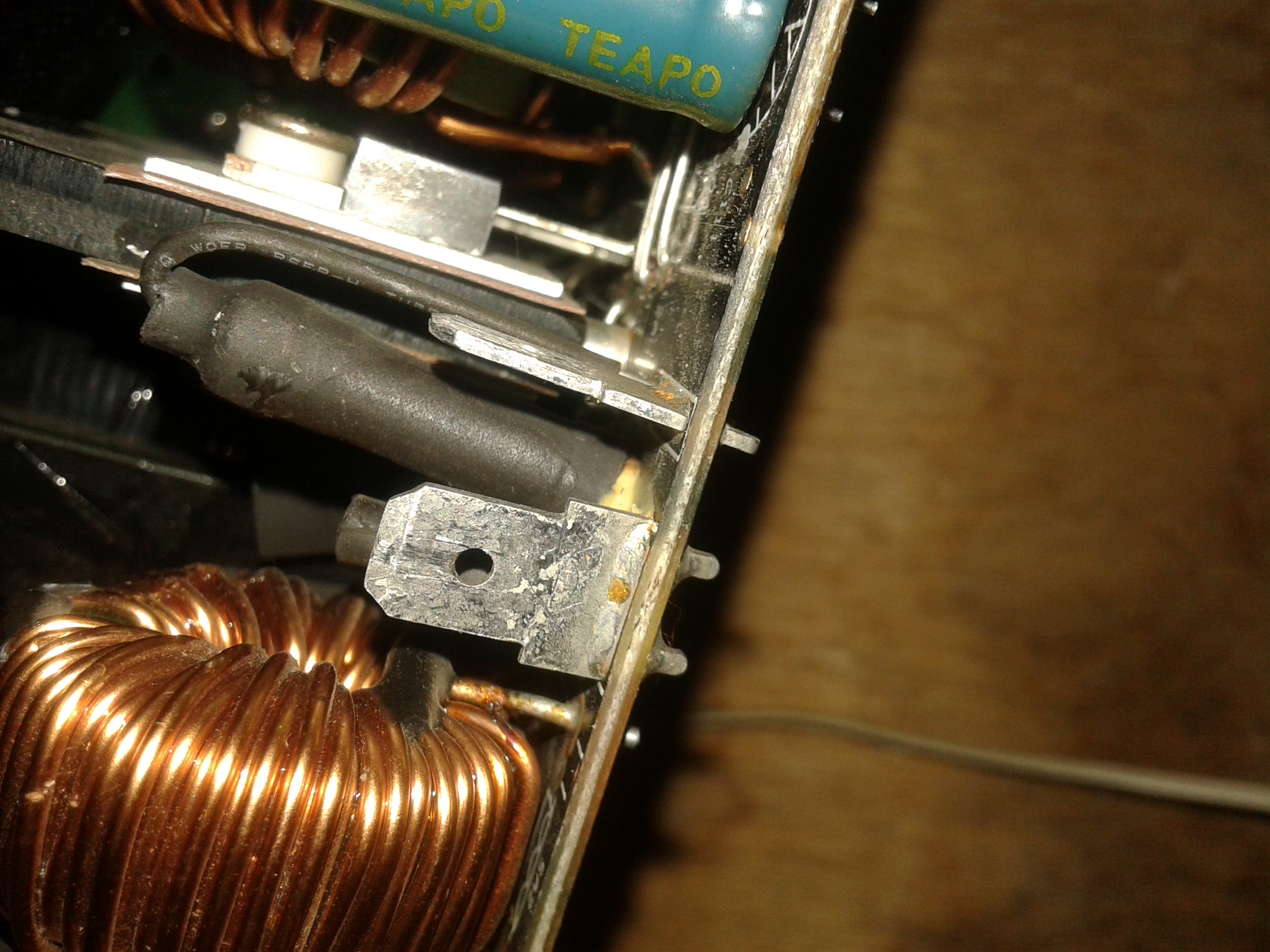

                  Seems like you have some chloroprene glue in the unit, check if it went brown somewhere shorting something and if so, clean it.
                  Do you have about 3.3 V on the green wire?
                    Hello Behemot,
                    i don't have the 3.3 V on the green wire
                    about the brown i have attached those 2 photos the view some brown.
                    but how to clean it with out damaging the board ?
                      Well, badly.
                      If you don't have PWR On available than no wonder it can not be started. Most likely problem with the secondary supervisor.
                        Make sure you measure the green wire without connecting it to ground, ie: without trying to force the PSU on.
                        That glue is much easier to remove if you heat it, try a hairdryer or heat gun on low temperature. Carefully pull it off with pliers or such. Don't damage the parts under it.
                          I can see Silicon Touch Technology logo, which one is there?

                              • abdorefky
                                • Jan 2017
                                • 19
                                • Egypt
                                PS223
                                P11616A1F
                                Board by ****** i dunno the logo
                                06 94V-0
                                TB-7-2W(L)X-CNT F1.2
                                2010.10.12 DC0-0103F2B
