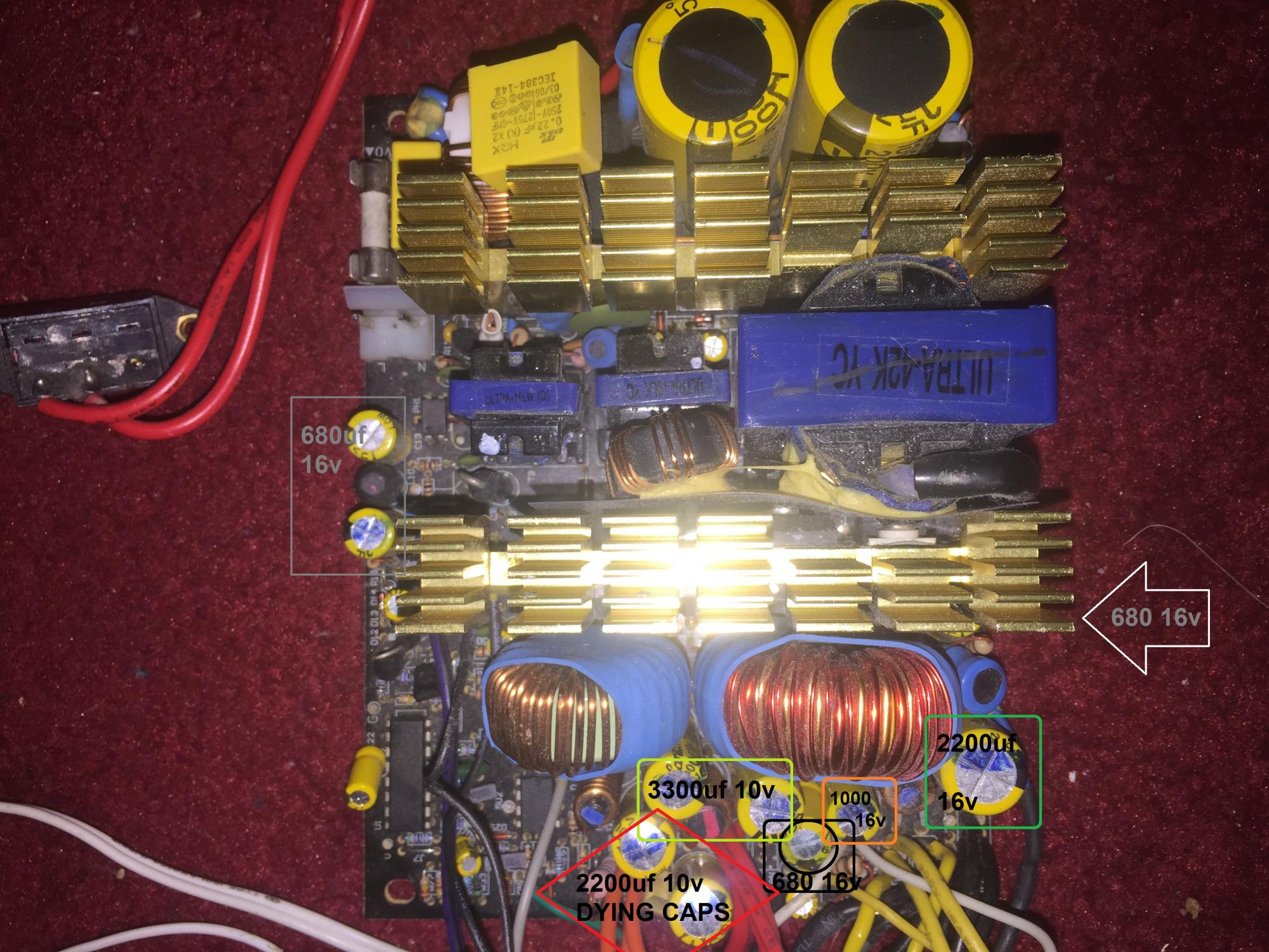

      i just desolder the camicon 3300uf 10v cap and it tests at
      5229uf
      0.18ESR
      2.2%Vloss (not sure what that means)
      it looks to be a badcap
      I'm not a expert, I'm just doing my best.
        • 30934
        #63
        Re: badcaps in a ATX PSU
        Vloss looks o.k. - if it's over about 4% it's not looking good.
        but yes, that's a very bad cap

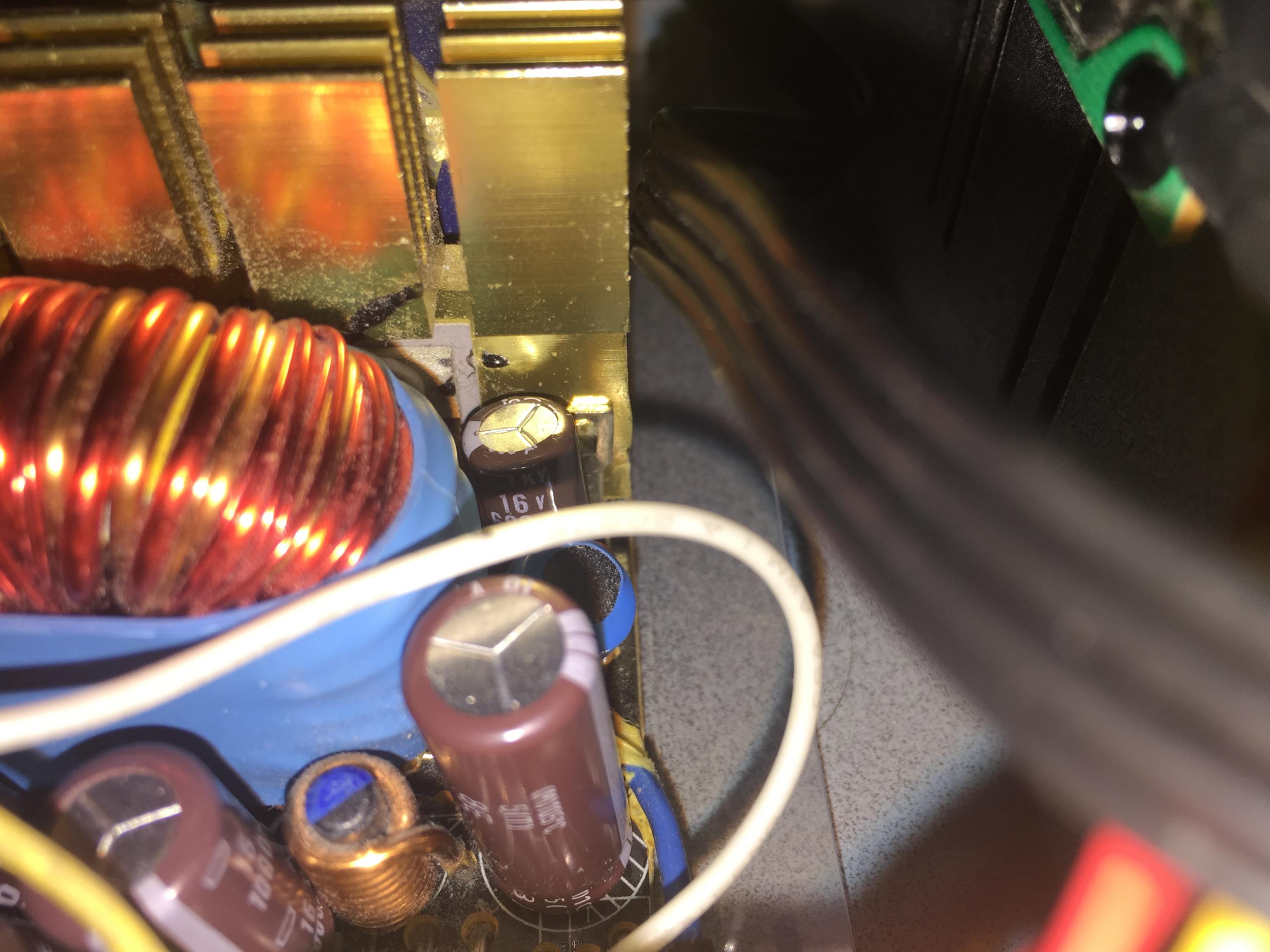

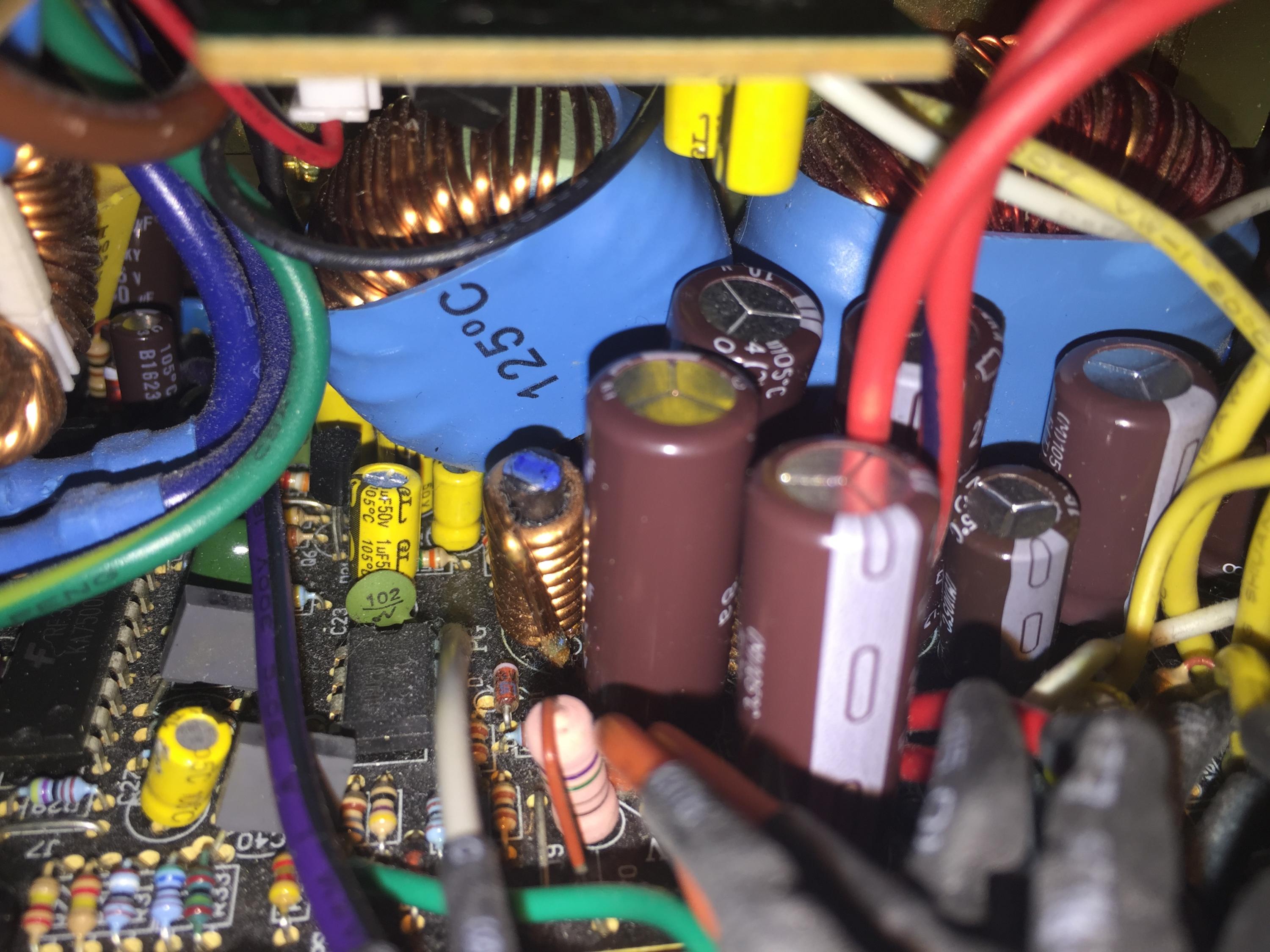

                                  and i did not do all of the small caps since some are in hard to reach parts of the PSU and because i accidentally burned my hand trying to desoder one but it feels better now
                                  ok here are the pictures you want
                                  and it does run

                                    Good work, sir! Looks beautiful. Take a gander at all those nice Japanese quality caps... No, don't use WD40 for the fan

                                      oh and out of all of the bigger caps i replaced [500UF+] only 2 of the 9 caps tested within specs for capacity
                                      them being a 1000uf 16v canicon
                                      and a 680uf 16v GL [or gold-link]
