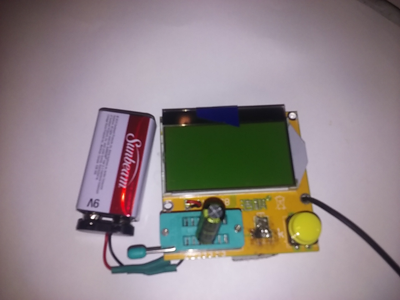

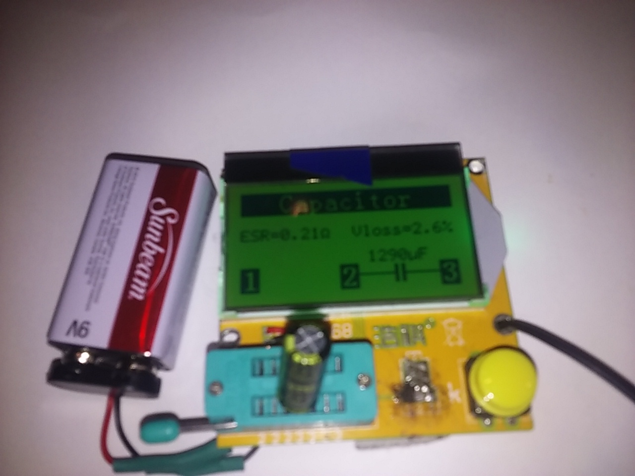

                              here is my ESR meter
                              I'm not a expert, I'm just doing my best.
                                • 30950
                                #55
                                Re: badcaps in a ATX PSU
                                T4, with a burn mark??
                                • RukyCon
                                  A Fake Rubycon
                                  • Jan 2017
                                  • 816
                                  #56
                                  don't ask me how
