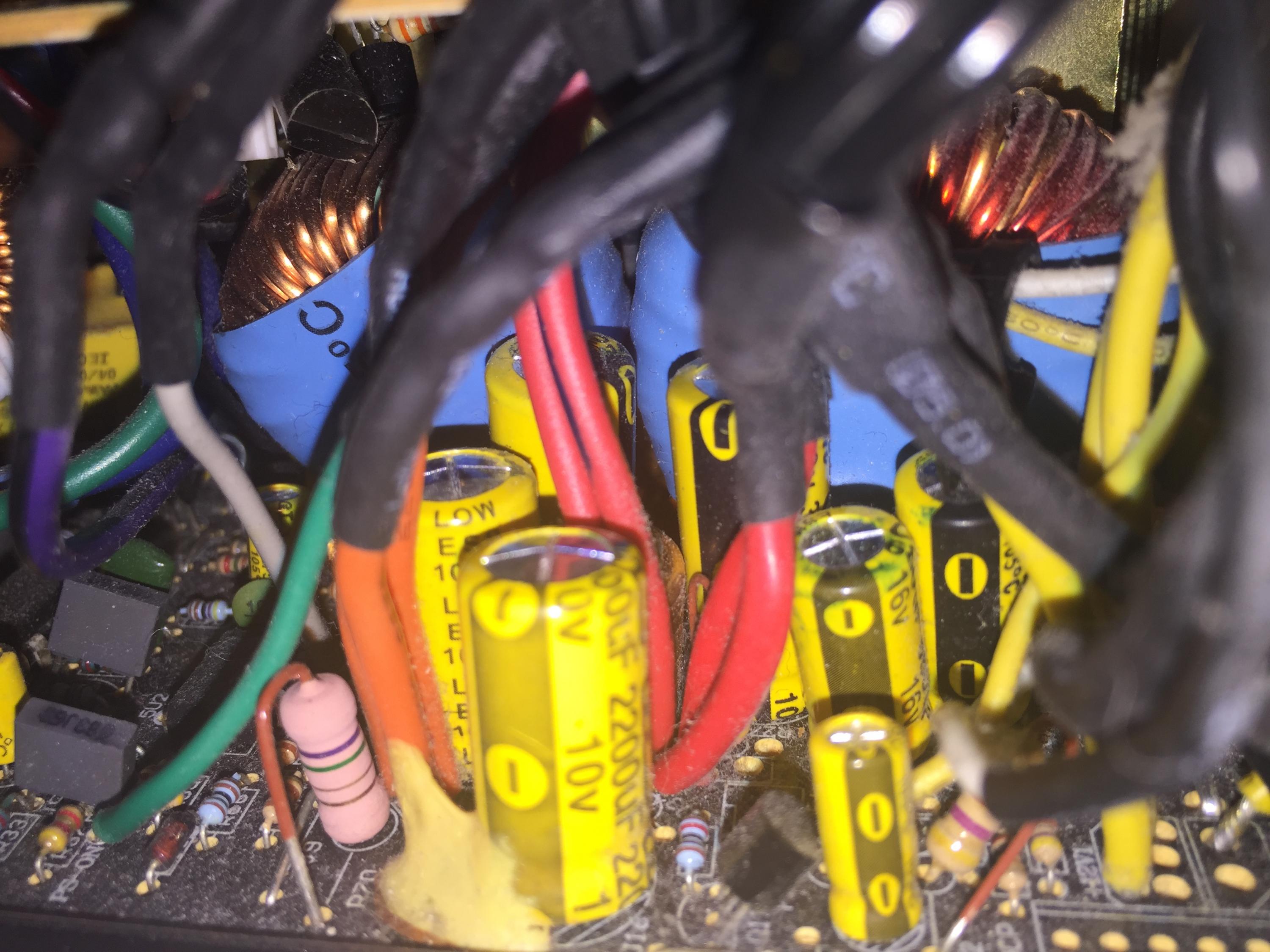

    hello i have a good PC PSU which i got from HSC Electronics used for $6 on sale.
    now i say the PSU is good but it's not 100% good because i wanted to open the power supply up (just to see how it work) but then i spotted 3 bulging capacitors brand GL [note there are also canicon caps in the PSU]
    cap1&2 is a 2200uf 10v
    cap3 is a 680uf 16v
    now that is the bad ones but there are a lot more and they are not dead or dying should i just replace the bad ones or should i change them all out and what brand cap should i use?
    here are some pictures i took
    here are the bad caps
    i hope you can help. thank you

    Re: badcaps in a ATX PSU
    change all of them.
    if you where in europe i would say use panasonic FR series,
    but in the states other decent brands are cheaper for some reason.
      Originally posted by stj
      change all of them.
      okey that's good to know
      at first i thought they were dying do to heat because i found them in a poorly ventilated part of the power supply
      but i did see a case where the canicon caps had died posted online by Kevin! on badcaps
      i'm glad that i open the PSU up now because who knows how it could have failed
        now i need to know what brand/line should i use? (like nichicon HD, rubycon ZLH, etc)
        I'm not a expert, I'm just doing my best.
          • 31278
          check prices at digikey
          before you do, make a list including the diameters.
          some company's make caps that are wider & wont fit - something to watch out for.
            Nice PSU. Needs a full recap. All of those caps are going to have to go except for the big high voltage caps. Typically for ATX SMPS, I use nichicon PW, HE, Panasonic FC, Rubycon YXF, Chemi-Con KY/KYB. You should be good height wise, just make sure you don't get any caps bigger than d10mm
                here are some capacitors that should work
                old cap -=-=-=-=-=-new caps
                GL 1000uf 200v - nichicon LGN 1000uf 200v [do not need]
                GL 680uf 16v - rubycon ZLH 680uf 16v http://www.digikey.com/product-detai...935-ND/3563424
                canicon 3300uf 10v - panasonic FR 3300uf 10v http://www.digikey.com/product-detai...383-ND/2433517
                canicon 2200uf 16v - rubycon ZLH http://www.digikey.com/scripts/DkSea...97480325358996
                canicon 1000uf 16v - rubycon ZLH http://www.digikey.com/scripts/DkSea...97483696382927
                if you know of any better brands/lines then please inform me
                thank you
                EDIT oh and i forgot to add this
                GL 2200uf 10v - chemi-con KY http://www.digikey.com/scripts/DkSea...97494034970927
                      Honestly, I think ZLH/ZLJ is too low ESR for PSU
                      • Pentium4
                        CapXon Be Gone
                        • Sep 2011
                        • 3741
                        I think FR is too low as well, you're talkin 0.018Ω, that's pretty low for a PSU. I bet you the original Canicon were much higher in impedance. You don't want to try and jam 12.5mm caps in there anyways. I'll recommend some when DigiKey's site isn't down
                          DigiKey should carry Nichicon PW, UCC LXZ, and Panasonic FC. Those are very similar series, and should be reasonable matches for what was originally in that PSU - in terms of impedance and ripple current rating (the quality will be much better).
                            ok good to know i chose rubycon ZLH because i found some in a PlayStation3 PSU and the panasonic FR because stj kinda recommended it to me
                              the new caps i'm looking at now are
                              the rubycon ZLH 680uf 16v is now a chemi-con KY http://www.digikey.com/scripts/DkSea...97610346542927
                              can not find a exchange for panasonic FR 3300uf 10v
                              im looking at getting a chemi-con KYB for the 2200uf 16v cap but it's a bit tall [16mm vs 31.5mm http://www.digikey.com/product-detai...869-ND/4843679
                              can not find a exchange for rubycon ZLH 1000uf 16v
                              2200uf 10v is still a chemi_con KY
                              if you know of any other options then i would love to know
                              thank you

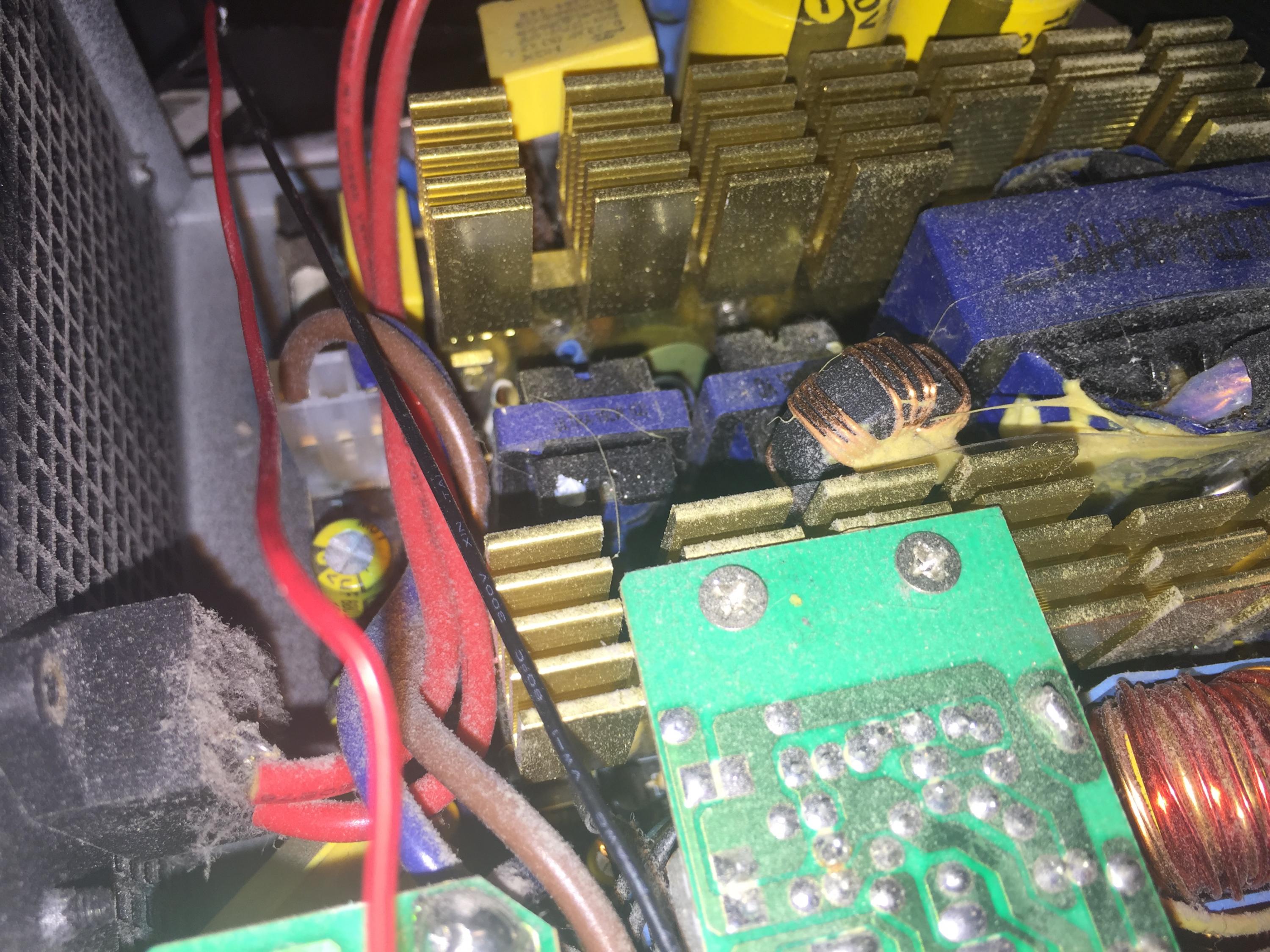

                                Get rid of that tan glue. It turns brown and goes conductive
                                I had an HP small form factor power supply short out from that glue. It took me over an hour of scraping to get it out.
                                    You really don't need 3300μF for the minor rails. You can use 2200μF 10V for the 5V and 3.3V rails.
                                    http://www.digikey.com/product-detai...1509-ND/756025
                                    Those 2200μF 16V KYB will work well for this PSU, they are actually 10x30mm
                                    You can use these for the 1000, 16
                                    http://www.digikey.com/product-detai...1527-ND/756043
                                        Click on the link from the original post, not the quote.
                                        You also don't need 10V caps for 5V and 3.3V rails. Since you want to get d10mm caps and want to keep 3300, get these:
                                        http://www.digikey.com/product-detai...840-ND/4843650
