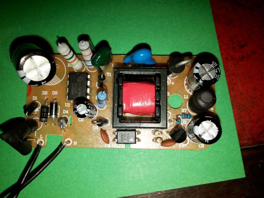

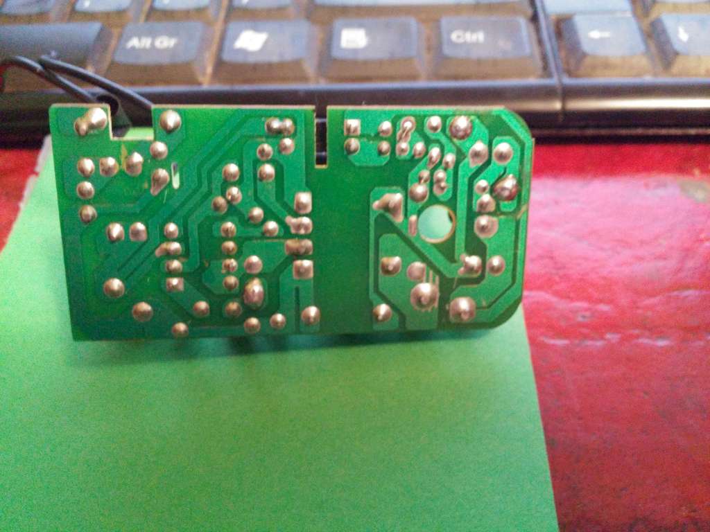

    i've got a faulty 5V 2A ac adaptor and was just looking for some pointers to identify the problem, sure I could buy another one for next to nothing but i'd rather try and fix it if only for the learning experience.
    Here are some pics:
    Output voltage was approx 5.3V but as soon as I connected a load (only had a 6 Ohm 50W resistor to hand) the voltage dropped to 1V even though the load current at that resistance is less than half what it should be capable of.
    Given the complex PSUs some of you work on no doubt this is childsplay for many so please be nice!
    cheers, Lee

    Probably bad caps causing the fault, do you have an esr meter to check the caps ?

      Unfortunately not only a Uni-T multi meter.
      Any recommendations for one? I see plenty of cheap ones on ebay but when I searched previously I recall people saying they were not 'true' ESR meters or something?

        Without an ESR meter, I'd start with replacing C2 then the output caps.

          change three caps (starting cap next to the PWM, and the 2 on the output) and be done with it.

                      i like that supply, it's simple and clean - even has a pi filter.
                      i would just replace the 3 low voltage caps with panasonic FR's and be happy.
                      i know it doesnt have an input choke or anything, but who cares - it's tiny.

                            So just for closure, I replaced all the caps and now it works again as it should.
                            I did order one of those ESR meters from ebay so once that gets here ill check the old caps just to see which one actually failed.

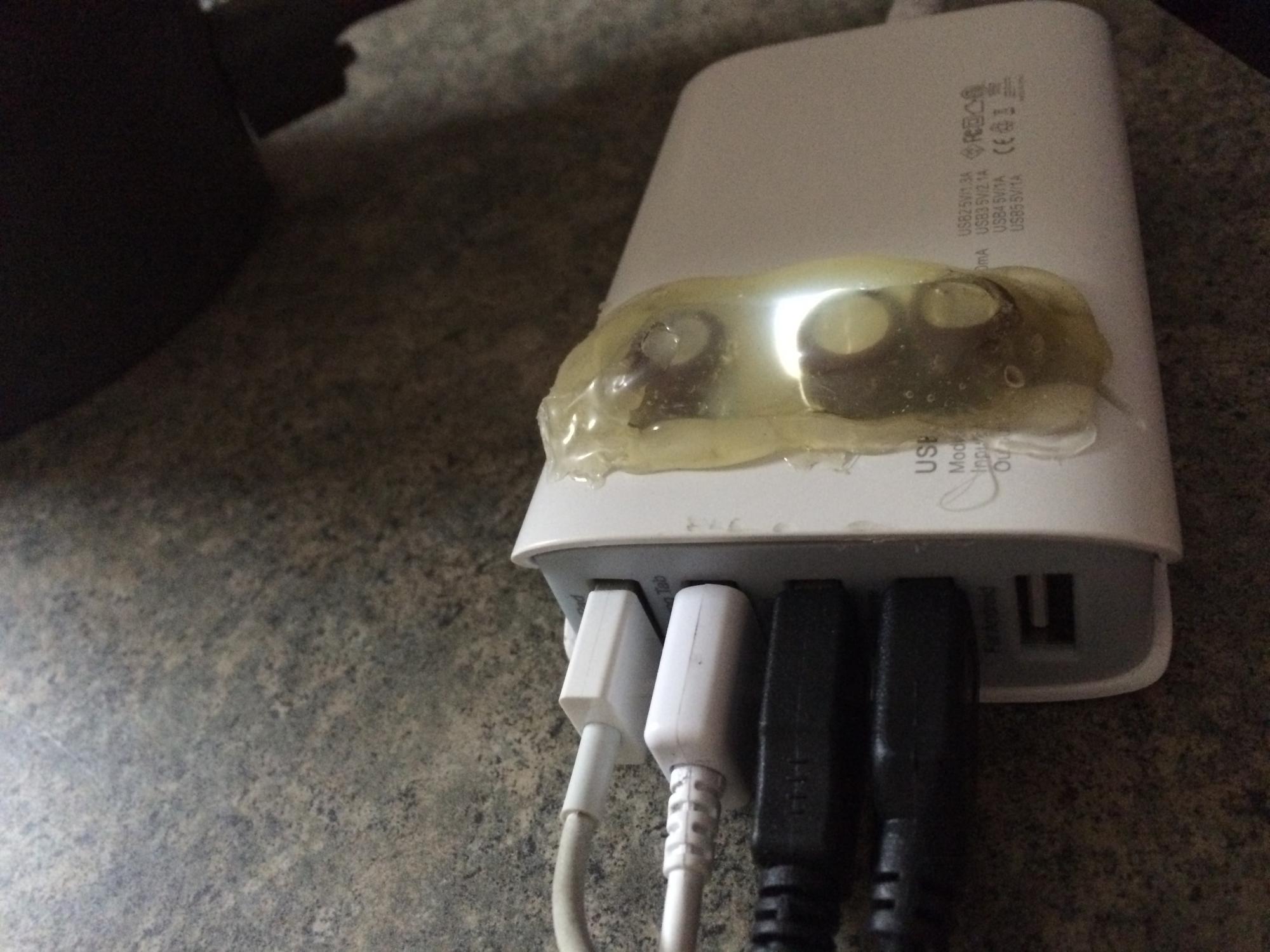

                                If I buy any switching power supply I change cap on site if they are NOT well know good brand name caps
                                This is a 5 volts @ 5 amp power supply
                                It had some green colored sleeve that had printed " Low ESR " on them no brand name
                                I know this a hack job how ever it had 2200uf@10 volt caps were 12mm Dia and 17mm tall
                                It end up with a 10mm Dia and 30mm tall
                                It had three of them and one that was 1000uf@10 Volts 8mm Dia and 15mm tall it end with a 8mm Dia and 20mm tall
                                I could NOT find any with that size at Digikey I look for some time so I did a hack job on the case
                                I would use KY,KME,FC or FR

                                    ESR meter arrived today, one of the 470uF caps had a value of 117uF and ESR of 39Ω
