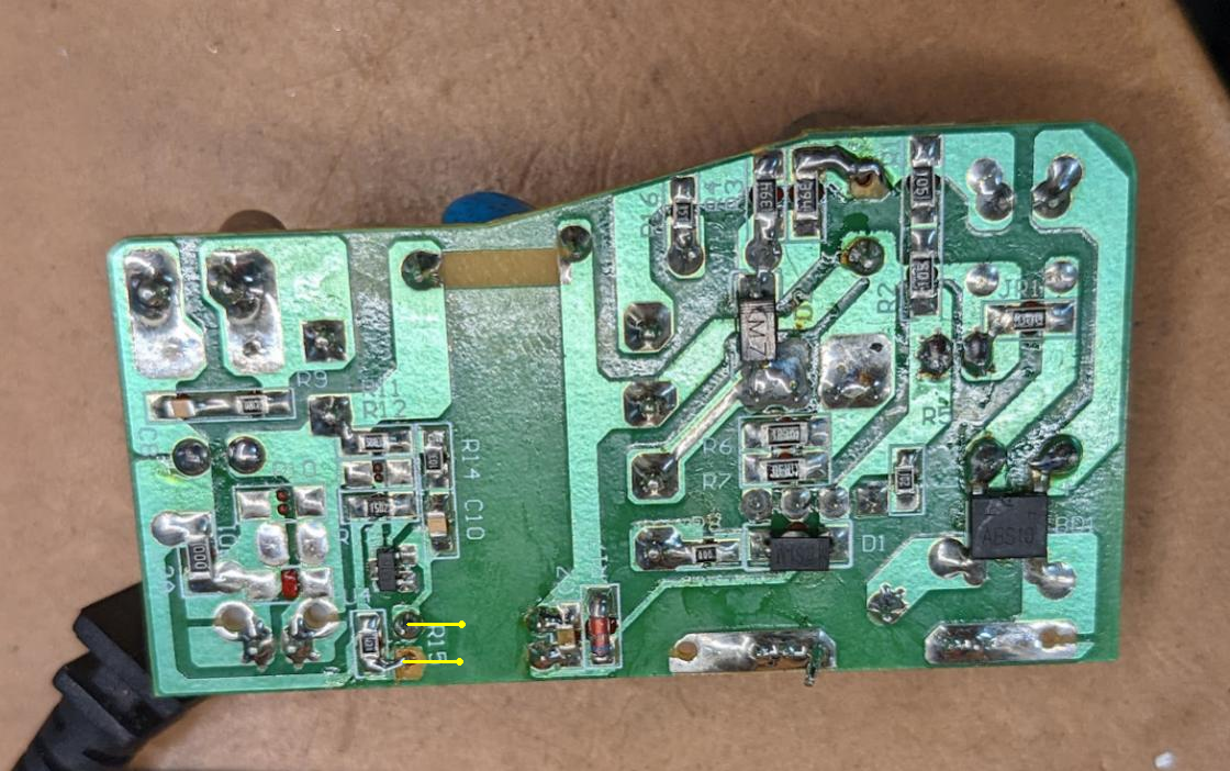

9v super basic wall wart issue
  • jayjr1105
    • 281
    This is one of those worthless and time wasting repairs but it's bugging me and I want to figure it out. Simple 9v 1a SMPS wall wart and it's bouncing between 8.2 and 9.4v without load. I've pulled out every single cap and all tested fine. I've replaced the opto and same exact issue. All diodes are testing fine. I'm not sure if the IC can cause this or if the IC had issues you wouldn't get anything at all on output.

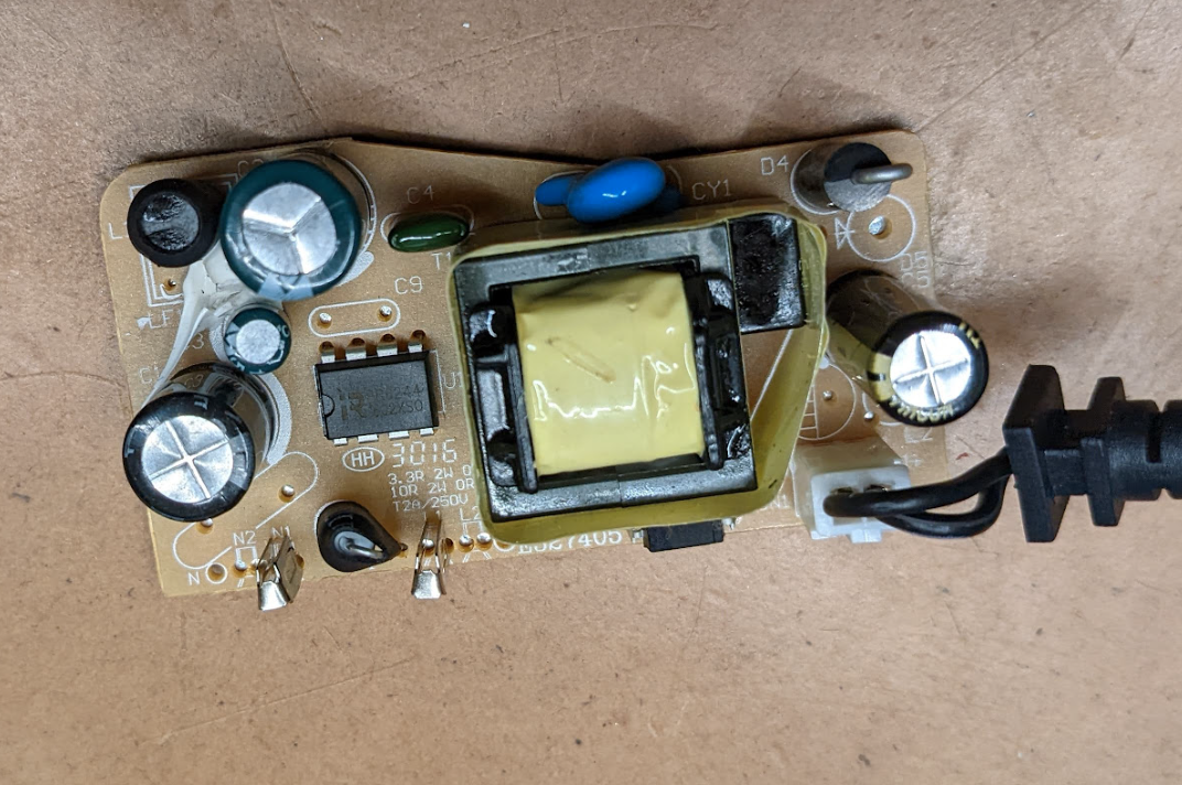

        Re: 9v super basic wall wart issue
        Replace that small electrolytic C3
        • CapLeaker
          Leaking Member
          • Dec 2014
          • 8351
          Look if C3 has something to with the feedback and change it.

              The 431 may be hunting.
              Try a 150-1k resistor across the IR LED in the opto.
              Points are marked in attached image.
              Change the small cap on pri side to 22u/50v or 47u/50v.
                I pulled all caps one by one and they all checked out. I can replace it anyway but don't know what good it will do

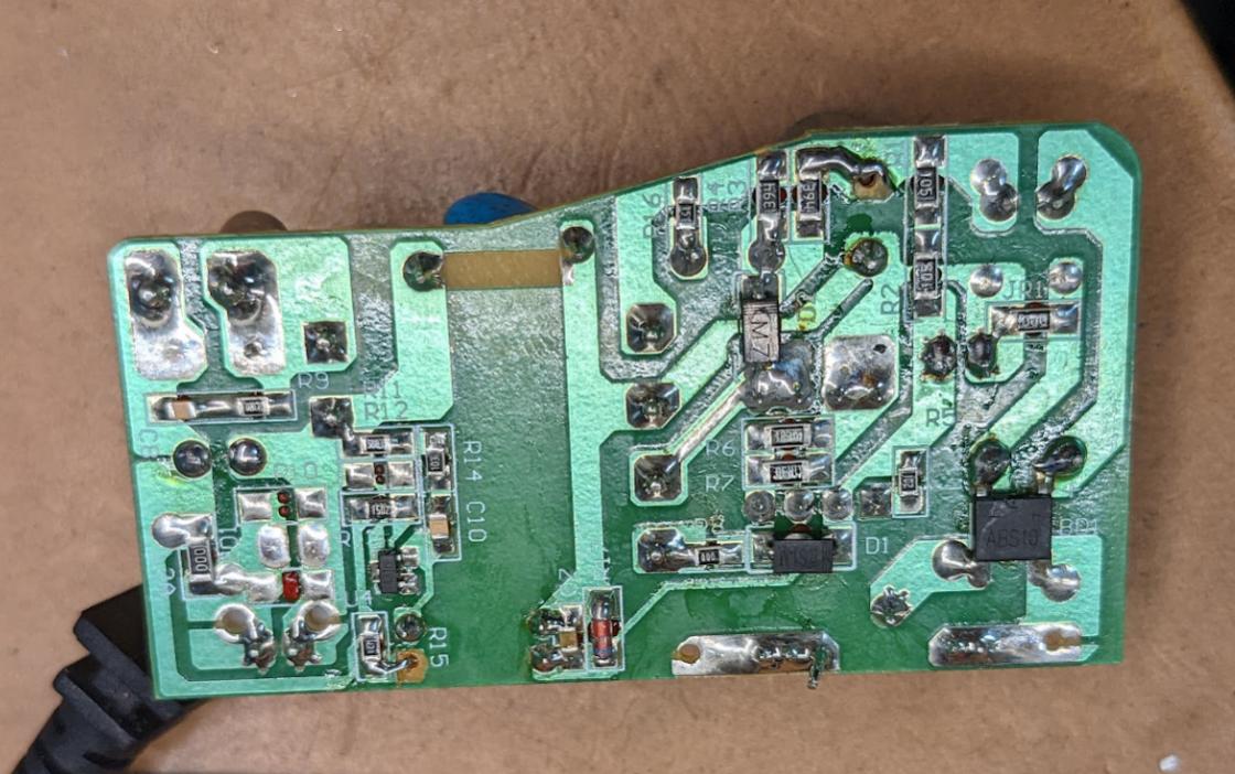

                  9.21v stable. How do I know which one fixed it? Replacing C3 or adding a 330ohm resistor to the opto?
                  Ok, pulled the resistor off and it's still good. Pulled C3 which was a 10uf 50v cap and replaced with a Panasonic FC 47uf 50v.
                    Soldering heat from R&R'ing C3 may have temporarily "woken" it up.
                    The 431 seems to need a minimum load; when an unbypassed opto LED is the sole source of current to the 431, the latter can hunt.
                    Leading to voltage "bounce" at no load.
                    Perhaps it was C3.
                    With the original C3 in place, leave it out in the cold a while- it'll probably act up afterwards= cap(s) is/were suspect.
                    In similar SMPS wall warts, I've used 22-47u/50v caps, PW/HE/FC, for C3.
                    If a new C3 keeps it stable, even cold, you can probably leave the opto LED unbypassed.

                        BTW, got home and still tested very stable around 9.2v.
                          glad you got it fixed! I ran into a similar issue before on a different power supply where it only supplied half of the voltage.
