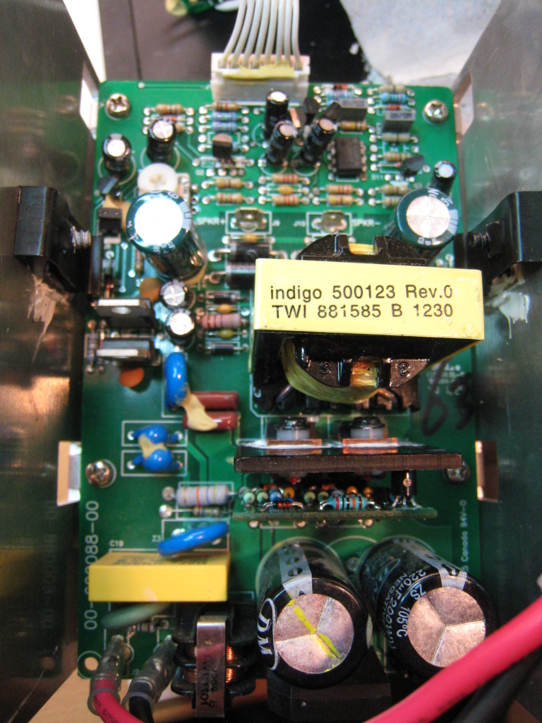

    Hello everybody,
    I have an issue on my Focal Cub 3 subwoofer unit : it stays desperately off.
    The main fuse and the 2 MOSFET's are not blown.
    Here is a picture of the main psu board :

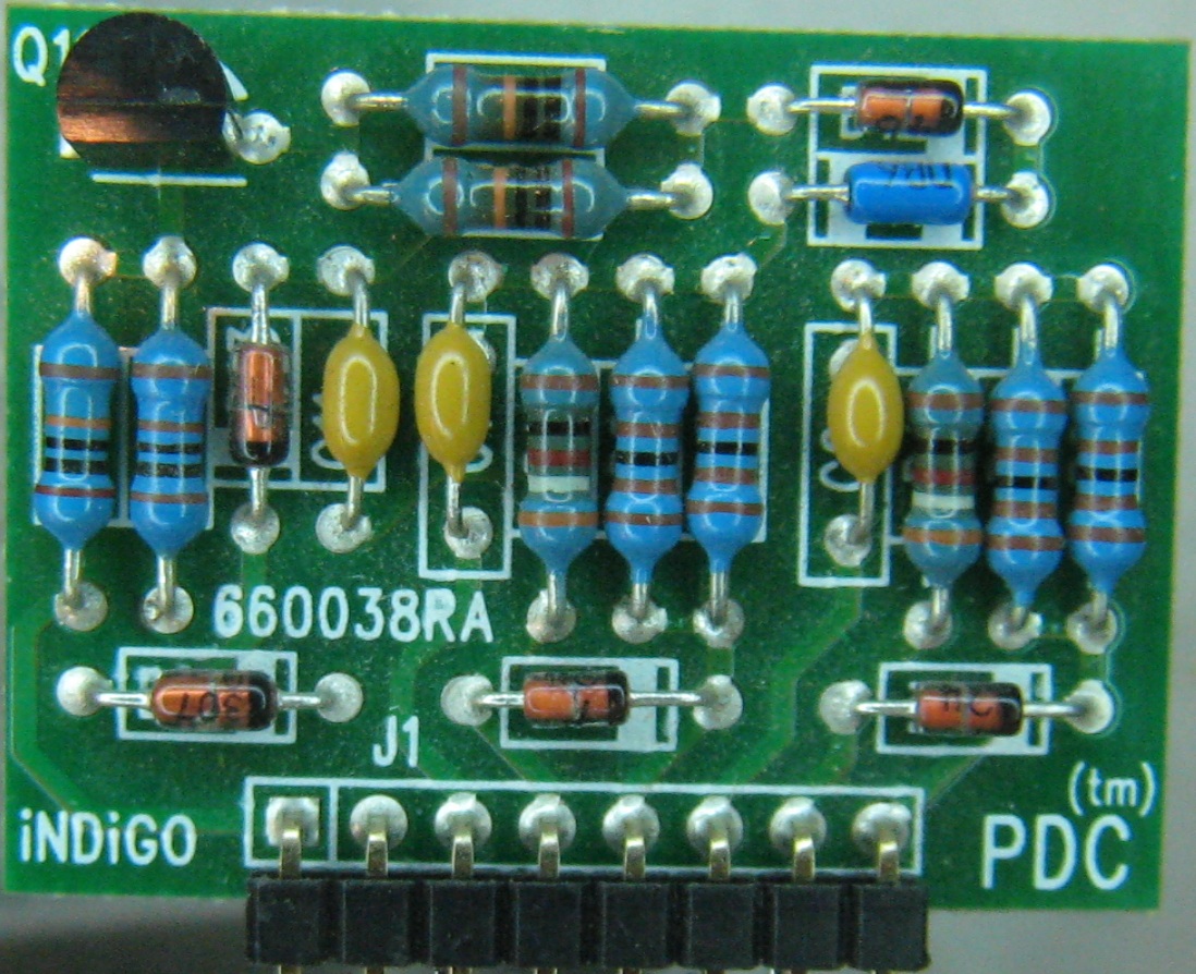

    As you can see on the picture, the 2 MOSFET's are driven by a tiny pcb board vertically soldered on the main pcb board "INDIGO 660038RA".
    From left to right, the pin 5 and 8 are connected to the gates of the MOSFET's.
    As I saw weird colors on the resistors, I changed all the resistors, all the diodes and all the capacitors on the tiny pcb board. The DB6 diac (hard to find !) and the MPSA92 transistor are the only survivors...
    I even replaced the 2 MOSFET's with IRF740 (IRF730 originally)...
    After replacing all that components, the voltages on the pin of the board are still the same...
    From left to right :

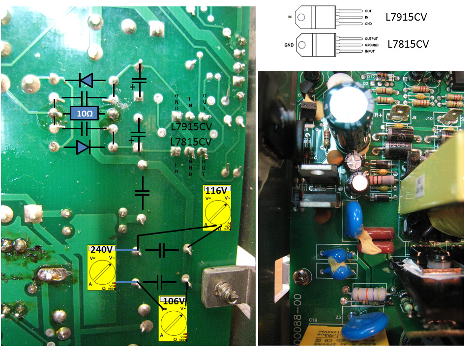

    Now, I'm wondering what is the purpose of an area of the main pcb : the 240V is directly connected thru 2 (X1 Y1) capacitors to the secondary. I guess this is a "step down circuit"... The value of the 2 capacitors is 100pF. I don't know which voltage I should have after this two capacitors... and I don't know what should be my reference point for measurement. Currently I have 0V between the GND and the OUT pins of both L79(78)15CV regulators.
    I regret not to have done some measurements on the regulators the only day it worked...
    Here are the top view and the bottom view of this part.
    According to you what should I measure in the different areas of this part ?
    Would it be interesting to change the X1, Y1 capacitors ?
    It is hard to me to understand the whole operation of this unit...
    Any help will be appreciated.

            'Would it be interesting to change the X1, Y1 capacitors ?' The circuit does not need X/Y caps to function.

                    Those two blue caps are safety cap, nothing to do with operation of the unit, they can be removed and the unit should still function.

                      We need straight shot and well focused pictures of the whole bottom side and top side of the board to see how the circuits are wired up.

                          Looks like the super-primitive self oscillating half bridge design often used in halogen lamp PSU.
                          No regulation, very little protection.
                          There is no electrolytic "start up capacitor" so stop looking for that. Check all of the high value resistors on the primary side, these can fail open. The Diac might be faulty too. Also some of the zener diodes on that vertical board might be bad if the FETs ever have failed.

                            About the diac ; someone told me to check the diac as follows : I need to quickly short-circuit the diac (< 0.5 second) : if the supply starts... the diac is failing.
                            What do you think about that method ?
                            Thanks again !
                            • robert
                              • Jan 2008
                              • 69
                              Re: Focal Cub 3 won't start
                              Shorting the Diac: yes, should work, just do it quickly. And carefully, its at mains potential after all...

                                And the winner is... the DIAC !!! After quickly shorting the diac... the unit powers on !!
                                Now I'm waiting for my DIAC DB6 order... 1 month...
                                I still don't understand how the circuit works... Do you think it has something related to this ?
                                What about the "protection circuit" with X1, Y1 capacitors ? What use is it ?
                                Thank you very much for your help !
                                  X1, Y1 are safety caps, not need to function, they are used for line noise filter to pass compliance test.
