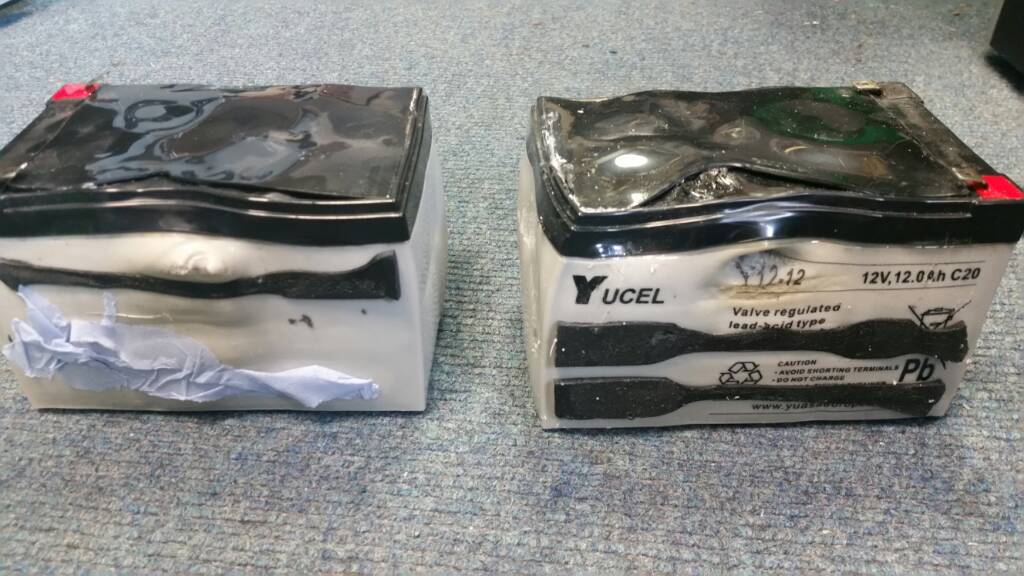

    Having recently seen a photo of a UPS that used cheap UPS batteries with them both melted inside, personally i would only use decent batteries.

                        These are three years old and came out of a smart UPS 1000.
                        To echo stj, not all batteries are the same.

                          you will have to replace both.even if the "good" one is usable it wont for long.
                          worse is its float current will be different than the new one and 1 will get overcharged.
                          order another and try to get it from the same lot as the first.

                            was that a cell failure or a runaway charger?
                            hopefully you checked the float at the batteries rather than powerchute!
