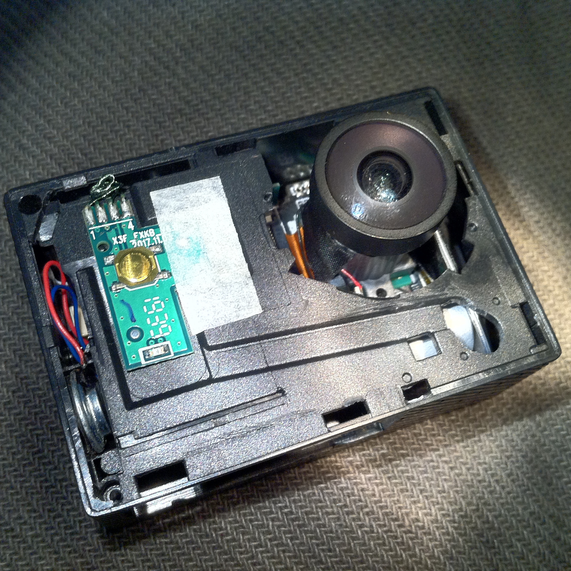

    I have a cheap action camera with an annoying trait, every time I change batteries the date & time gets reset and I have to set it again.
    To solve this problem I want to add a small internal battery inside it which will keep supplying power to the camera for a while while I change batteries so the date & time is retained.
    I have opened the camera and I think there is enough room to add something inside to accomplish this:

    The camera is powered by a 3.7V nominal single cell lithium ion battery.
    So I need to connect another battery in parallel to ground and battery + on the PCB.
    What battery, or perhaps capacitor should I use?
    I have on hand such capacitor visible in my photos which will fit, 25V 220µF, would that work?
    And should I add a resistor in series with the capacitor to limit the inrush current charging the capacitor when plugging in the battery, if so what value resistor?

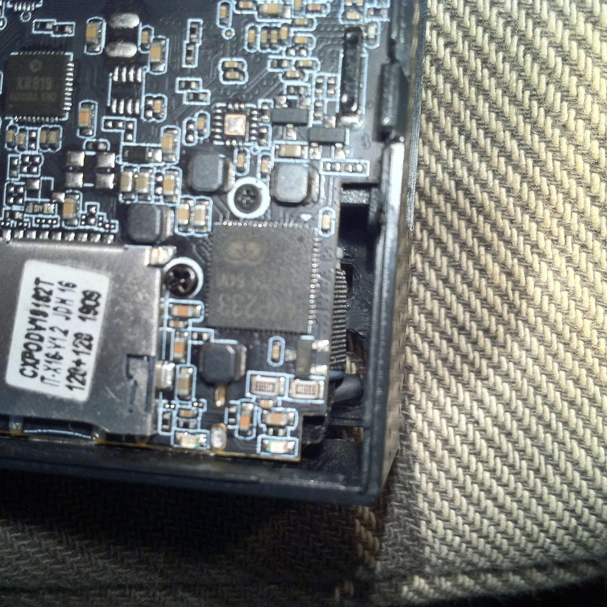

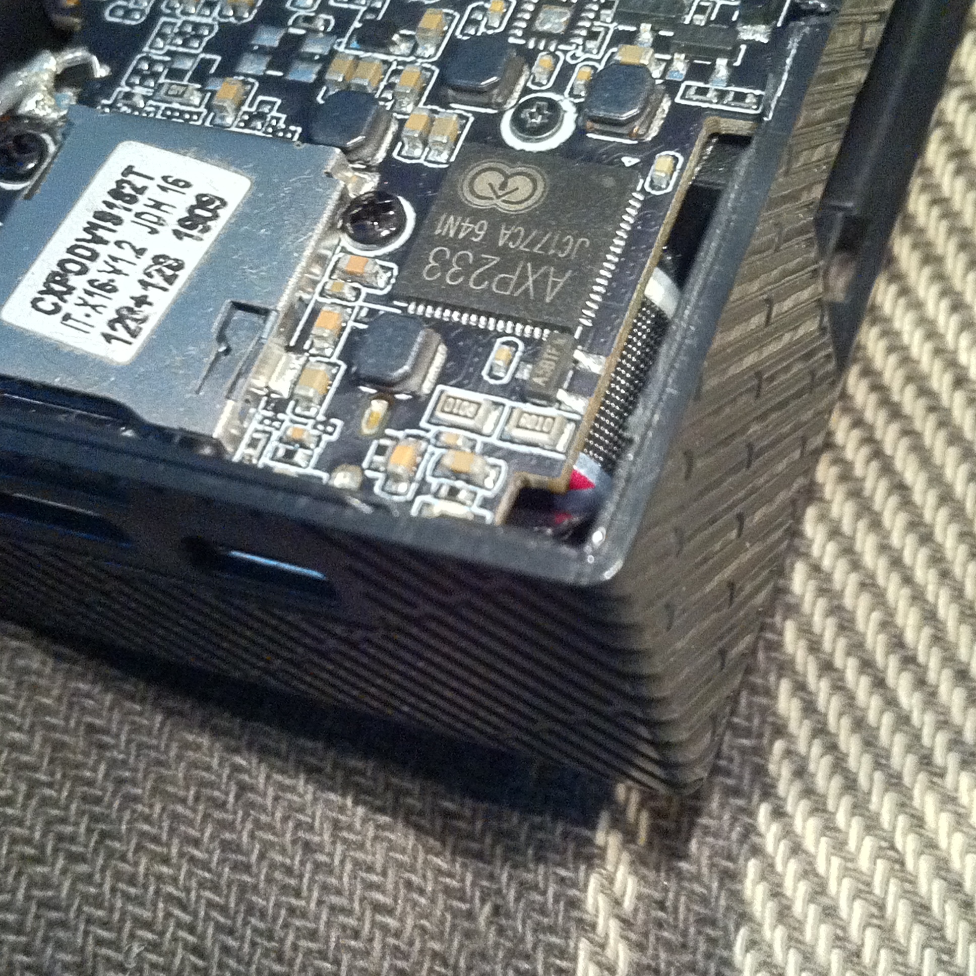

        Thanks guys for your suggestions,
        The component marked EAFC is the 32.768KHz oscillator, I think it's MC-146. one side is ground and the two pins on the other side are at 0.85V at standby,
ID:	3656268 Click image for larger version
ID:	3656269 Click image for larger version
ID:	3656270 Click image for larger version
        I didn't find continuity from it to any pin on chips XR819 or AXP233.
        On the other side of the board the chips B649SN and the covered one are BGA so can't test pins.
        In standby I found few places at 1.8V, maybe adding a cap there would keep the time? IDK... everything is extremely small so I think I will connect a capacitor to some place on the main battery rail,
        I found online 6.3V 2200µF10x12mm capacitor, looks like there's enough space to fit it so I want to try that.

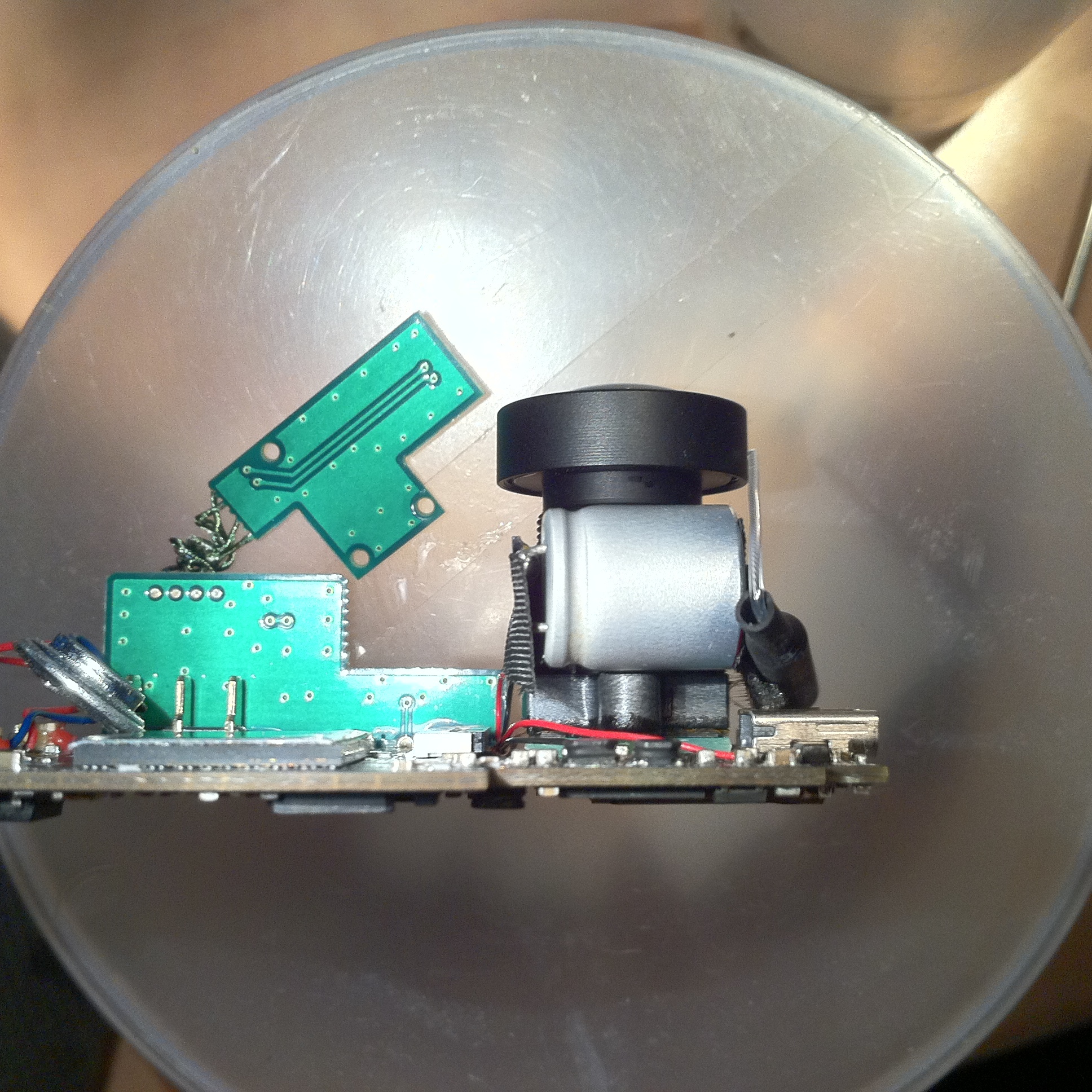

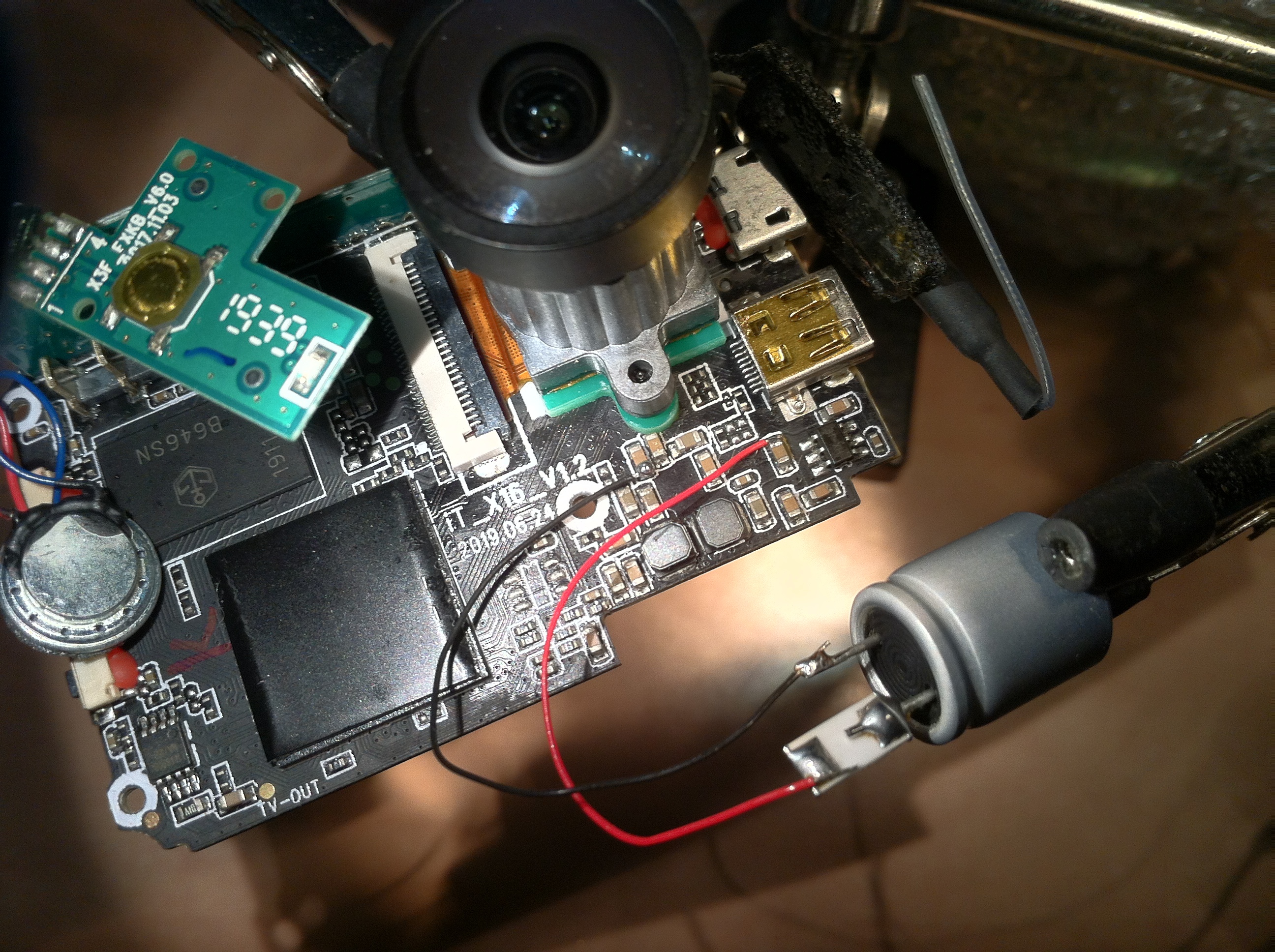

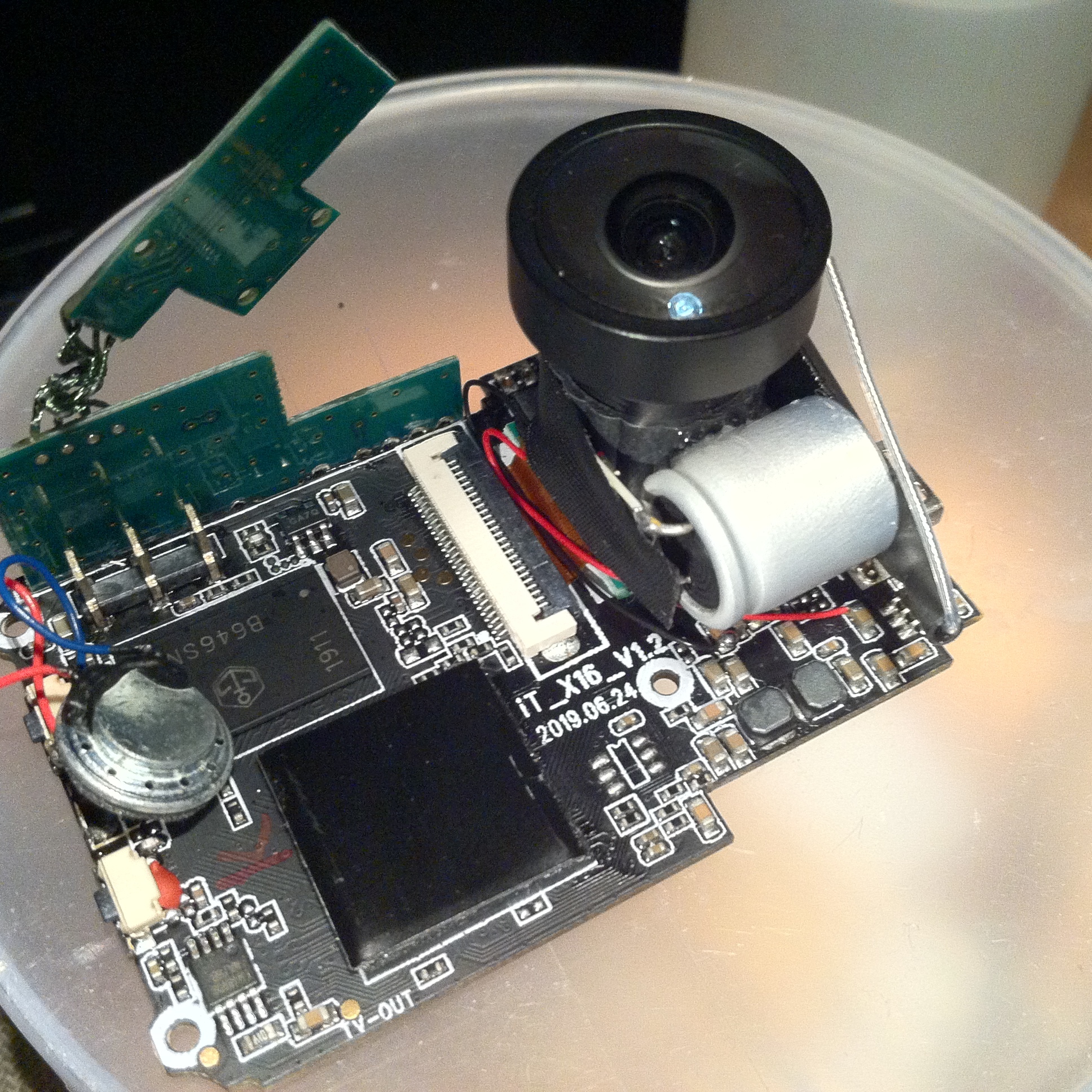

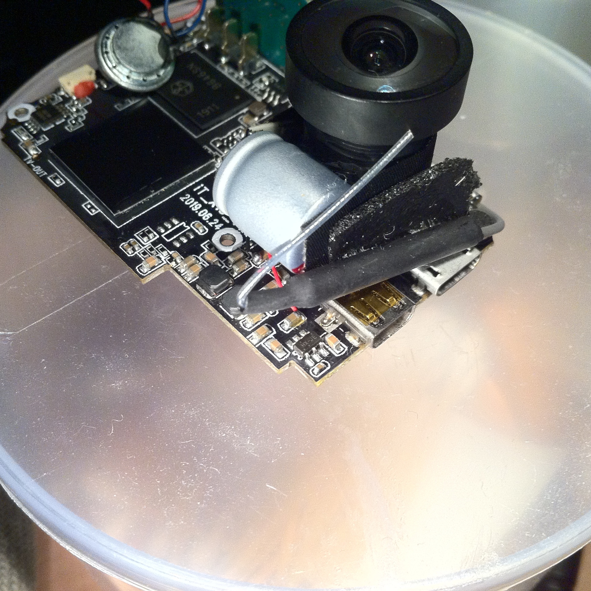

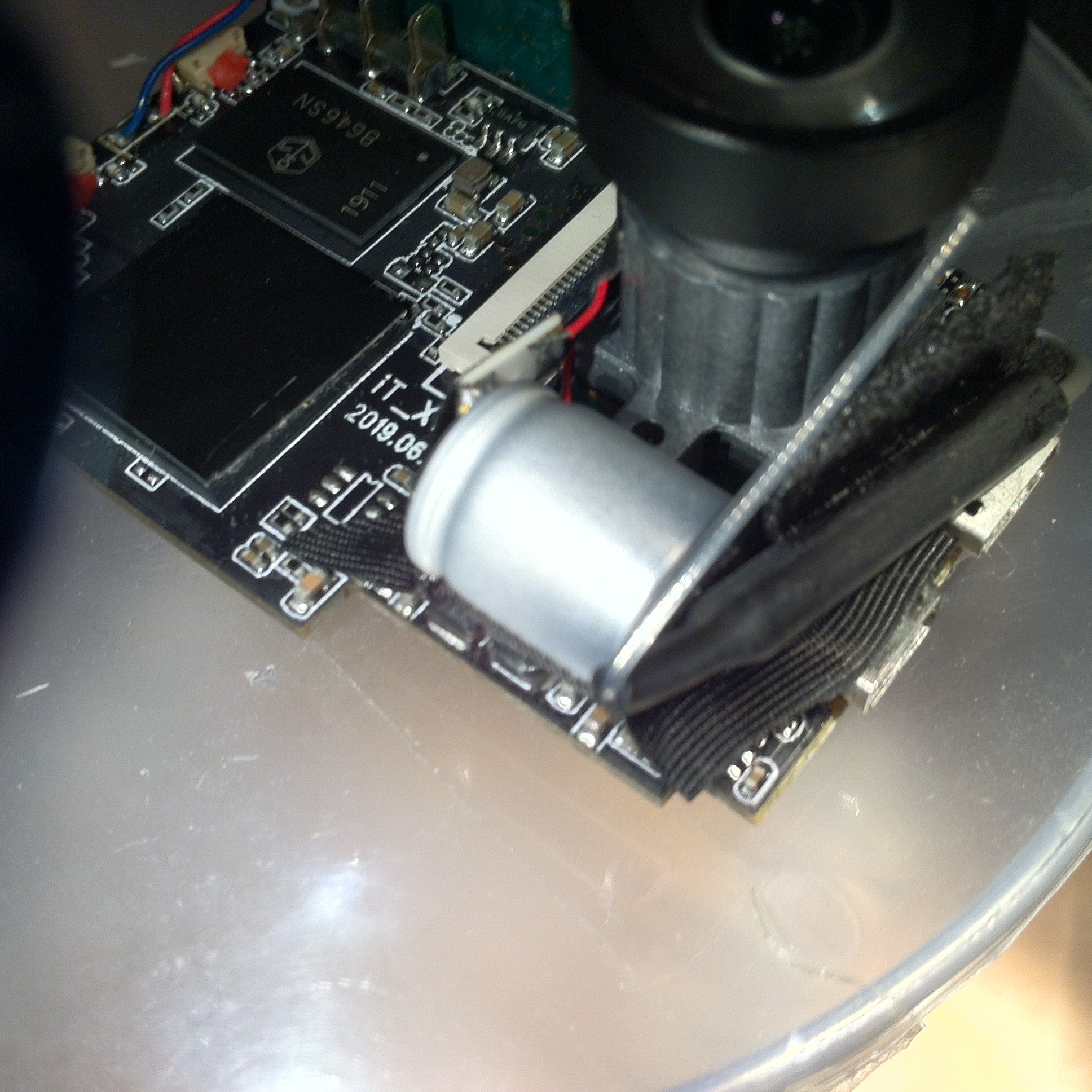

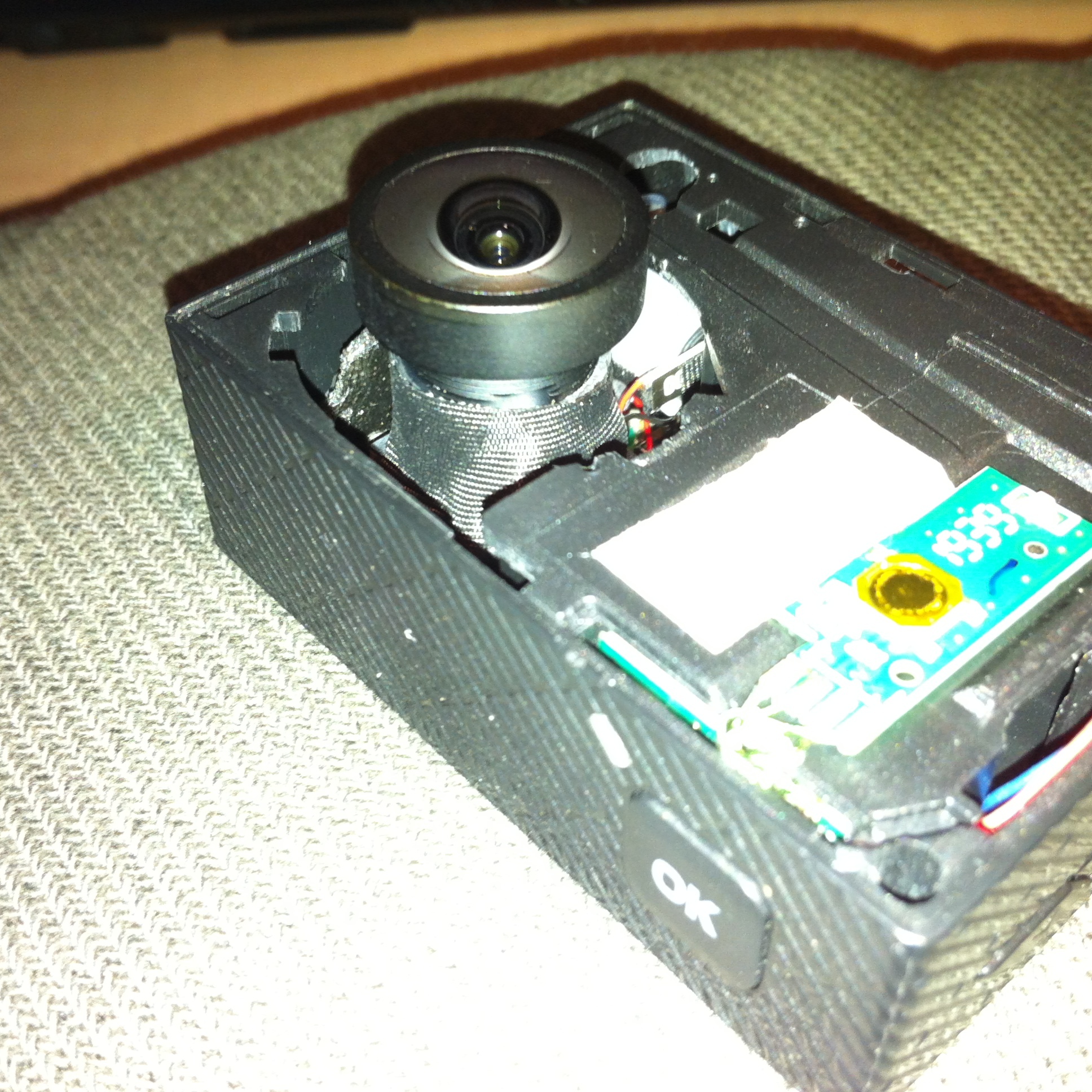

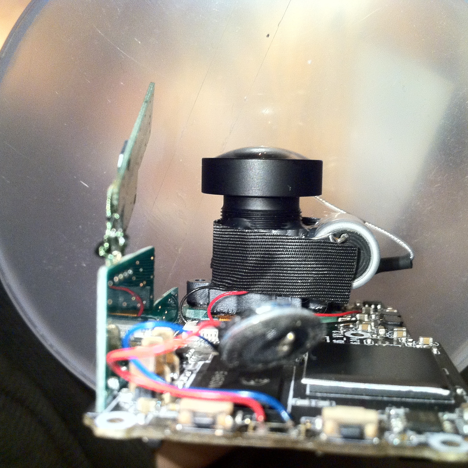

              Oh no all my photos in this thread have been lost.
              I added a 6.3V 2200µF10x12mm capacitor.
              I connected the capacitor to a ground and battery rail point I found on the camera's PCB, and added a 150ohm resistor I found in series with the capacitor to limit inrush current when plugging in the battery:
              Click image for larger version  Name:	IMG_3495.jpg Views:	0 Size:	1.89 MB ID:	3679037

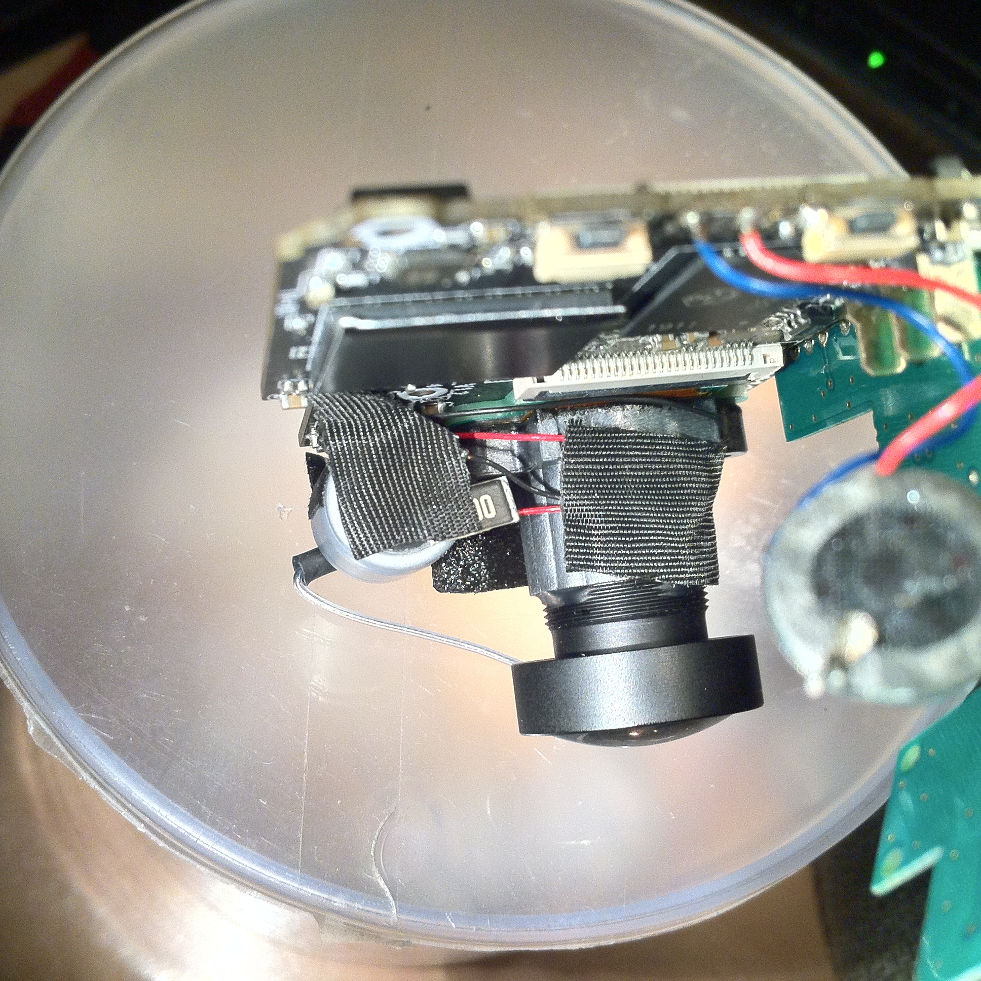

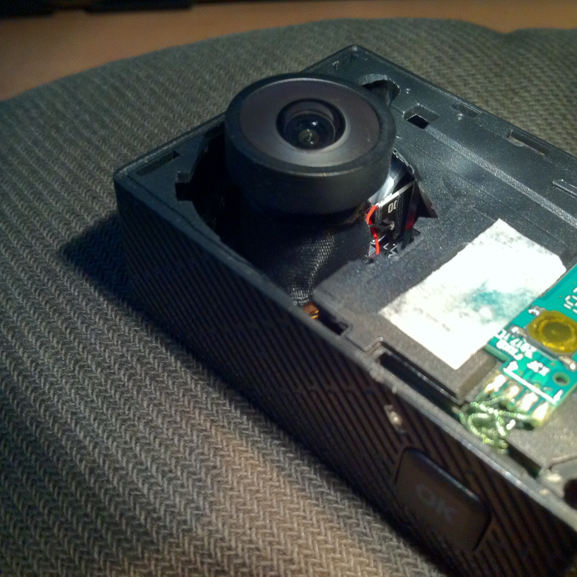

              First I taped and glued the capacitor to the lens housing but the cap was too high so the case didn't fit:
              Click image for larger version  Name:	IMG_3496.jpg Views:	0 Size:	1.56 MB ID:	3679022 Click image for larger version  Name:	IMG_3497.jpg Views:	0 Size:	1.57 MB ID:	3679029 Click image for larger version  Name:	IMG_3498.jpg Views:	0 Size:	1.34 MB ID:	3679028 Click image for larger version  Name:	IMG_3499.jpg Views:	0 Size:	1.70 MB ID:	3679033

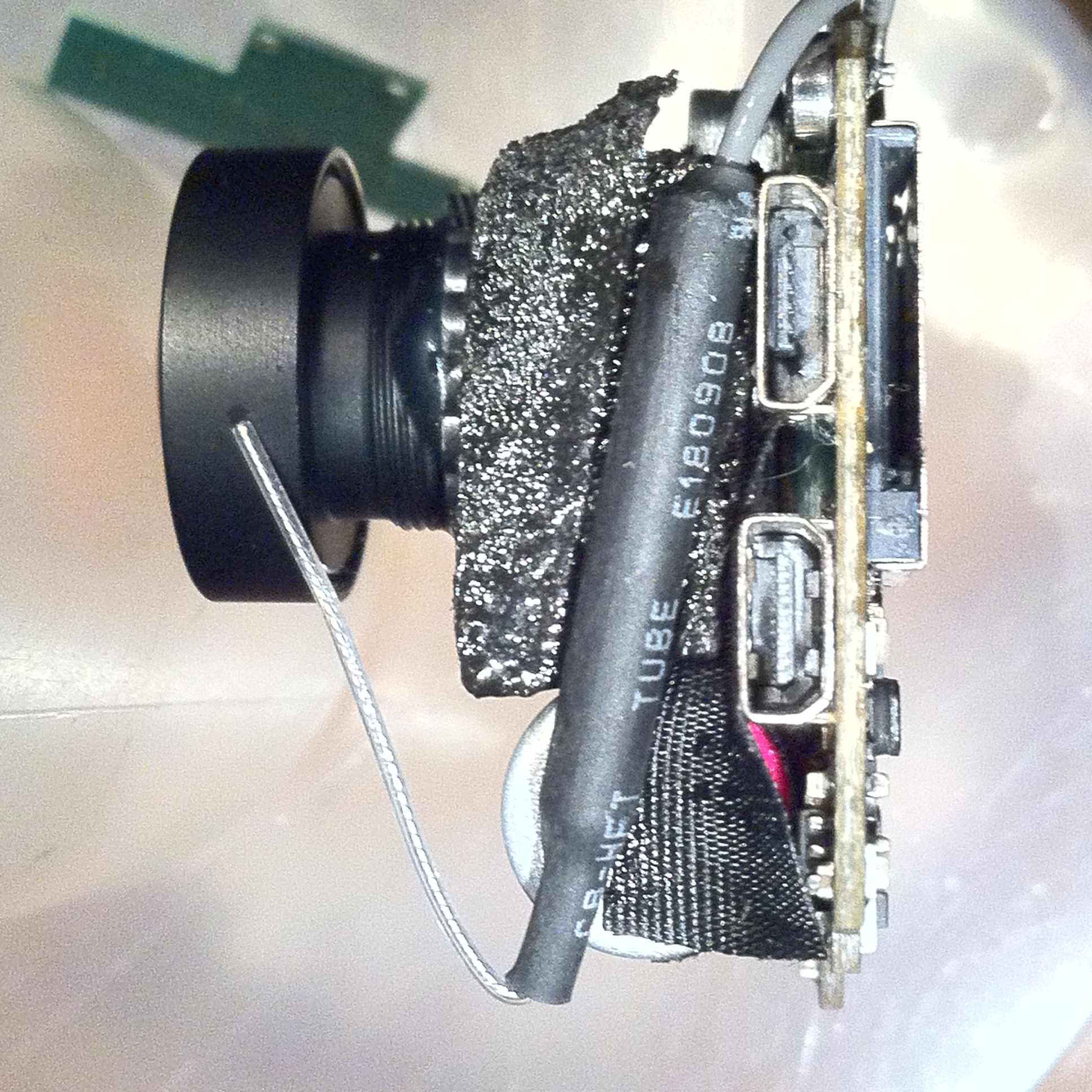

              Then I moved the capacitor and attached it lower, right on the PCB:
              Click image for larger version  Name:	IMG_3500.jpg Views:	0 Size:	1.51 MB ID:	3679023 Click image for larger version  Name:	IMG_3501.jpg Views:	0 Size:	1.27 MB ID:	3679026 Click image for larger version  Name:	IMG_3502.jpg Views:	0 Size:	1.62 MB ID:	3679027 Click image for larger version  Name:	IMG_3503.jpg Views:	0 Size:	1.22 MB ID:	3679024

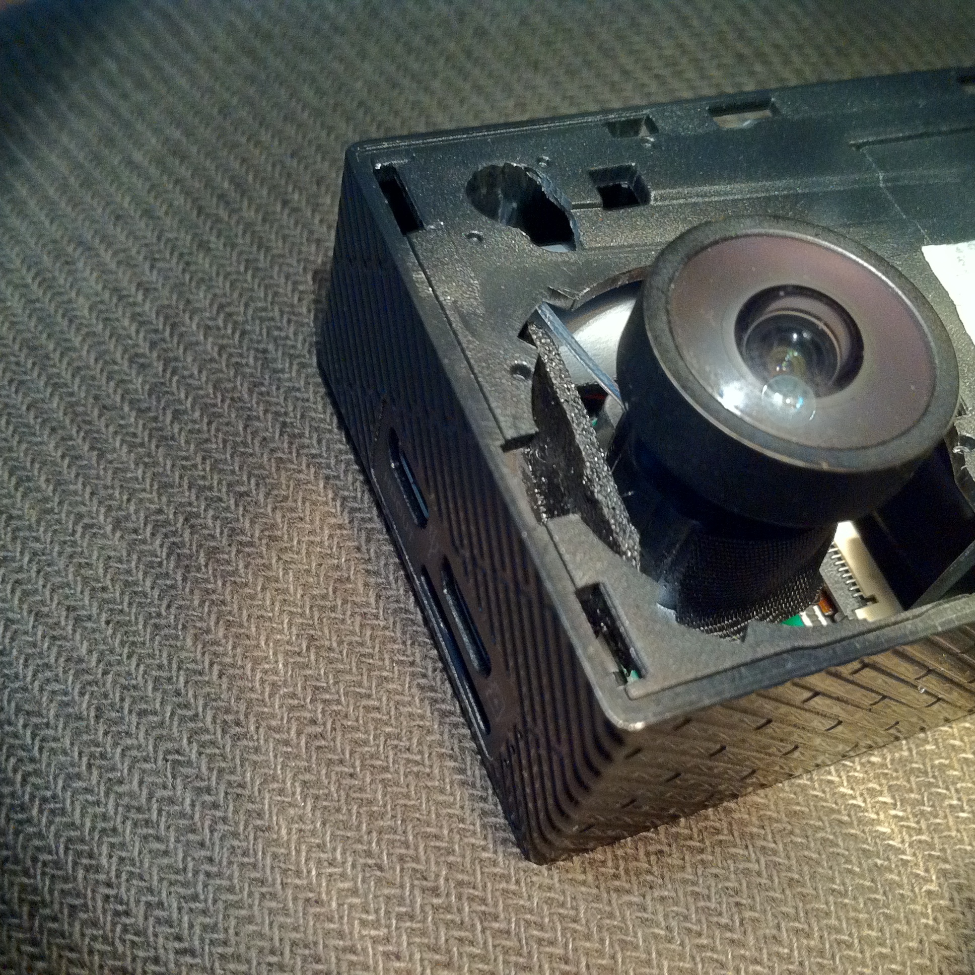

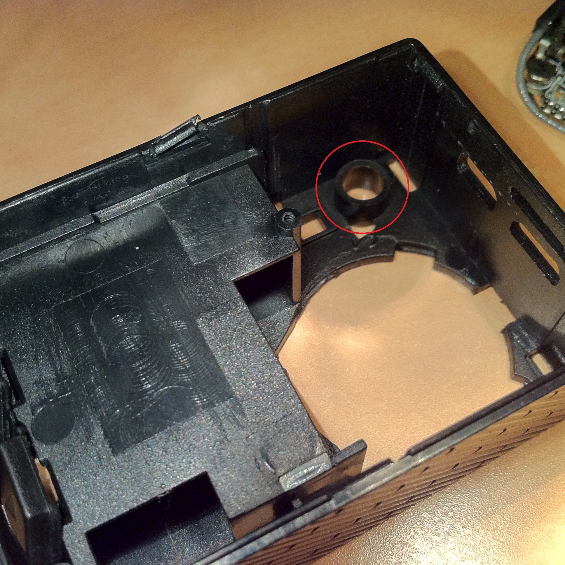

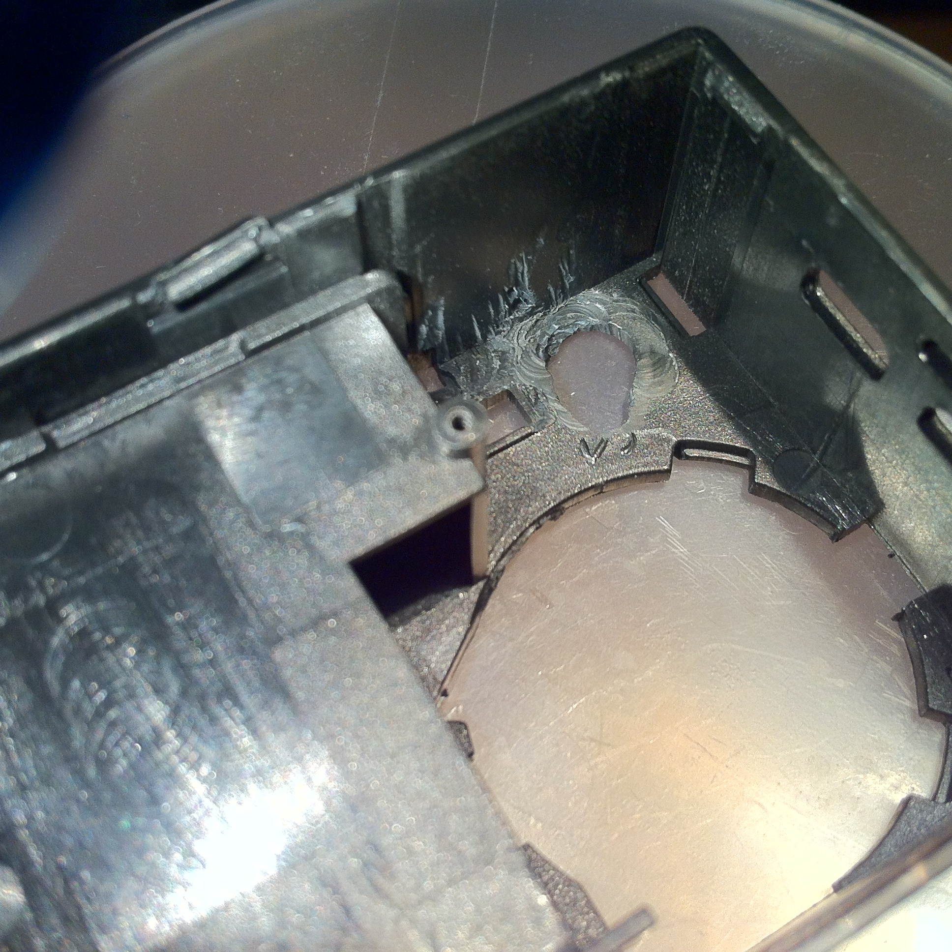

              But there was one protruding feature on the camera housing that was still interfering with the capacitor:
              Click image for larger version  Name:	IMG_3504.jpg Views:	0 Size:	1.35 MB ID:	3679038

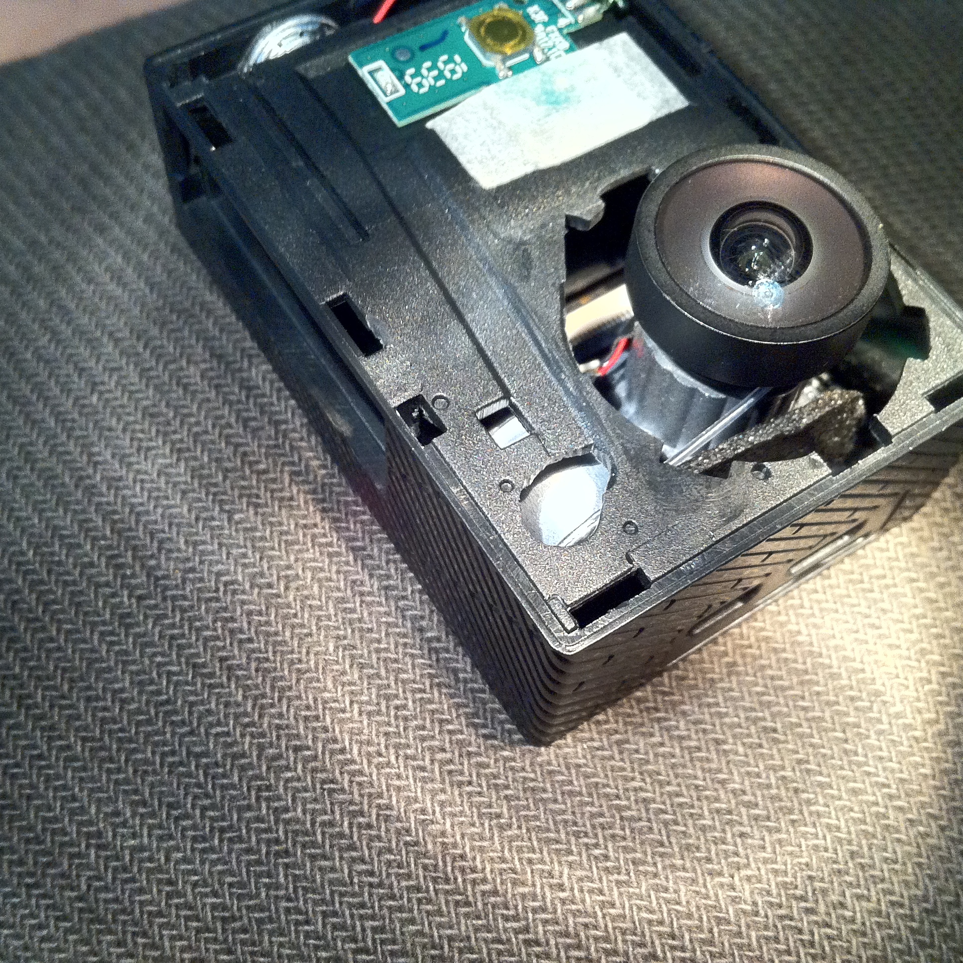

              So I ground the plastic away:
              Click image for larger version  Name:	IMG_3505.jpg Views:	0 Size:	1.42 MB ID:	3679025
              After that it fits:
              Click image for larger version  Name:	IMG_3506.jpg Views:	0 Size:	1.81 MB ID:	3679032 Click image for larger version  Name:	IMG_3507.jpg Views:	0 Size:	1.95 MB ID:	3679035 Click image for larger version  Name:	IMG_3508.jpg Views:	0 Size:	1.15 MB ID:	3679021 Click image for larger version  Name:	IMG_3510.jpg Views:	0 Size:	1.39 MB ID:	3679030 Click image for larger version  Name:	IMG_3511.jpg Views:	0 Size:	1.63 MB ID:	3679036 Click image for larger version  Name:	IMG_3512.jpg Views:	0 Size:	1.72 MB ID:	3679034 Click image for larger version  Name:	IMG_3513.jpg Views:	0 Size:	1.36 MB ID:	3679031
              I tested it and after changing battery the time is retained now.
