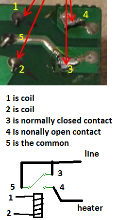

        Re: Sonach drinking water heater not working
        here is a picture of the back of the board
        also note: i measured the resistance between pins 1-2 and 3-4.
        Pins-1-2: is ~ 400 ohms
        Pins-3-4: is open
        pins 3-4 are where the "power" comes in.......my guess is the output of the relay is on pins 1-2. If this is a relay "noramally open" should i be measuring 400ohms on pins 1-2 when no power is connected to the board?
        is this relay bad? if so what replacement should i get?

                It will read that, as those are for the internal coil. Likely the relay is faulty, they often fail and are cheap and easy to get as spares. The relay will be either a 12V or a 24V unit, likely a 12V one and the mains transformer will be a 9VAC unit.
                Check the heaters and the thermal fuse in the lead to the heater as those are also failure prone. If the heater you need to get a new one from the agents, but the relay and the thermal fuse are common parts.
                  Pin 1 and 2 is the relay coil, DCR of 400 Ohms for 12VDC Coil is about right for this relay. pin 3 and 4 are for the N.O. (Normally Open) contact. I would check the heater core and it should also have have some kind of thermal cutoff switch for the heater for safety. Pictures of the whole unit? The Diode in parallell with relay coil is for snubber.
                        At this point, you can bypass the relay contact by putting the jumper between 3 and 4 but I will not do that until you verify that the heater, thermal cutoff are OK, if they are OK, then the heater should be hot when apply 120V to the unit.
                                      Try connecting a 9V battery to pins 1 and 2 of the relay and see if it makes a clicking sound. If the relay does click, try measuring resistance between pins 3 and 4 while the battery is still connected to pins 1 and 2. The resistance between pins 3 and 4 should then be very low (under 3 Ohms, depending on how low your multimeter can measure).
                                      When you're doing this test with the 9V battery, put (+) of the battery on pin 2 and (-) on pin 1. Make sure that the diode you removed (D5?) is installed on the board before you do this, though, and make sure it is put back in the right way.
                                      If you do NOT get any clicks from the relay with the battery, either remove the relay out of the board and test again with the 9V battery or remove the small transistor (Q2) next to the relay.
                                      There's also a chance this may be a 24V relay. In which case, a 9V battery may not be good enough to test it. However, two 9V batteries in series should be.
                                      Also, the 0.5 ohm reading you got is right for the thermal cutoff switch (i.e. this thing). The 275 ohms reading is right for the heating element.
