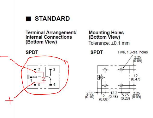

    Hello and happy new year ,
    my Analog Combustion Machine Honeywell gone bad and I don't know what type of diode is utilized.
    There is no mark around the body of the diode. The Schematics are general referred only, without any electronics components and values.

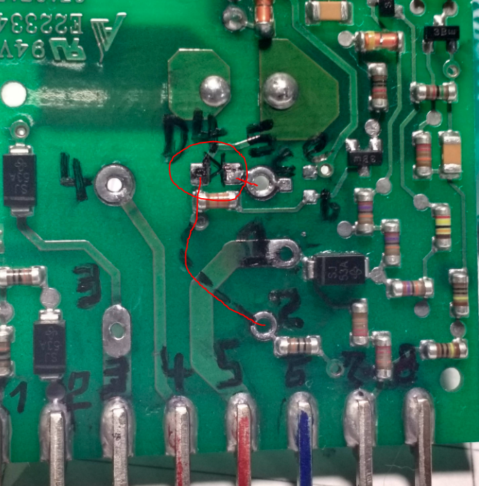

    The two contacts (2),(5) of the Relay Coil need 48 Volts DC to begin operating. Between these two contacts in series is the bad diode and near of contact (5) is the bad pnp (bc856b) Transistor that can be easily replaced.
    I have made a diagram of the PCB and some measurements along some points.
    Do you have any idea about what type of diode could be utilized ?

      Originally posted by lotas
      Usually a 1N4148 diode (150mA 100V) is installed in parallel with the relay coil.
      https://aliexpress.com/item/32802141687.html?
      Thank you for your answer Iotas, but here are in series not in parallel and that's why I can't really understand what type of diode need to replace..

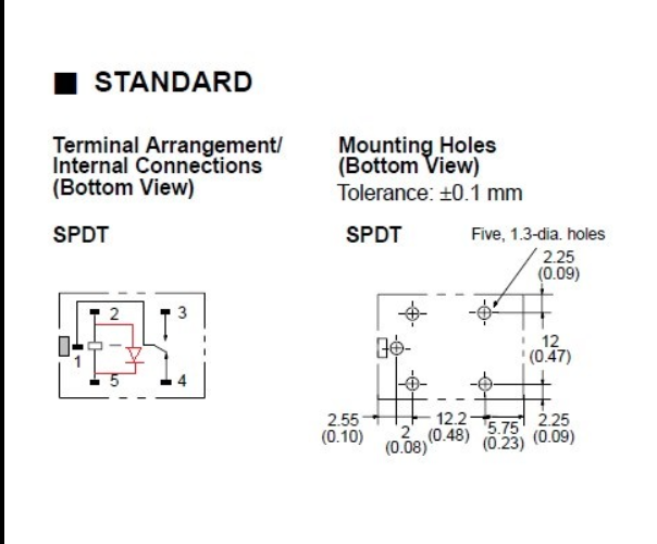

      • lotas
        • Jan 2016
        • 4602
        • Russia
        This is in parallel with the relay winding!

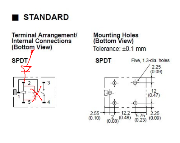

            Sorry for the previous draw it was wrong !
            Here the right one :

              Are you talking about this D4 diode?
              • InsertCoin
                • Apr 2021
                • 11
                • Hellas
                Yeap, that's the bad guy !
                • lotas
                  • Jan 2016
                  • 4602
                  • Russia
                  But it stands in parallel with the relay.

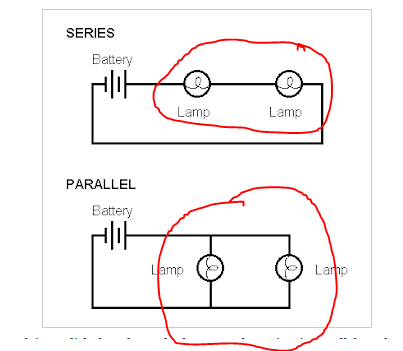

                    Why in paraller ? Between contact 2 and 5 (which is the 48Volt relay) is the bad diode and as far I can understand it is in series, because the one end starts from contact 2 and the other end (of diode) terminates on the contact 5. Is that wrong ?

                      This is parallel, not sequential, like in the photo.
                      • lotas
                        • Jan 2016
                        • 4602
                        • Russia
                        You need to understand what a parallel connection and a serial connection are.

                          Because the circuit is a bit difficult for my electronics level finding the voltage sources, and understand if the bad diode is in series or in parallel connection, do you believe a 1N4148 diode (150mA 100V) could make the job ?
                          • lotas
                            • Jan 2016
                            • 4602
                            • Russia
                            Yes. The main thing is not to confuse the anode with the cathode; it will burn out instantly.
