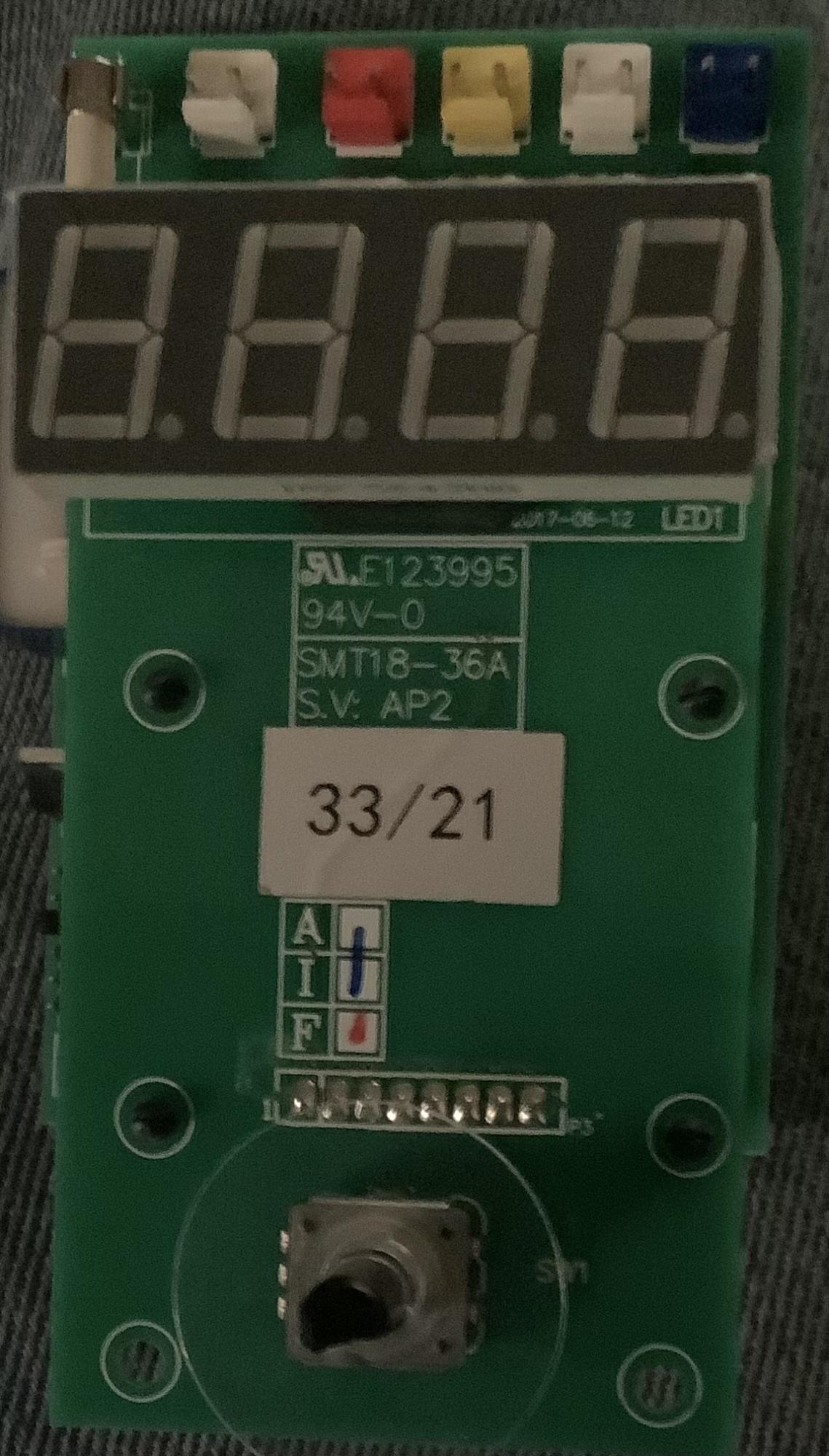

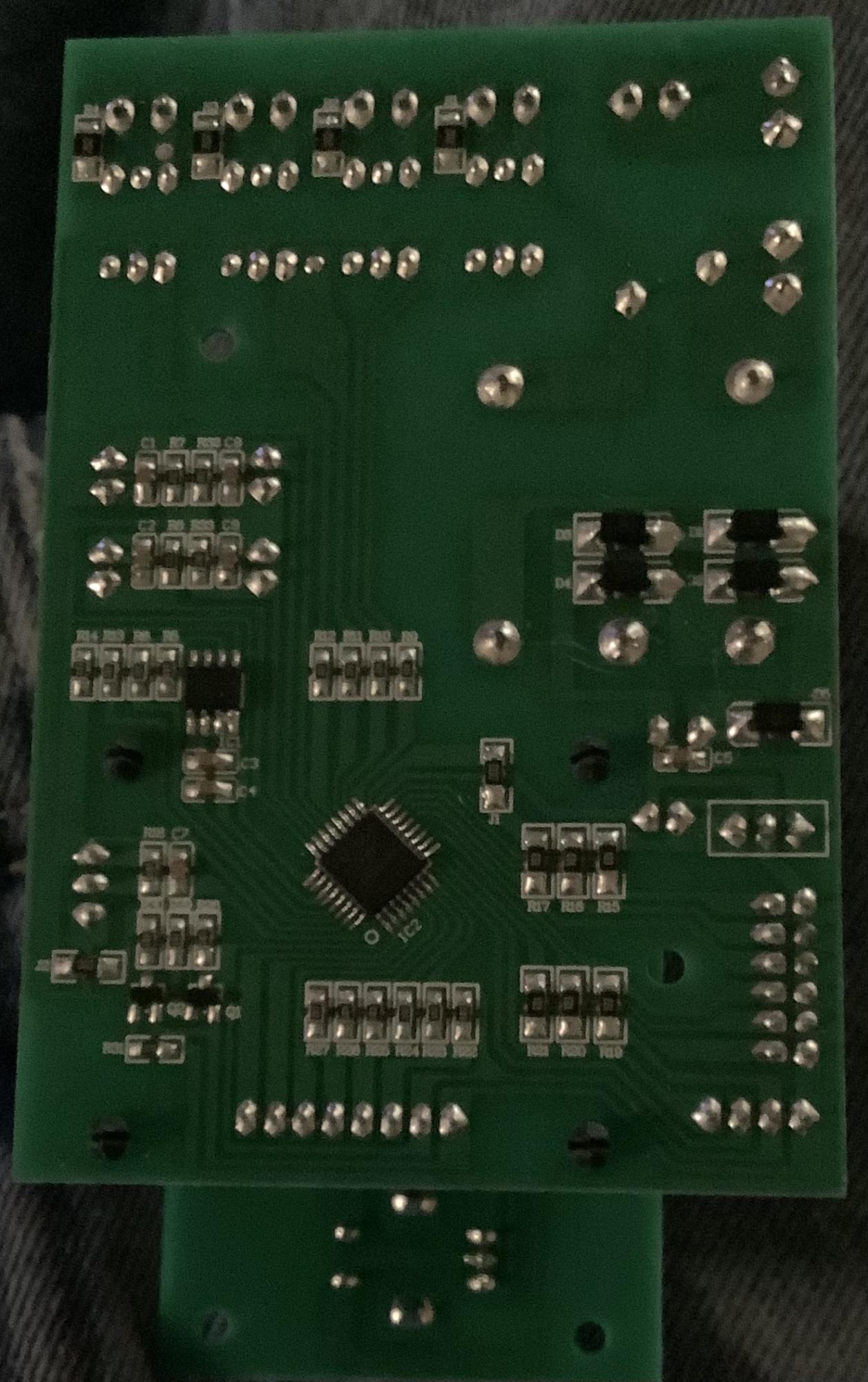

    I recently bought a used tankless hot water heater and the controller board is completely dead no power up when power is applied the display board works however the main controller board does not work correctly at all the fuse is good
    I bought a used replacement controller board that also had issues that I was able to fix and now the tankless water heater works correctly now
    However I would like to know if I could figure what happened to this controller board if possible
    Tomorrow I will take some better pictures of both side of both boards
    The transformer has resistance on the primary and secondary sides the rectifier diodes test good with a meter I have not checked with power connected to the controller board because I would have to make a jig to be able to check if I am getting secondary power from the transformer
    The power inputs are the white connector red wire ( L1 ) and a red connector the left pin which is black is
    ( L2 ) is the power pins for the controller board the right pin which yellow goes to the triac gate pin then other two pins on the triac go the power in and to the temperature limit switch and then to the heater element the other side of the goes to the other side of the power supply

    Re: Tankless hot water heater controller board not powering up when power is applied
    pictures are shit.
    but you have a microcontroller - so you have a voltage regulator.
    find it and check it's input and output pins

                        EcoSmart, Eemax, Rheem tankless hot water heater controller SMT18-36A
                        It's got jumpers to config the heater power kW. So that means no EEPROM I guess for special settings. This is proportional (phase) control using the triac? Or only ON/OFF? 4-pin connector is for the remote control.
                        You might have a difference in the flow sensors - the pulses per rev. but I can't see one ever giving a fault code because the impeller (magnet) stops on the Hall sensor or not. So the signal stuck high or low does not mean there is trouble. It's something else. The restrictors are at the shower head?
                        I would guess 4-wire sensor has flow plus a thermistor in it for incoming water temp possibly.

                        P.S> - it's been 10 months, when are we getting good pictures of the controller board that went dead lol

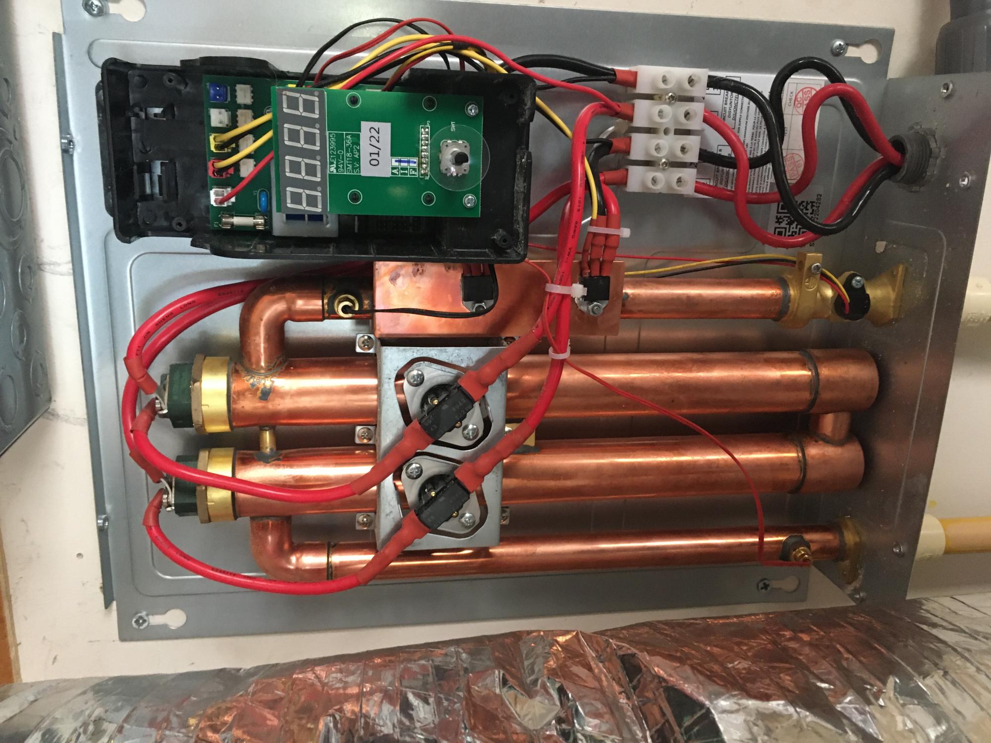

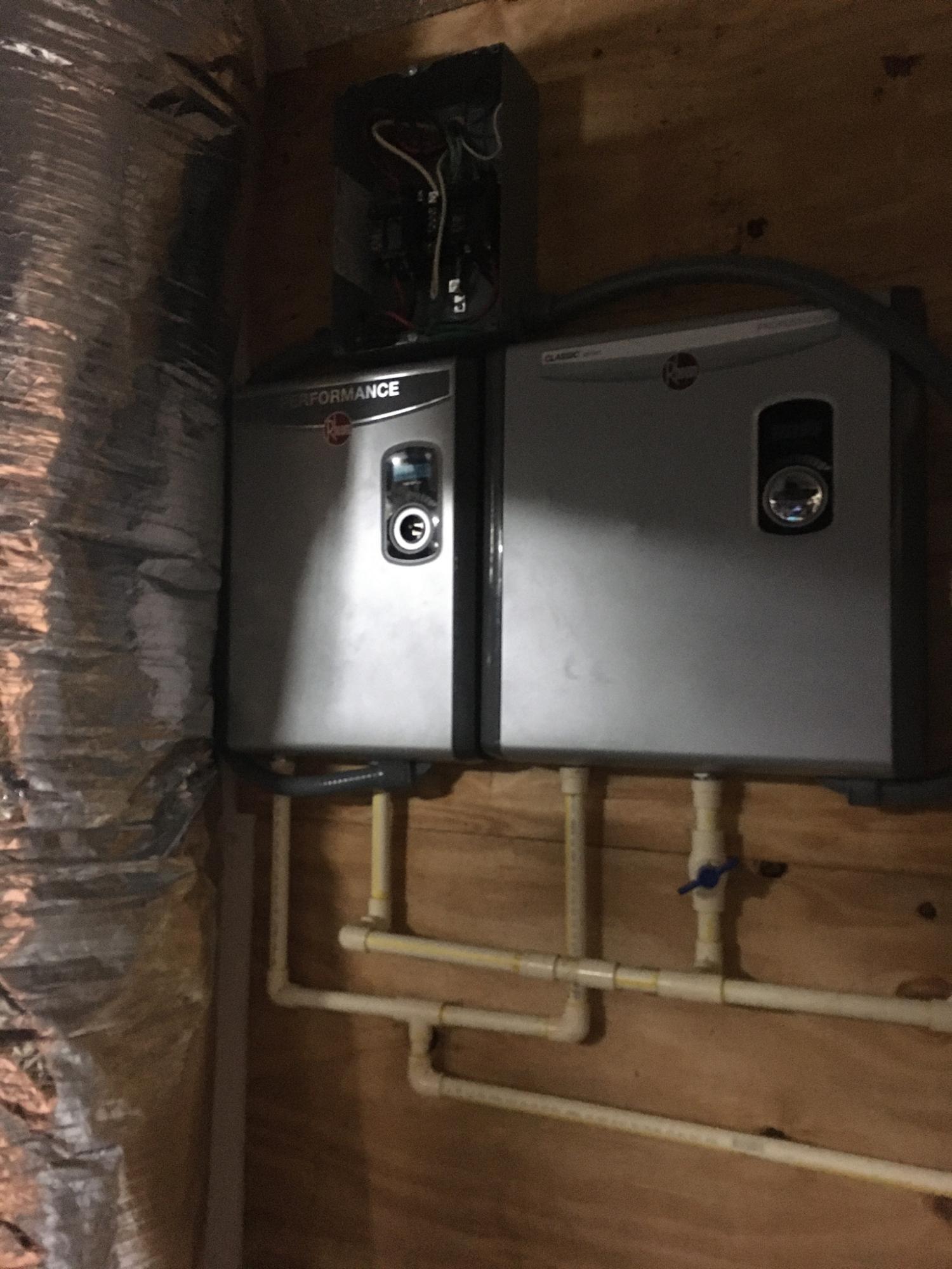

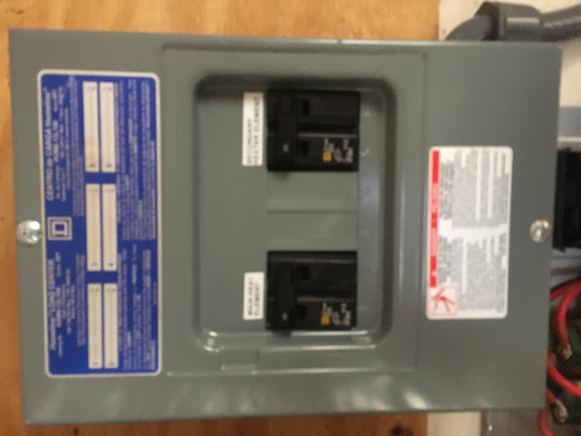

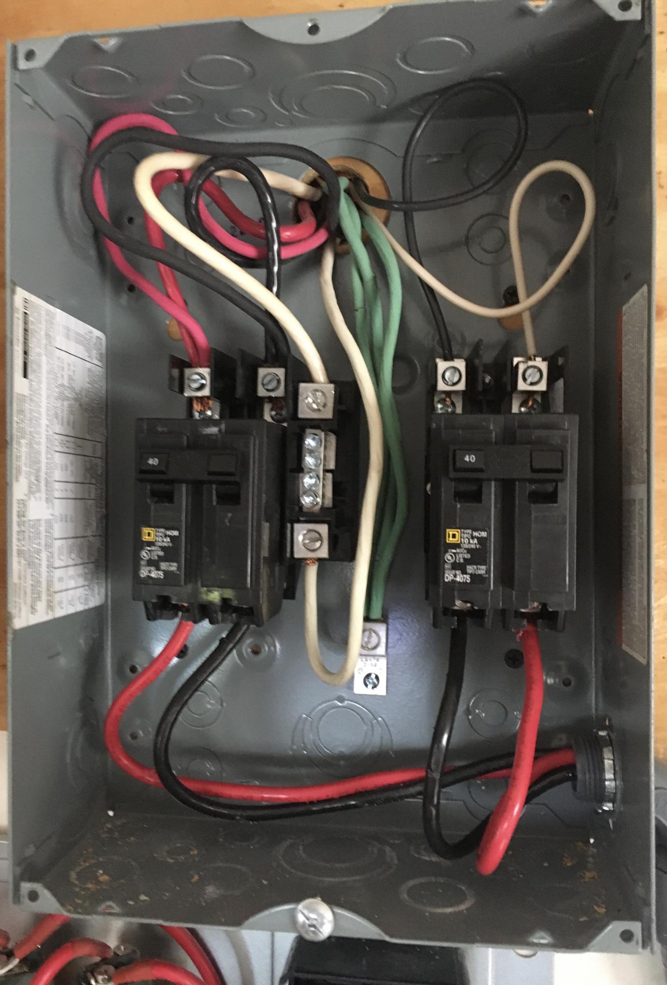

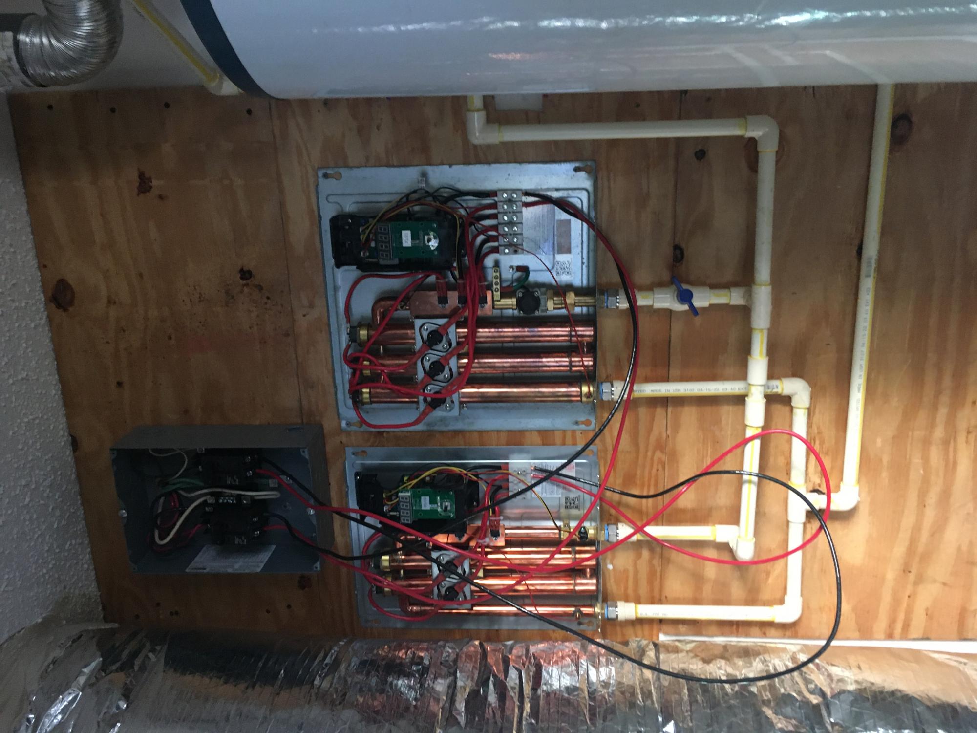

                            Here is some pictures of how I have it installed in my garage
                            The second picture is where I checking the installation of the tankless hot water heaters
                            The breaker that has the black and white wires are the ones that were use on the tank hot water heater that I had originally when I moved into the house
                            And yes this breaker box was modified for this project
                            One note the red and black and white wires are a #6 wire good for about 100 amps

                                        Seeing the pics - I would check for a ground fault. If anything is shorted to the metal, it could make a lot of electrical noise on the sensors. Like a triac or heating element. Just check with an ohmmeter.
                                        Or ground the backpan like it's supposed to be...
                                        The sensor wiring is best away from mains wiring, not on top of it.
