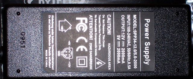

    3 wire cord but no ground
    No-name model SPP34-12.0/5.0-2000, 3-wire plug but no ground connection (or UL approval or EMI filter):

      If the construction for critical components are double insulated, then ground prong is not needed. Is there actual ground pin on this IEC AC Inlet?

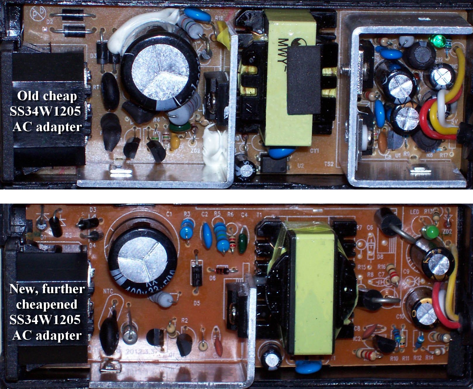

        I think there actually is ground, through that blue capacitor by the transformer. later edit: no i was wrong, it has to do with making sure there's no high frequency noise and radiation in the output cable .
        The optical isolator is for feedback on the secondary side.
        Here's a really crap psu : http://www.youtube.com/watch?v=T88ej...ature=g-user-u
        And a reasonable one: http://www.youtube.com/watch?v=1F3Xl...ature=g-user-u
        ^ it explains about that capacitor near the transformer and being isolated and all that, why it doesn't need ground...

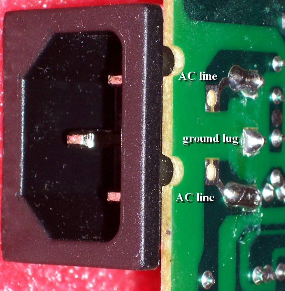

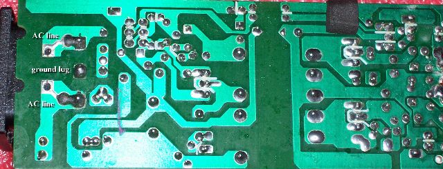

          There is a ground pin there (see attached pic), only it goes nowhere inside, but on eBay I've seen power supplies with AC inlets that fit 3-wire cords but lacked any visible ground pin. At least they weren't pretending to be safer than 2-wire.

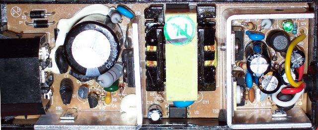

            This AC adapter has been updated to make it even cheaper, although the output ratings remain unchanged. I think the basic circuit is the same (new one still has an optoisolator, but it's hard to see in the picture), but some parts were removed (output chokes), reduced in size (less capacitance, lower wattage resistors, TO-220 schottky diodes replaced with axials), or cheapened (regular resistor in place of flameproof, UL certified Y-capacitor now an uncertified one). The ground prong still goes nowhere, but they quit bothering to solder it, at least not properly.
            The old AC adapter was made in China; the new one was made in "CHIAN".

              LOL! Why even bother to put some components inside? Worst I ever seen!
