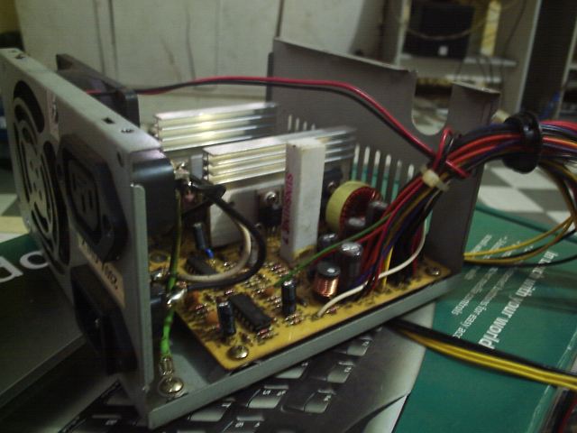

            Yep. Looks just like a 200w "Austin", rebadged L&C/Deer AT supply I have, except that mine (all Viva caps, circa 1998) still works. Wouldn't shock me if this was just the ATX version.
            But man, that's something. Surprised it still (sort of) worked after that!
            You know there's something wrong when you open up a PSU and are glad to find Teapos.

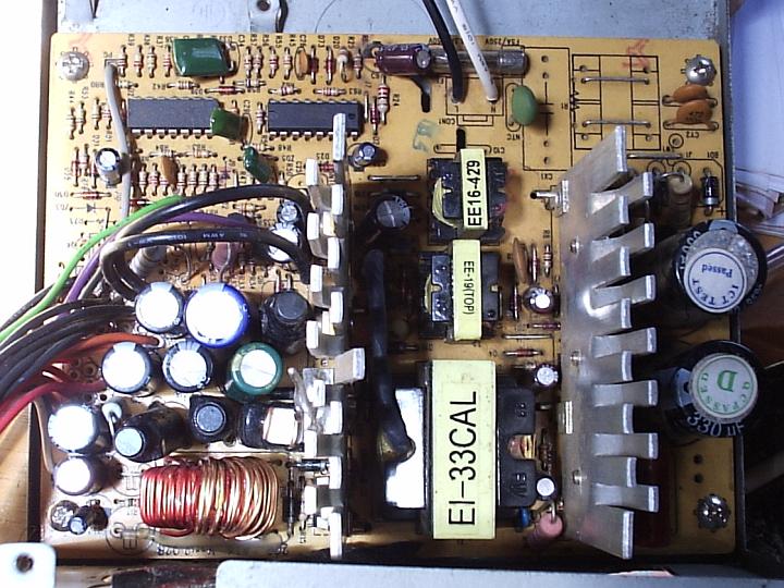

                Originally posted by dood
                I'll let the pictures do the talking here...
                On the output side, the smaller caps are Jun Fu and the larger are CapXon. All the caps on the output side are domed, and some of them are burnt (though this could be from nearby component failure).
                i think i found a similar one to dood's PSu. It is a 250W version.
                without load: +5v = 4.5v, +12v = 9.6v
                load 8A on +5v: +5v = 5.0v, +12v = 11.9v
                it's been recapped just for fun. but the two big resistor on secondary side still are boilling hot. i wonder if it is normal.
                days are so short when you actually do something..

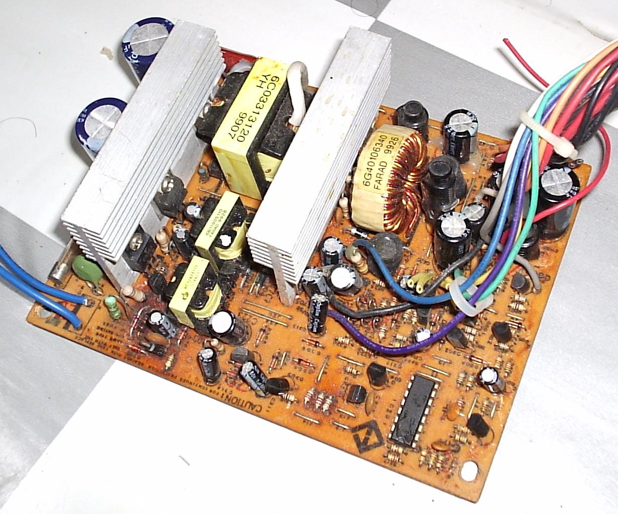

                            sorry for the dark picture. that resisor, to my surprise, only 0.3 ohm probed with my multimeter after i desoldered it. i wonder if it is really a resistor.
                            i would like to change those dummy load resistor in the psu with the 5w or 10w type. or i will try to remove them (i'll be very carefull to remove only those on pi filter, typically 33 - 100 ohm 2W).

                              I have two fried PSUs like that - one marked as MEICO, one as FRONTIER. These are the even worse than DEER. The symptom is always the same - exploded cap.
