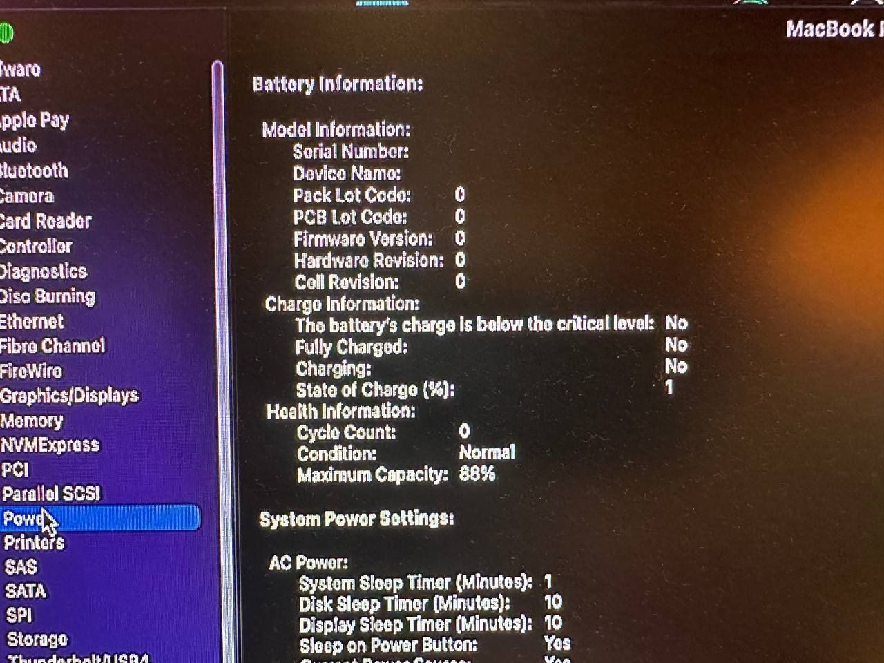

    • Battery showed 1%, but checking system info about the battery (no serial number or other battery info).

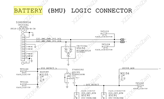

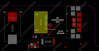

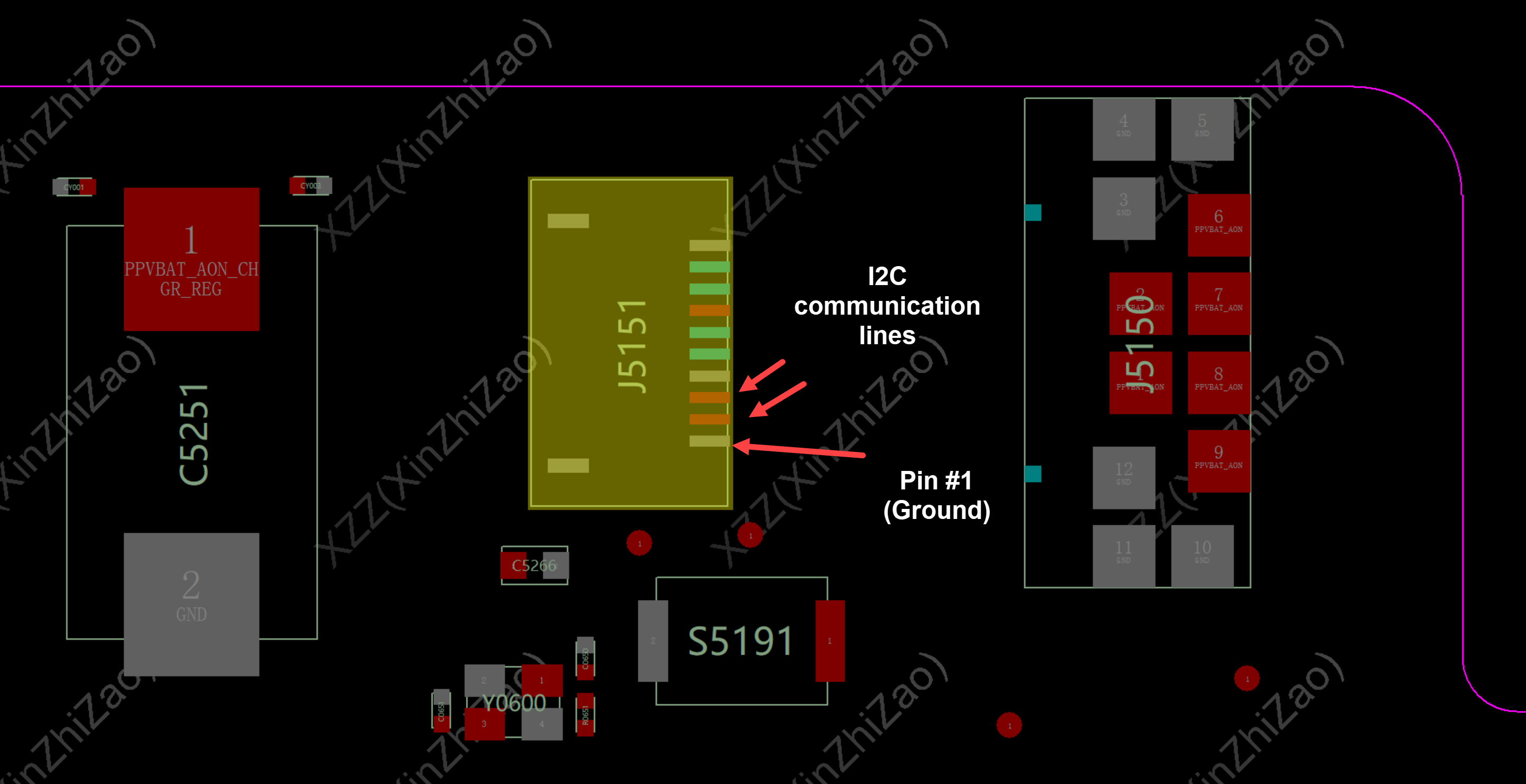

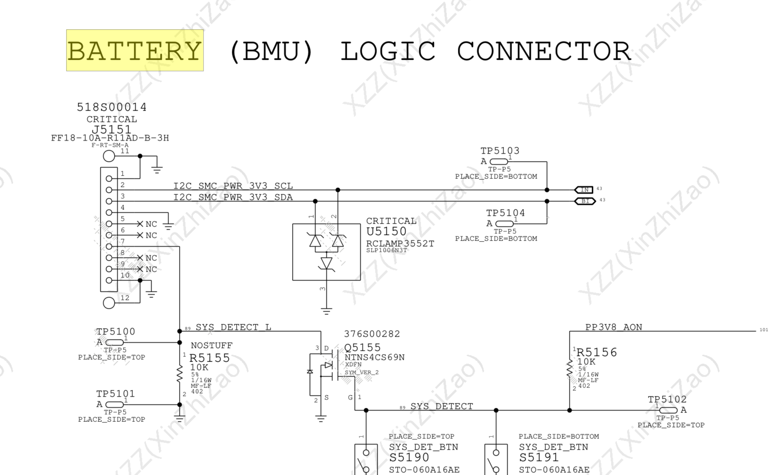

        No. See attached. It is J5151 and should be with 10 contacts. Meter in DC volts mode (20v or higher is ok).
        Black meter probe to ground. Red meter probe to the pin to measure. Interested specifically in the voltage levels on pins # 2 and # 3. Each measured to ground. These are the I2C communication lines and if either of these is defective, you will experience the same symptoms as you have posted.
        You do the following:
        1) Remove all power. Remove the battery. You will need access to the connector @ J5151.
        2) Meter in DC volts (20v or higher is ok)
        3) Red meter probe on pin # 2 (see below); black meter probe to pin #1 or any metal shield that will be a ground level. What is the measurement of the measured I2C line? Repeat for pin # 3 and ground. Post each measurement.
        Click image for larger version  Name:	i2c_battery_connections.png Views:	0 Size:	209.7 KB ID:	3208199
        Click image for larger version  Name:	battery_connector.png Views:	0 Size:	479.4 KB ID:	3208198

                Made a screenshot of sys info of the battery.
                Battery info
