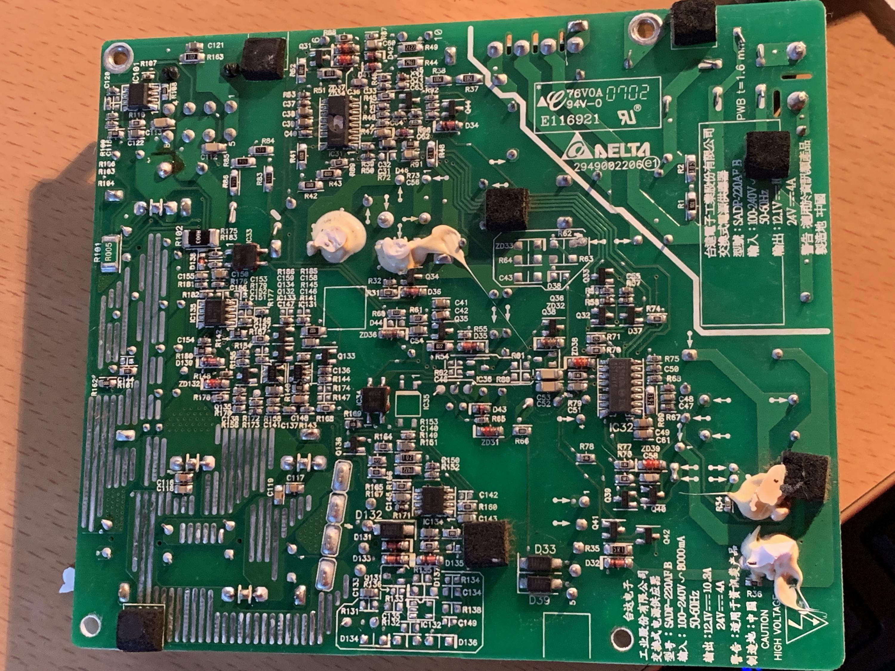

                            Hi guys!
                            I'm new to this too, so please go easy!!
                            I have an iMac Intel core 2 duo, with the 614-0387 power supply. It's faulty, in that when powered on it works ok, but after about 5 mins, the computer hangs and requires a restart. When I do restart, the computer hangs after a shorter period of time, and after restart, the hang happens even sooner. I'm assuming that the capacitors are bad, even though there is no visible damage. No bulging, and no leaks. Do capacitors always display these symptoms when bad, or is it possible that they could be bad without displaying these symptoms? Thanks for your help.
                            • Toasty
                              • Jul 2007
                              • 4171
                              #114
                              Re: IMAC 24 PSU Bad Caps replacement
                              Perfectly good -looking- caps can be completely weak/bad/open.
                              Consider that you could have an issue with the motherboard.
                              T
                              veritas odium parit

                                I have checked the voltage outputs on the PSB, and only 3 are giving any readings. There are 12 in total. Of these, 2 readings are 1.2v, and one of 4v. Is it safe to say the caps are shot, even though they look fine??
                                • Toasty
                                  • Jul 2007
                                  • 4171
                                  #116
                                  ??? >>There are 12 in total.<< ???
                                  I only count 8 output pins. This is the Delta SADP-220AFB version, correct?
                                  There are 2 output voltages, 12V & 24V.
                                  Are you bench testing this, or in the machine?
                                  Low outputs such as those lead me to believe you don't have a 12V load attached. When bench testing, you have to apply a small load to the 12V to get this to come on. Usually a 194 bulb (auto marker lamp) or equivalent will do.
                                  T
                                  veritas odium parit

                                    There are 8 output pins on the board, but I checked them from the attached lead which has a further 4 for the HD power. I also checked from the 8 pinout connection, both tests carried out in the machine powered up.
                                    I have just checked the PSB caps with a multimeter, out of the machine. 3 appear good, but 11 are reading down to zero.

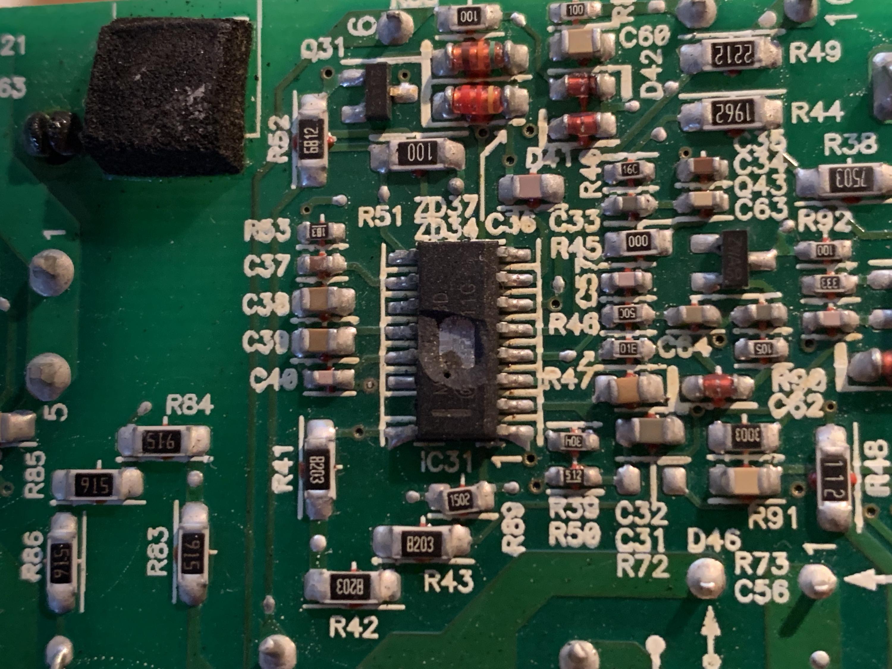

                                        #119
                                        Hi!
                                        You would not be able to tell it what would be his accurate type how it "ic31"-nek,or since it would be possible to substitute?
