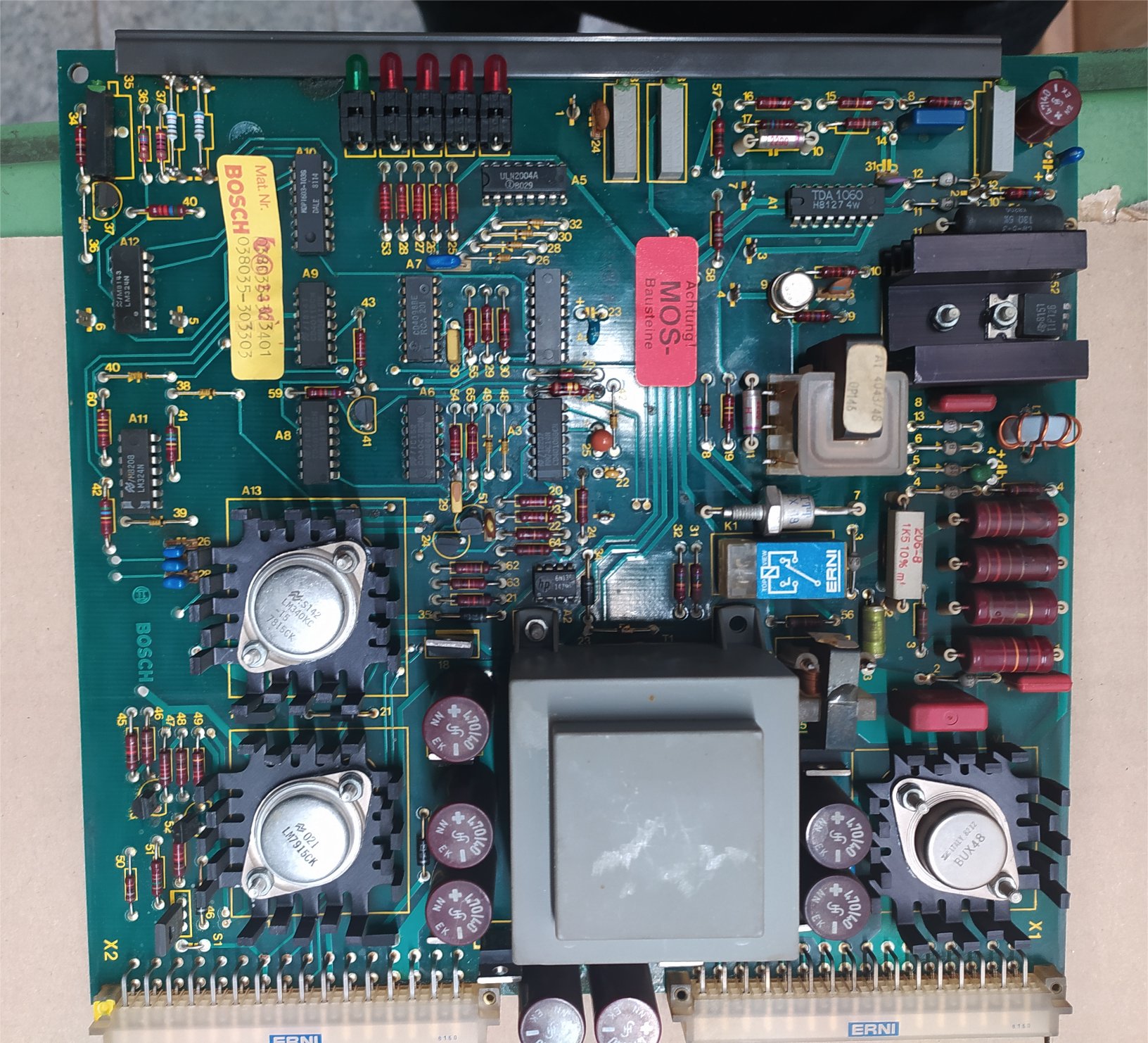

    There actually was a time when early SMPS and late bakelite housed electrolytic caps coexisted in high end industrial gear. A friend of mine just got himself a CNC milling machine form that time with its first set of now 41 year old caps still installed in the PSU... and it's malfunctioning.

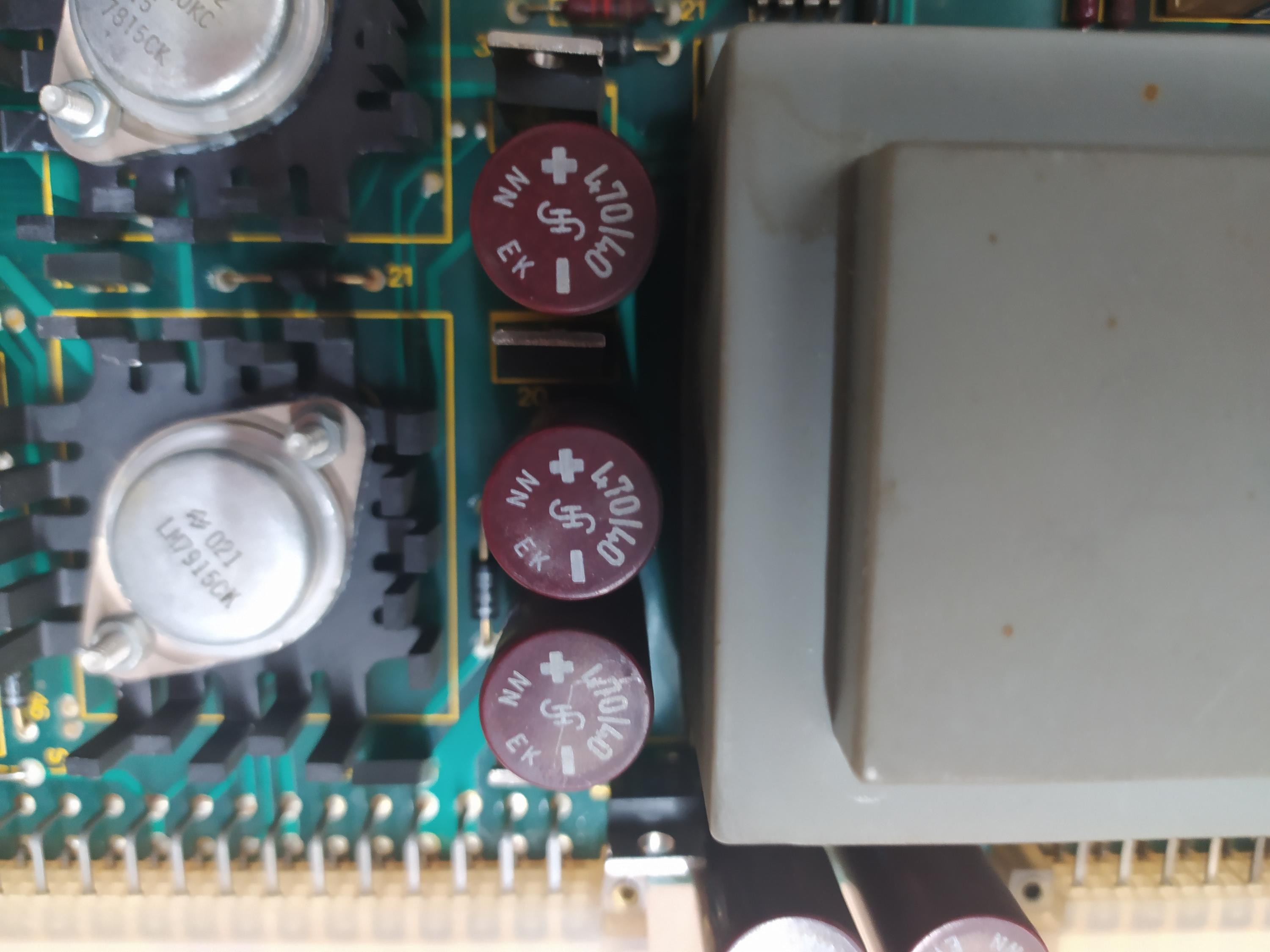

    Two of the caps have already leaked slightly onto the board. I have not desoldered or measured any so far but they should qualify for replacement.

          I suspect they may be some sort of OEM production for Siemens by Roederstein. The rather unique casing, marking, etc all look like they came from the same production line with just the logo stencil swapped. But I can't know for sure.
          Pin spacing is 5mm. Dimensions I have to guess right now. Something like 16x35mm.

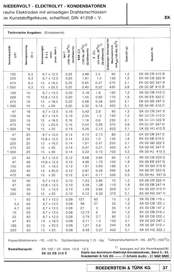

          I just looked around some forums and found an old datasheet for Roederstein EK series

            i saw that, but people esr testing the siemens caps found them reading much lower - i mean seriously better spec!

              Maybe they are not the same after all. Also Z in the datasheet is measured at just 10 kHz.

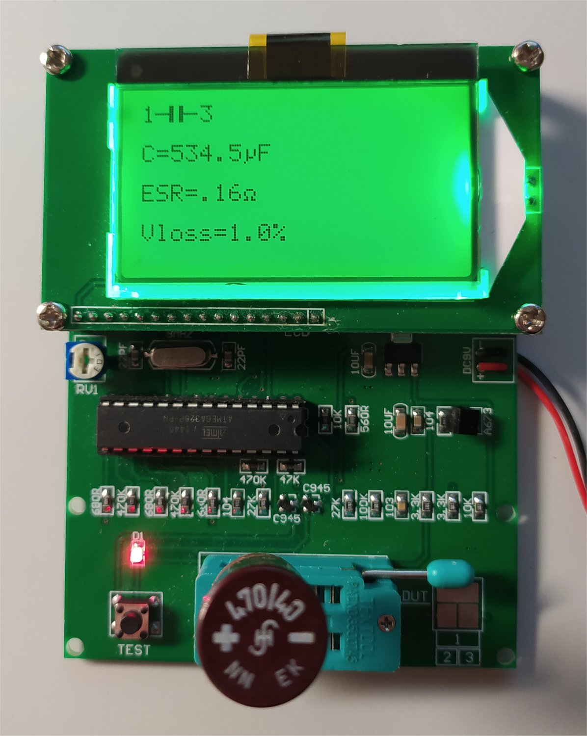

                Just replaced the caps with Nippon KY and tested the old ones with my chinese component tester.
                They all measure around 500 to 600 uF and 150 to 200 mOhms ESR. Didn't solve the issue but had to start somewhere.

                  Trying to make out date codes on several ICs, it looks like that board dates to early or mid 1982. Back then it was still common to spec ESR instead of impedance, and at 10KHz or 20KHz instead of 100KHz.

                    Yes the machine was made in 1982. I'm impressed with those Siemens caps. Other caps with Bakelite housing (Roedersteins) were also fine and went back in for lack of replacements. Found a Frako NO 10µ/63V that aged way worse measuring 140 Ohms ESR.
